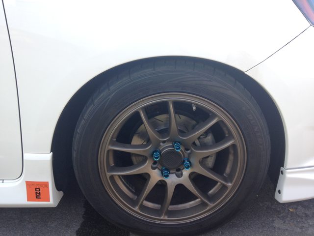

Installed my EBC greenstuff Pads and Slotted Rotors.
I am planning on flushing the brake fluid and replacing with Motul RBF600.
Does anyone know how much fluid is needed? They sell it in 500ml bottles.
Thanks.

Hey ALPINA,
Thanks for the info! I have also heard about ATE TYP 200 (the blue stuff), but was unsure of how it compared to the Motul. I might go with that instead.
I don't mind the extra brake dust, my wheels are bronze so it hides it haha
My friend runs yellowstuff for autocross and says they are great! I think redstuff might be a bit too harsh for just regular driving.
Thanks!

Hey ALPINA,
Thanks!
Hi Mr. Hollow,
There used to be 2 kind of ATE Brake Fluid (the high performance one),
there is this TYP 200 and the ATE Blue. Both of them had the same exact boiling point spec, the difference is one is dyed Blue and one is Clear.
So people use to alternate between the ATE Blue and TYP200, this way
when they flush the brake fluid they know that it had been flush completely when it change color.
But about 2 years ago, there is a BAN from government that make the ATE Blue illegal to be sold in USA because the blue color were supposed to be only for other liquid... and not brake fluid.
so now ATE only sell one kind which is the CLEAR color ATE TYP200.
Regarding the EBC brake pads, the yellowstuff is suppose to be more aggressive than the redstuff.
someday, I want to try Castrol SRF brake fluid... it is just that it is quite expensive...
Thanks.
Did you happen to get this kit on AutoAnything? They're selling drilled and slotted rotors and Greenstuff pads for $190, hopefully I'm going to get these soon
Yes I did, although save your self some cash and just buy the slotted package. Cross drilled doesn't do anything for performance at all its just for looks. In fact the braking surface area is reduced because of the holes, so some say its even worse than regular rotors.
