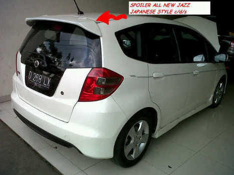

Does anyone know what the large black panel around the license plate is called?

Wow $50? $50 shipped from japan seems like the seller would be taking a huge loss. Thats a nice find. the LED or nonLED ones?
Also, tried a google search of those images Mr. Hollow and only pages from indonesia would pop up. Even with translate no one mentioned what those parts were specifically.
Only concern I have about those, is the "window" is made for the wider international plates so the CA/US plates will leave some open space.

Yeah it's really odd, it only shows up on Fits from Indonesia. It also seems to be places onto of the plate which covers the bolts.
If I were ever able to find one, I would make a mold of the piece and retrofit it to fit a US license plate....but it seems like a nonexistent part. :/

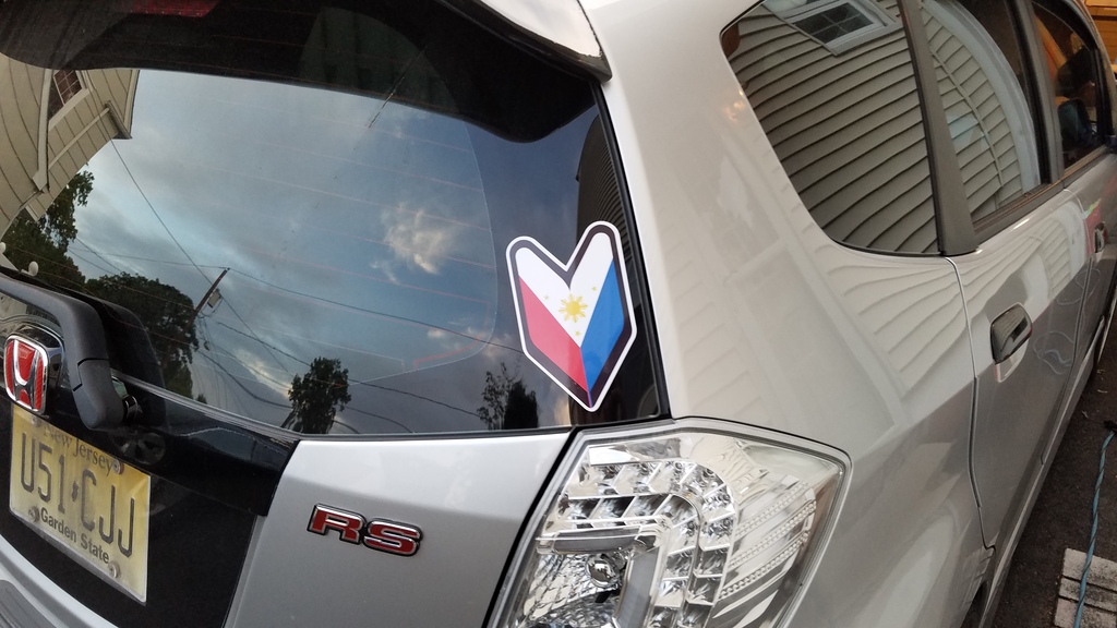

We hunted the guy down who makes it on youtube and he made me one. Upon getting it, it really doesn't appear so hard to make. Its just a piece of clear acrylic painted black in the inside. Make a template of the license plate area and cut the acrylic to shape. Tape off where the license plate would be and paint.
I just 3m taped it to the hatch initially and when I got my vanity plates, I upgraded to velcro for what I hope is easier removal and replacement. I also used weather stripping around the license plate so water and dust doesn't get in and dirty up the plate as much.

Lol for a second there I thought you were talking about the Filipino decal on your car since thats kinda the focus of that pic. Also, hello fellow filipino fitfreak .
So its just a flat piece of plastic huh that you attach to the hatch area? No curvature or anything? I know a good acrylic/plastics place here in SD, maybe they could make one. Thanks for the pics, sure Mr. Hollow appreciates it =)

No problem, 'tol!
I would get a flexible acrylic since you will need it to bend a little. I would make em myself but I don't have tools to cut acrylic or the know how. I'm thinking just a jigsaw and some water lol.

Shinjari- I could maybe create a vector cut line if you know someone who can machine cut the acrylic sheet.

Let me ask around. Wonder if the bend can be created using a little heat. Should be doable if the acrylic is not incredibly thick. I've known people to make their motorcycle windshields out of acrylic with handtools/dremel and a heat gun to get the bend they wanted.
Some detailed pics/dimensions would be helpful =)
