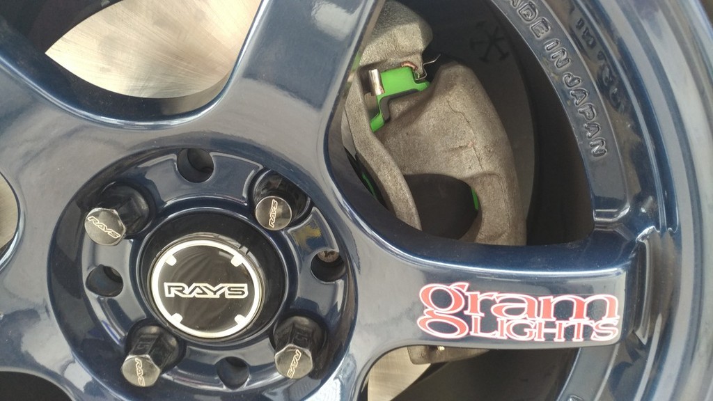

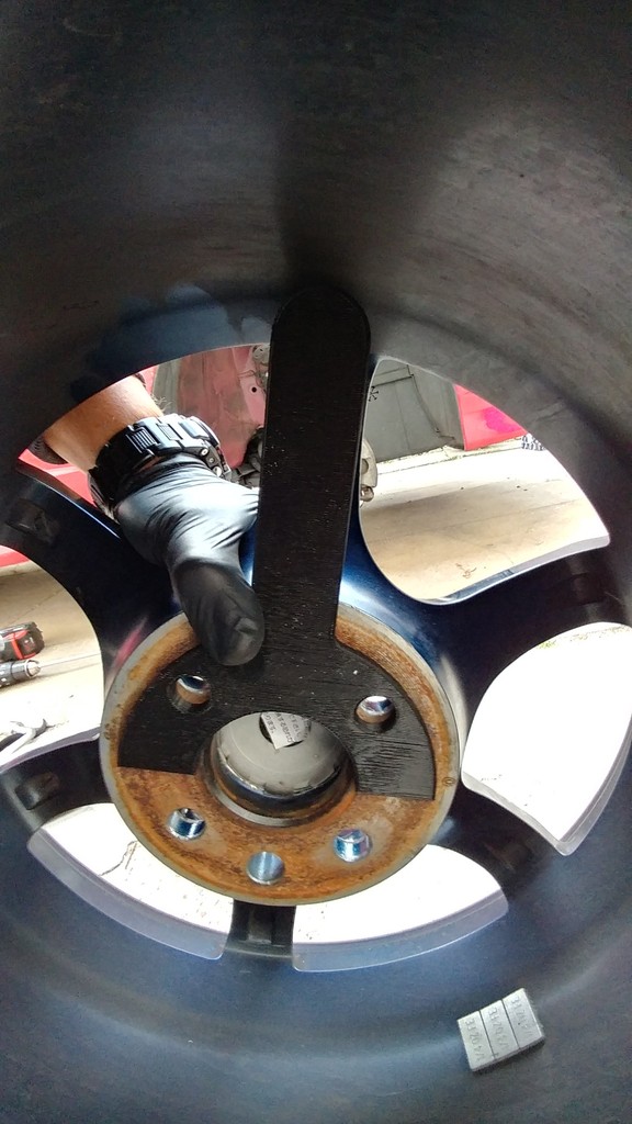

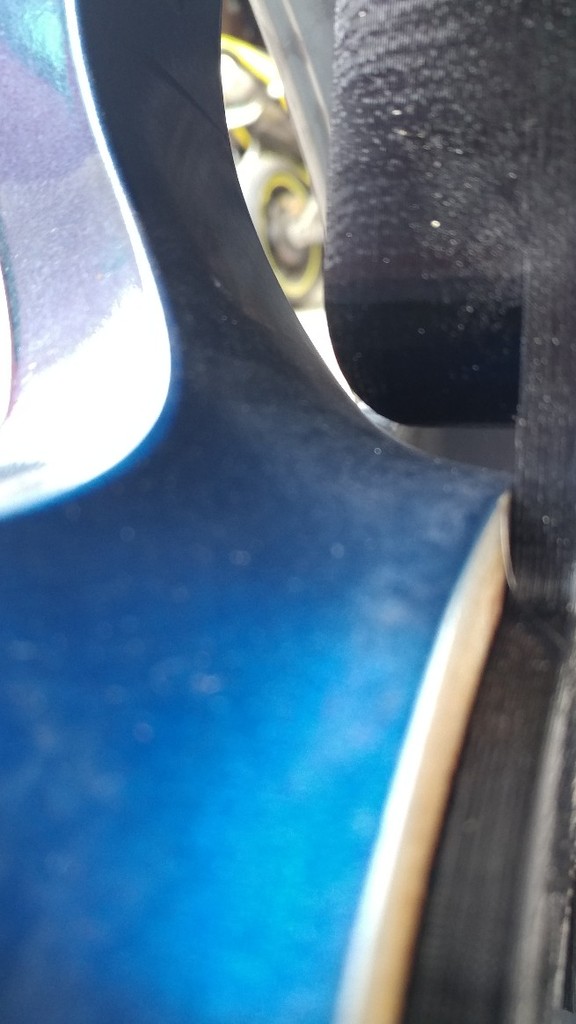

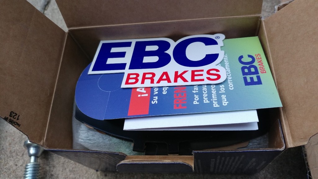

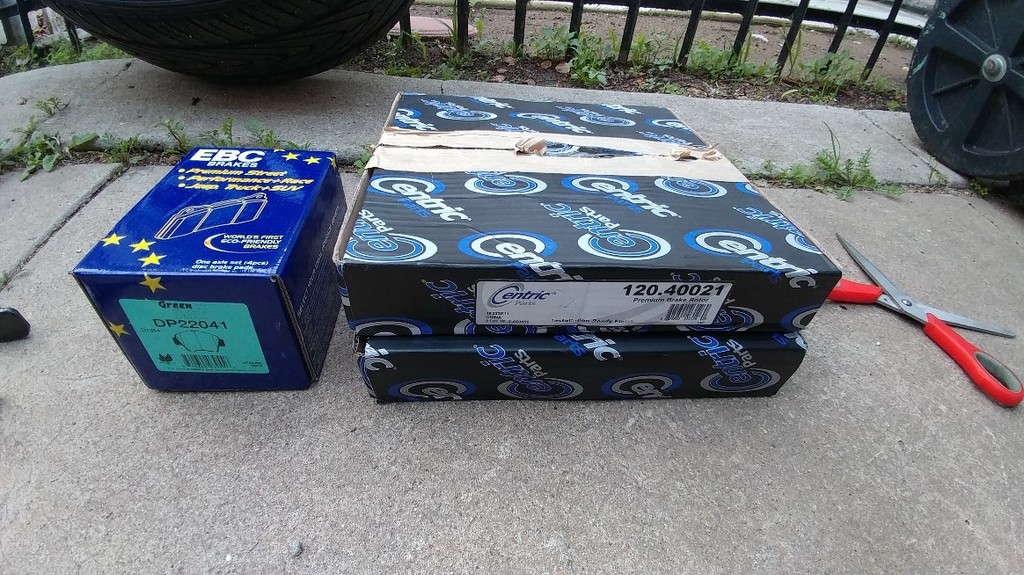

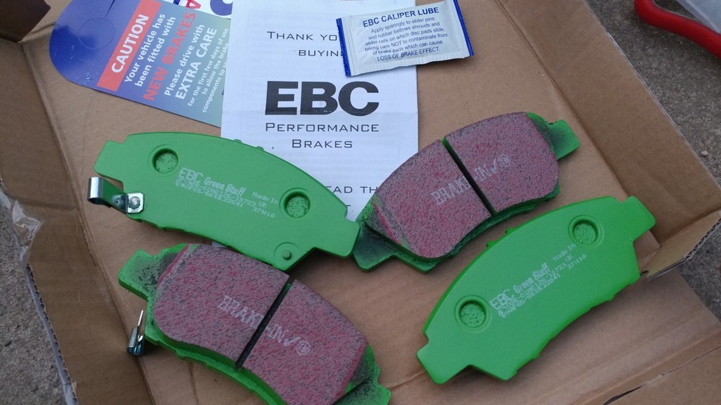

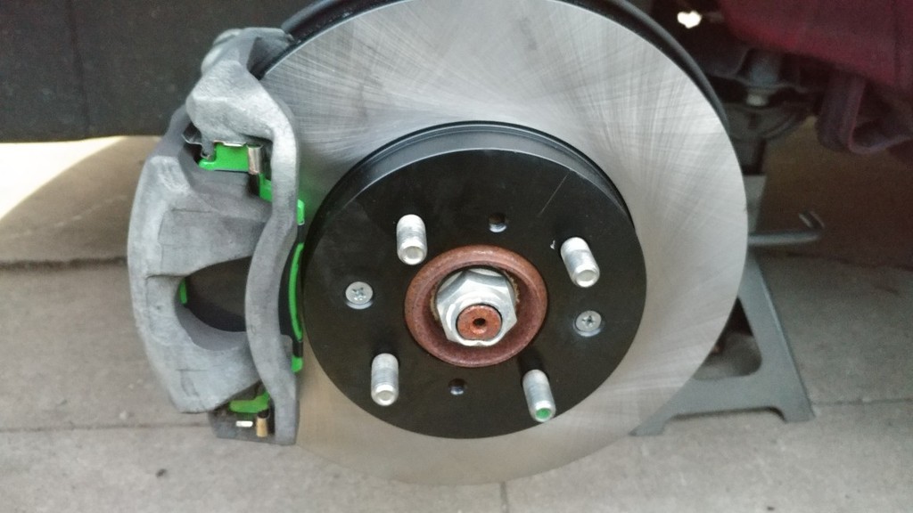

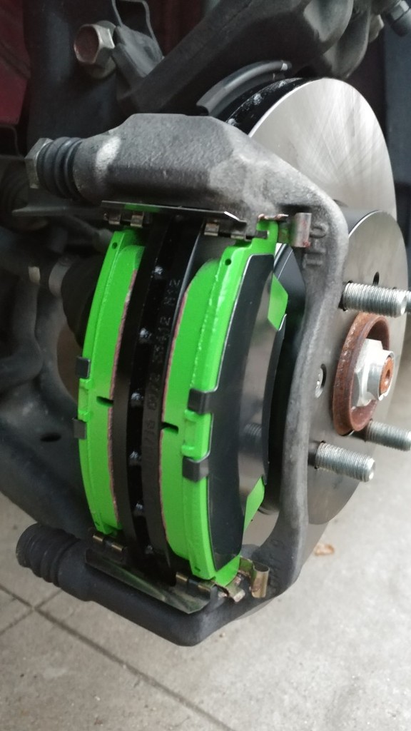

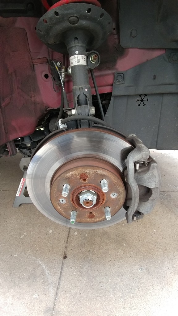

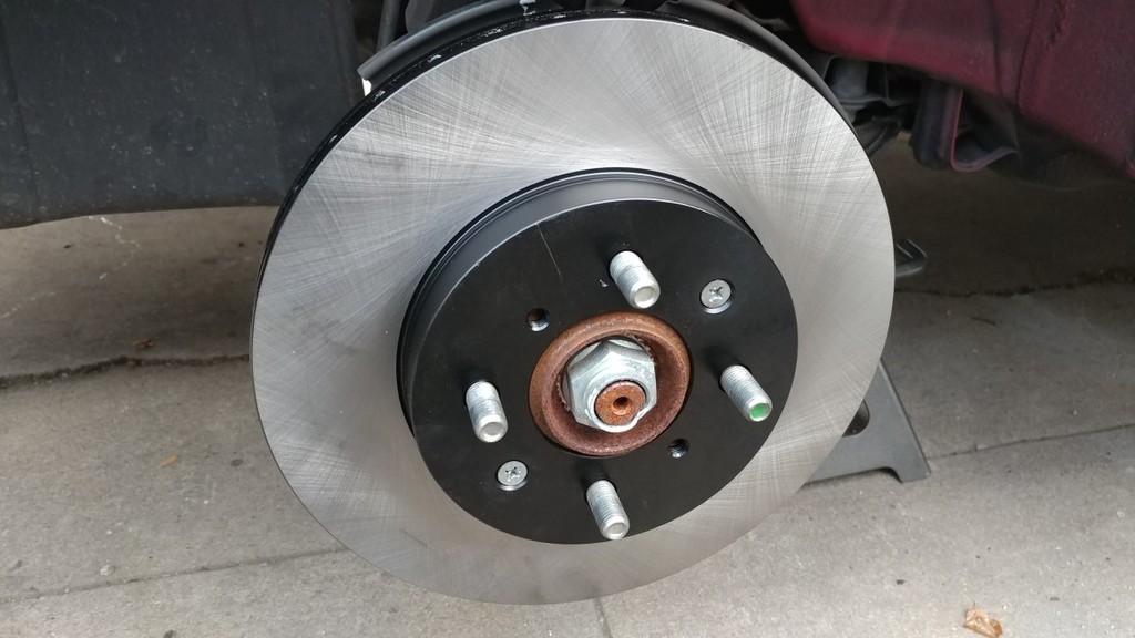

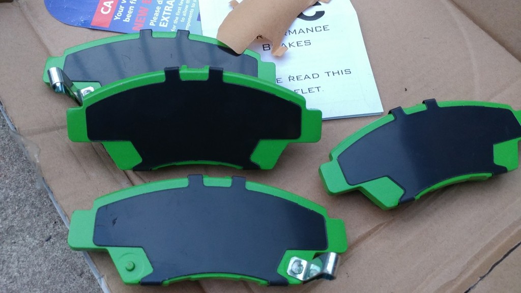

Well due to a delay by amazon I didn't receive my 2nd rotor until yesterday. I did my brake replacement yesterday. Centric performance blanks with e-coating and EBC greenstuff pads. Took a little over an hour to do.
Overall I'm very happy with the way it turned out. Next time I want to paint the calipers. Just wanted to get the brakes done for this time around so I was driving safer. Thoroughly cleans the clips and reused them. The screws that held the rotors on were super easy. No rust and an impact driver helped. Had to take a dead blow to the old rotors to break them free from the rust around the center area. Hopefully the painted rotors will stay rust free.
Also gotta follow these break in instructions.

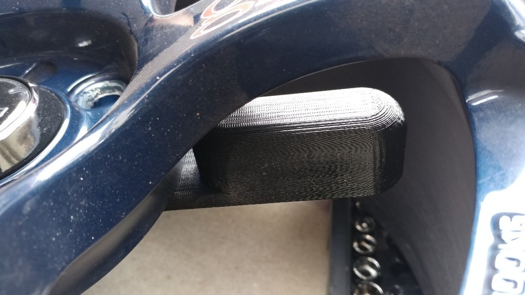

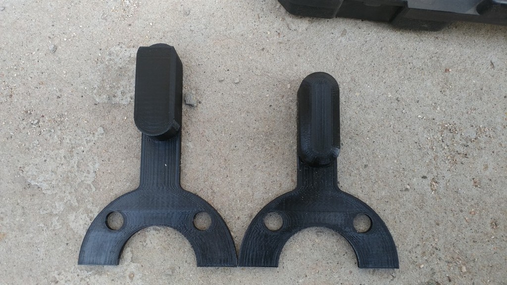

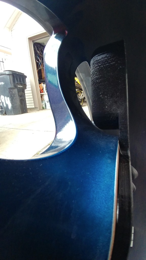

In addition to this since I had the wheels off I wanted to see if either the 6-piston big brake upgrade or the 4-piston stock caliper upgrade from Wilwood would clear my 15" gram lights. I 3d printed some templates based on the dimensions they provide to ensure there was sufficient caliper clearance. I oversized the template by 0.05" in all directions to ensure sufficient clearance.

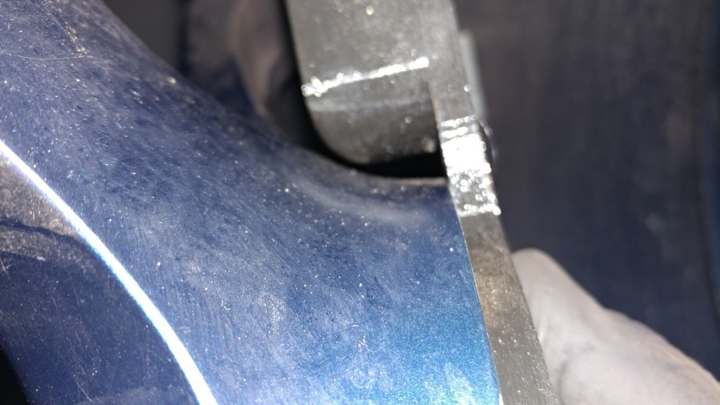

Tons of clearance on top for the 4-piston stock replacement caliper. There is sufficient room on the bottom for the caliper as well. Just hard to get a photo of or see from the outside of the wheel.
As for the 6-piston big brake, its a no go. The bottom portion would clear, but the top would hit...a LOT. If these were 16s then I believe they would fit but with the 15s there just isnt enough diameter to clear the big rotor upgrade. As you can see, the top of the template is touching the inned diameter of the wheel but the wheel studs are not centered by at least 1/2".

Glad I printed these templates. Maybe they'd be helpful to others wanting to know if their wheels would clear. I plan on reaching out to Wilwood and seeing if they could use the files...think it would be a good option for them to offer a 3d printed clearance template for customers to purchase through shapeways or something.

Did you leave that damn squealer on the pad? That's what I call them because that is what it does when it finally touches your rotor. Better to just break that thing off as it is not needed if one actually maintains their vehicle.
What size rotors come with their 6 piston kit? I fit 294mm rotors and J's/Seidoya 6 piston caliper under 15s, depending on the offset of the wheel, need a spacer to clear the spokes, but caliper clears the barrel.
