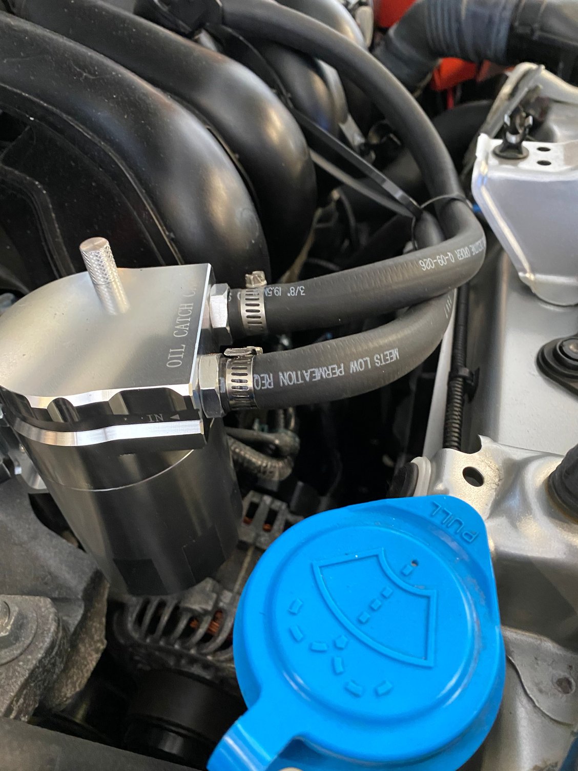

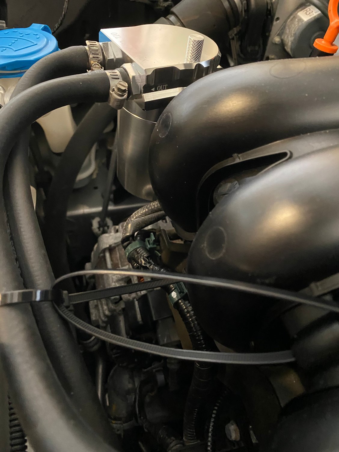

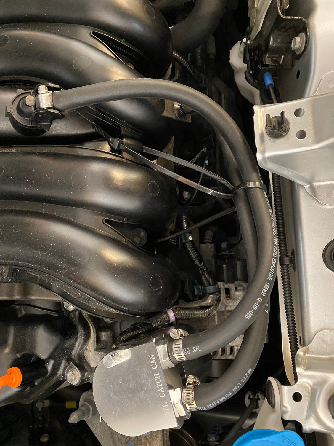

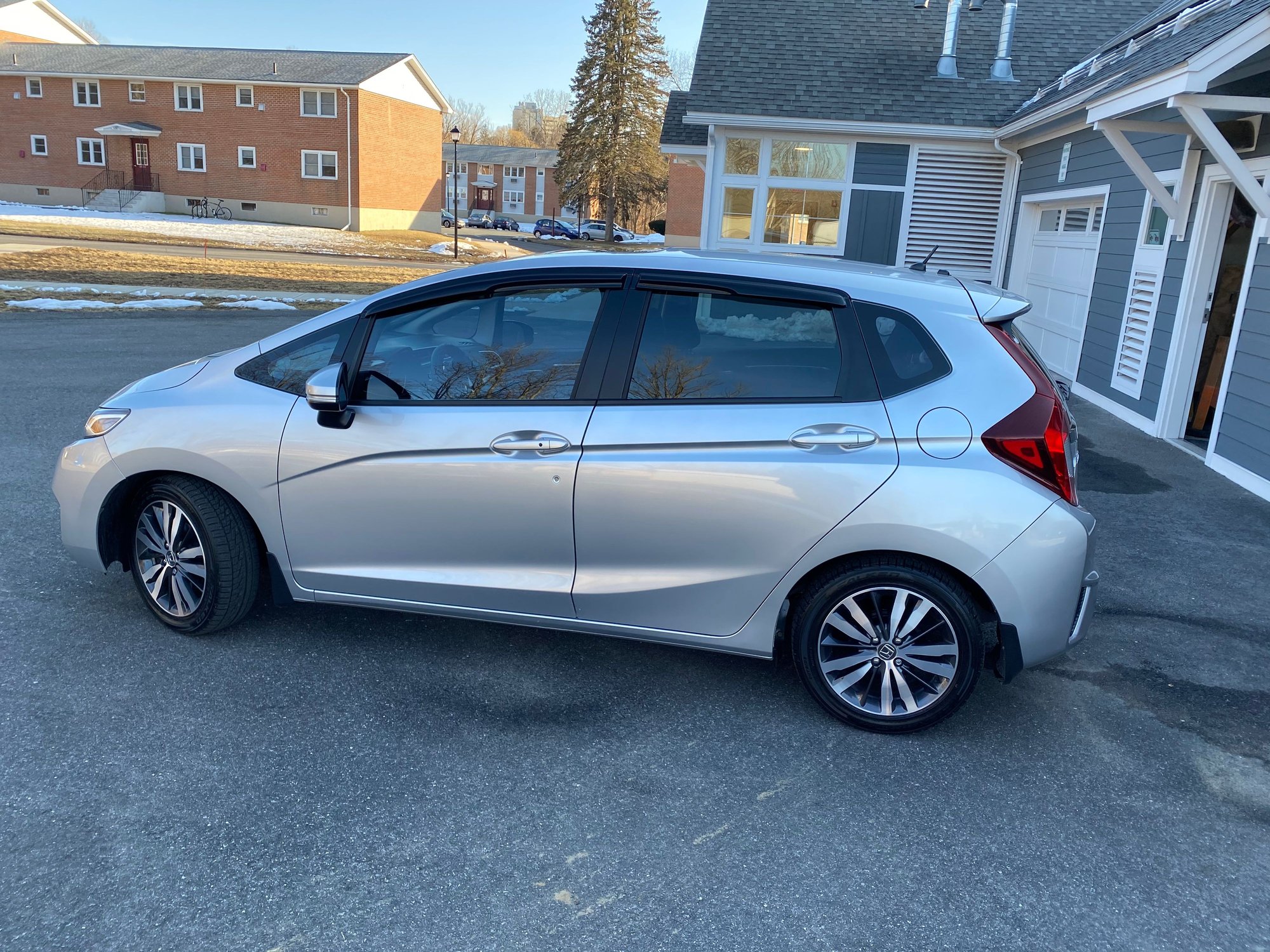

Oil catch can and had the windows tinted.

That’s a nice looking catch can.
how difficult was it to install and mount?

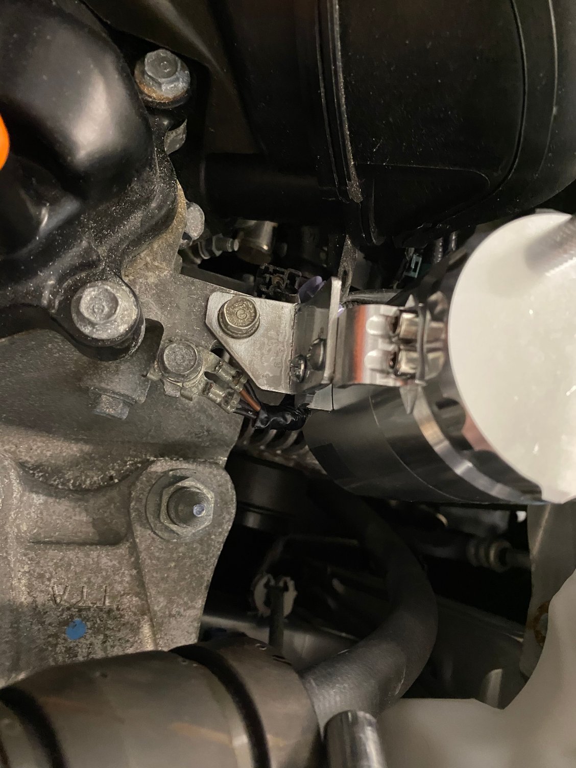

Super easy. I had to buy 5 feet of 3/8" inside diameter fuel/PCV hose to do the can. The stuff that came with it was absolute garbage. I made my own bracket in my shop at work. Otherwise it was pretty easy. 4 stainless hose clamps. Took 20-30 minutes.

And the reason to add an oil catch can is????

To prevent the oil/blow by from carboning up my valves.....

Isn’t that the purpose of a PCV?

Well apparently it doesn’t work too well in this car because I see a lot of posts about carbon all over valves. Just in case you doubt it, my brother is a service manager at a Honda dealership and he even told me that putting the catch can and will prevent this in the future. I don’t mean to be rude but if it bothers you so much don’t worry about it just let people do what they want with the car the way they want it. If it prevents me from having to tear my intake off or have to pay someone hundreds of dollars to have the walnut blast done I’m gonna do it. It doesn’t hurt anything.... I’ll take my chances.

It doesn't >bother me so much<, I just want to understand the reason for adding it to what I thought was a pretty well engineered little car. I can only assume that Honda considered the amount of oil that gets past the PCV and determined that it wasn't harmful. If there are owners that think otherwise then that's their prerogative to add an aftermarket part.
As for me, I'll take my chances. Thanks for the justification, er, explanation.

please report back at 100k, I'm curious to see how valves look for the non catch can crowd
