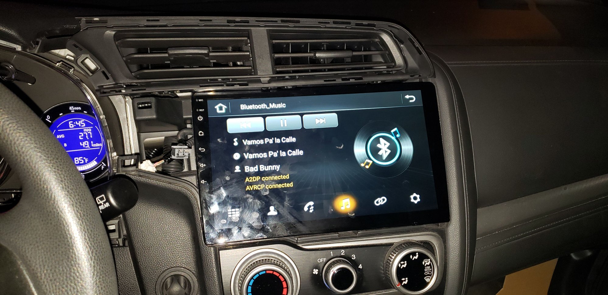

Started... this headache proyect Changing the head unit..... its a work in progress, since i still need a couple of adapters since i wanna keep oem camera and steering wheel controls.... and the frame that is supposed to arrive on monday.....
Its a Chinese ebay 10.1 inch android.....

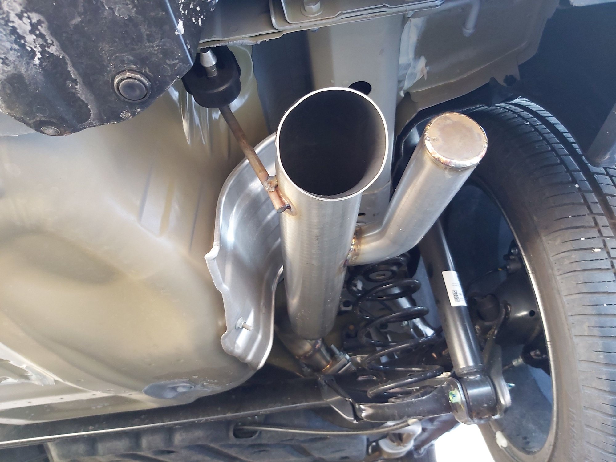

Braved the frigid temperature to install my Bisi Pulse Chamber yesterday

Radio
That 10” radio display looks great 👍🏼

The fit seems to be slightly off on my car (bumps the chassis a little) but the sound is very deep, I love it.

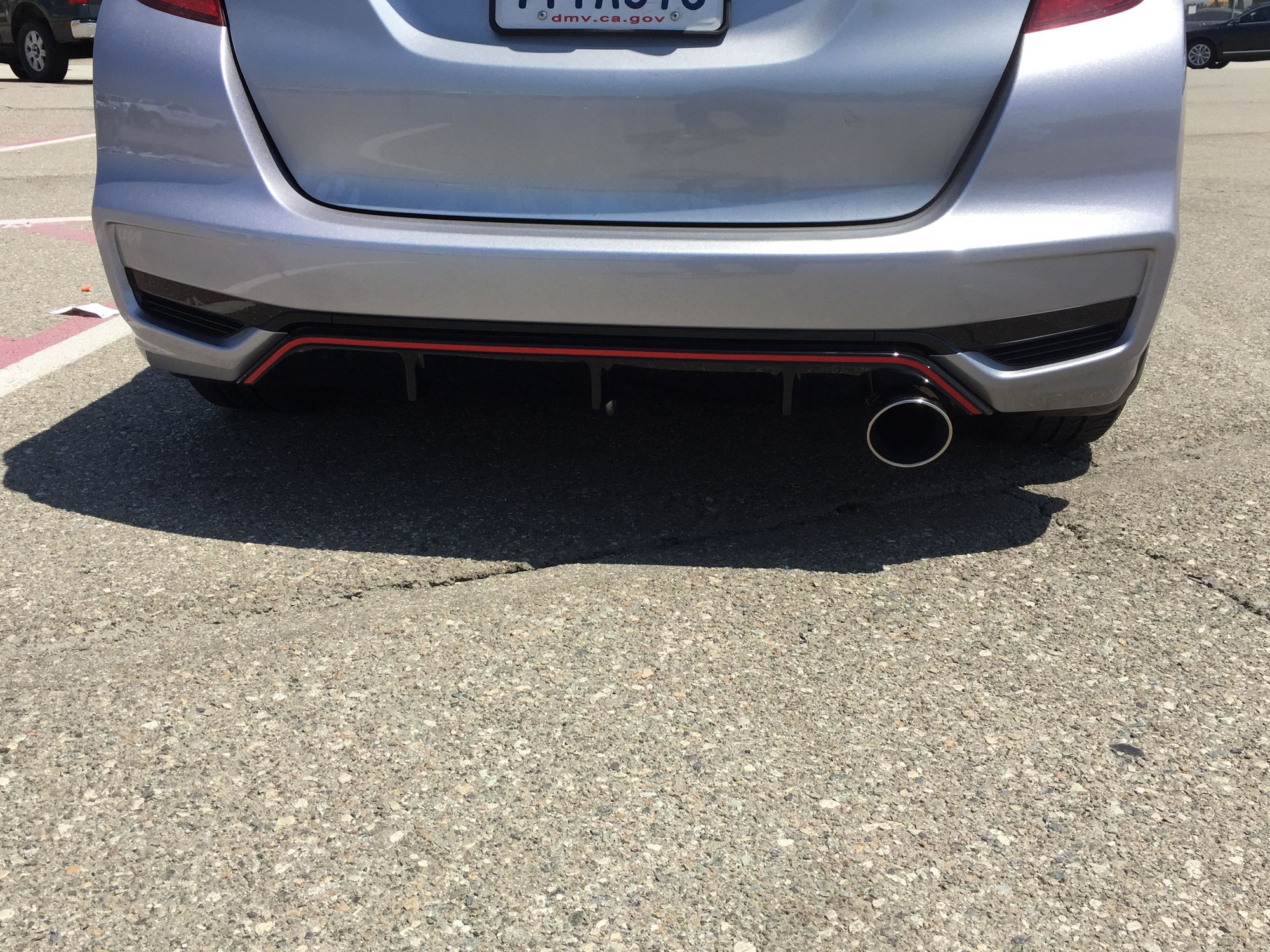

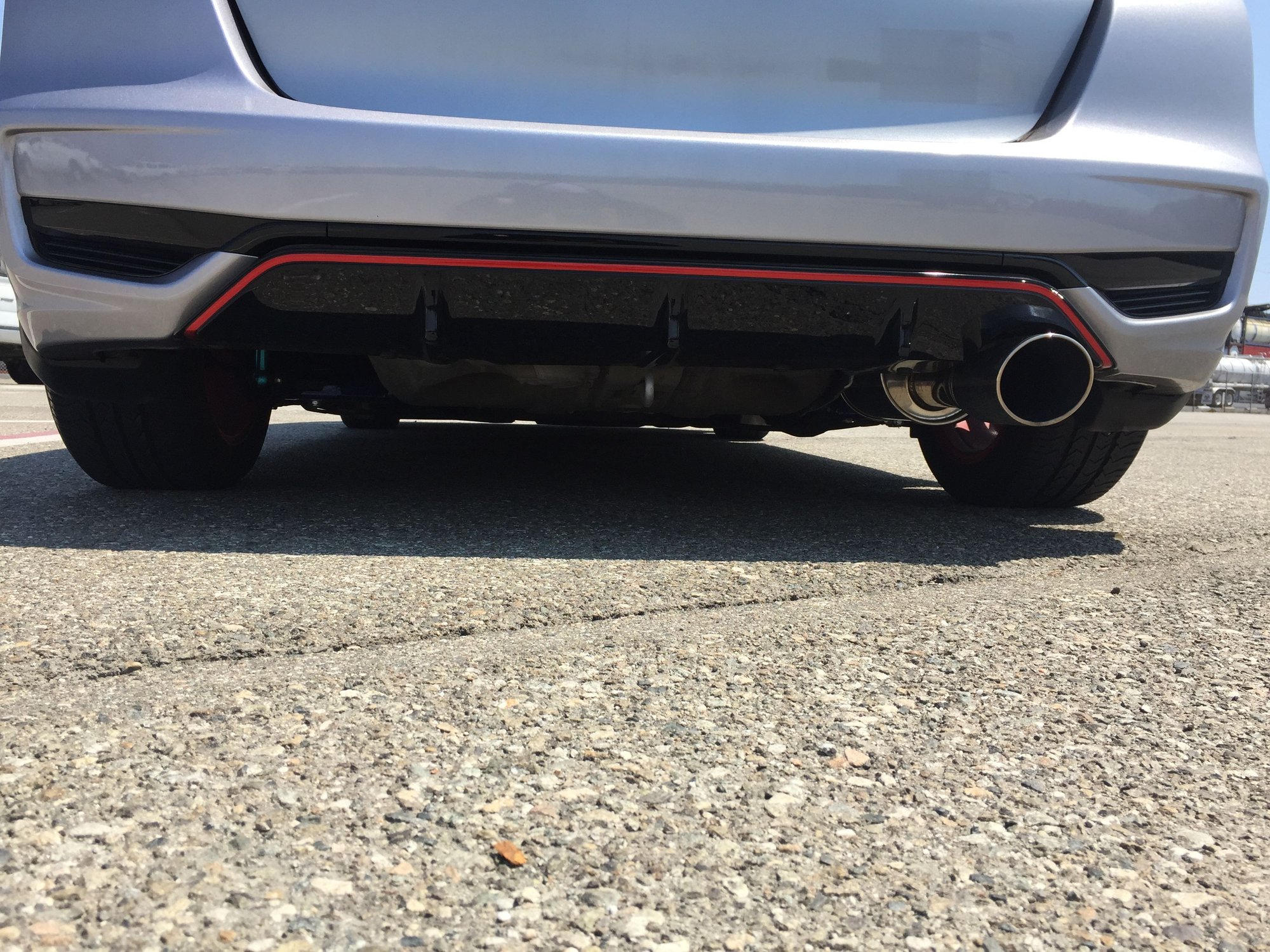

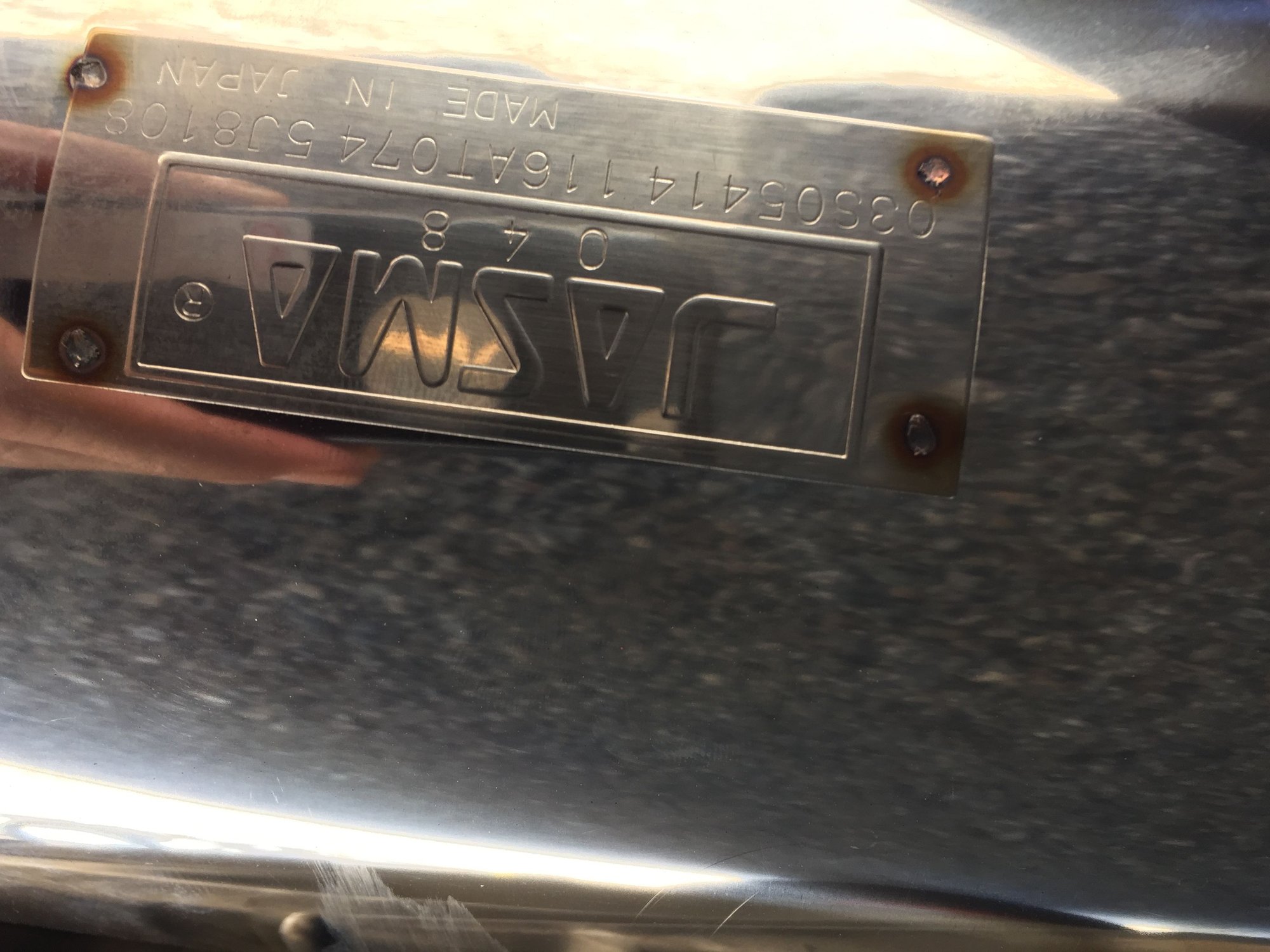

Exhaust
I’m old school I’m running the aipex exaust
This exhaust set up I had to change the rear bumper to the 2019 fit my fit is originally a 2017 ex
Jdm life
Finally complete

Thanks bro, as soon as i get the mounting frame i think its going to look cleaner!!

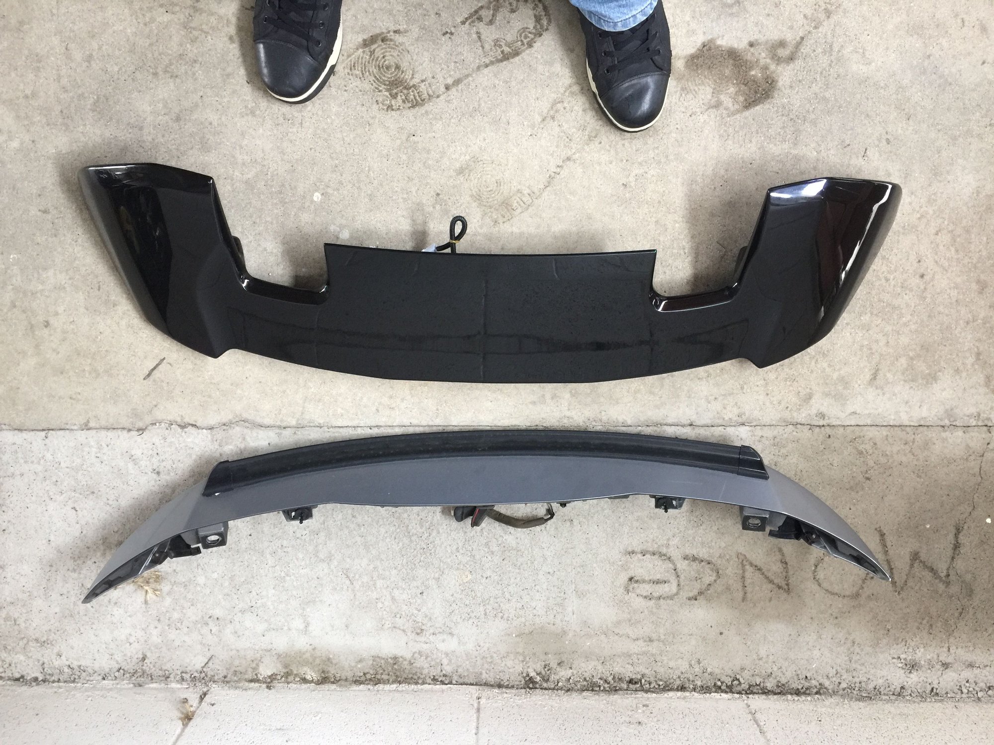

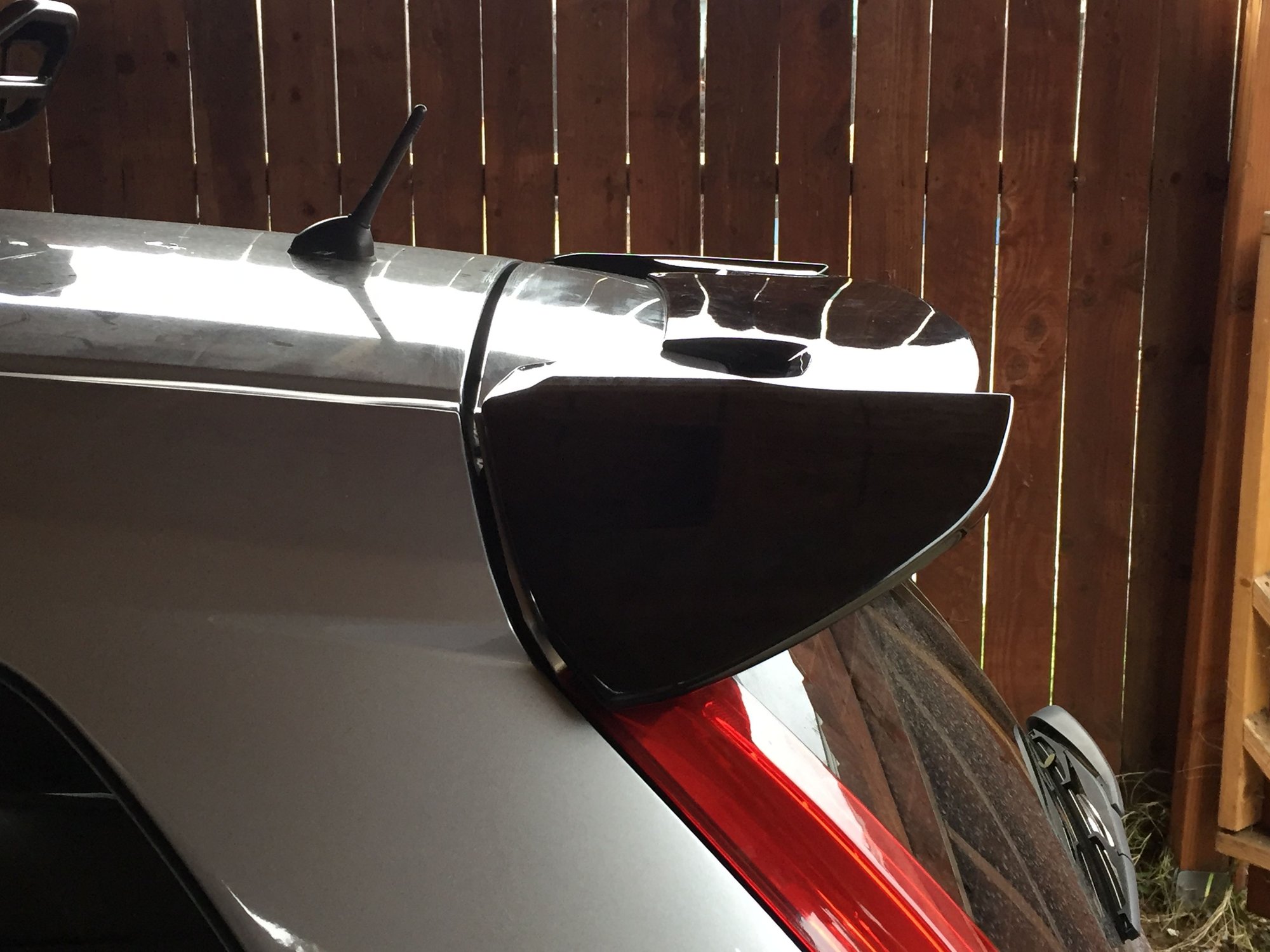

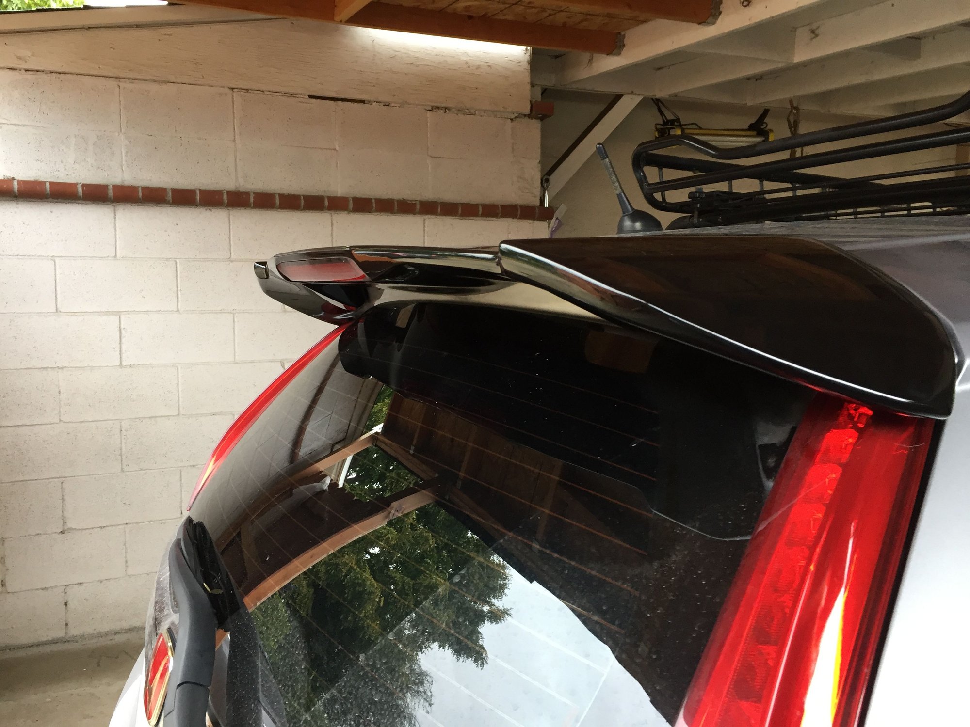

Rs wing
Oem with lip vs Rs wing
Install 30 min
Side view
Old Dec 8, 2019 | 04:49 PM
  #2551
Elpapas's Avatar
Joined: Sep 2019
Posts: 376
From: United States
Wing
There is a lip the is cal Rs-s wing I have that in order is going to be a 6 week wait
I’ll get it silver for the off set of the black wing

RS wing looks good!
when installed, does it expose any holes left by the oem wing?
any tips for the install for the rest of us?

Wing
Well there's two holes but i just put plastic tab and solve the problem
in another note the wash spray is not the some you get one from a old Honda that have them in the hood and that will work or just plug the water line and you will be good up to you guys the oem is held by 2 10m and 2 plastic clips 👍🏼😎

happened to me as well
I even tried bending the mounts, no success
I finally was able to get the noise to stop by using 2 exhaust hangers as "cushion" so metal will no longer touch metal

Yeah I totally agree ECF that no amount of hanger tweeking is gonna make it stop. It actually looks like the flange should've been welded at a different angle. I might try finding a slightly longer rubber hanger for the b-bipe which would make a big difference.
How did you hold the insulators in place between the body amd the pipe? Might try that until the weather gets better 👍👍👍

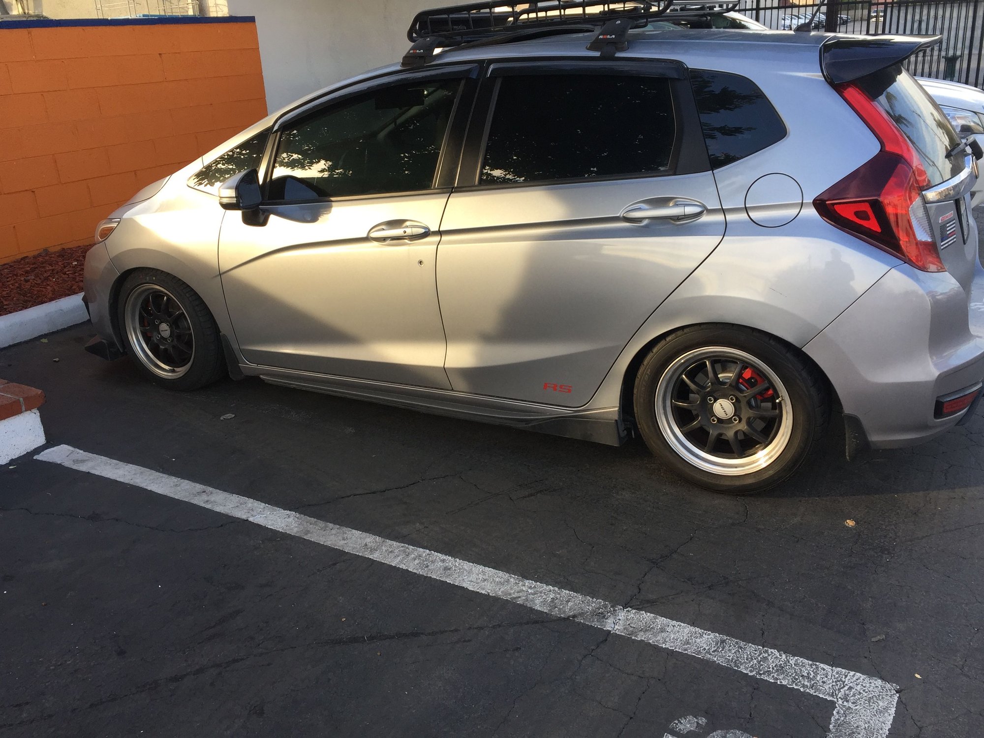

Tire wheels
Got a set of gt3 Rota wheels 16 by 7
old school wheels from 2000
215/45r16 front and 215/50r16 back
no rubbing fitment is on point on a gk5

Had to search because I didn't know what they looked like but good looking wheels bud 👍

There it is guy
thanks bro

Yes, very nice!
