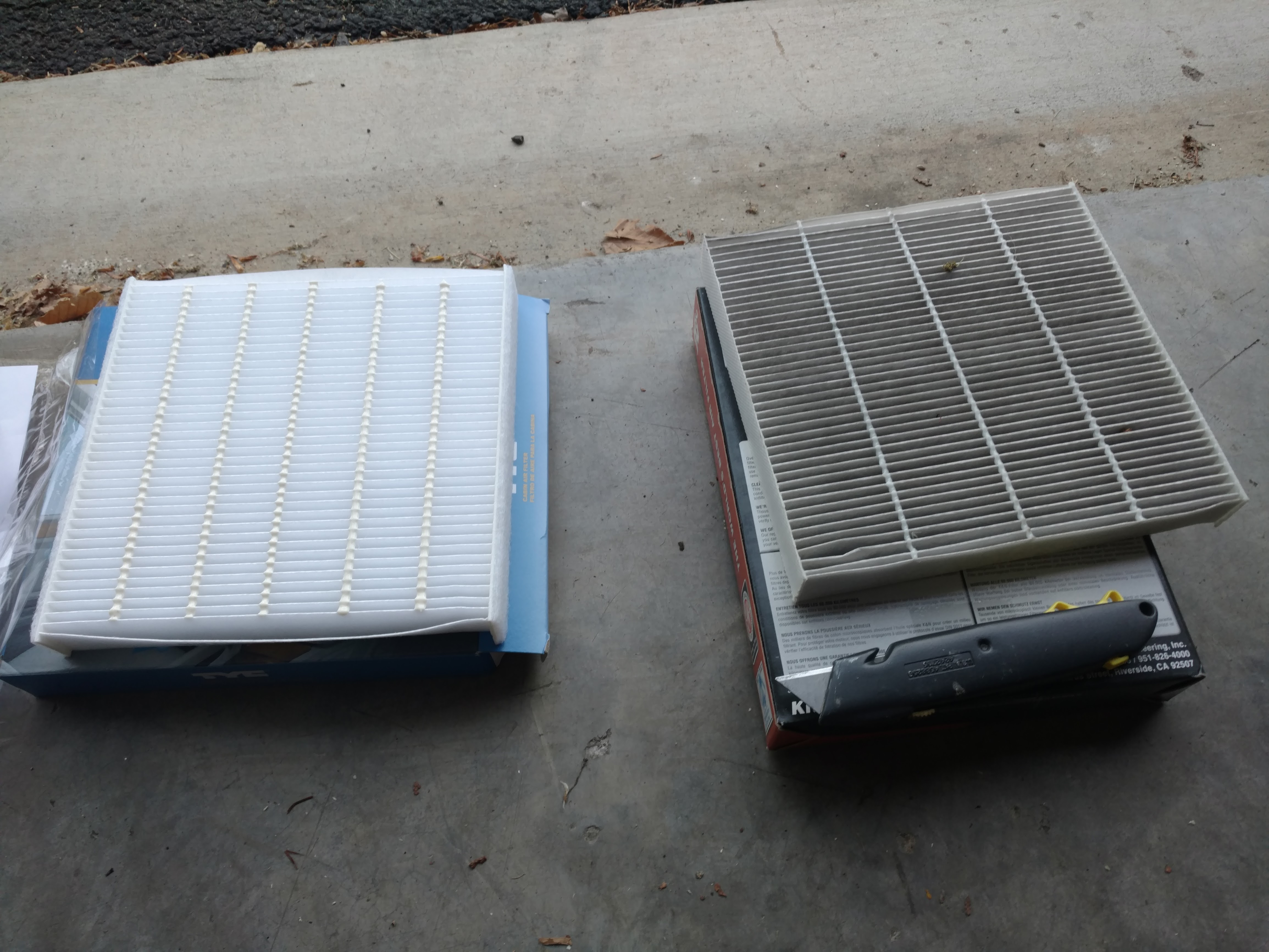

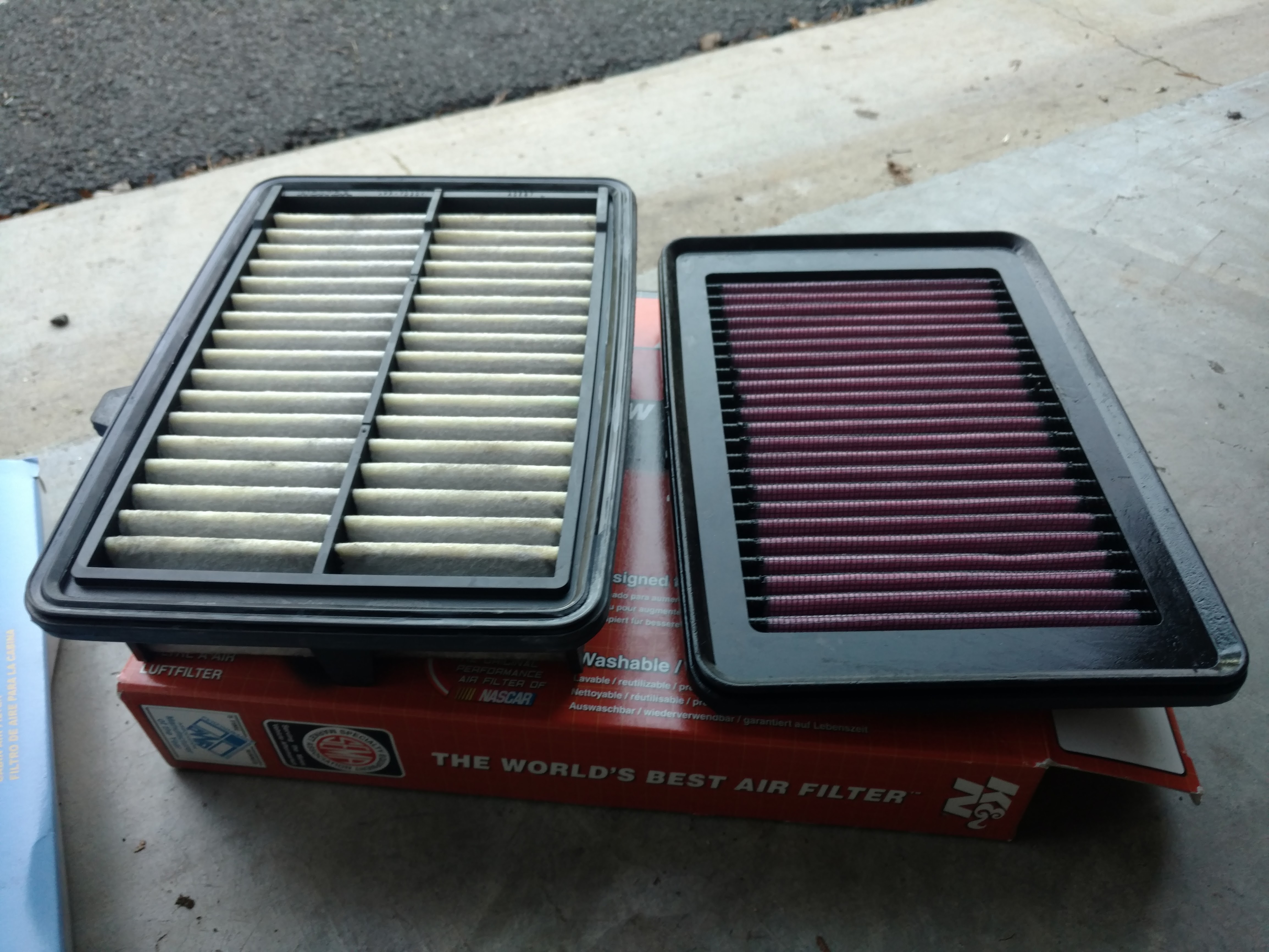

Installed a K&N 33-5027. It was on sale for $35 on Amazon and I needed a new filter. Not sure how I like that it's smaller than the last filter I have. To be honest, not sure what filter it is as it's been a while but it's not OEM. I do remember that it was very similar to OEM though. I haven't driven enough to make a judgement on it, but again it is smaller as you can see in the pictures.
Also installed a TYC cabin air filter. It's a perfect fit and pretty inexpensive:
Amazon Amazon

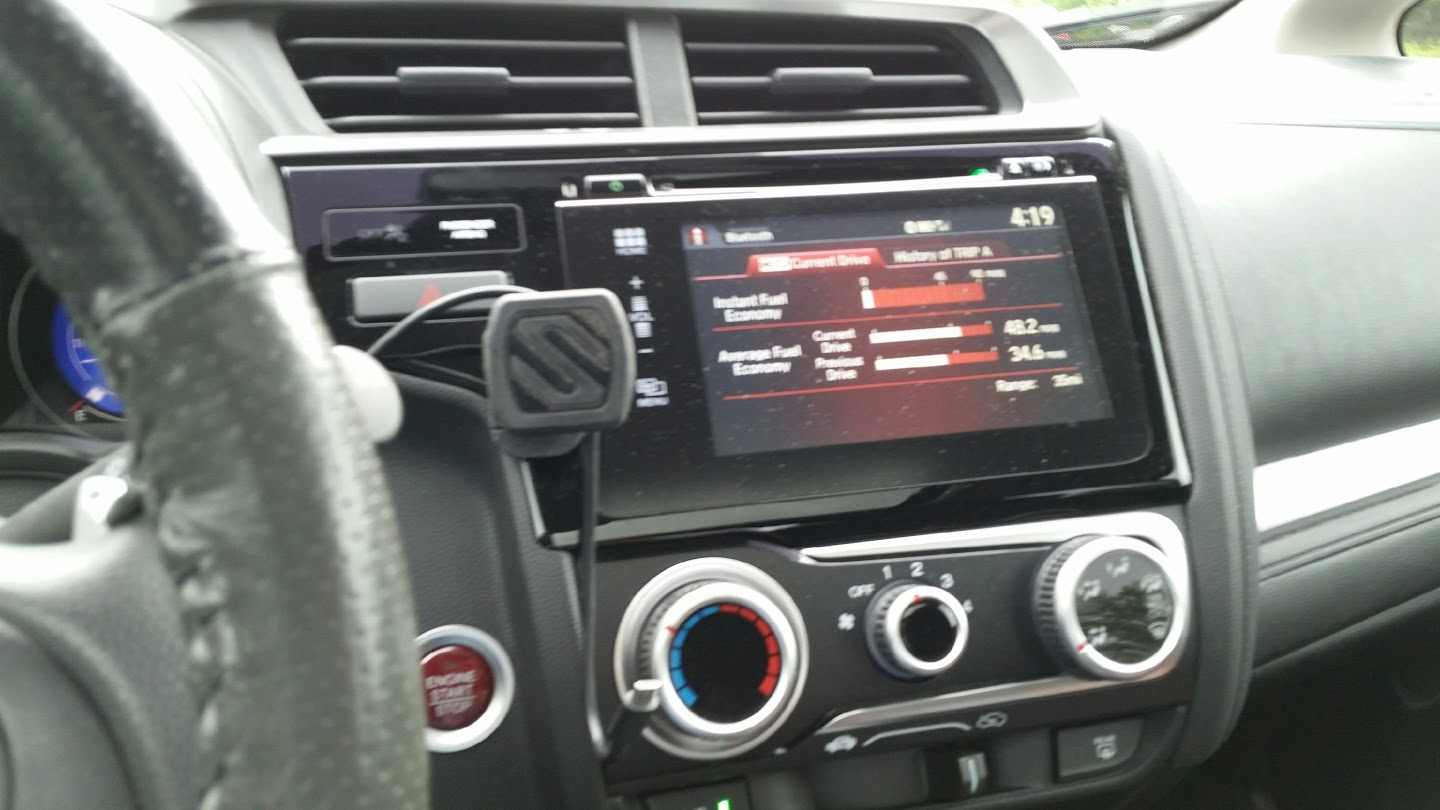

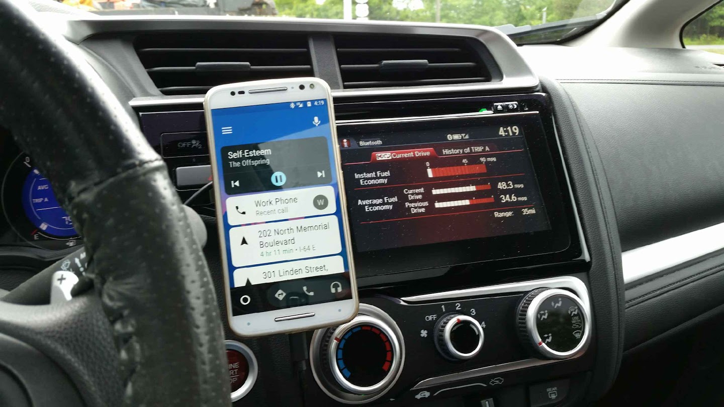

Changed my phone mount to right next to the head unit. I feel this is a more natural position to look when using my phone for GPS. Previously I had it above the left side cup holder.
Also tried out Android Auto a little bit. It works pretty well but wish it integrated with Waze for navigation versus Google Maps. Just a personal preference.
Fill up today was 40.98 MPG. Not bad but could have been better. We've been having a lot of spring storms and I think that's been hurting the mileage.

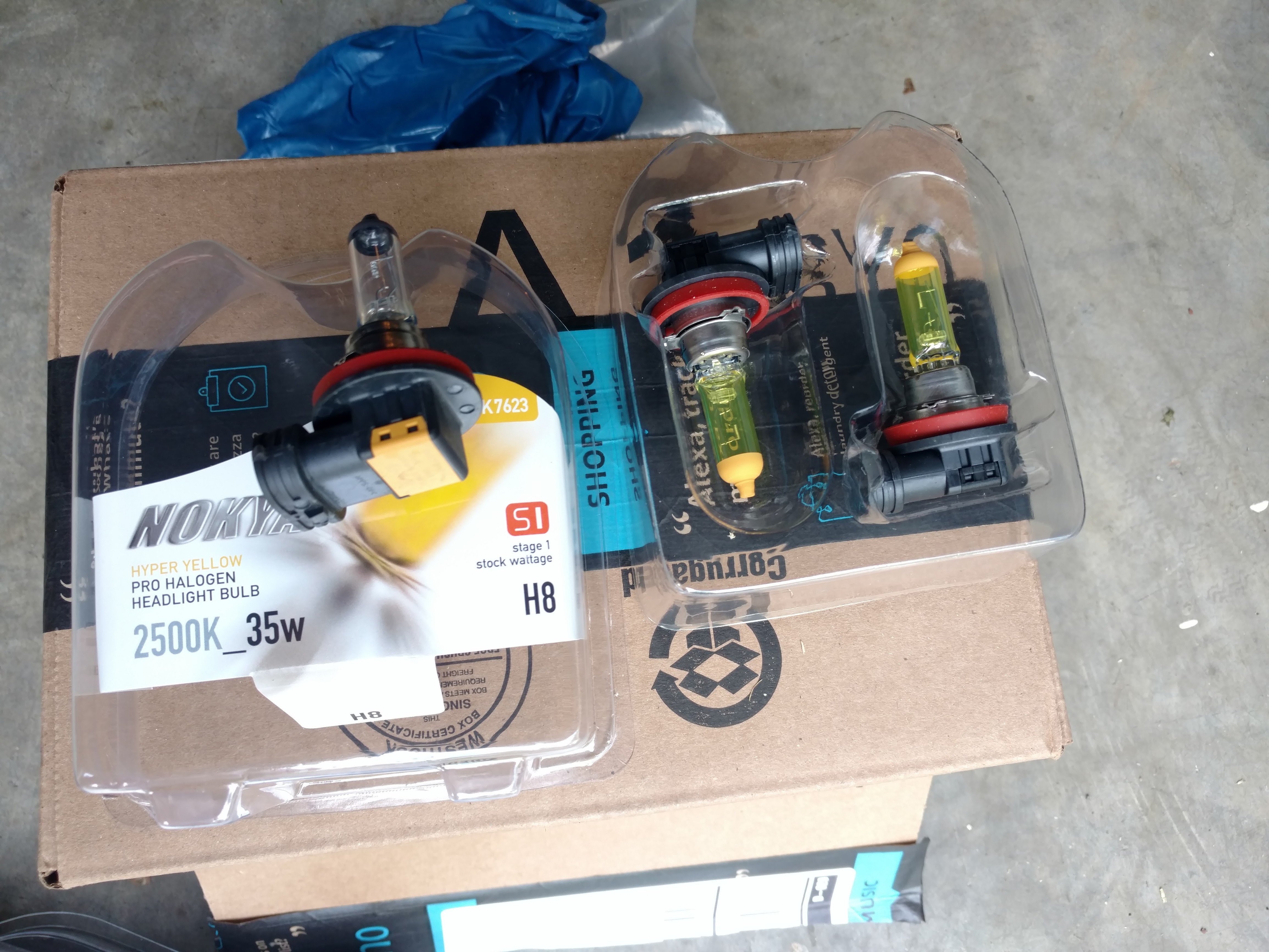

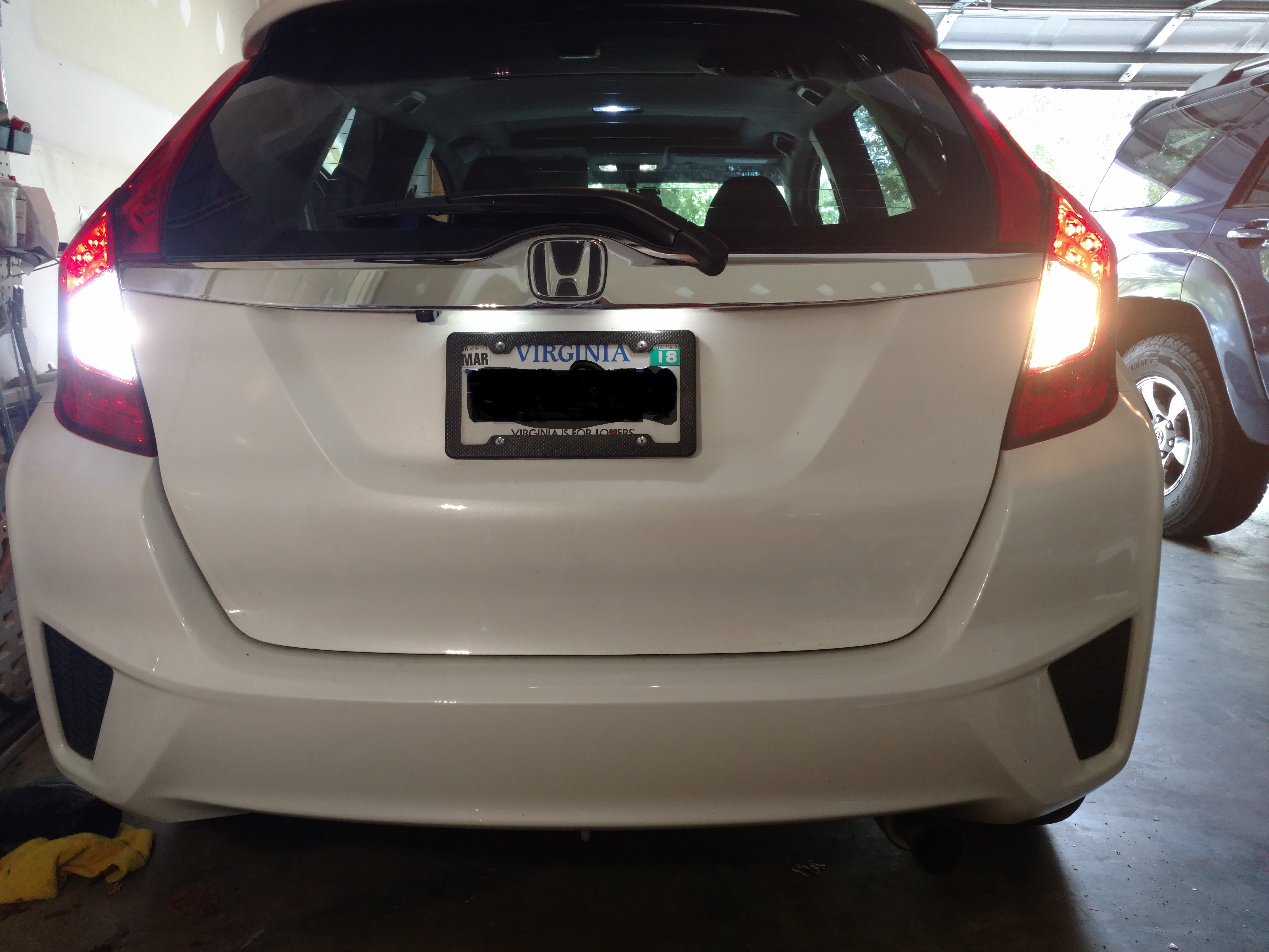

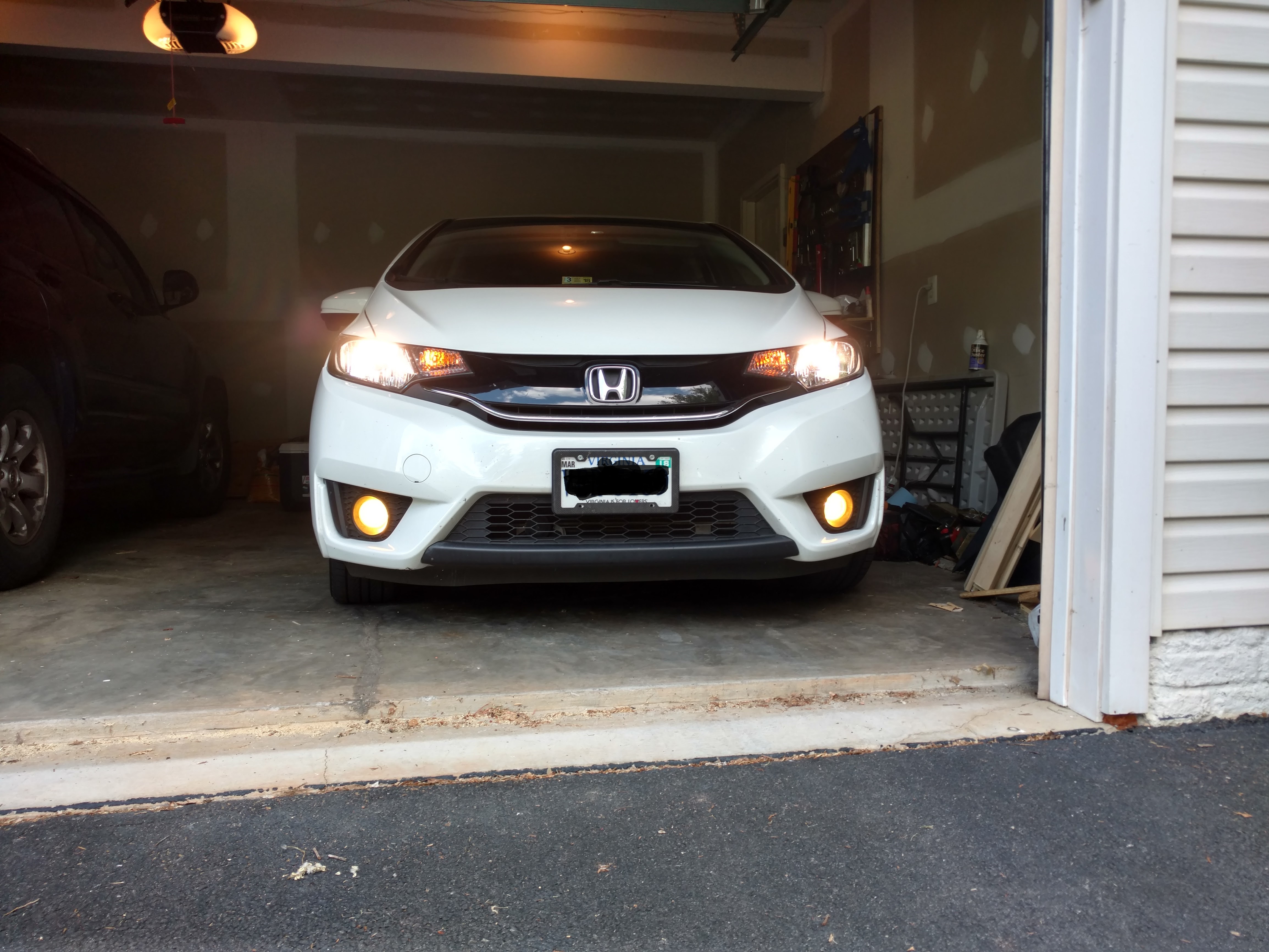

Finally got around to installing some lighting upgrades. My wife bought me NOKYA NOK7623 fog lights and Partsam 7440 LED backup lights for Father's day. I bought myself Some PIAA for my birthday.
The headlights are whiter than stock, but hard to capture in daylight picture. The fog lights are definitely yellower as well, just the look I wanted.
The backup LED is ridiculously white compared to stock bulb, and much brighter. They are supposed to be the same bulb size as the turn signals, but I tried them out and they don't stay in the socket. Just an FYI if someone is looking to try it out.

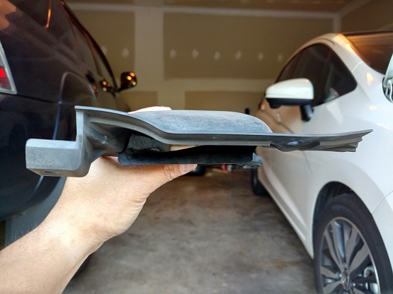

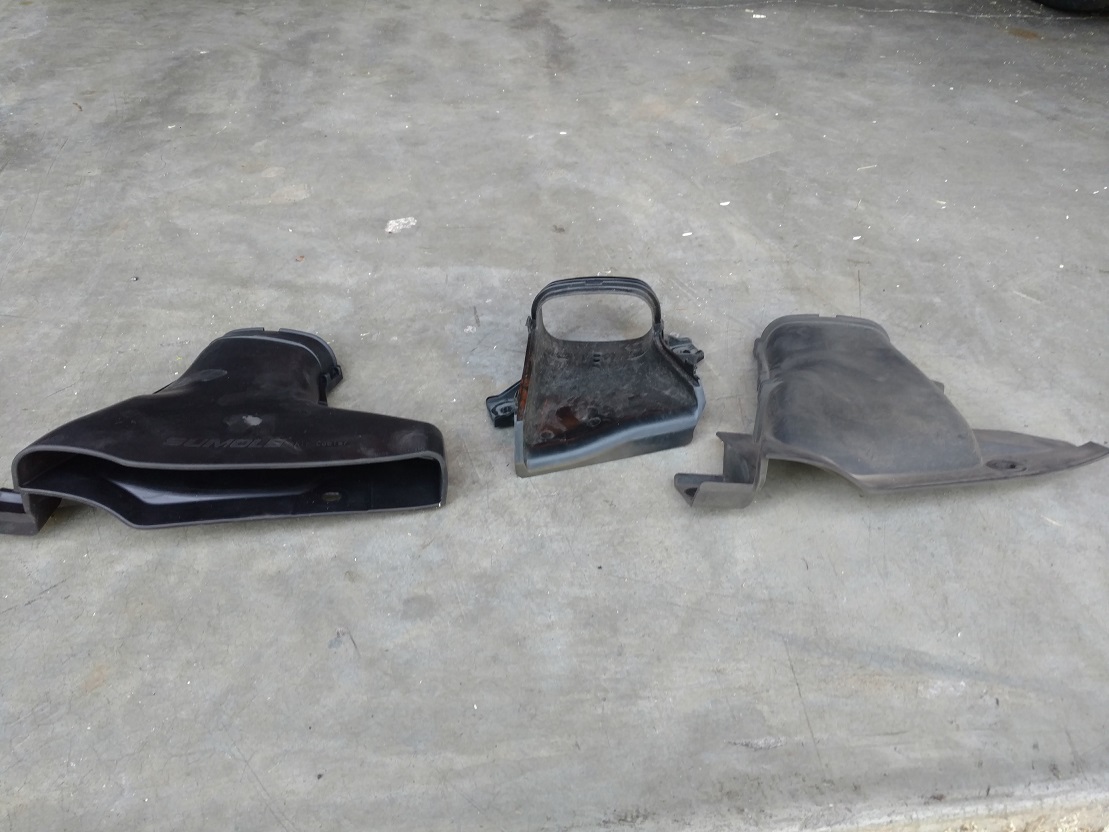

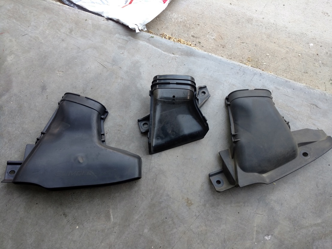

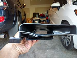

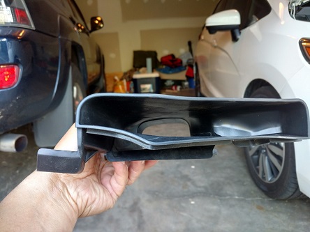

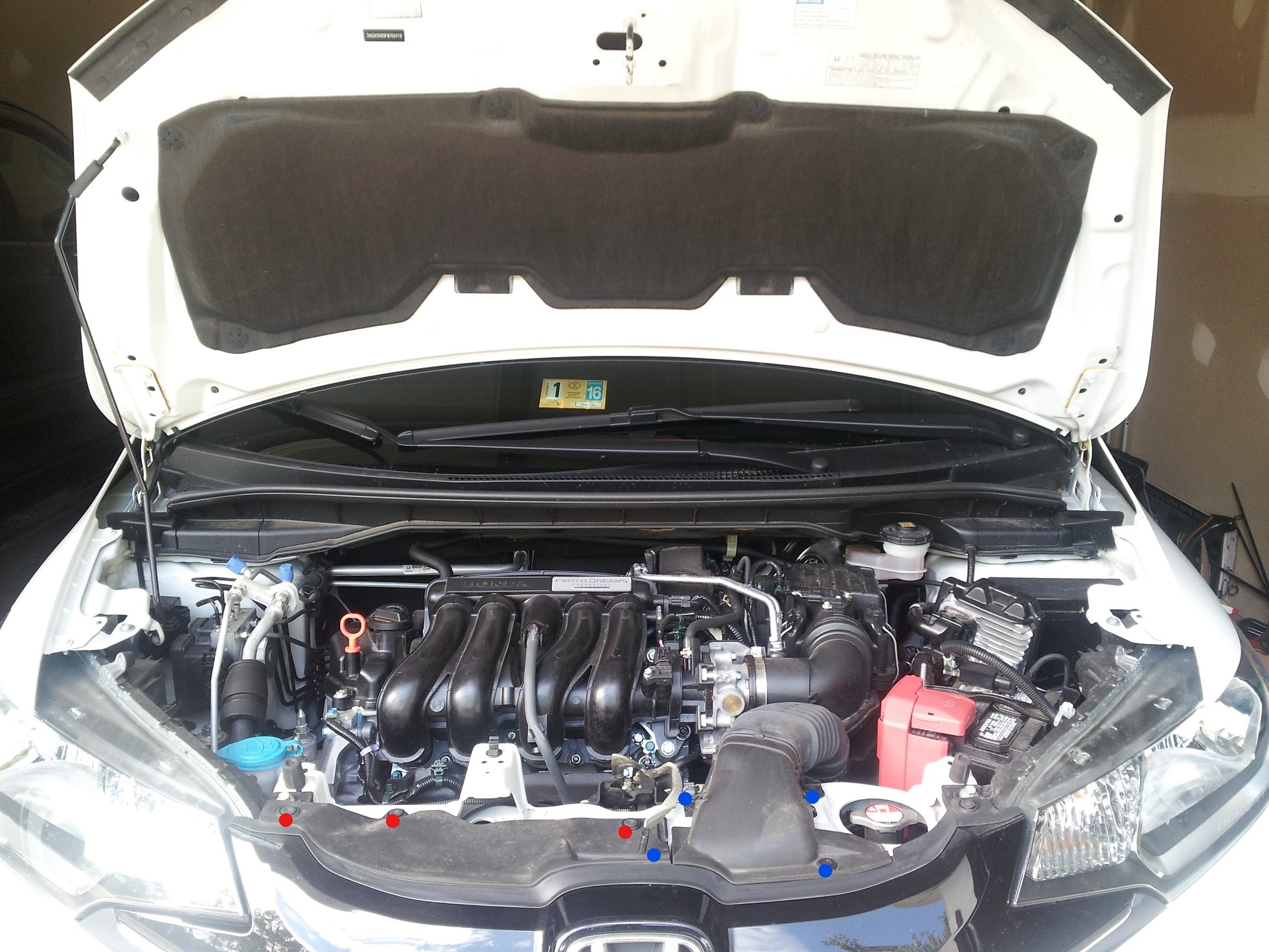

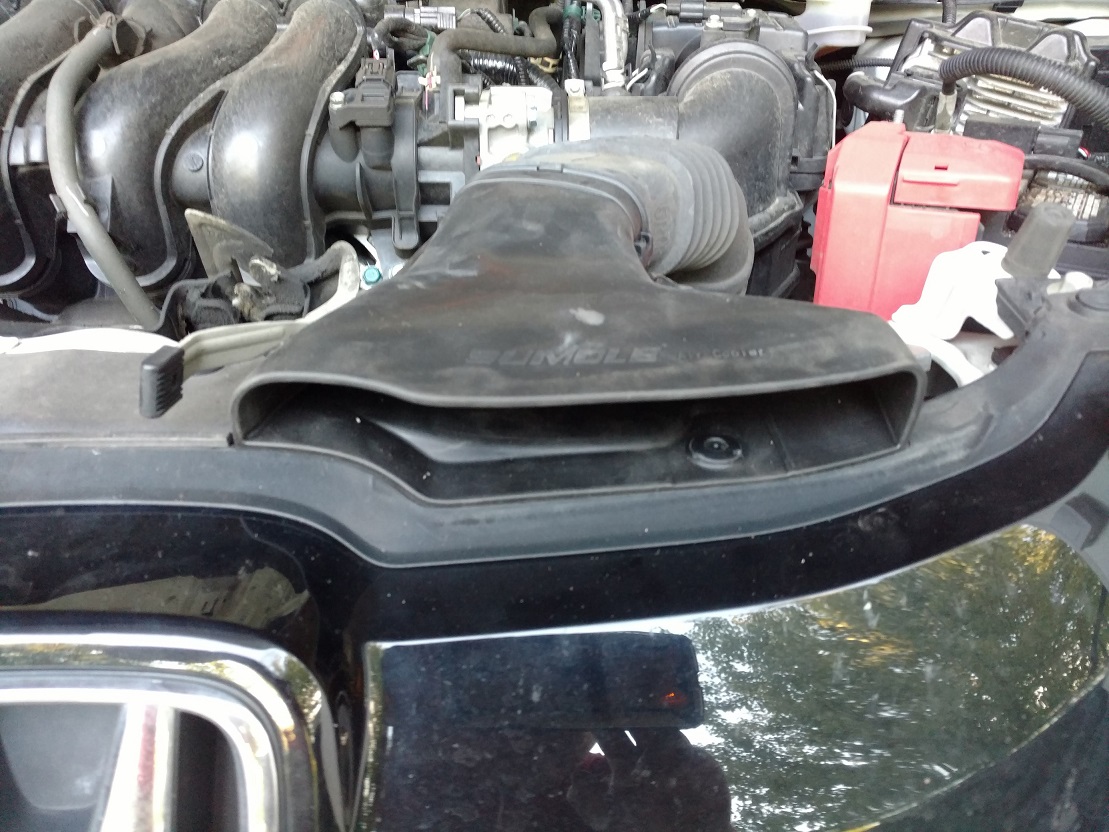

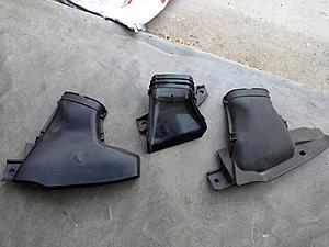

I installed a Ram Intake I got from TougeMonster_GK5. He's got a group buy if anyone is interested in it: https://www.fitfreak.net/forums/gaug...ml#post1378274
More info and pics here: https://www.fitfreak.net/forums/3rd-...air-scoop.html
Uninstall the intake by first removing the red plastic push pins and then the grill cover. Remove the blue push pins . One of the blue push pins is hidden until you remove the grill cover held down by the red push pins. You'll be reusing all the plastic push pins so don't lose them.
Once the blue and red push pins are off, you can just remove the stock intake by pulling it off the snorkel piece. Then you can separate the stock intake from the duct assembly. It's held on by 4 little plastic tabs. Install the new ram intake scoop by pushing it in place and making sure it's held in by the plastic tabs.
Stock intake:
Ram air intake scoop
Ram air intake scoop installed
I forgot to take a picture of it, but there is a piece of weatherstripping that can be removed on the right side of the hood. Otherwise the scoop gets pushed down a little bit. The weatherstripping is held by 3 push pins. Here is a picture of the hood closed with the new intake scoop and no weatherstripping.
Instead of leaving off the weatherstripping, I decided to modify it and cut is as such. It took a few tries at cutting and fitting to get it to sit just right. I'll clean it up but this was test fitment. This allows the ram intake scoop to be installed with the weatherstripping utilized. I'm assuming the weatherstripping serves a purpose so I'd rather have it on there.
Here's how it looks with the modified weatherstripping and the hood closed.
Initial impressions are the intake scoop fits really well. I wish it had some better molding as you can see where a piece was trimmed off at the top. It's more flexible than I thought it would be, but so is the stock intake. The intake noise is louder than stock. I had my wife rev the engine and I held a napkin at the front of the intake. The napkin was sucked into it! So there is definitely some air movement.
Unfortunately I haven't had a chance to drive it. Right after install my 15 month old decided to get fussy and wanted to be put to bed. So I'll report back after driving it for a while. Luckily I just got gas so I'll be able to compare the mileage after a full tank soon. I currently have a K&N in there so maybe with the two it'll get better gas mileage and throttle response. I'll report back with my findings...
Oh and sorry about the dirty car pictures, but we've been getting a ton of rain lately and I haven't had the time to clean up the car. And did I mention the fussy 15 month old? lol
