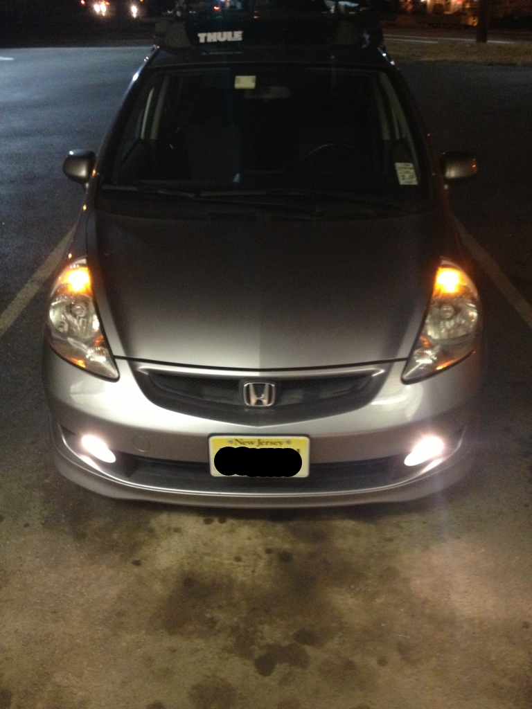

Great tutorial, very easy to follow and a simple project.
The wire you need to cut is on the top of the clip, the second one in from the left. The photo has a little of questioning to follow, but makes sense if you read carefully!
just make sure you grab the right 10 amp fuses! I grabbed ones that were a little bigger. same price, just an extra trip to auto zone.
Thank you!
