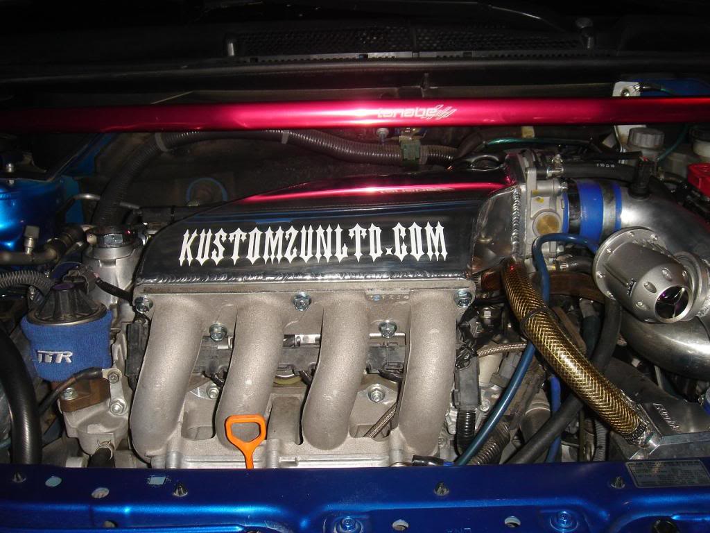

Here she is

Old Mar 26, 2009 | 12:14 AM
  #353
dewthedew's Avatar
iTrader: (9)
Posts: 4,055
From: HollyHOOD, fl
that is sick!!! how much would it cost to order one?
Old Mar 26, 2009 | 02:34 AM
  #354
explosivpotato's Avatar
Posts: 548
From: Flint, MI
Wow that's a sweet manifold!
I'd scrub that logo off though, its fugly IMO.
Old Mar 26, 2009 | 02:39 AM
  #355
kelsodeez's Avatar
UNBANABLE
Posts: 4,548
From: Af-BAN-istan
damn!!@@@ i want it!!! soooo much better looking than the weapon r one.
Old Mar 26, 2009 | 03:29 AM
  #356
quangalang's Avatar
Joined: Jul 2006
Posts: 667
From: california
nice intake plenum
Old Mar 26, 2009 | 12:13 PM
  #357
bluerice's Avatar
Posts: 179
From: Edmonton
Originally Posted by BlueCell
Here she is
Do you have any other photos taken from different angles of this thing.
Old Mar 26, 2009 | 01:32 PM
  #358
BlueCell's Avatar
Posts: 2,847
From: Yeehaw!
I made a new thread so I don't jack up this one too much hehe.
https://www.fitfreak.net/forums/fit-...tml#post615337
