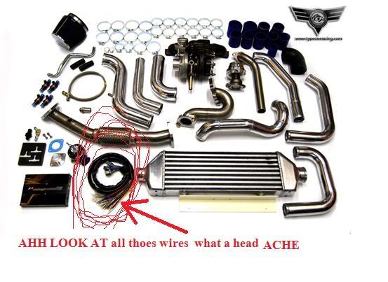

t1r if you will, but have fun spending about 3 hours cutting and splicing and soldering and crimping and and and well just Fing up the cars wiring harness.

LoL, not me - i hardly had the tools to install my mugen visors... DEEEEYYYYYAAAAAAUUUUUUMMMMMMMMMMMM, look at all demz wierz yo!!!
i'm going to have to bite the bullet and pay a shop to do it for me . my gf's dad knows the right people, i'm hoping he can pull some strings and get me some sort of labor or tuning discount

It's actually not that bad.. I know it looks like a rats nest of wires, but supposedly all the wires are labelled as to where they are to go.
I guess for me its not an issue since I am MECP certified.
an hour of wire harness install for an extra 40hp/40ft lbs to the wheels @ 6psi is well worth my time. lol.
But ya, I can understand that to the average joe the wiring can look very overwhelming. If you question your skills, take it in to have it all professionally installed.... OR just get the HKS kit.. its a solid kit, easier to install, and an efficient and CARB legal kit.
Don't forget, you can still upgrade the HKS kit with the necessary parts to get it to a higher boost level.. it just takes mo money.. and in the end it can cost maybe the same as the T1R kit.
