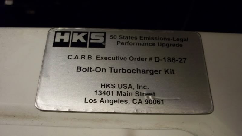

hey josh, you got a pic of your carb sticker??

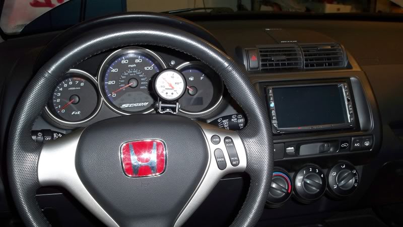

here it is, and i thought i would sneak in a pic of my new boost gauge

nice! thanks dude. i am going to pm you in like two seconds.

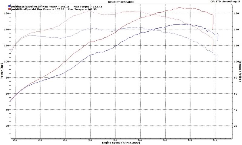

ok here it is my new graph
boost= 8lbs
AFR=11.4:1
ambient temp=94F

Nice numbers dude. Any dyno videos?
Curious at what % duty cycle are your 310cc injectors at right now?
