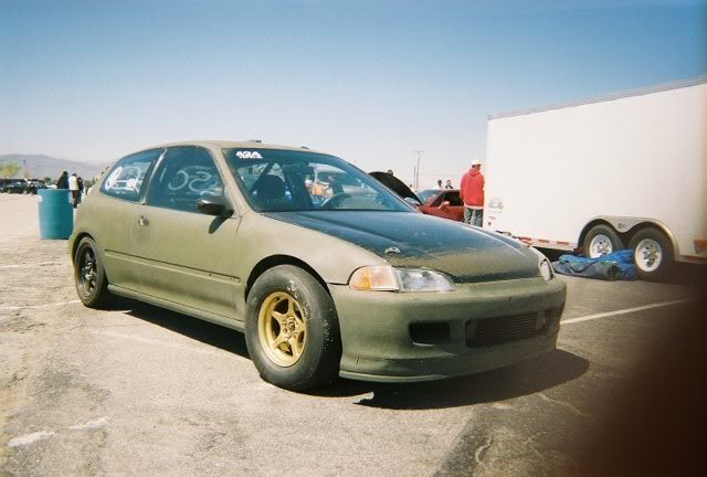

The old set-up ran 481whp & ran 10.7 at 135mph. I'm sure some are very familiar w/ the car. It was the old full race "pinks" civic. My friend won that car from that race & I took it off his hands. That pushed 460whp & we re-tweaked it & got a few more ponies out of it. For more info on the "pinks" car here you go: Full-Race "Pinks" SOHC Drag Civic
I def. understand there is a huge difference from 10.7 to 9.9. I know one person that achieved into the 9's on a SOHC in 2008. He was pushing I believe close to 600whp on his SOHC w/ a gt35r. He was running in HOTROD class. Keep in mind I put the interior back in the car to run street class.

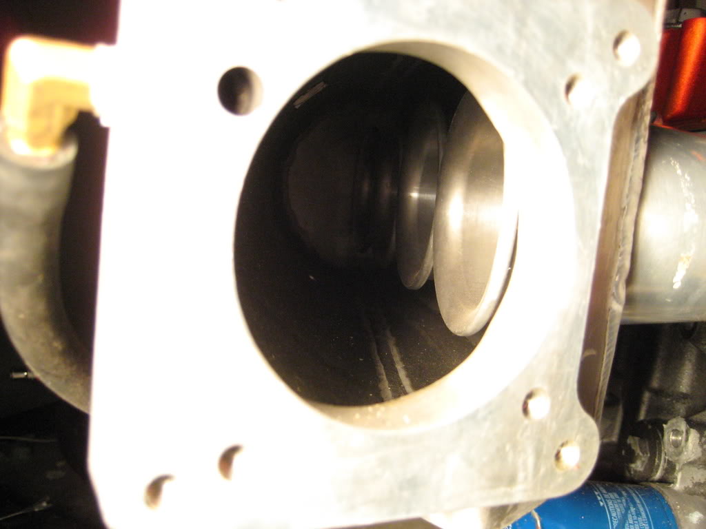

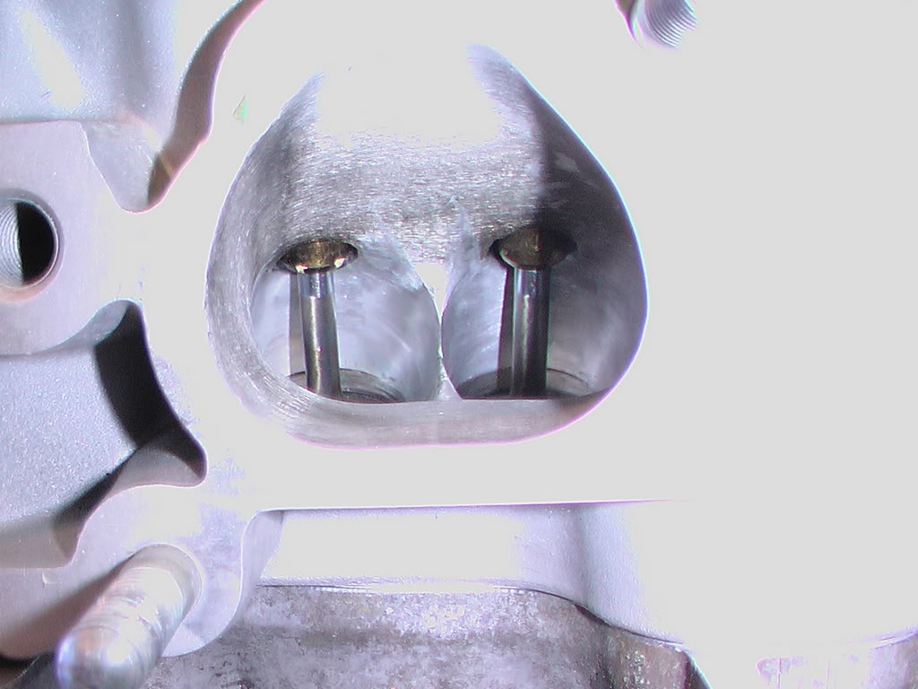

Here are some pics of the new engine set-up & car. This is all I could find due to computers crash & losing a lot of pics:

Some basics to the build:
Block:
- AEBS close deck sleeves
- Pauter rods
- CP 10.5:1 pistons
- ARP head studs & bolts
Head:
- All Ferrera valve train
- Crower custom turbo cam
- Skunk2 cam gear
- More head work done on top of everything full race did
Intake manifold:
- Full Race custom
Turbo manifold:
- Speed Machine custom top mount w/ t4 flange & dual waste gates
Turbo:
- Garrett GT42R
I can go on & on but this gives you an idea of what was going on. As I started this project in late 2007 into 2008 around March 2008 some had hit the 700+ who on a D16. I believe it was like 721whp & there was more room he said.
