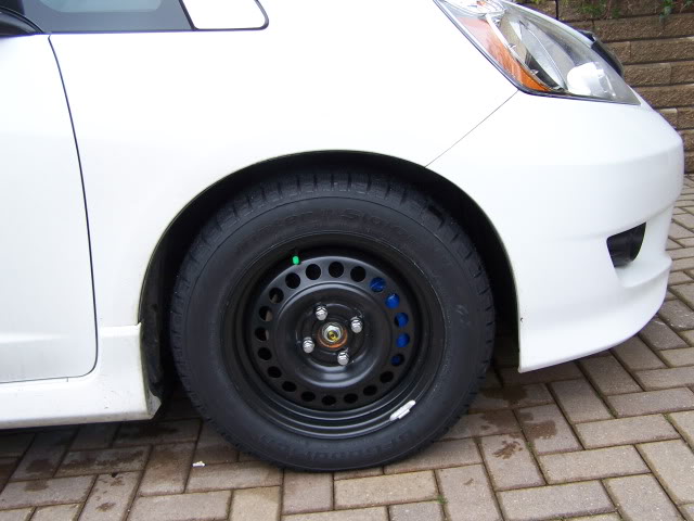

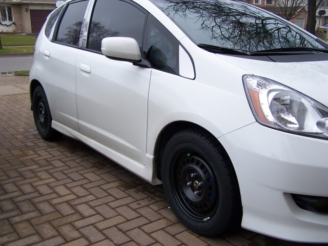

I just had my BFG 185/65R/15 put on. Can anyone tell me how much my speedo will be off if any?
Oh why did they put those green valve caps on? I must get center caps or cheap hub caps.
Wow quite the dif in the ride. Much softer.

I learnt something today. Green is Nitro. Will I go faster? Thanks awptickese
Pics just added. Talk about clashing. Green, blue, silver and black and a bit of rust in center. I may look for some cheap hub caps.
