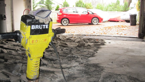

Old Nov 19, 2009 | 11:04 PM

Great pic... nice view/shot.

heavy duty foundation for a car lift? lol would be cool.
Originally Posted by DZeckhausen
I won't be doing this mod any time soon. Just started construction on my "dream garage" and the cars are sleeping outside for now.
Old Nov 22, 2009 | 11:15 AM
  #110
DZeckhausen's Avatar
Posts: 56
From: Fairfield, NJ
I considered a lift, but I want to be able to park the car in the middle of the garage at an angle, so I can have lots of access for washing/detailing as well as the occasional brake installation. A lift just takes up too much space. And even with the lowered floor, I still won't have much headroom. Since the living room is directly above the garage, I can't blow out the ceiling (according to my wife)!
