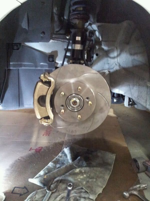

Old Mar 31, 2012 | 02:30 AM
  #213
ohanahuichubbz's Avatar
Posts: 327
From: alhambra, monterey park, CA
here is my type r front brake upgrade...
while these are waiting to be put on...
Old Mar 31, 2012 | 04:07 AM
  #214
Jodele's Avatar
Posts: 590
From: Cincinnati, OH
Cool...tell us a bit more...ie 5-bolt installation with the ATR front BBK. Did you replace the front hubs?
