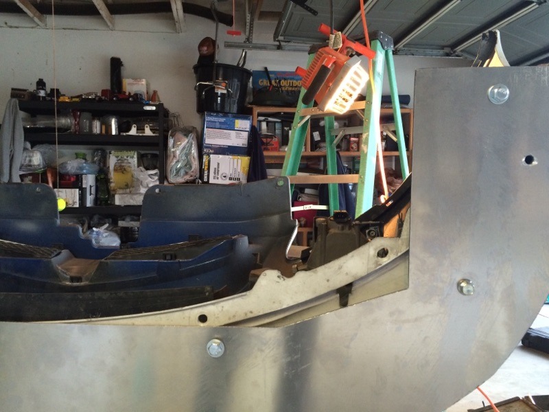

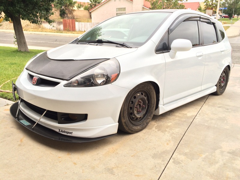

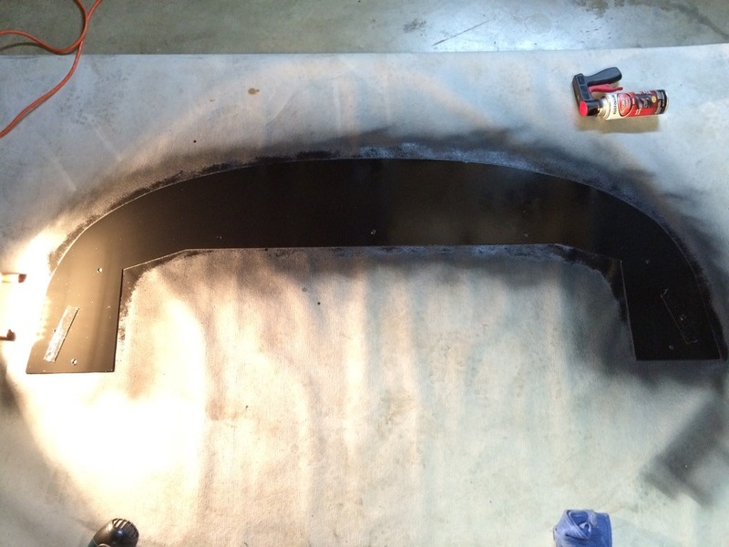

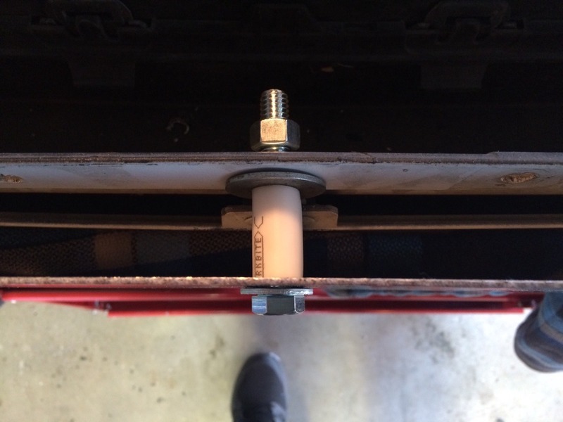

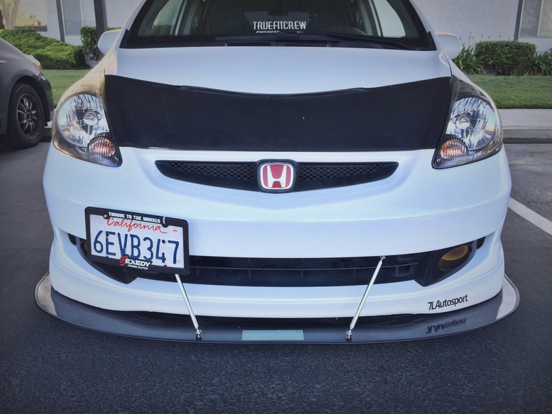

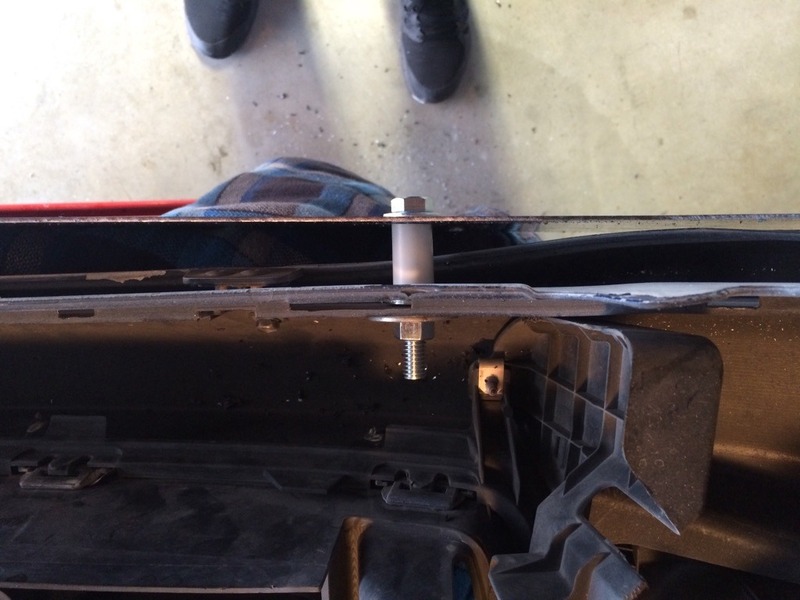

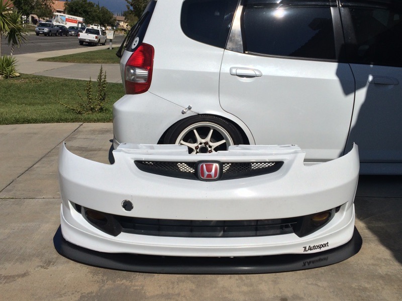

Originally Posted by Alvarooo90
Front splitter w/supports installed
Mounted
Panted
No supports
Final
Dude, that is killer, that is the look I wanted since I added the flares on my ride. Can you tell me how you made yours?

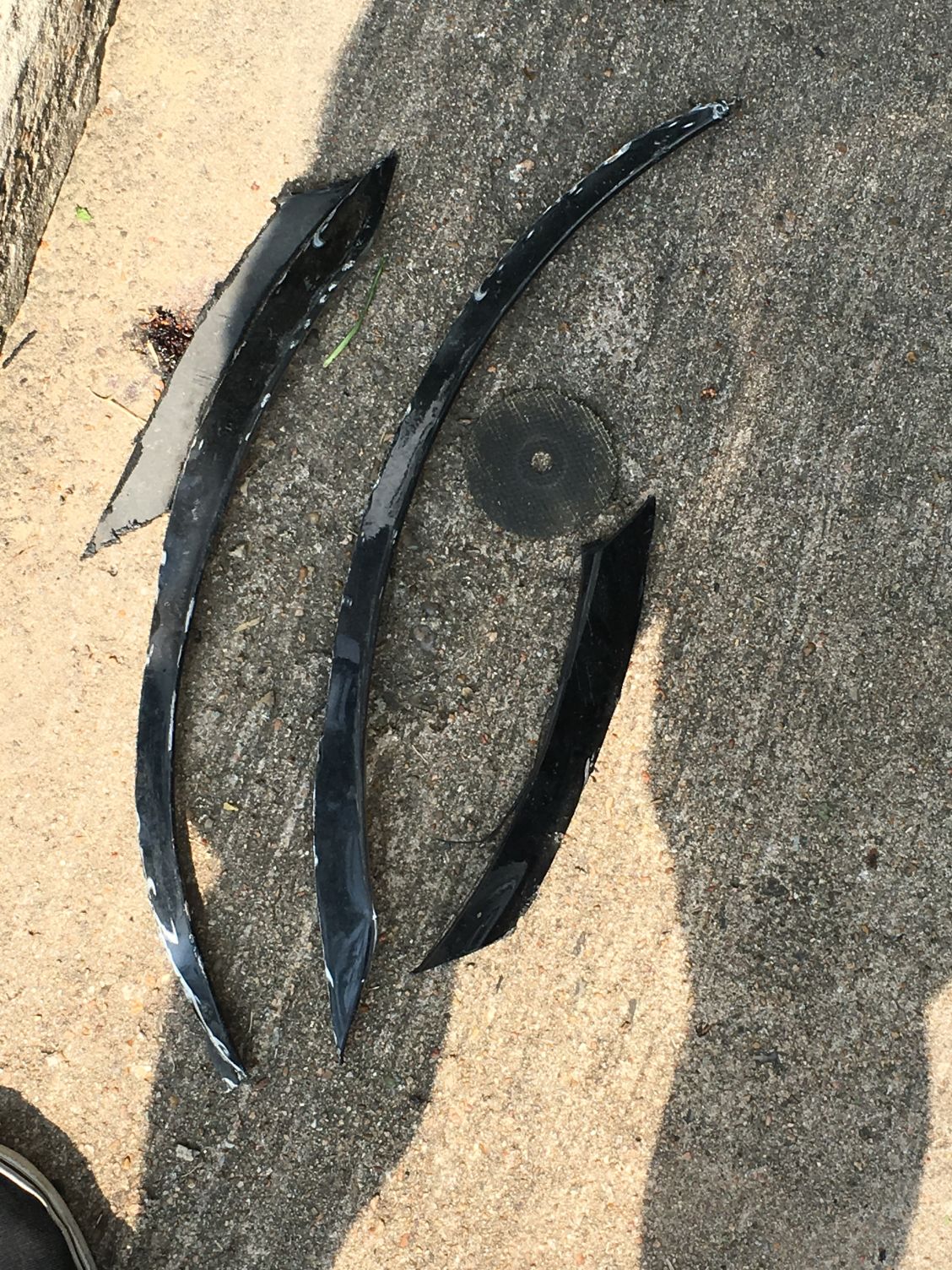

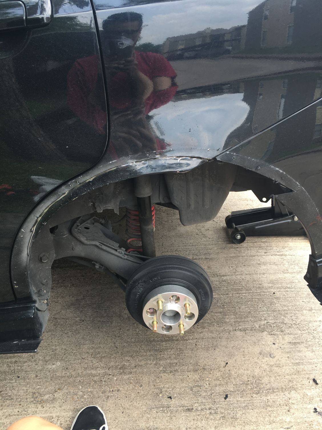

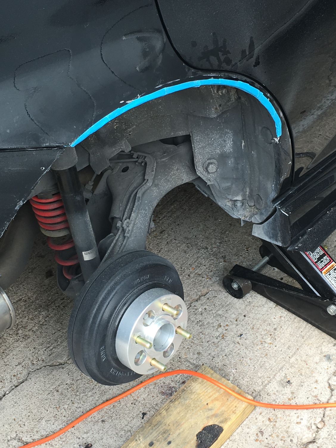

Cut both rear metal fenders today. Rubbing has stopped a lot. No more rubbing on bumps ever 2 seconds heheh tape is temporarily covering the fenders until I have someone weld it back together. Do I still have rubbing issues? Very minimal. Well finish the front fenders Monday and start working on them door dings, I got plenty of those. Looking forward to making me a front and probably a rear splitter. I like the voltex rear diffuser made for the wrx but I don't know.
Thanks man a dude here in Fresno Ca made it. Do you have a Facebook? I could get you his info and I want to ask you about your side skirts cause those are killer as well

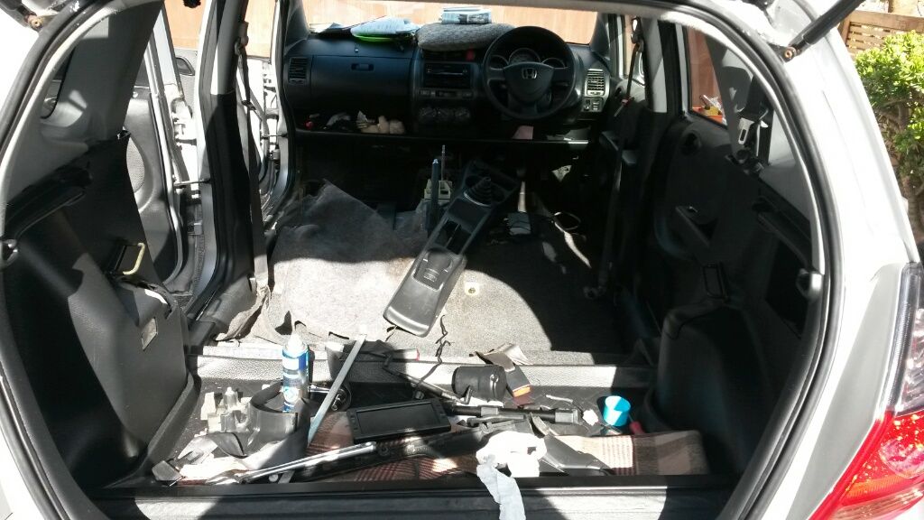

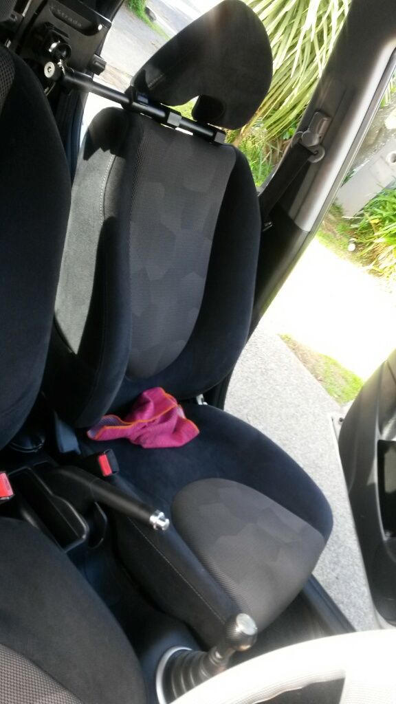

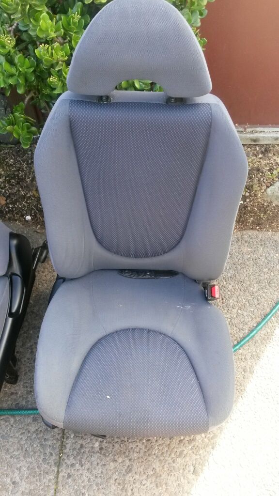

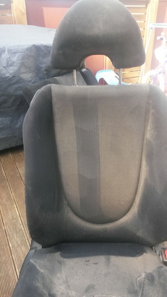

All done. Super stoked
Originally Posted by JRHPNG
Looks like cleaning shouldn't be too hard.. That's one pass with the vacuum. Have just finished wet cleaning them so will see how they look in the morning.
Looking roomy!
Old seats
All done
Please take pictures when you do your door dings and finish the arches. I'm curious to see what the fenders look like when you're done.

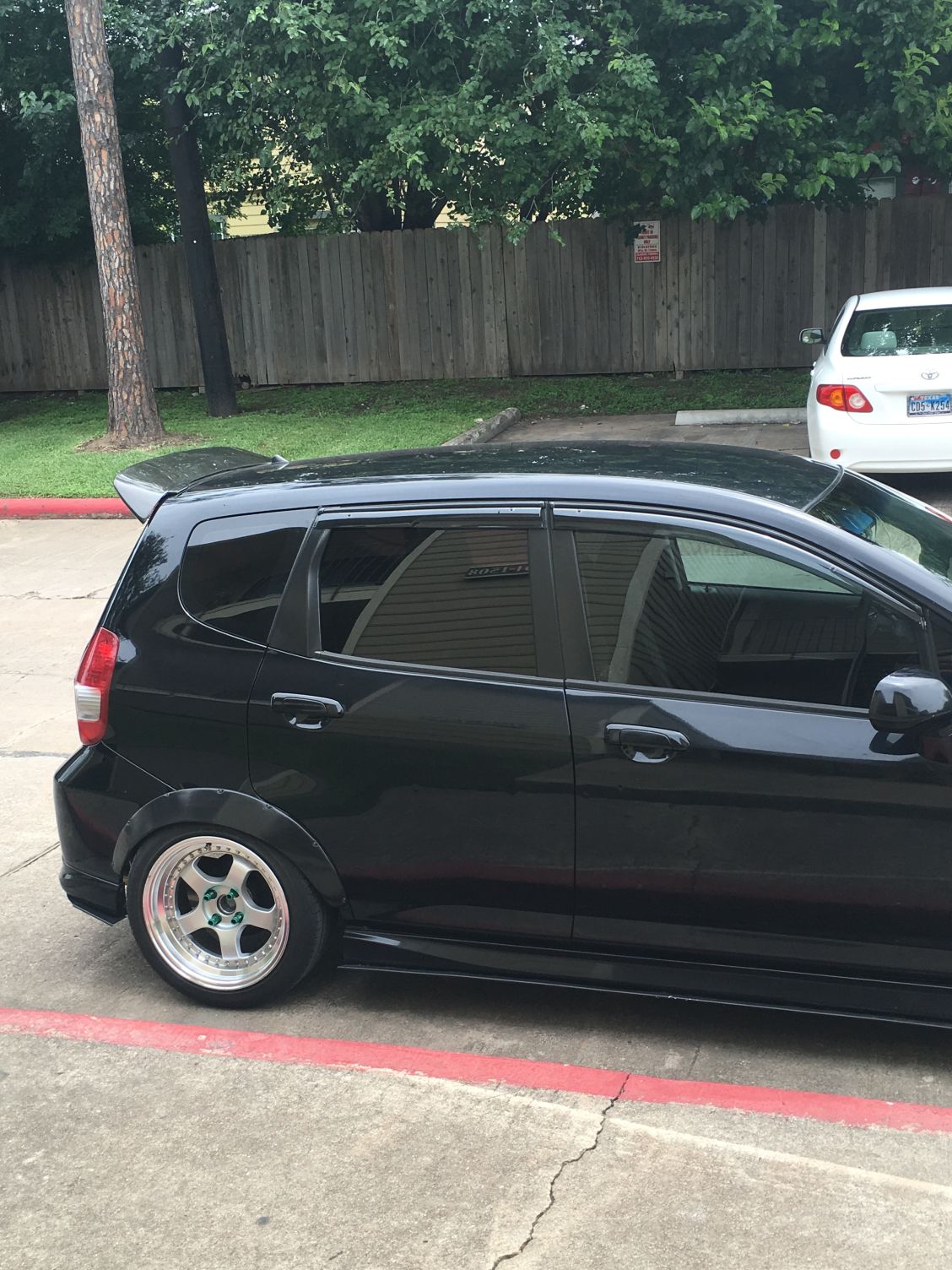

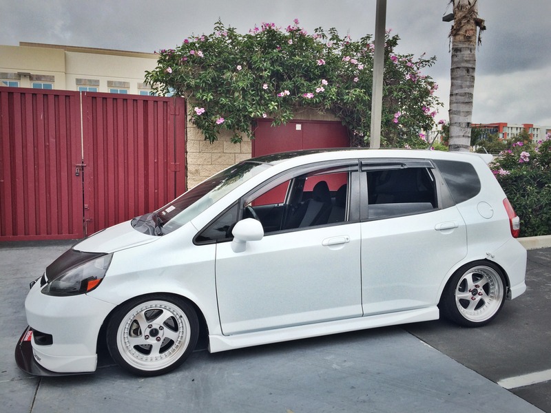

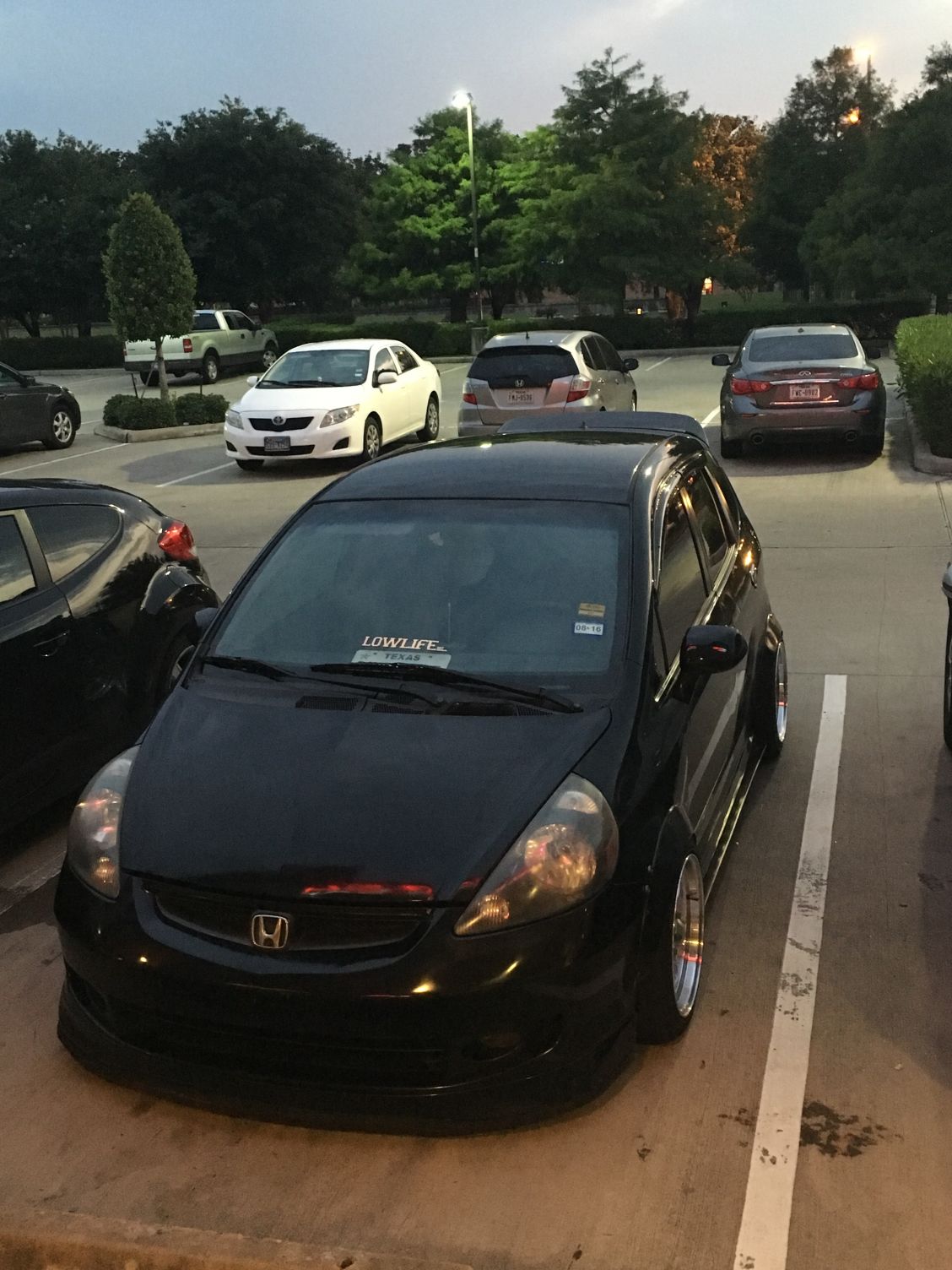

Door dings aren't done but this is what they look like.
Riding 16x8 +10 offset, 205/45/16 tires. Thinking of 195/40/16 tires when I'm due. 56.1 hub centric 1.25 wheel spacers, 28" length/ 2.35 width fender flares. Cutting is required to fenders and fender flares to have everything fit properly. Plus, depending on ride height, I would not go lower then 1.8 to 2 inches front and 1.5 in the rear to avoid constant rubbing. I'm on tanabe DF210 1.8 front / 1.5 rear. Probably sagged and settled around 2.0 front / 1.6 or 1.7-8 rear. Honestly I love the look now. �� would love it more after I can make that front splitter like the other guy but if I do, I will leave mines a tad wider kinda go with the wider stance of the tires. Probably work on it soon hopefully heheh

Thanks, nice. What'd you do to inhibit rust on the cut edges? POR-15 or something?

Riding 16x8 +10 offset, 205/45/16 tires. Thinking of 195/40/16 tires when I'm due. 56.1 hub centric 1.25 wheel spacers, 28" length/ 2.35 width fender flares. Cutting is required to fenders and fender flares to have everything fit properly. Plus, depending on ride height, I would not go lower then 1.8 to 2 inches front and 1.5 in the rear to avoid constant rubbing. I'm on tanabe DF210 1.8 front / 1.5 rear. Probably sagged and settled around 2.0 front / 1.6 or 1.7-8 rear. Honestly I love the look now. �� would love it more after I can make that front splitter like the other guy but if I do, I will leave mines a tad wider kinda go with the wider stance of the tires. Probably work on it soon hopefully heheh[/QUOTE]
Looks amazing man cant believe your only riding on springs that's awesome, do you have a facebook?

Never heard of por15 but thanks for the info, guess I'll apply some of that to prevent any rusting, if not, I'll think of something.

Ah, I didn't notice you live in Texas, no wonder you weren't thinking about rust. :P Even so, I'd hit the bare metal with something, anything (e.g. a can of Rustoleum) just so it's not bare metal. POR15 might be overkill for your climate.

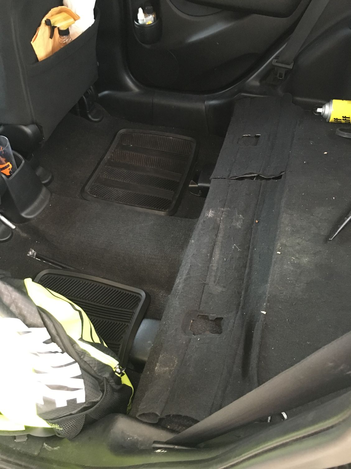

Removed rear seats, why.....because, no ones back there and plus, the vehicle, feels a lot lighter at the rear section now. Did this in the past with my 98 civic EX coupe and the seats in the civic did not weigh as much as the Fit does, wow.

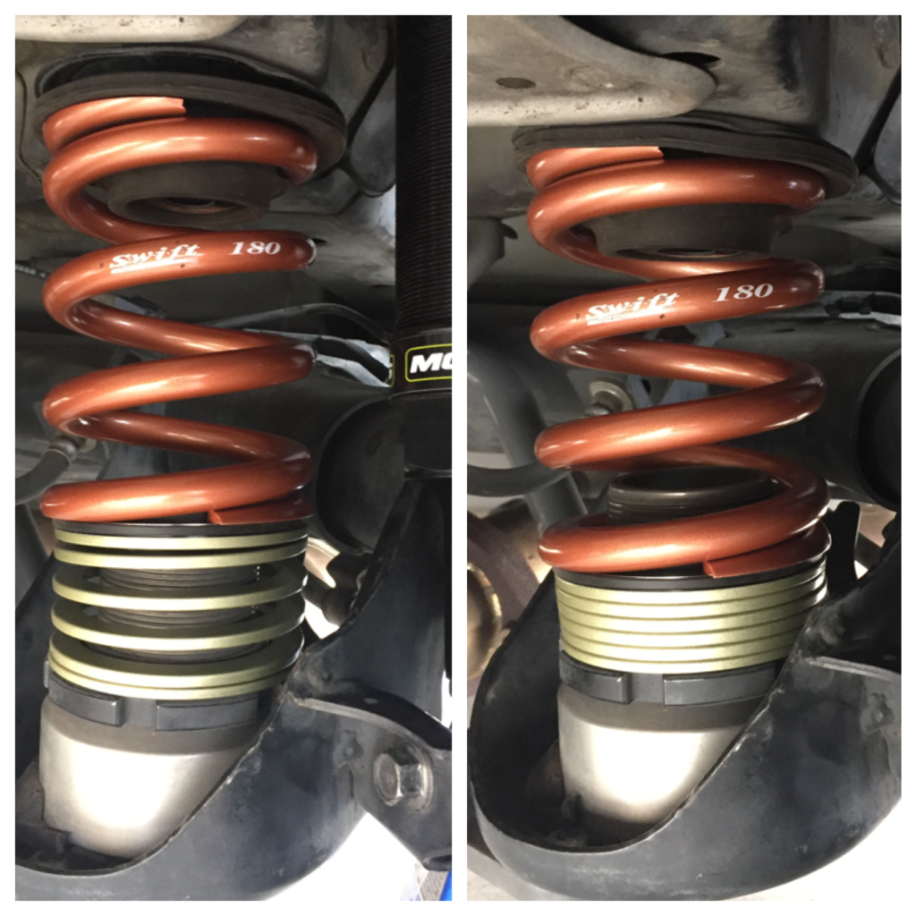

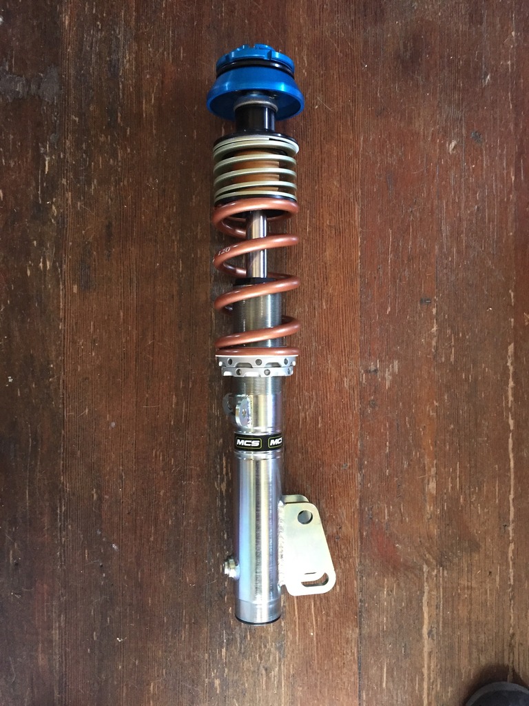

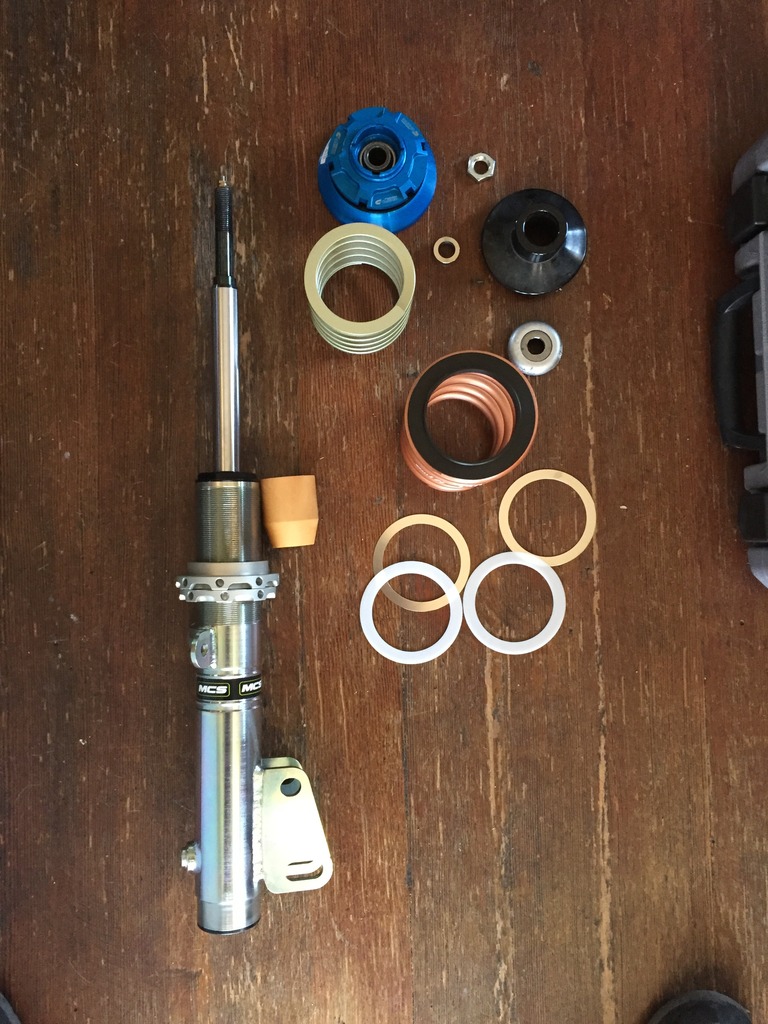

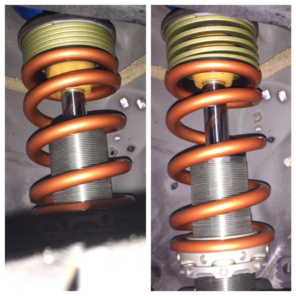

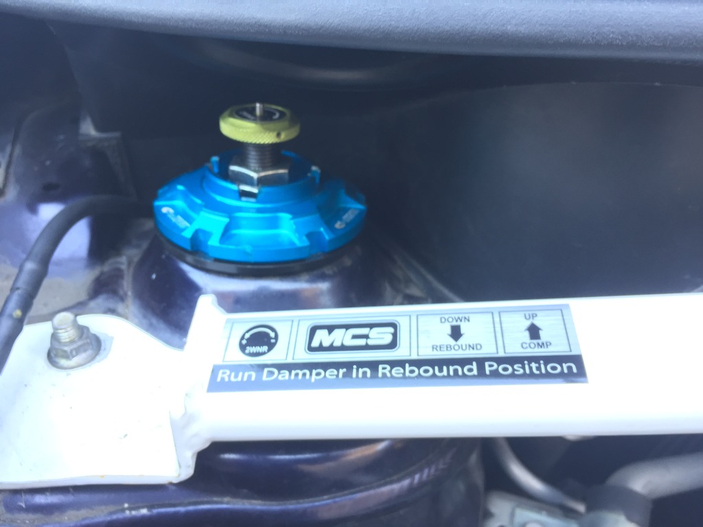

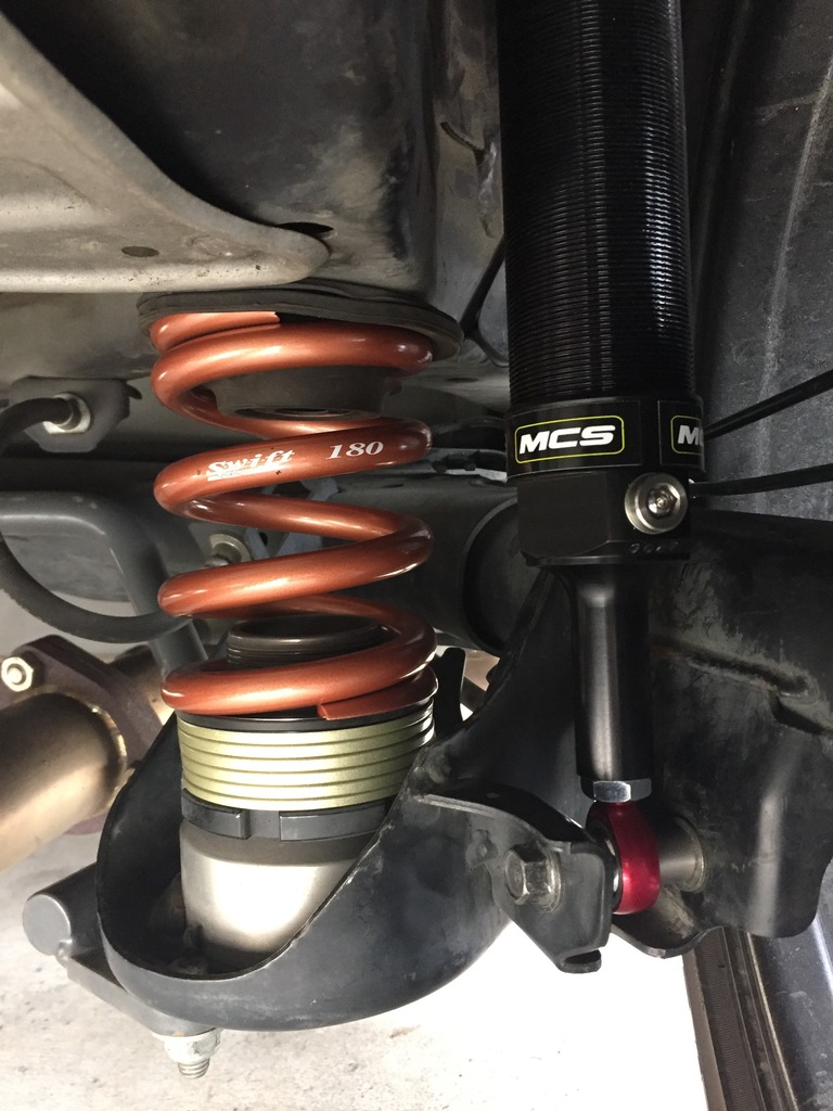

Finally got the new suspension installed the other day. Looking forward to racing on it this weekend.
- Motion Control Suspension 2 way non-remote
- Swift springs (reg and helper) F 12K, R 18K
- Cusco pillow ball mounts
- PSI bumpstops
- OE hardware custom tailor to fit
Here are a few photos of the suspension on the car and the springs compassed/full droop.

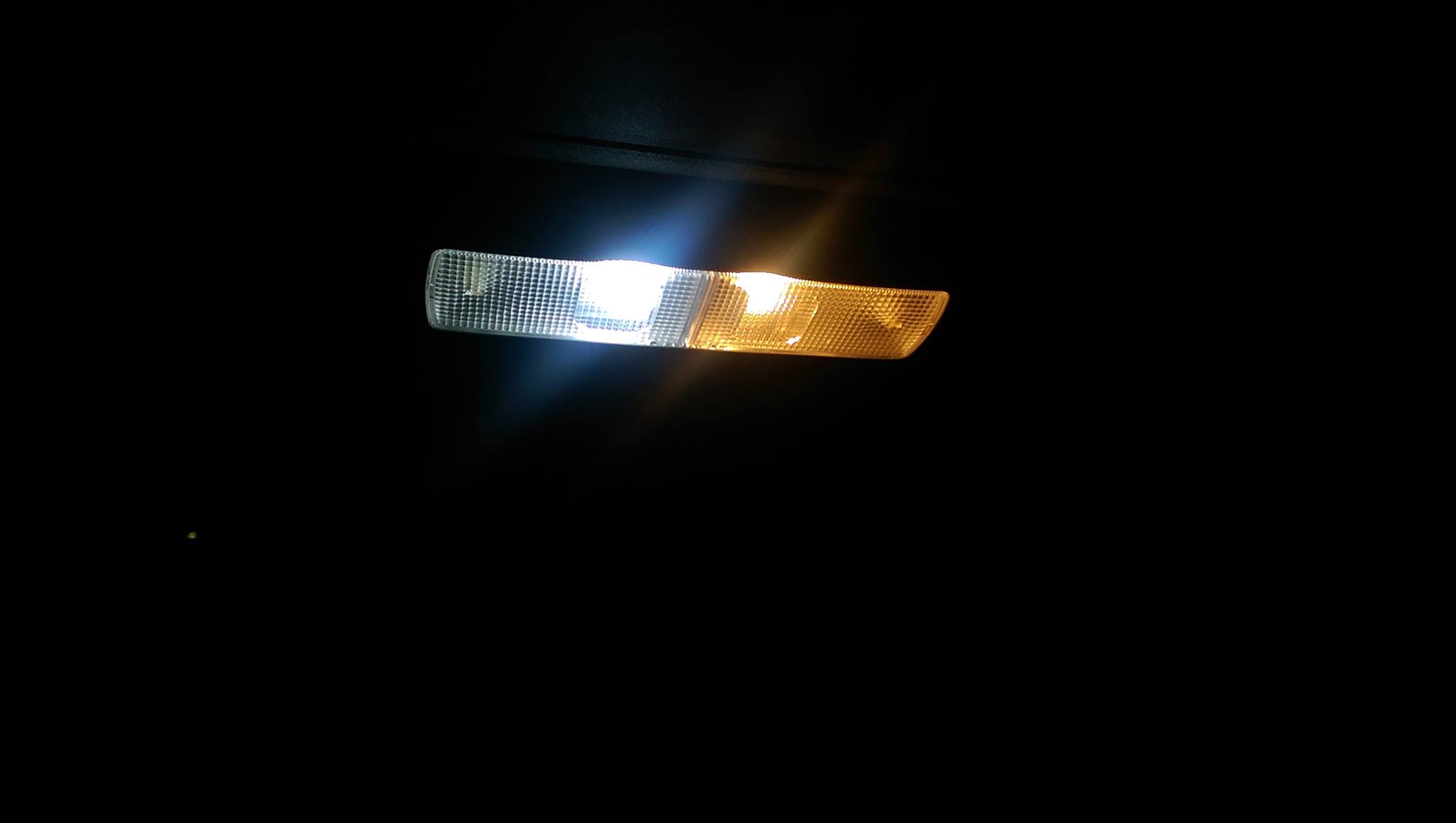

Found some free time this weekend and changed out the old bulbs in my map light to LEDs. I also did the same for my cargo light.
The difference is huge! It's almost too bright... but I'm glad I finally got around to doing it. Such a cheap mod but it goes a long way.
