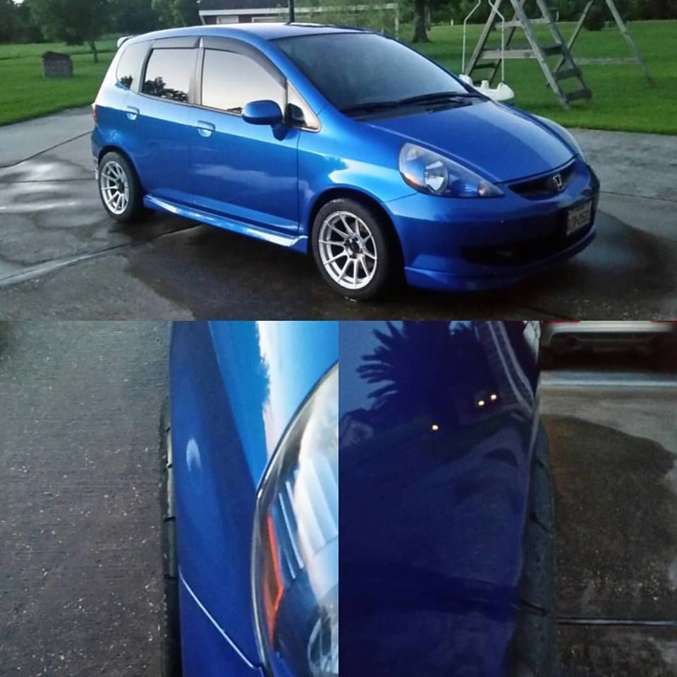

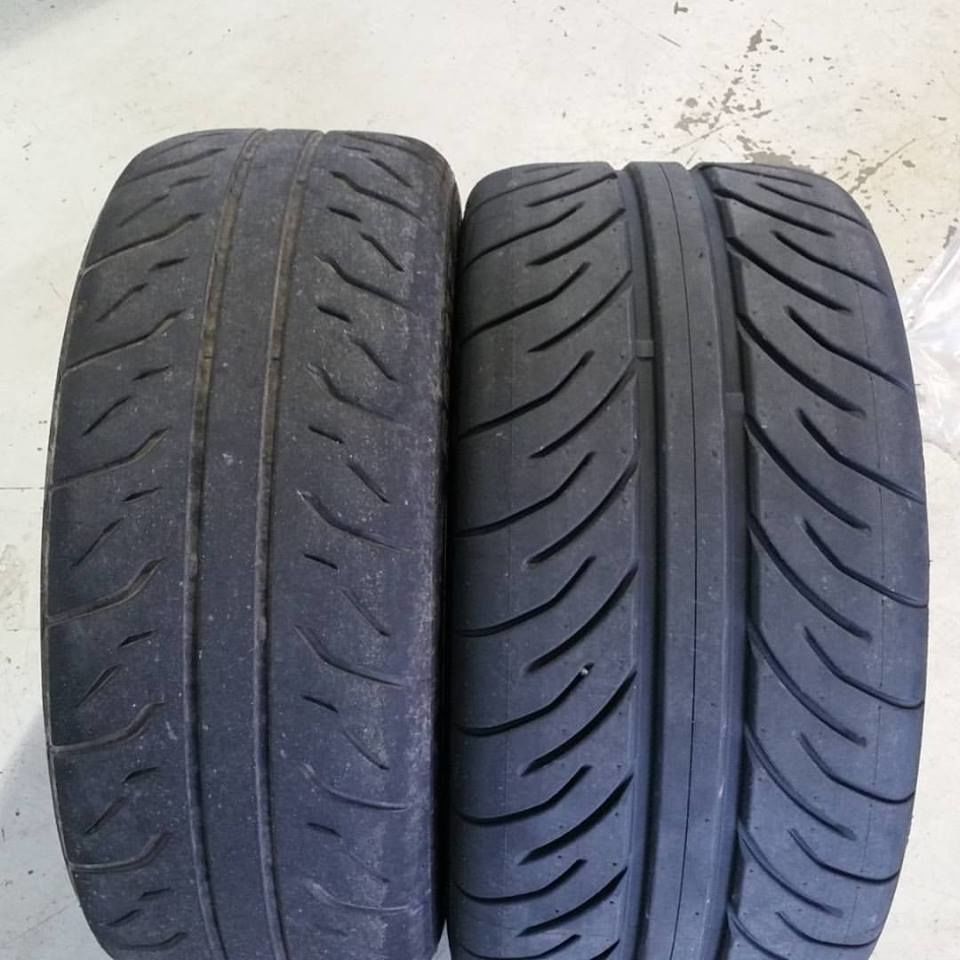

Old but new since I haven't updated in forever and a half. Been streeting my new autocross wheelset for about a month now. 15x9 Advanti Storm S1s and 245/40R15 Maxxis Victra VR-1s... Minimal rubbing with a 3mm spacer thanks to my spring rate.
205/50R15 vs 245/40R15

killer... those tires have the miata crew all worked up...
how do you like them?

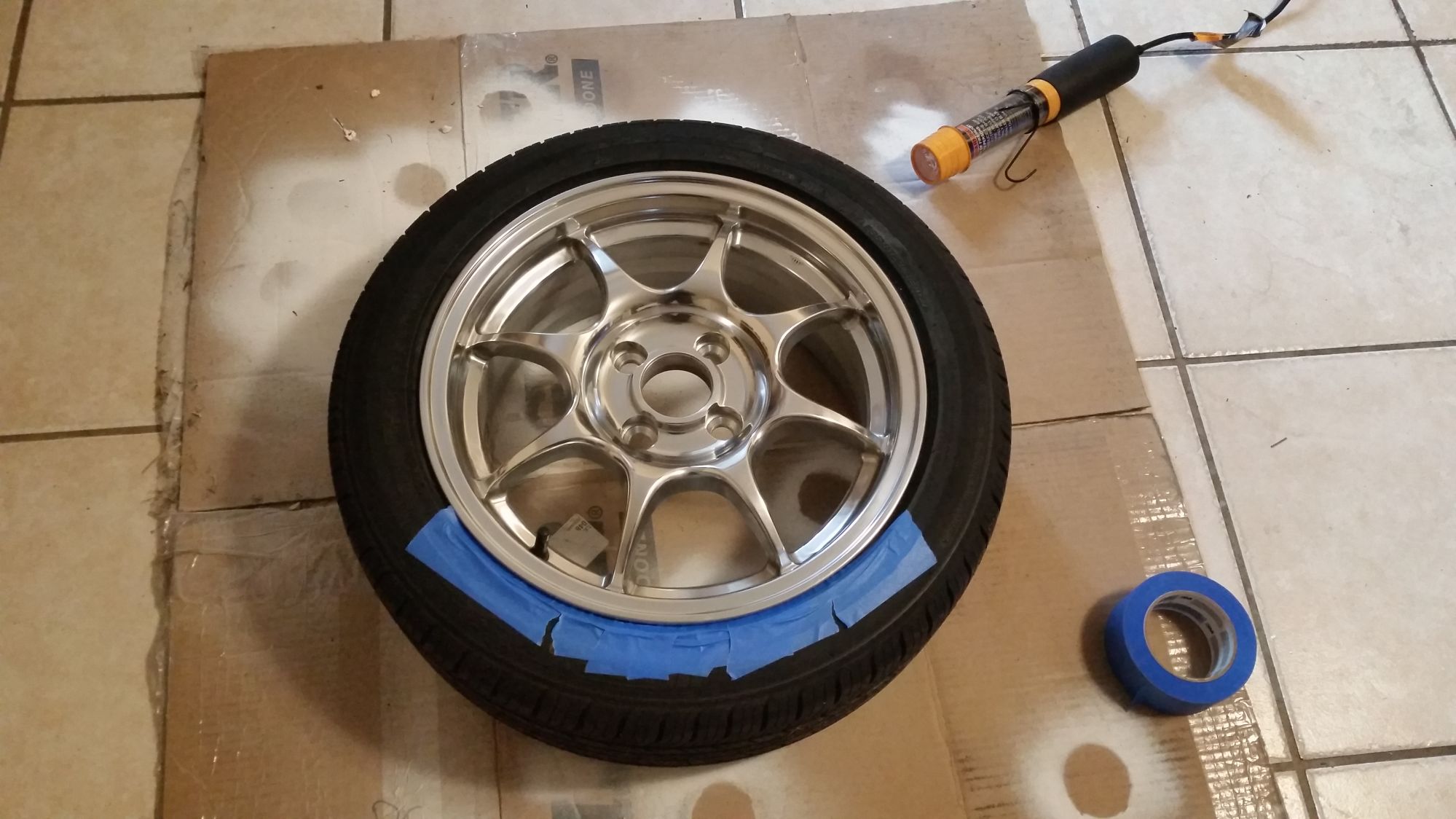

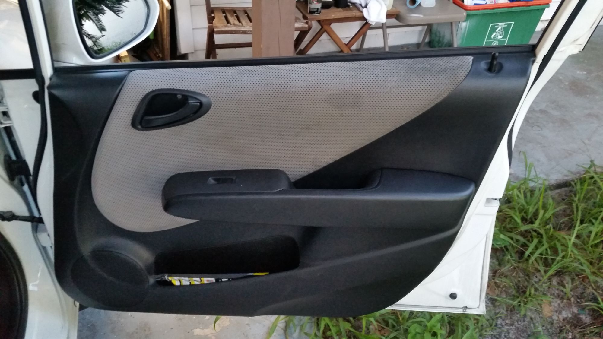

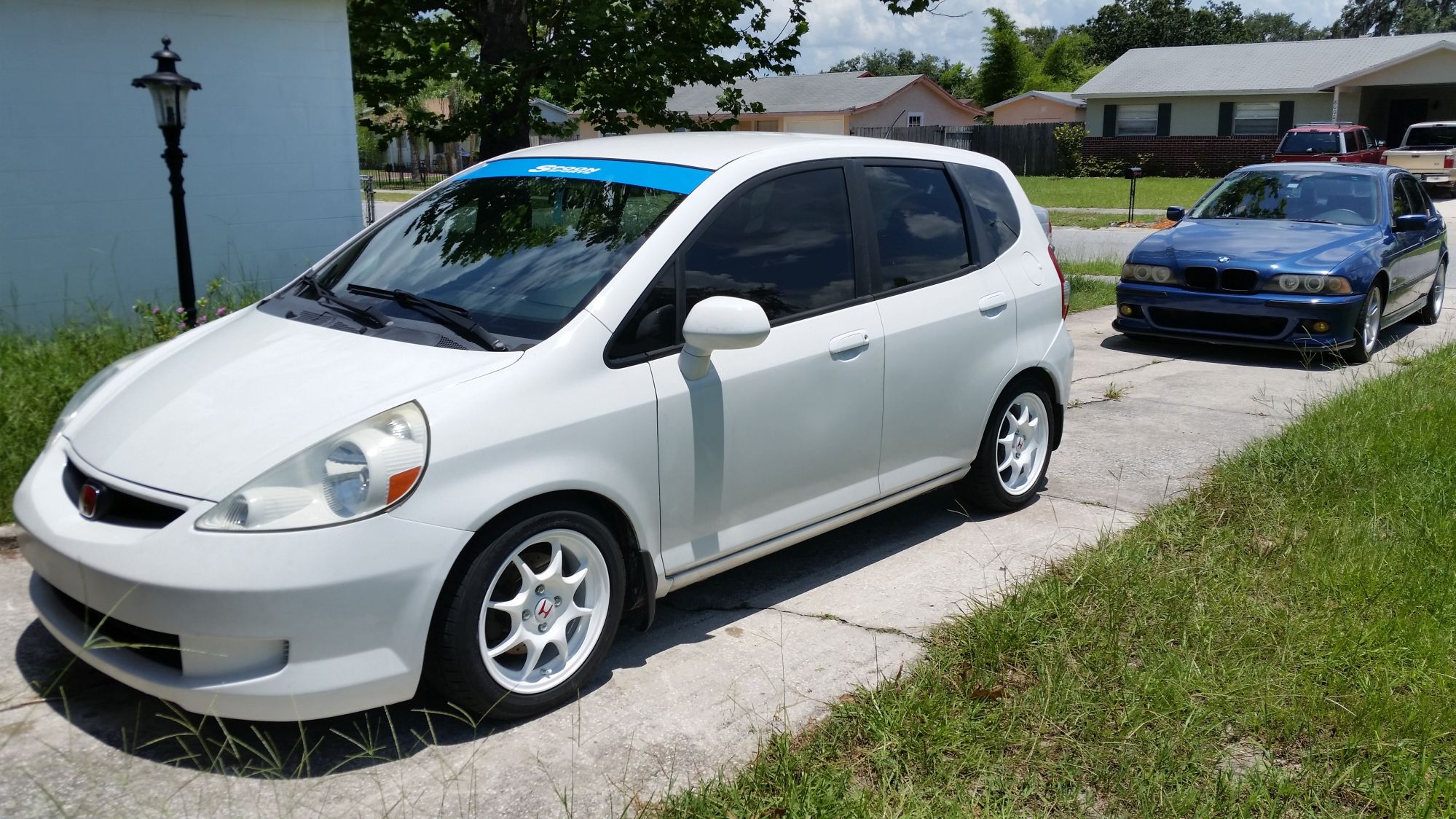

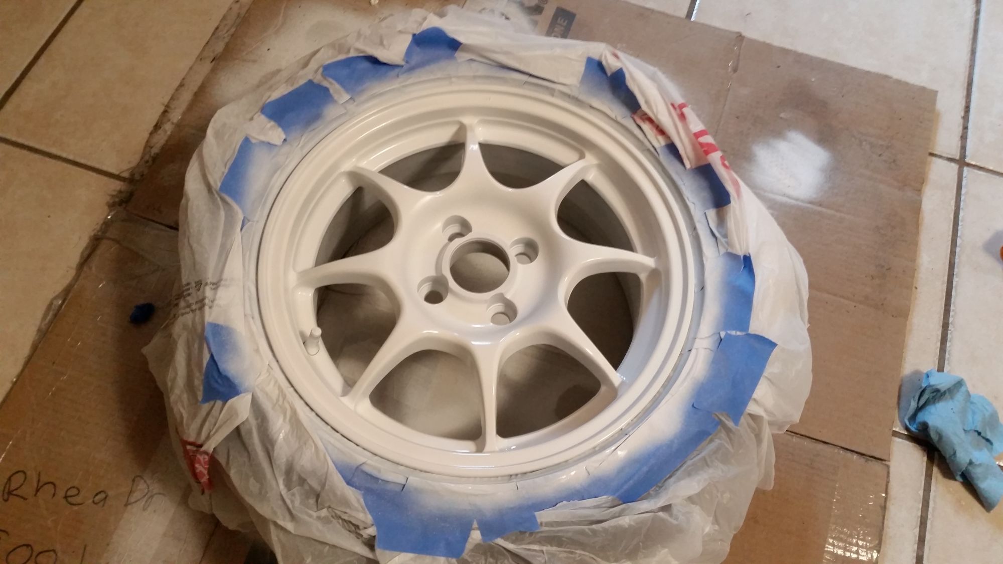

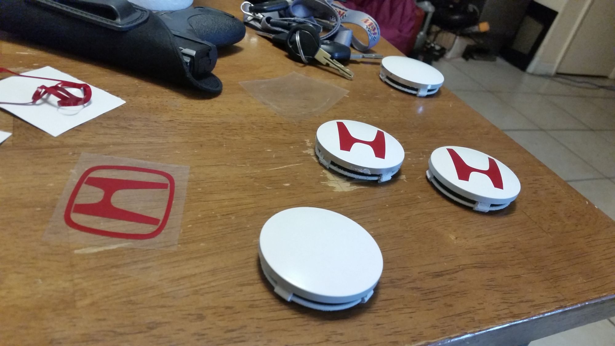

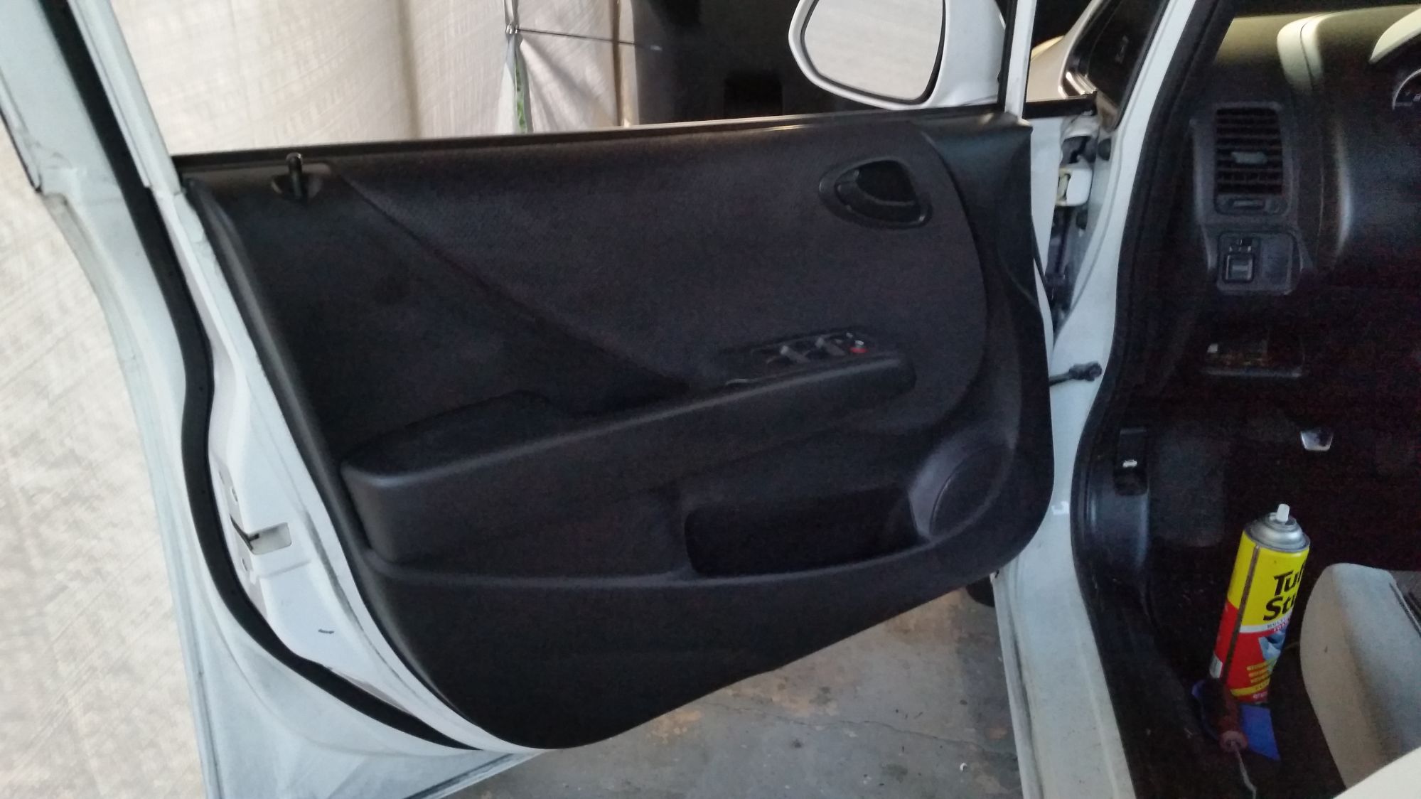

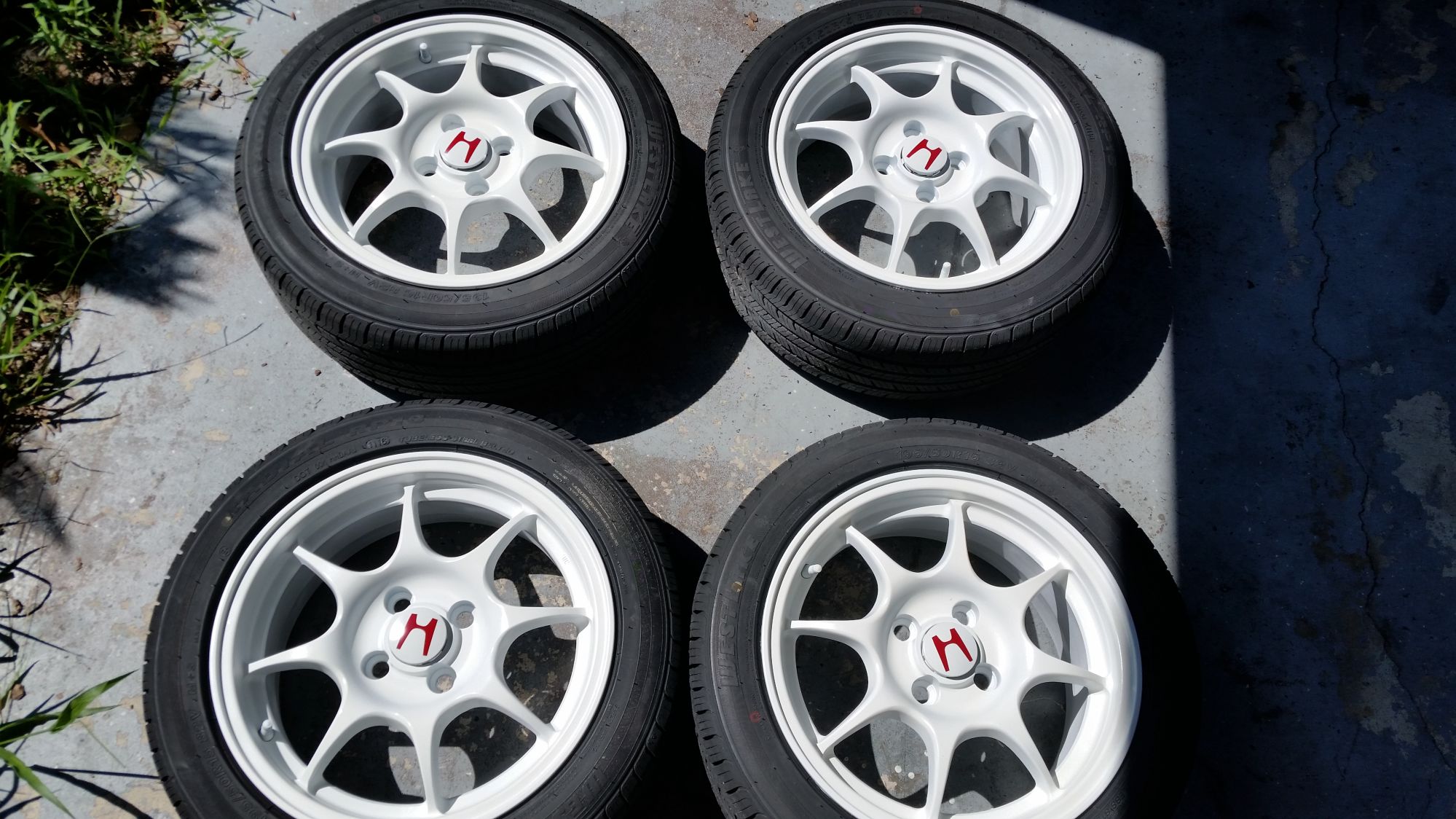

Finished up a diy project for my daily the fit, painted my panels black and pillars, to convert to black. Also painted my wheels.

Who makes these rims and what kind of paint did you use?

Super Road race, i used rustoleum white primar, vht gloss white high heat engine ceramic paint, and vht wheel gloss clear coat.

FWIW.. POR-15 makes a NICE white and some specialty coatings for hot bits like calipers, Dont be afraid of brushing it on its an amazing leveling paint..

awesome thanks! they look great! want them on my ge

thanks you can find on ebay, they used to have a web site but looks like its gone so not sure if they went out of business. Youre going to need hub rings and they are not common 64.1 to 56.1

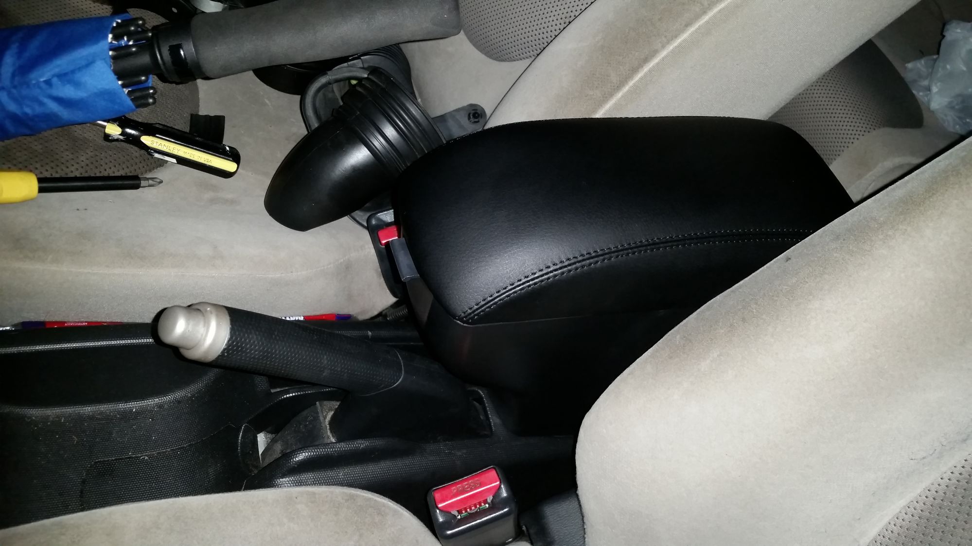

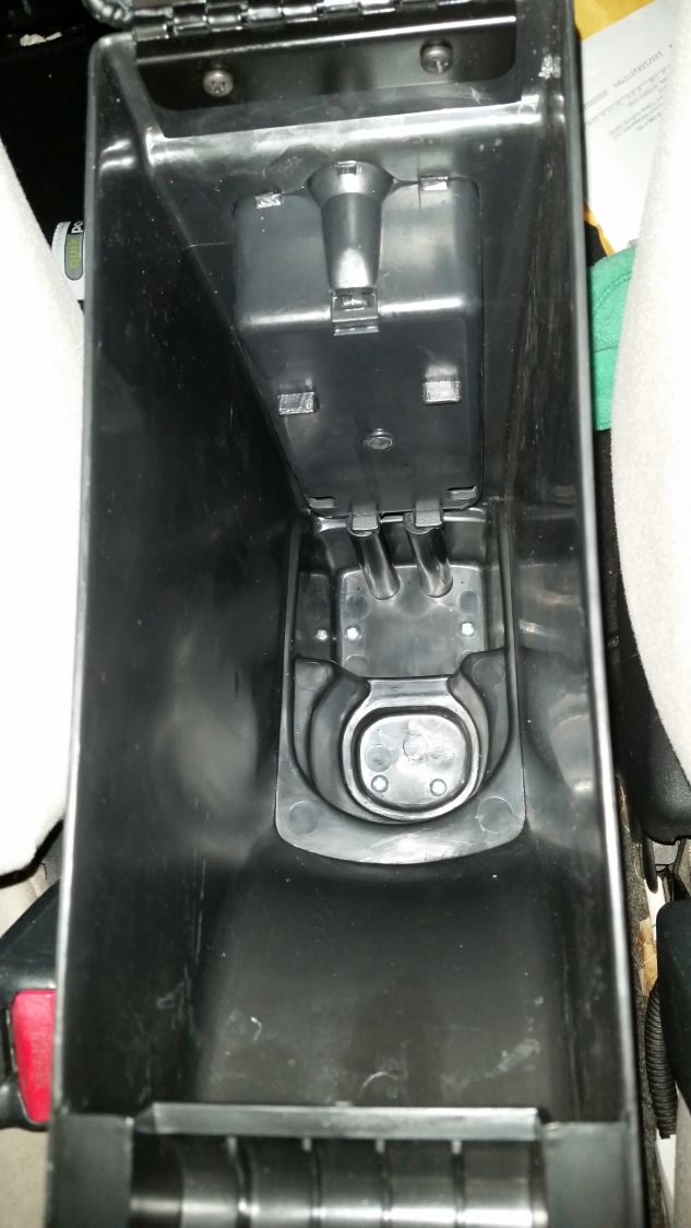

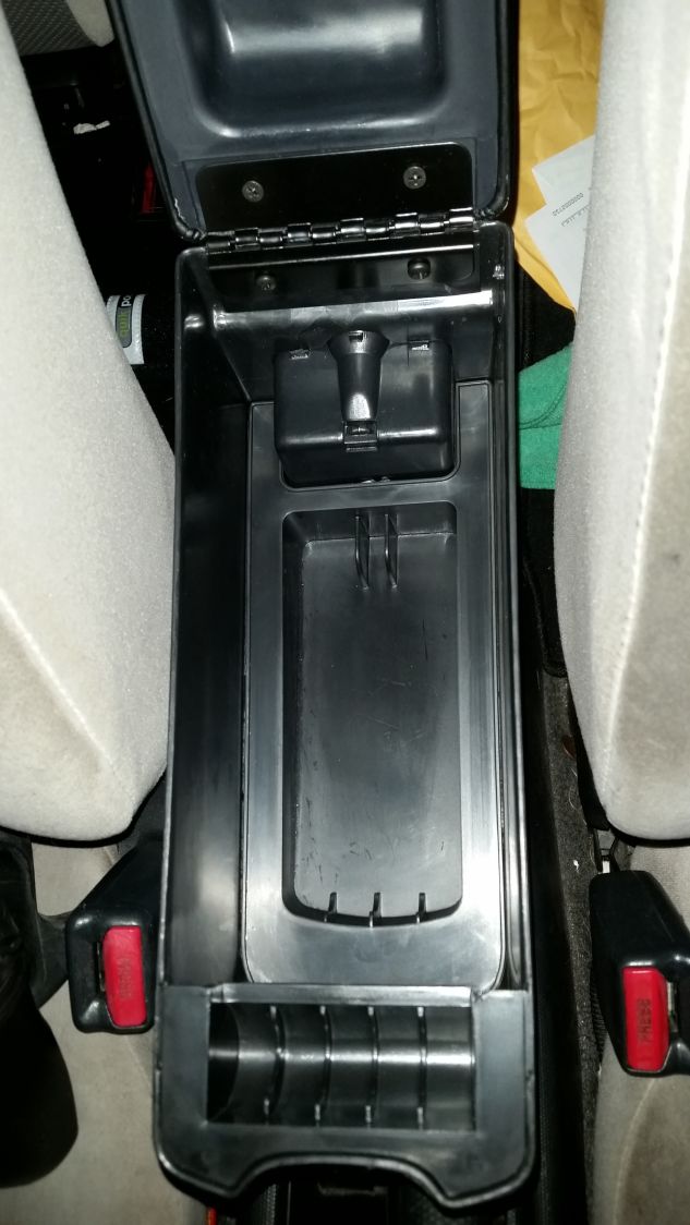

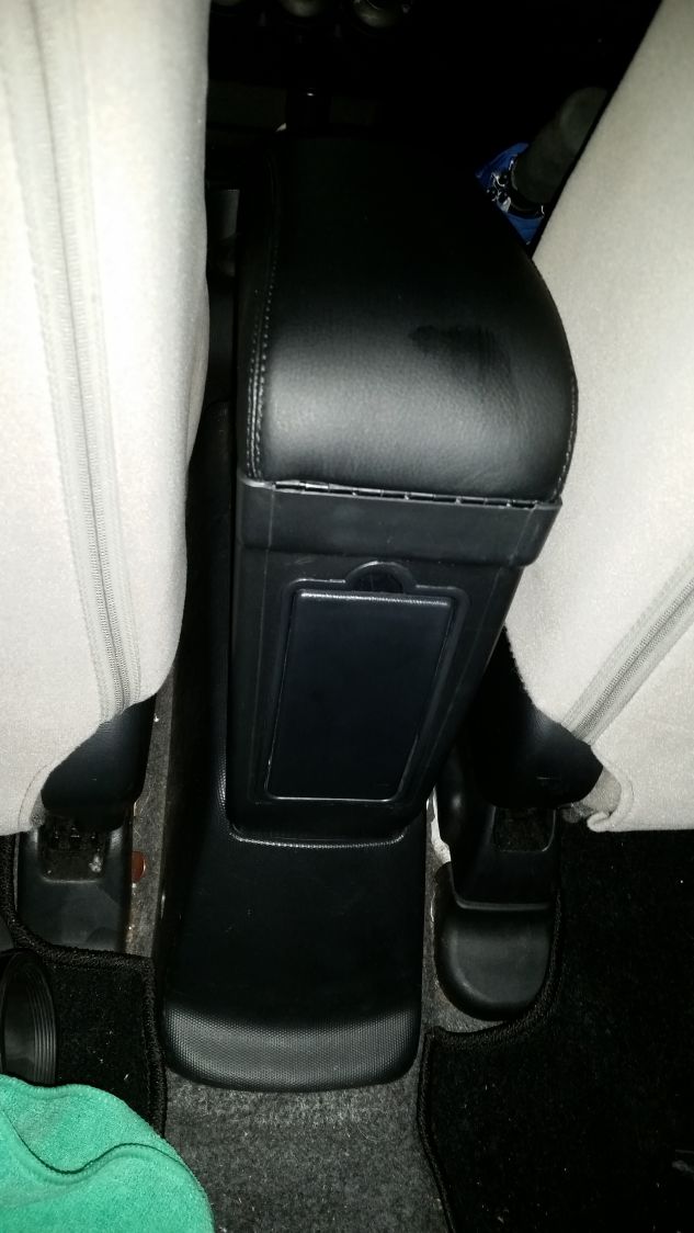

So after much consideration i kept going back and foth about the JDM arm rest and i just couldnt justify for an arm rest paying the buku money people want. id rather spend that money on performance parts or something worth wild to me. So instead i tried out the whole bolt on arm rest and see how it works, and i like it. alot of you might flame on me for doing so but i dont care. I just wanted to share.
Front part
REAR view has a pop out cup holder as well
WHERE is bolts in
and with the tray, also has a coin holder as you can see.

I made the same decision. Totally worth it for the money.
