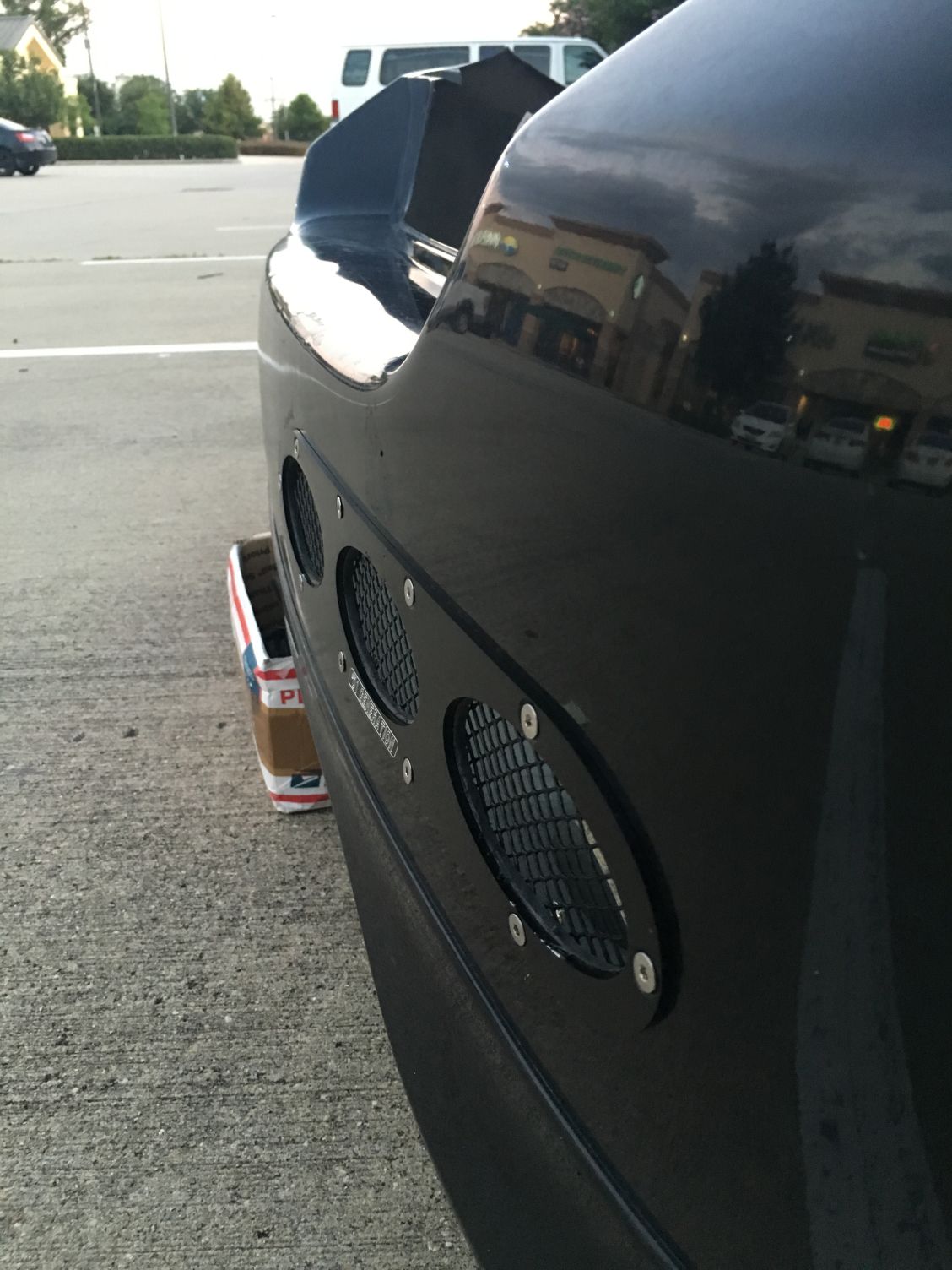

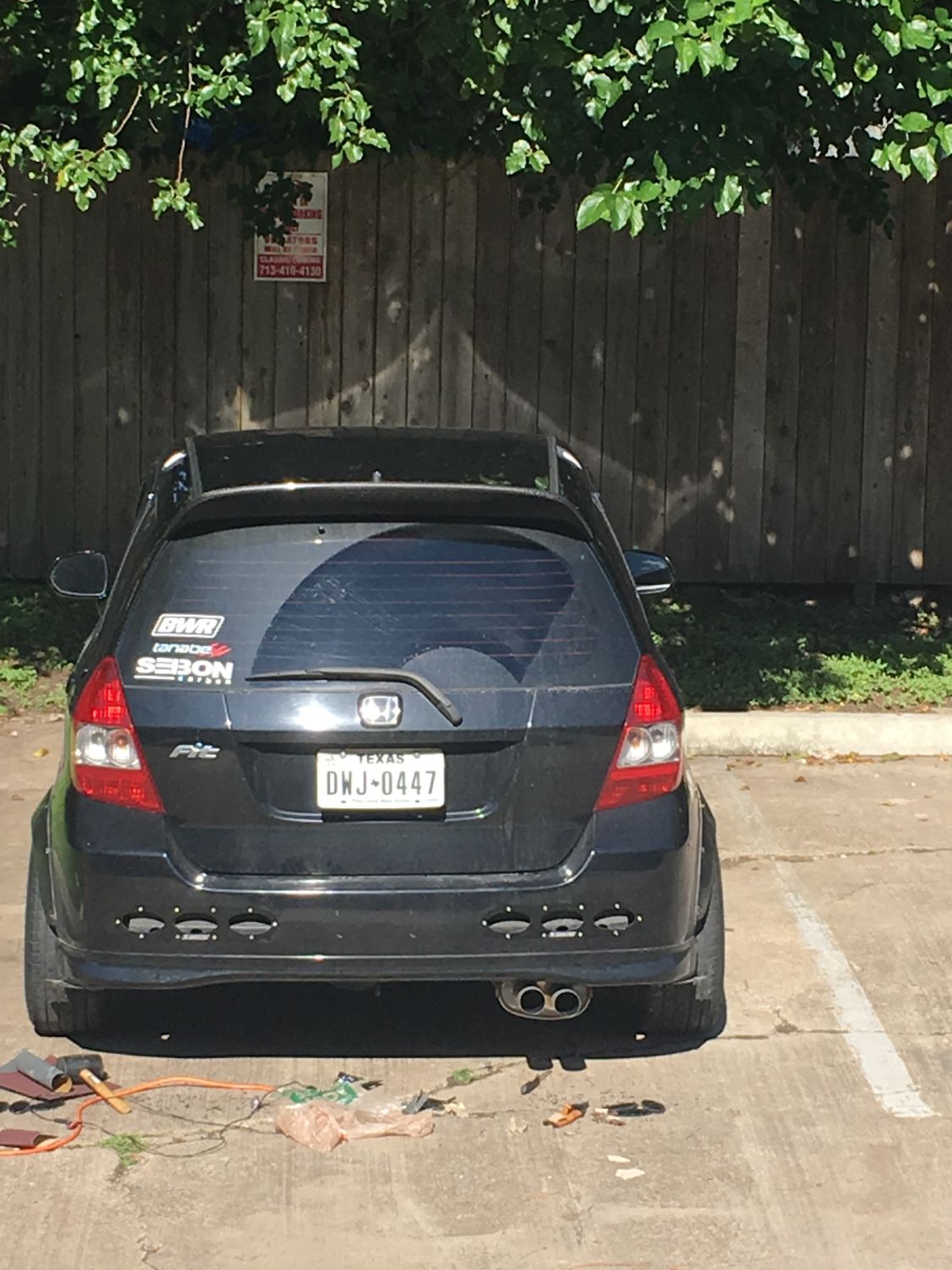

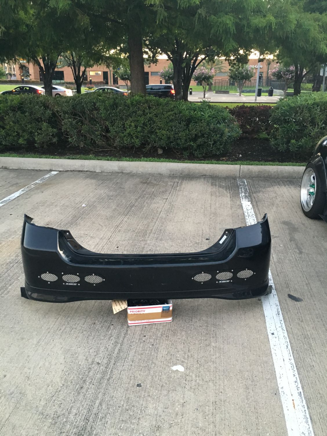

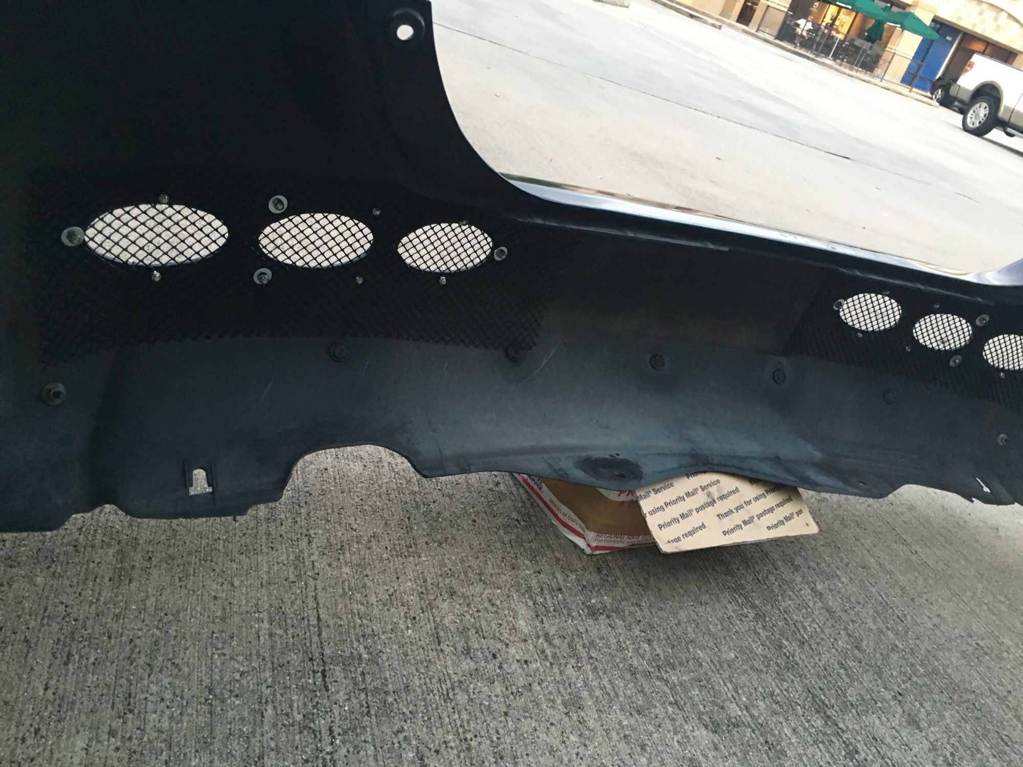

Did this the other day
This shot still has the rear beam on, I already removed it. Planning on getting Js or beatrush rear beam, not sure yet.

Is the car actually quick? I've always like the 'go fast holes' look for some reason. Just my opinion here, but I'd peel off that BWR sticker and throw it in the trash. A lot of their forced induction parts are garbage and a rip off.

Well, I did the holes for looks and letting the air out as I drive. As for quick, I did lessen the weight of the car by removing rear bumper bar, back seats, and spare tire and jack, I do worry though of a flat but It now moves quicker and that I can feel a difference were not given a strong power plant motor but I make the best for my car 😄

I'm all for weight savings, but I hope you or a passenger doesn't get hurt in a rear-end accident now that you have no rear bumper bar.

+1
When I do the JDM rear end conversion, I'm shortening and rewelding my rebar.
Safety > anything else.

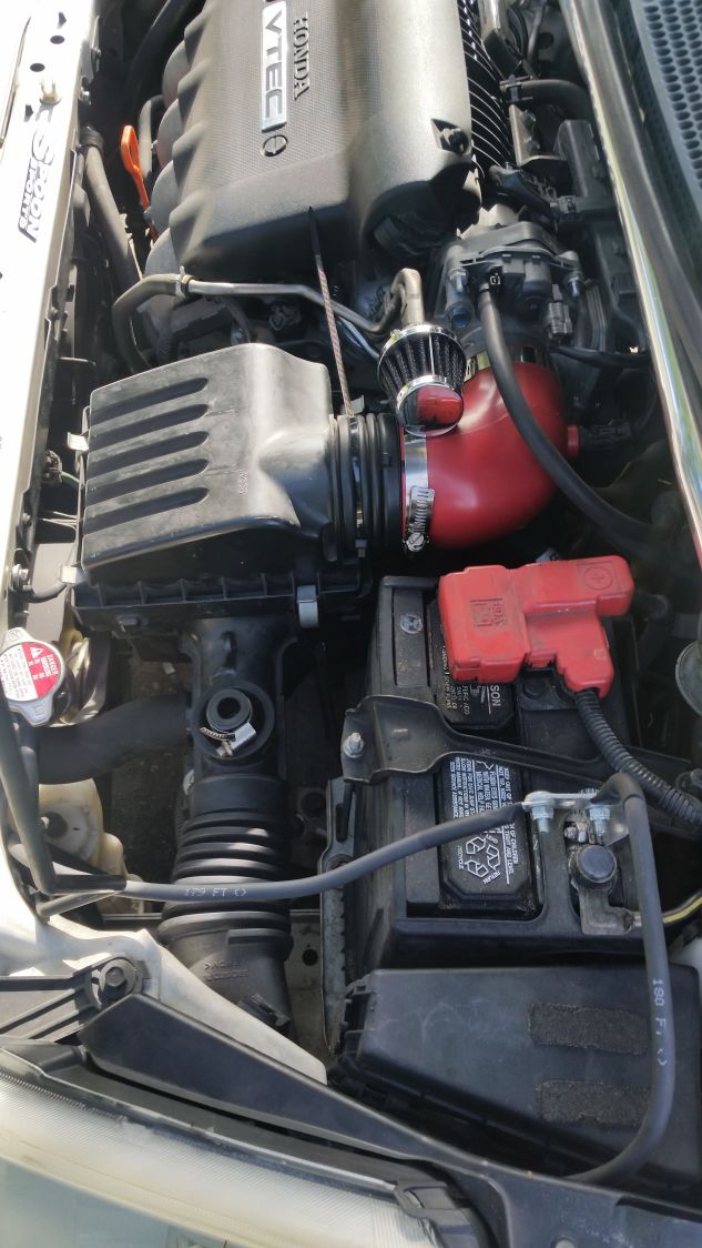

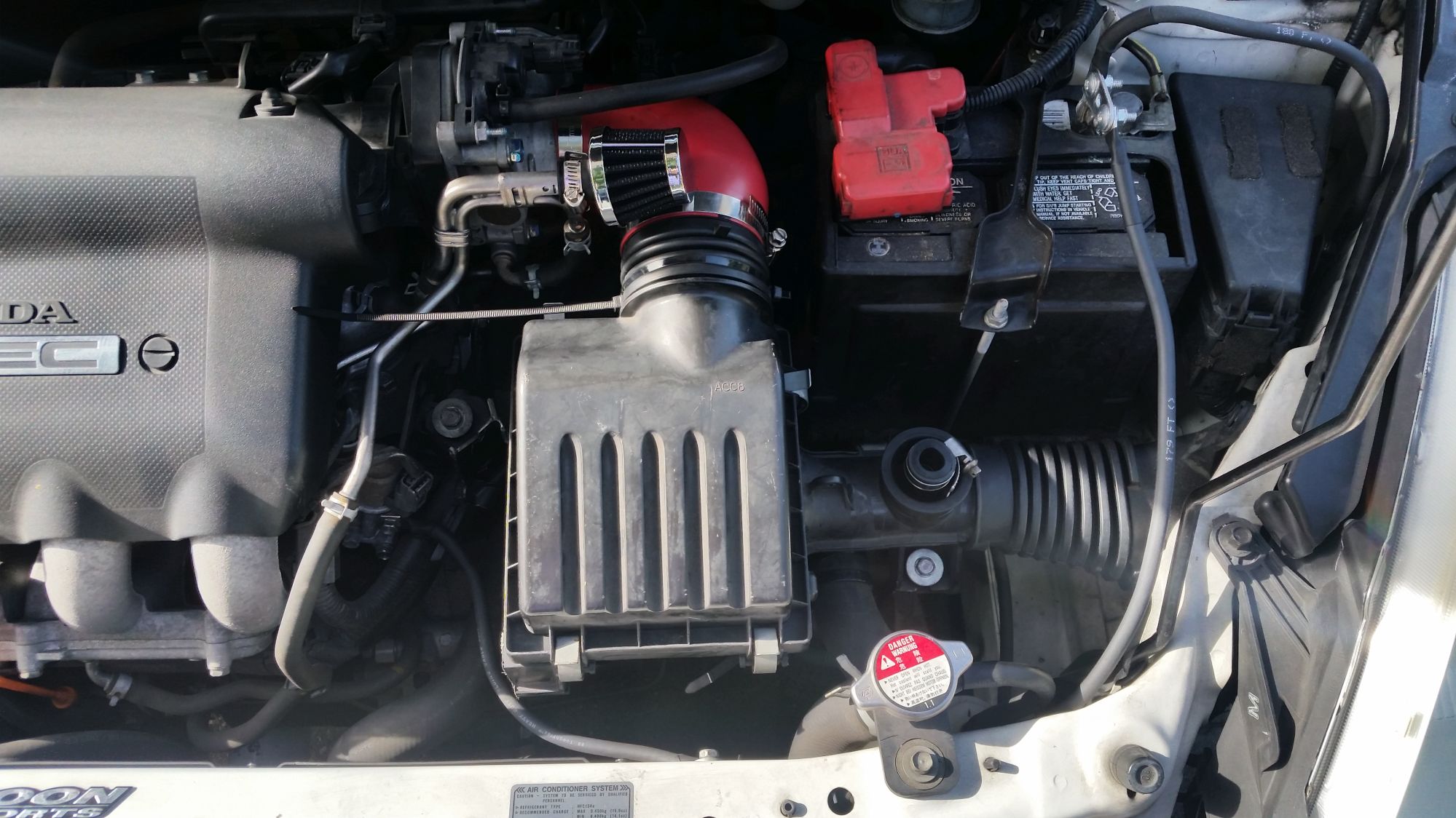

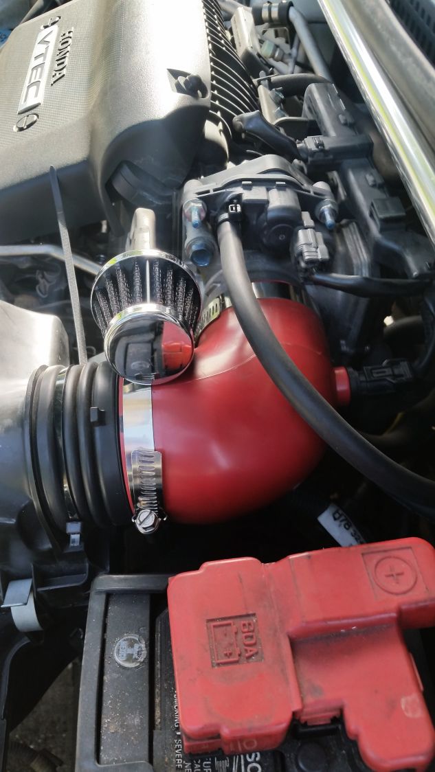

Modded the stock box, deleted all the resonators and added custom Silicone with air intake sensor from tb to the stock box using existing hardware. Tb side is 2.5 inch while box side is 3 inch.
