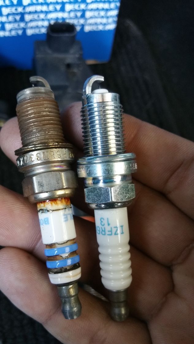

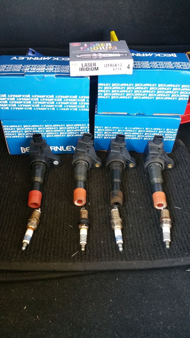

I bought my 08 fit sport last wk and the previous owner said he changed the coil packs and the spark plugs. Well 1 day of owning the fit and the cel came on, along with bad gas mileage and a fuel smell.. code read misfire cylinder 3. I did some research and seems this is a common issue so I decided to double check the previous owners work and see if he changed what he said. Come to find out he changed 1 coil pack and had 2 different brand spark plugs. Everything was cheap parts. So what I did was order the oem brand coil packs along with the 4 ngk plugs that are recommended and I changed everything out today. So far car is driving better, gas doesn't seem to be wasting fast like it was and dosent smell like fuel in the car. I'm hoping it continues to drive good and treat me good, I always make sure to do what's needed to make my cars last and run good. I think I'm going to do a valve adjustment soon as well since I hear alittle ticking and I'm sure it was never done.

Holy crap! Did the electrode actually crack on the old Bosch plug?
