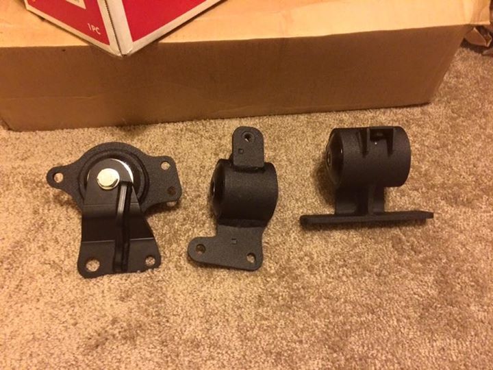

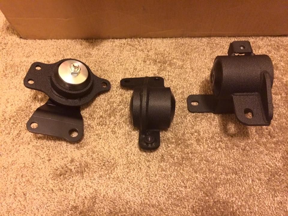

Attached Thumbnails What did you do to the GD Fit today?-80-12316140_10156336088285026_2211628118853593158_n_7c7770dd511799a68e261ef7a6139599567bde77.jpg   What did you do to the GD Fit today?-80-12316469_10156336088265026_691760697875867092_n_7046d7ed32cee65d469c7bf895b2d9b517fbba83.jpg

Are those mounts for an auto or manual?
The kybs are okay as long as you dont have alot of weight in the car. Im just over a year running on kyb excelG shocks and h&r springs and the rear is starting to get bouncy and I will be replacing them in the rear at least in the summer.

Do yourself a favor now and sand down the urethane on the mount on the right in the pictures. It is supposed to be flush with the steel insert. It will save you serious headache when it comes to install. I took an orbital sander to get it flush evenly.

It's an auto, and ok thanks Kyler.
Also, don't expect them to just drop in. Or at least that was the word on the street when reading reviews of the Innovative mounts here. The place that installed mine for me said that the installer learned three new curse words when working on my car. And I think they had to source some bolts/nuts that would actually fit (no pun intended).

DWils makes a great point I completely forgot about.
You will need new bolts for the passenger side engine mount.
If you are installing these yourself, jack the car up, drop the lower transmission mount, tilt the engine as far forward as you can, and install the back engine mount first. That was the most difficult mount have have ever installed. Using a crows foot attached to a swivel socket was the only way to get in there.
As just a hint, I removed the one stud in the stock passenger's side engine mount and used a nut for the bottom part so that the two pointed ends of the studs stick up. (this will make more sense when you get it apart.)
At the time I was able to locate the bolts I needed from home depot.

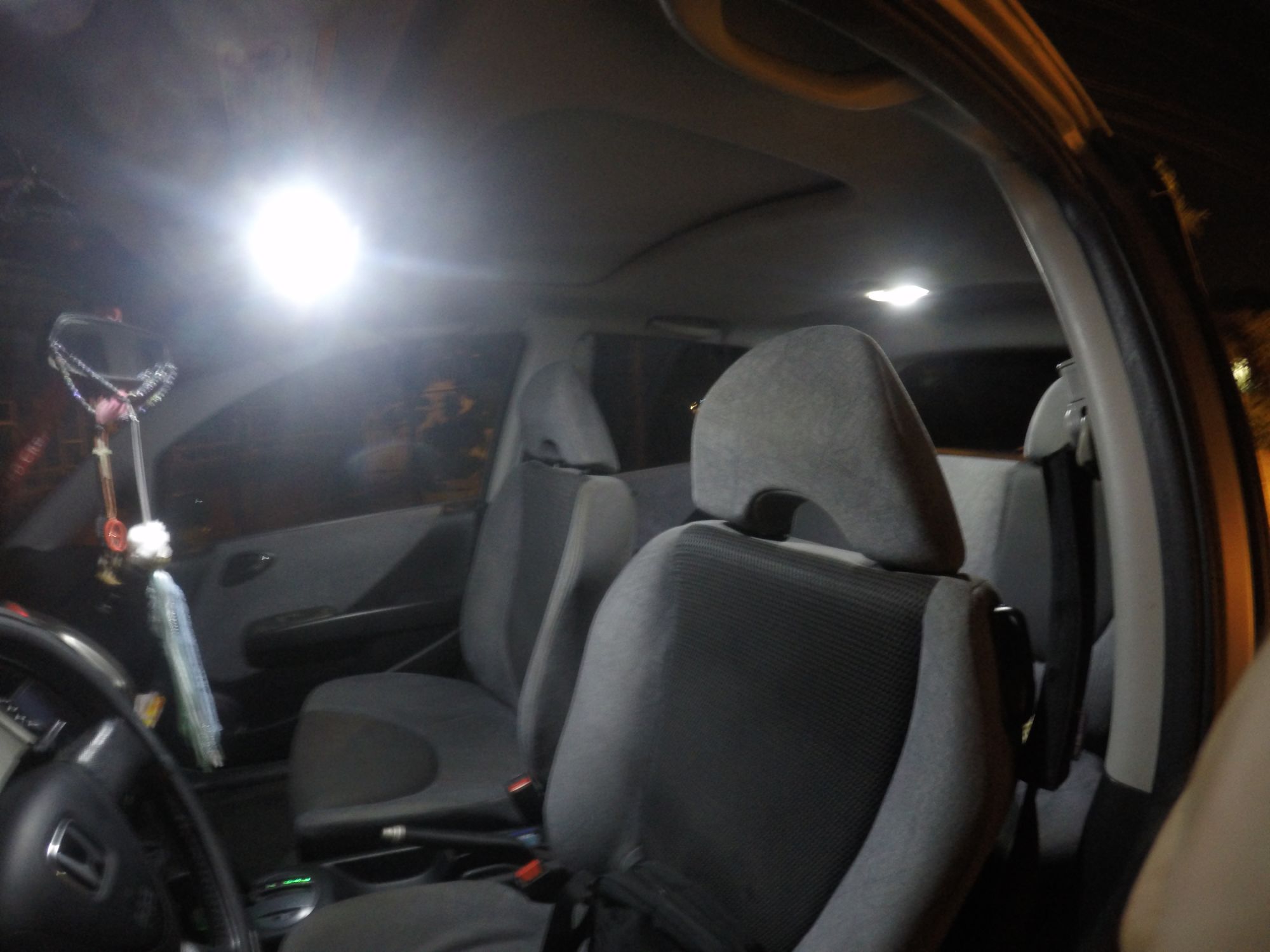

Just changed my stock cabin lights to LED lights. Let there be light!
Attached Thumbnails What did you do to the GD Fit today?-80-gopr7411_5cbaca27901152831d02ec5784f81ca74e5e71cd.jpg
