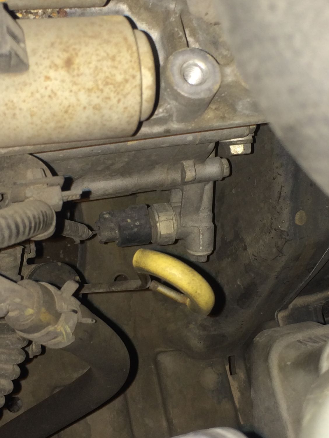

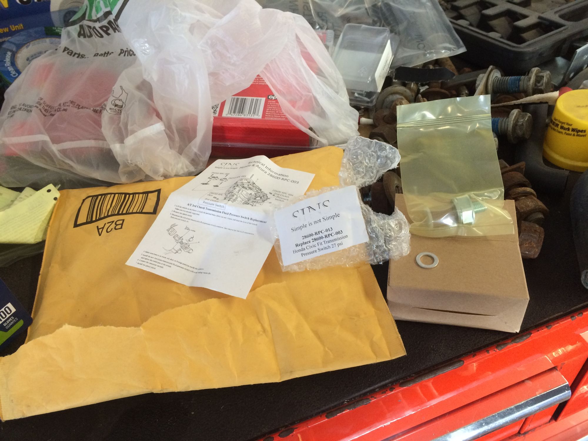

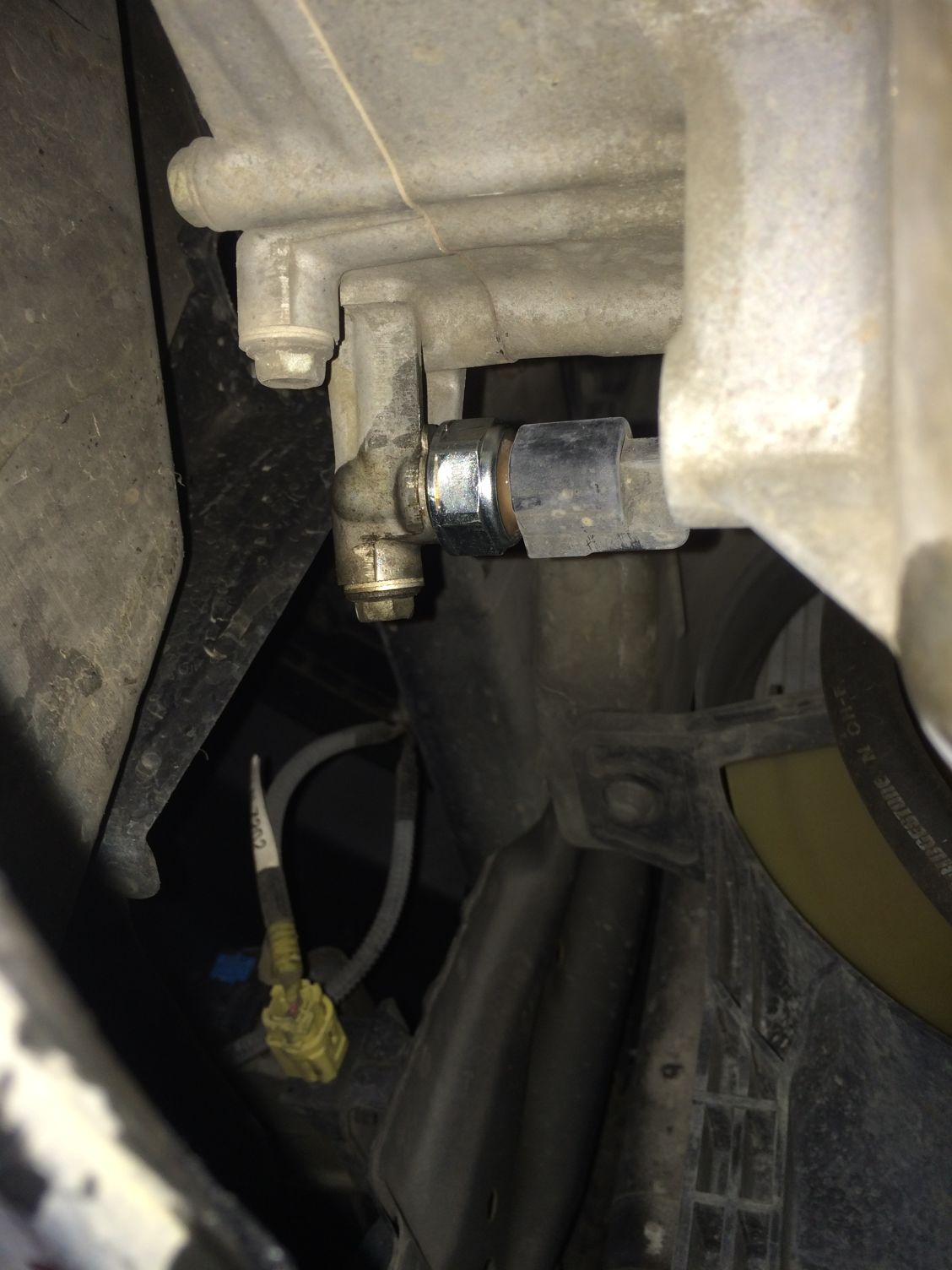

Goodbye P0848

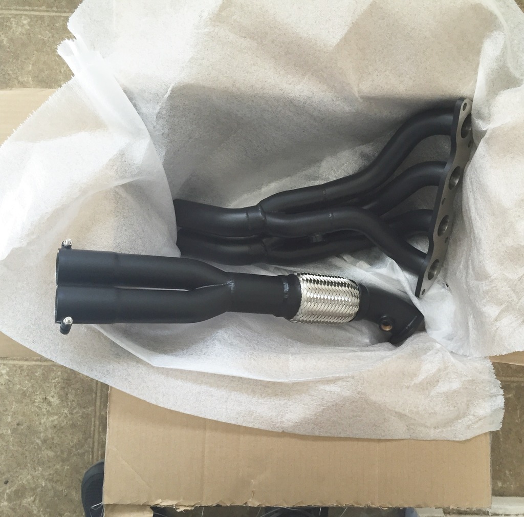

Just picked up this batboy from getting ceramic coated. Excited to throw on my WR race header soon!
Headers looks sweet I was planning on picking up Megan's racing header and down pipe to complete my Megan's dual tip catback

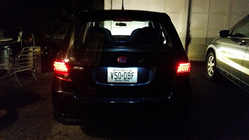

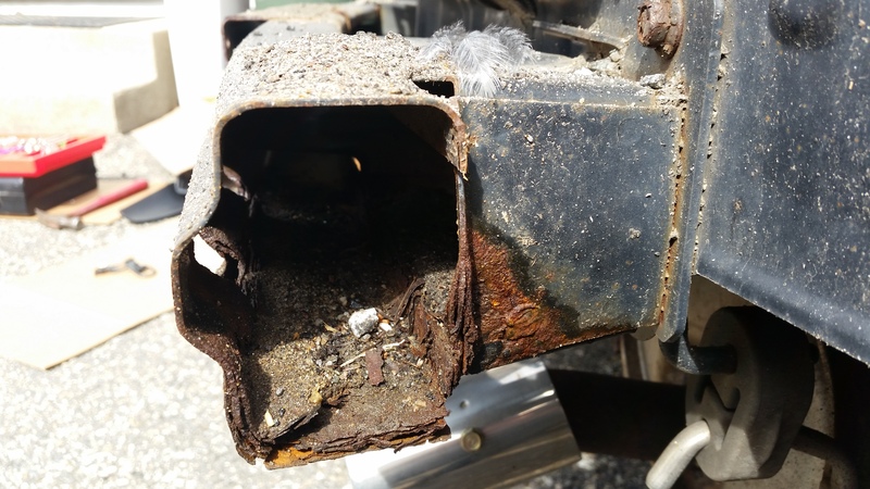

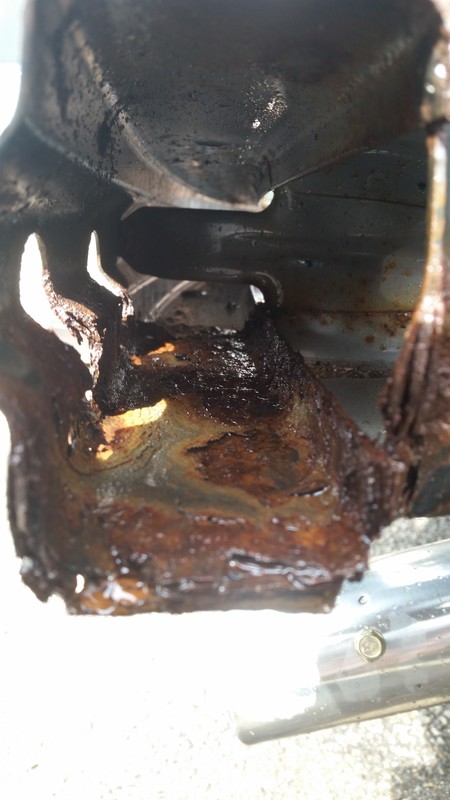

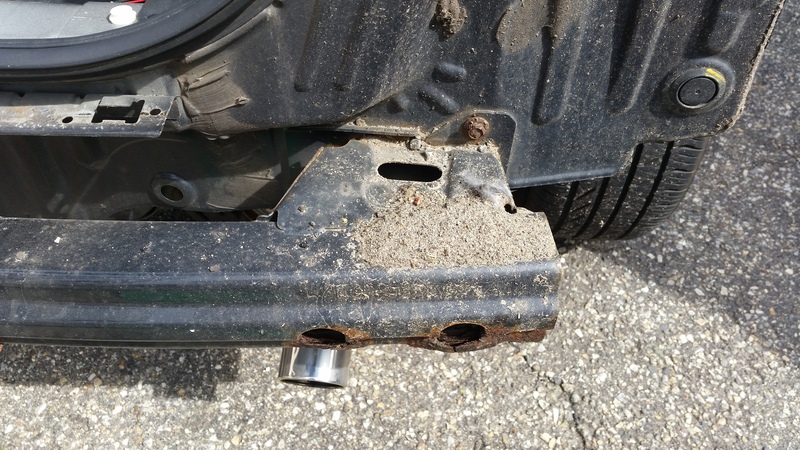

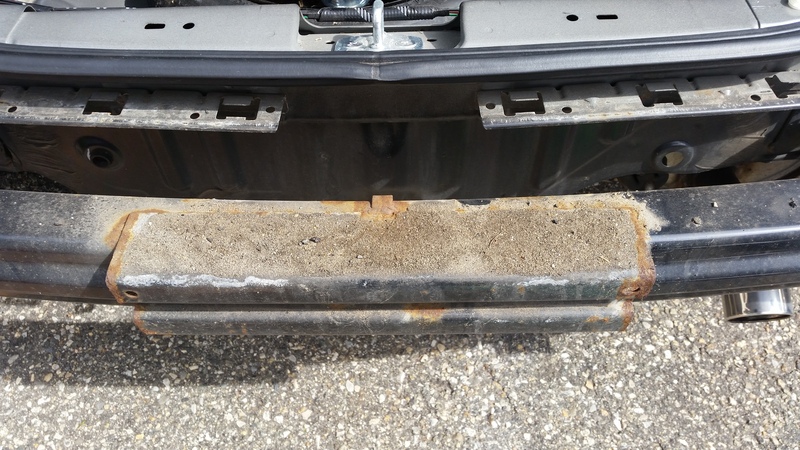

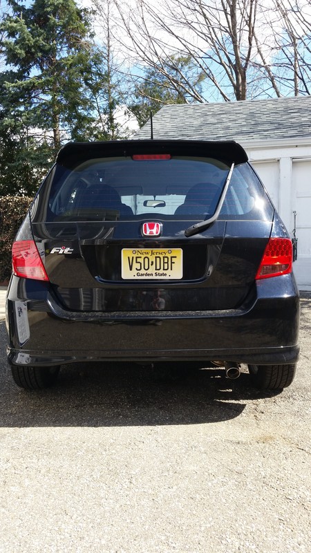

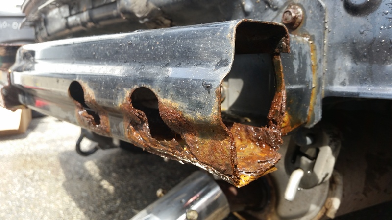

Installed a pair of DEPO Smoked/Red LED tails.
There was a lot of dirt/sand buildup inside and on top of the beam causing bad rust. I took a hose and blasted it all out of there. Wish I knew that was in there a while ago, I would have prevented this. Seems this was the first time the bumper was removed.

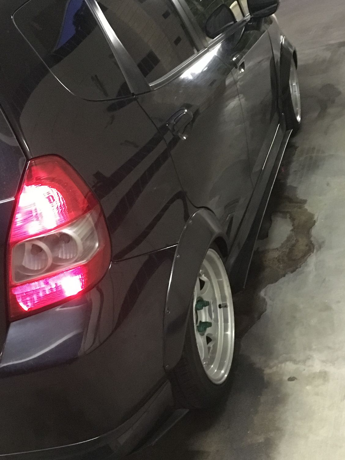

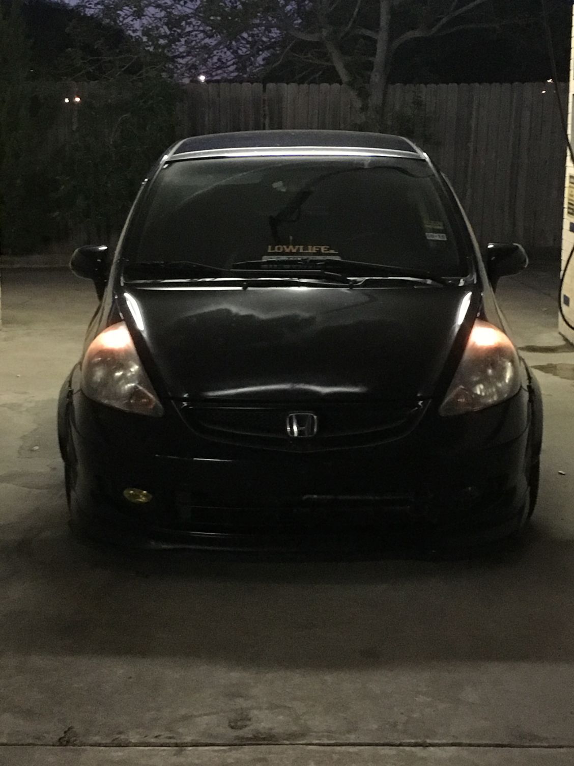

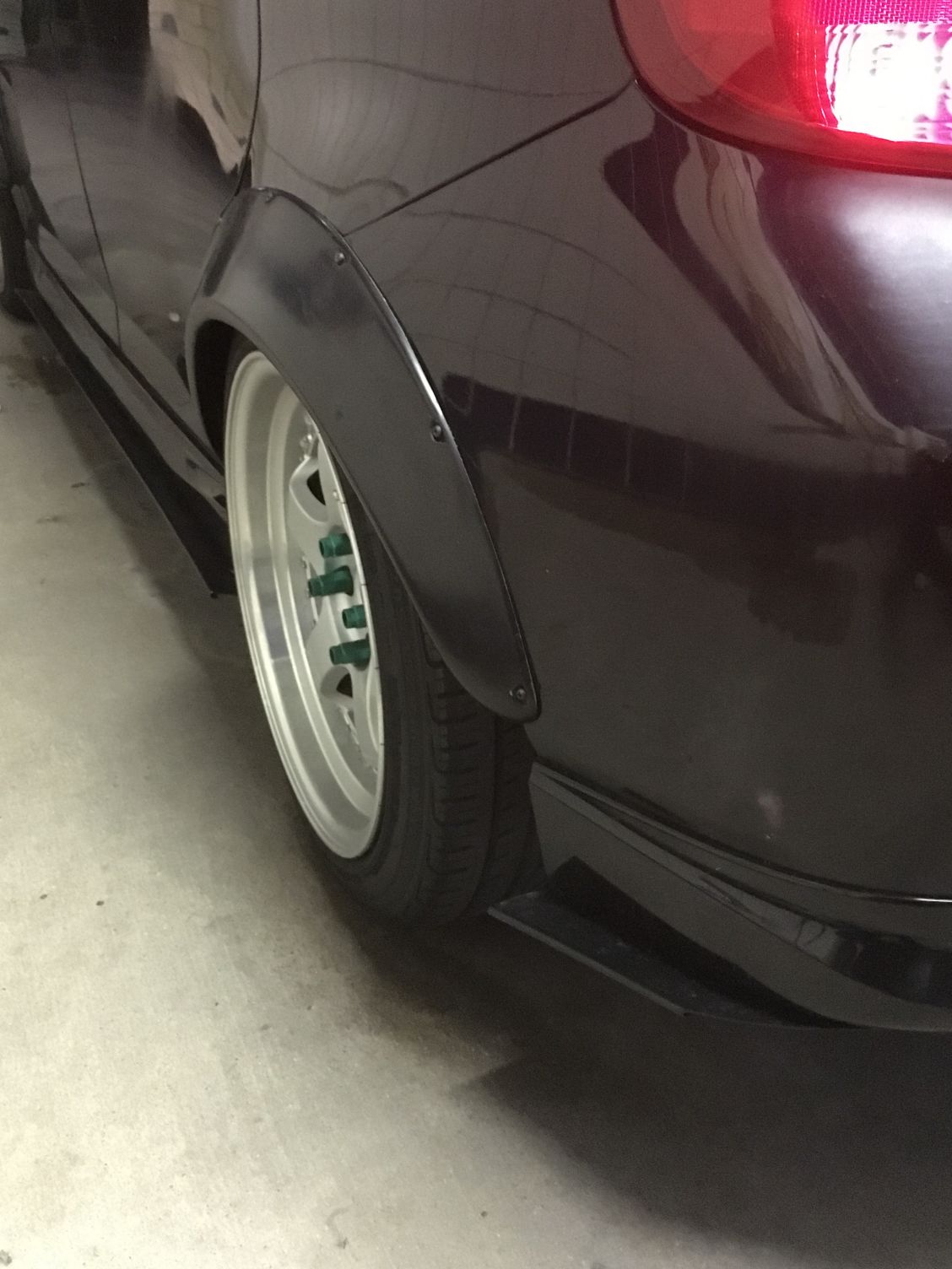

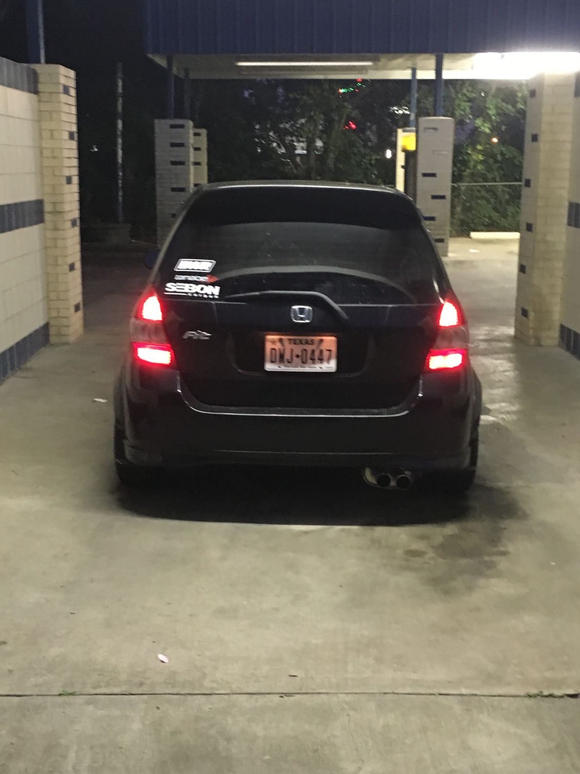

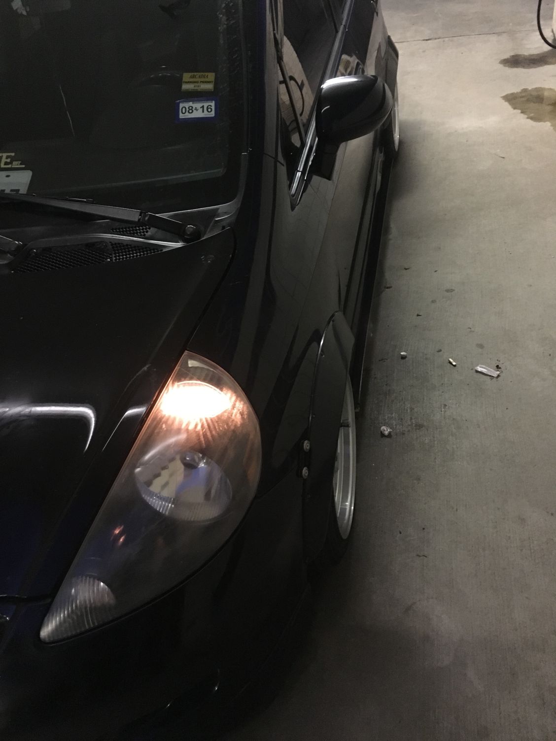

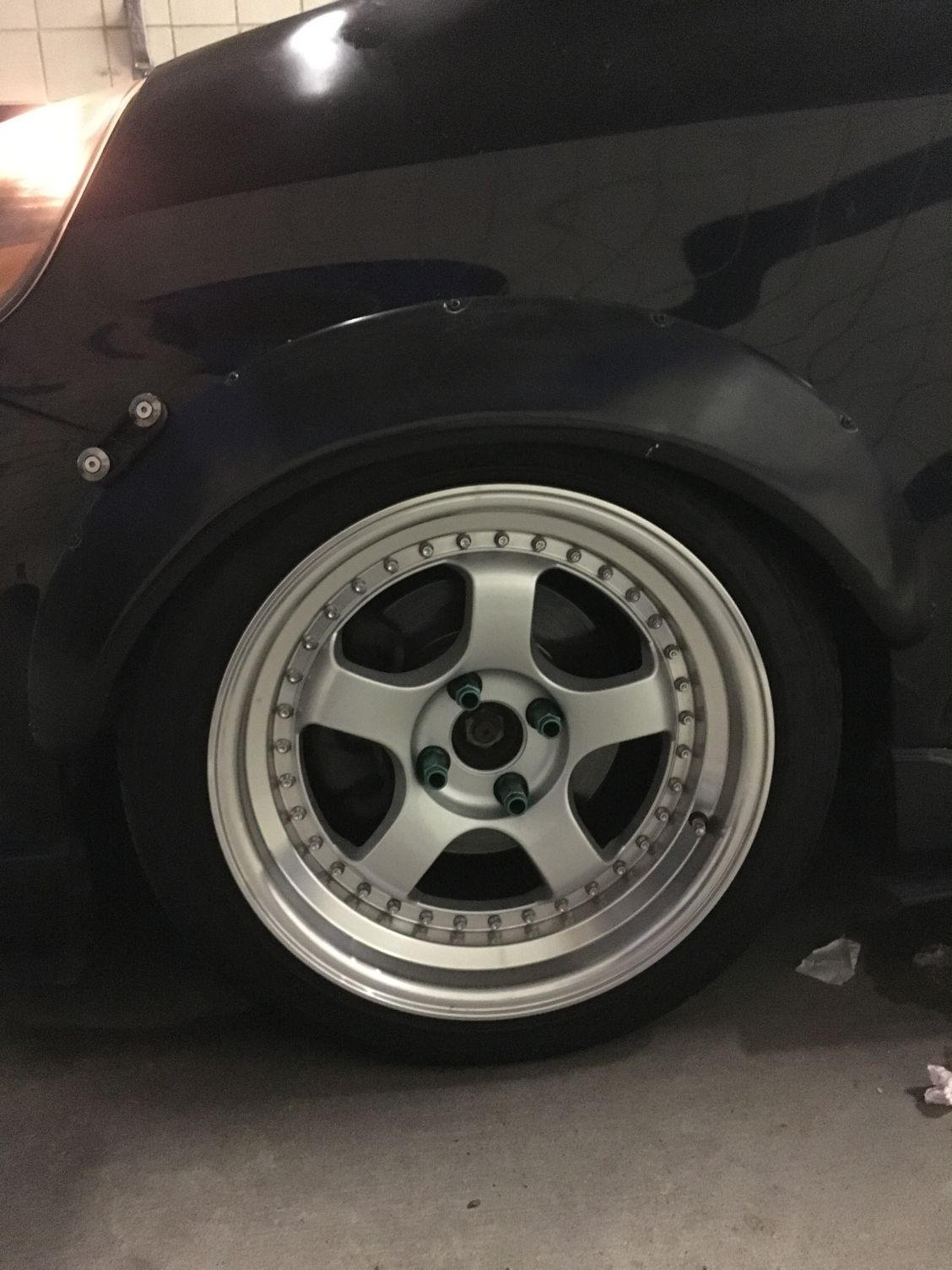

installed these on, will be putting on 56.1 1in or 1 1/2in wheel adaptors. I already trimmed one flare due to, to much rubbing. I need to cut the rest to so after the adapters are in, the wheels will fit perfect
Thought of getting the voltex rear diffuser made for a Subaru but wasn't sure of the firment but I did images how it would look though. Would look sweet plus getting the 2pc black rear 3 holes rear bumper diversions.
after everything is done the way I want it, i'll begin fixing the little door dings and repaint it back to black with some sparkle or a different color, Im unsure which color, kinda liking a dark grey or brown.
waiting on my VIS terminator carbon fiber hood to come in to finish up the front end with eyelids and probably front splitter, not sure though. everything here in houston I hit.

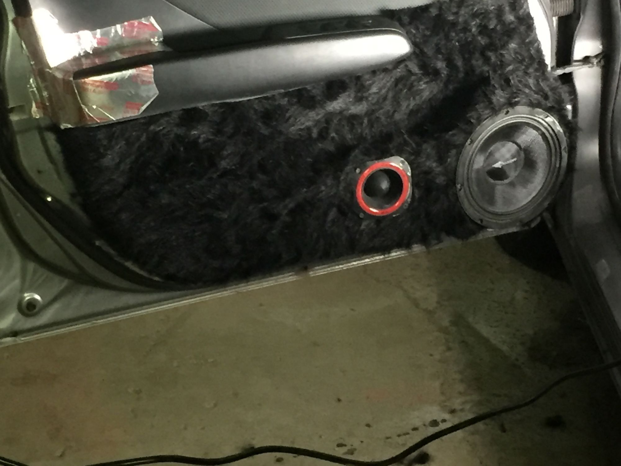

Finished putting 8's and tweets in my doors

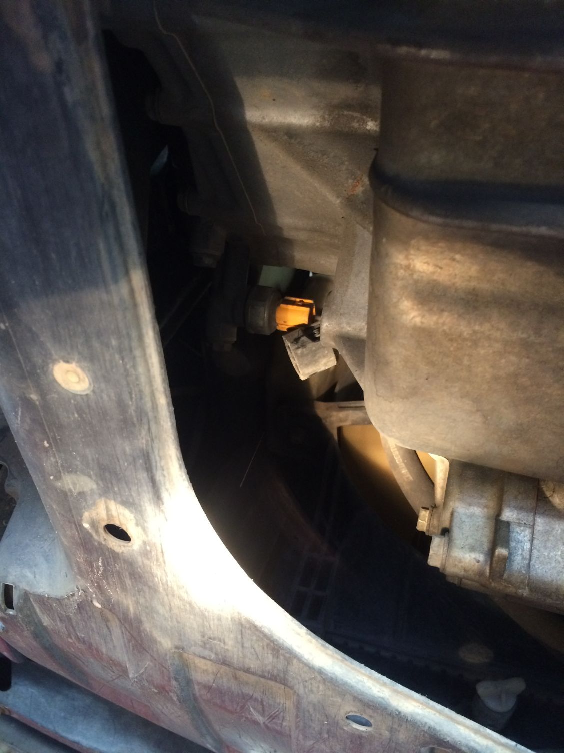

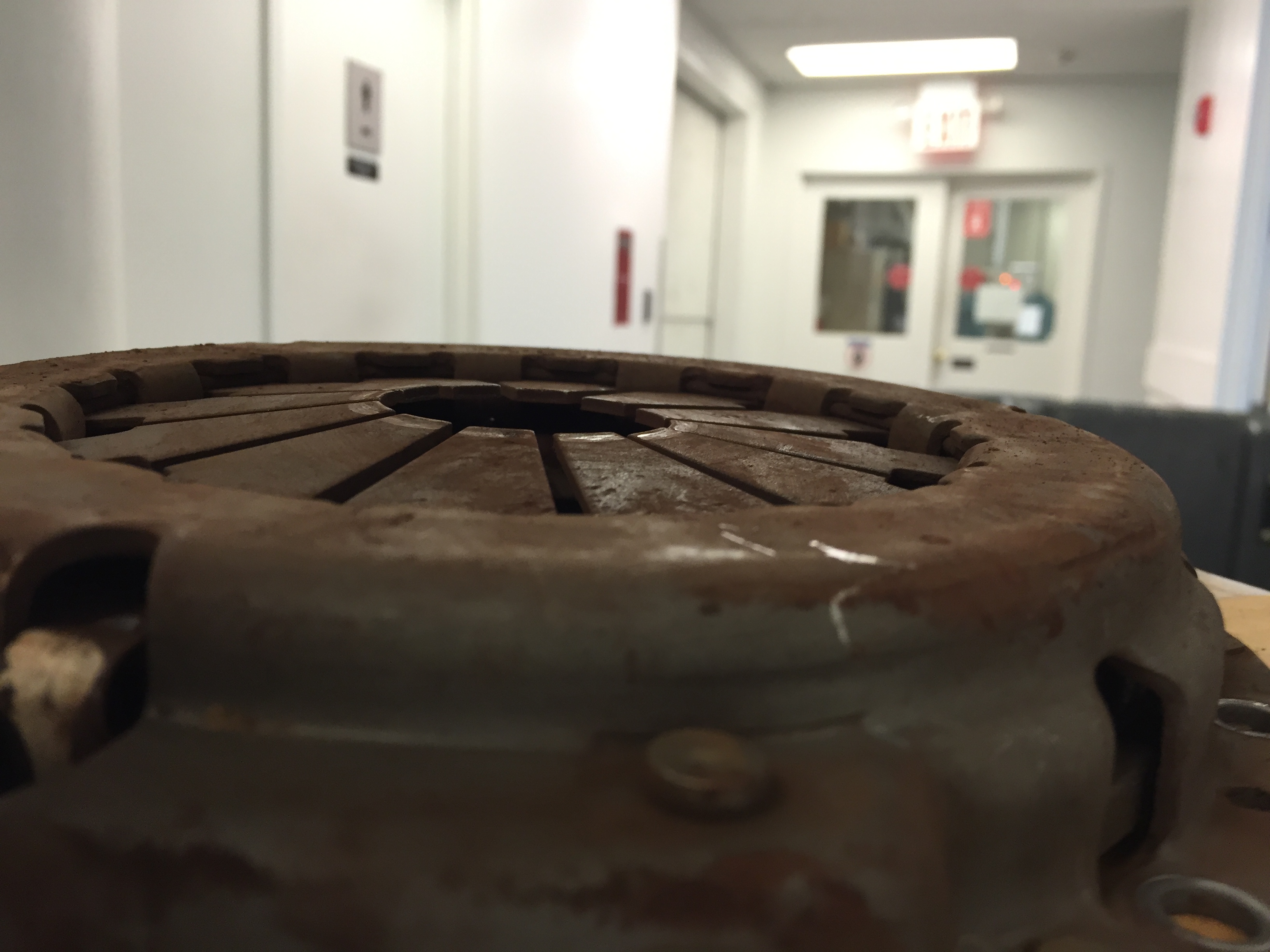

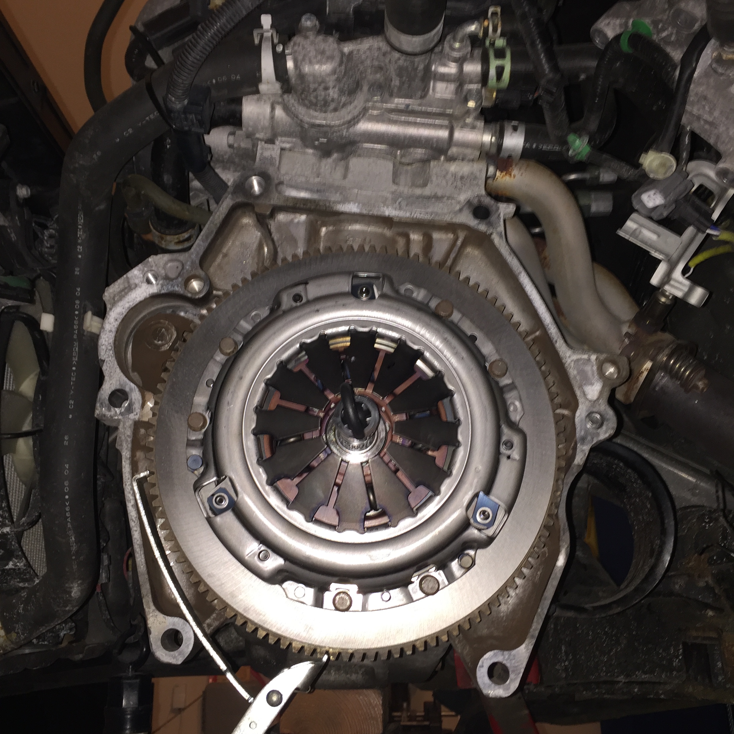

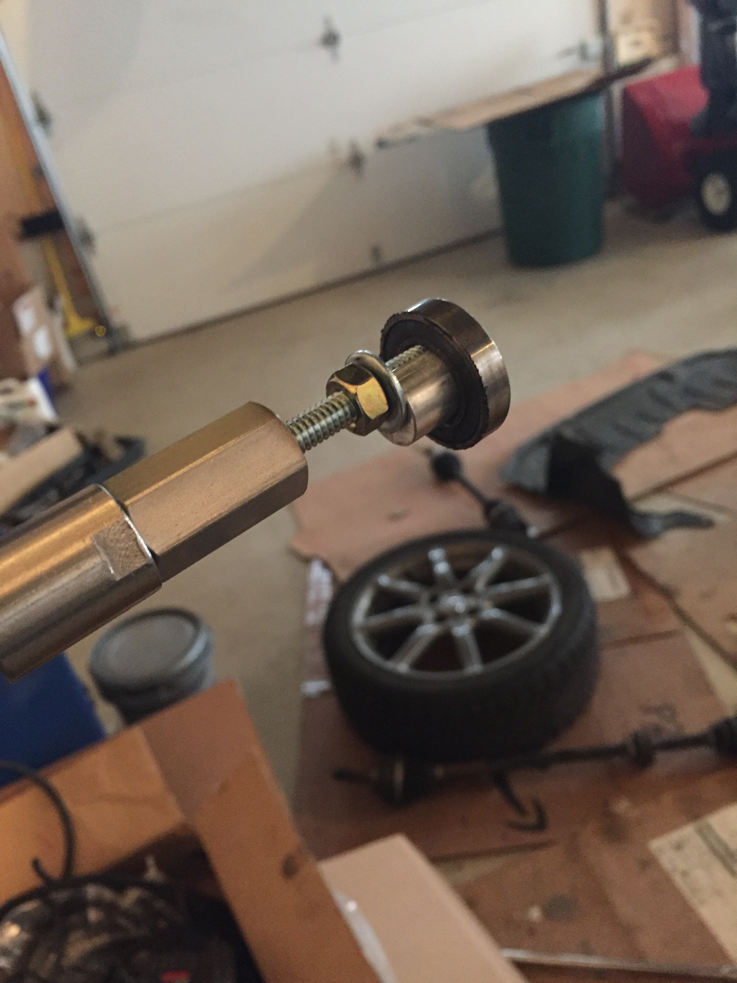

Ive been driving my fit since Dec 15. 2 weeks ago I started having some trouble with the manual trans. It only had 50k on it, i bought it with 42. It started getting notchy going into gear and then got so bad I had to push really hard. I tried adjusting the clutch master rod, but once I got it shifting smoothly, it started to slip. I backed off and dealt with it but finally it started slipping again so it was time to get in there. I borrowed my moms CRV for the next few days. My Acura isnt a fun DD any more with its slammed suspension and unstreetable clutch for the turbo and nitrous.
I ended going with an Exedy hck1006. I resurfaced the flywheel and changed the pilot and throw out bearing. While I was in there I changed a noisy axle and 3 of the 4 motor mounts. Once I pulled out the clutch I noticed that the fingers on the diaphragm werent flat. A few of them were collapsed. Who knows what caused it, but I am guessing that was the reason for the premature failure. I made a small tool to pull out the pilot using a slide hammer. After it went back together I filled it with new Honda fluid.
The worst part of the job was separating the tranny from the engine. The dowels that held it together where so corroded that I had to literally hammer screwdrivers between the block and tranny, wedging them in place to spread it apart. I have done lots of clutches but this was the worst I have dealt with.
I'm really happy with the hck1006. Hopefully it lasts me as long as my other cars. My last car had 225 on the original clutch.
I have attached a few pics.

Looks good man! I had the clutch/flywheel in my 07 swapped out a few months ago, went with an Exedy stage 1 and Fidenza flywheel. The difference in shifting and acceleration is night and day! Just wish I had the ability to swap out my clutch myself, I paid a local garage $425 to do it which I thought was more then fair. I see you are in Jersey, there are a bunch of us located around the area. We actually have a monthly meet at the Sonic drive-thru loc on Rt.1 by the Menlo Mall in Edison. The next one is Sunday, April 17th from noon till around 4 or so (depends how many guys show up) you should definitely come through.

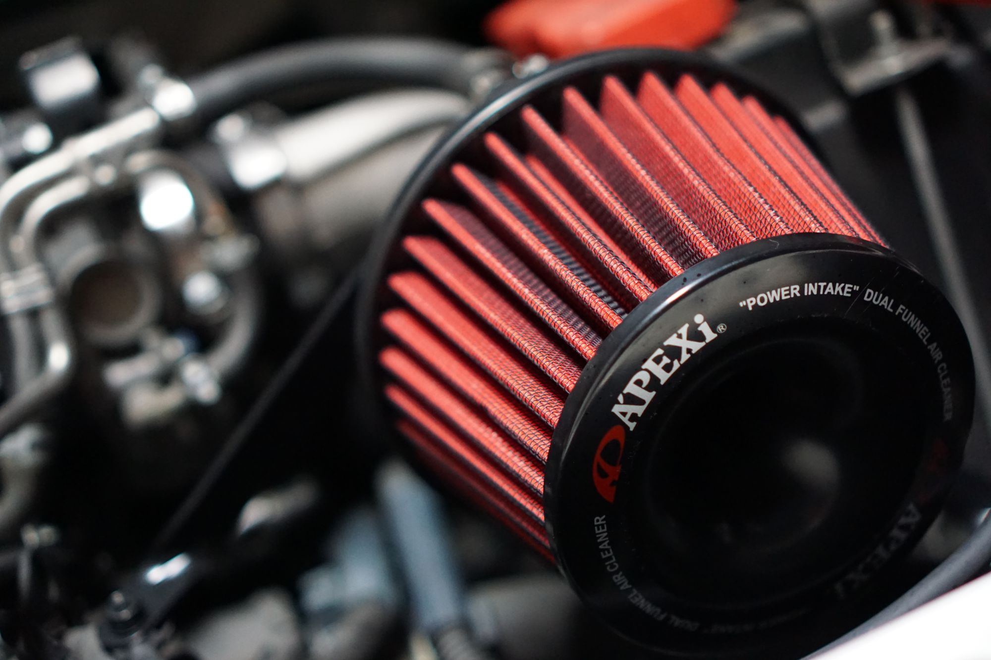

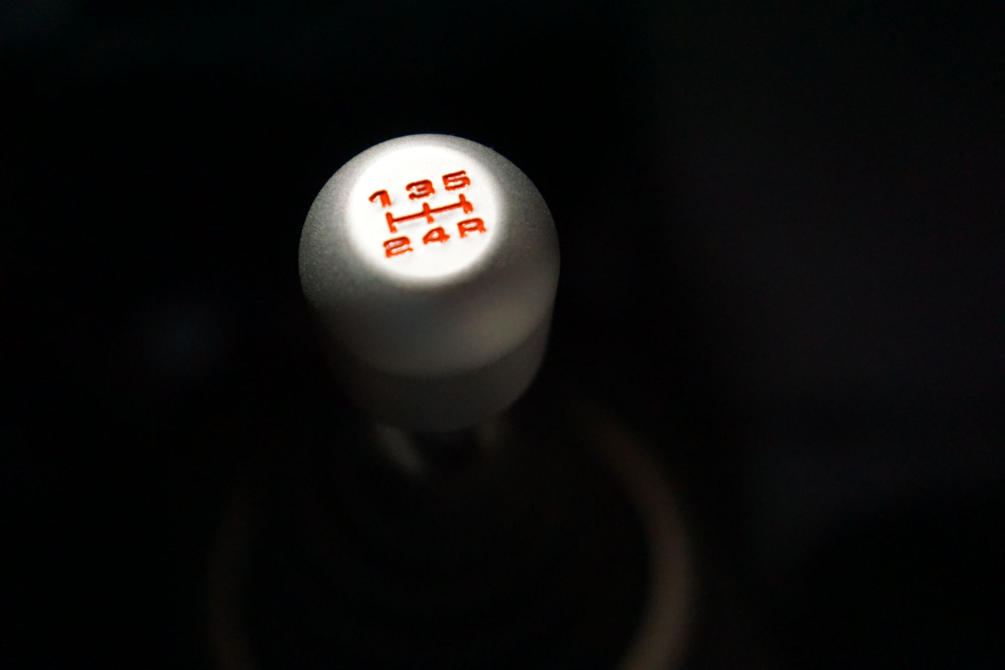

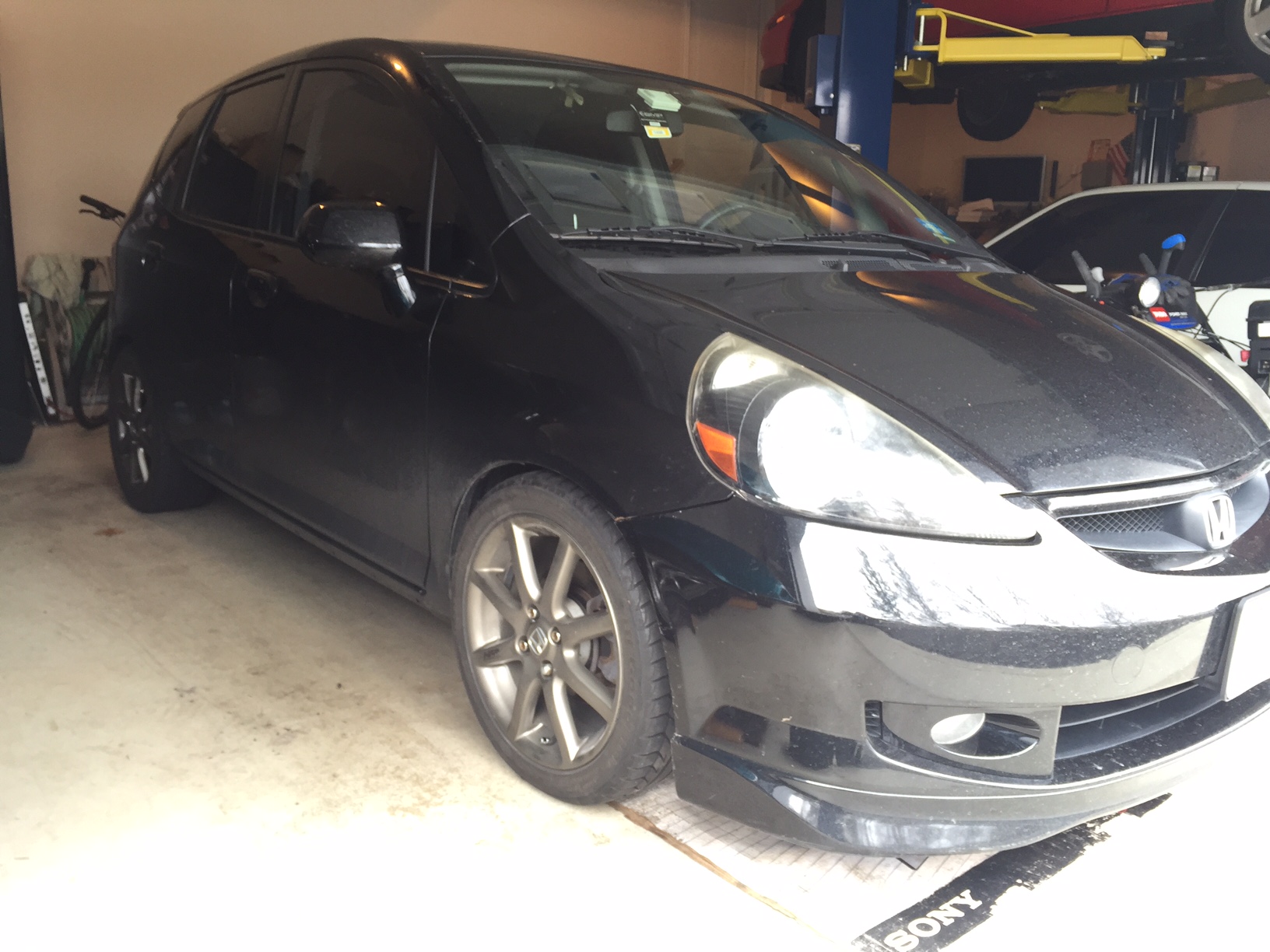

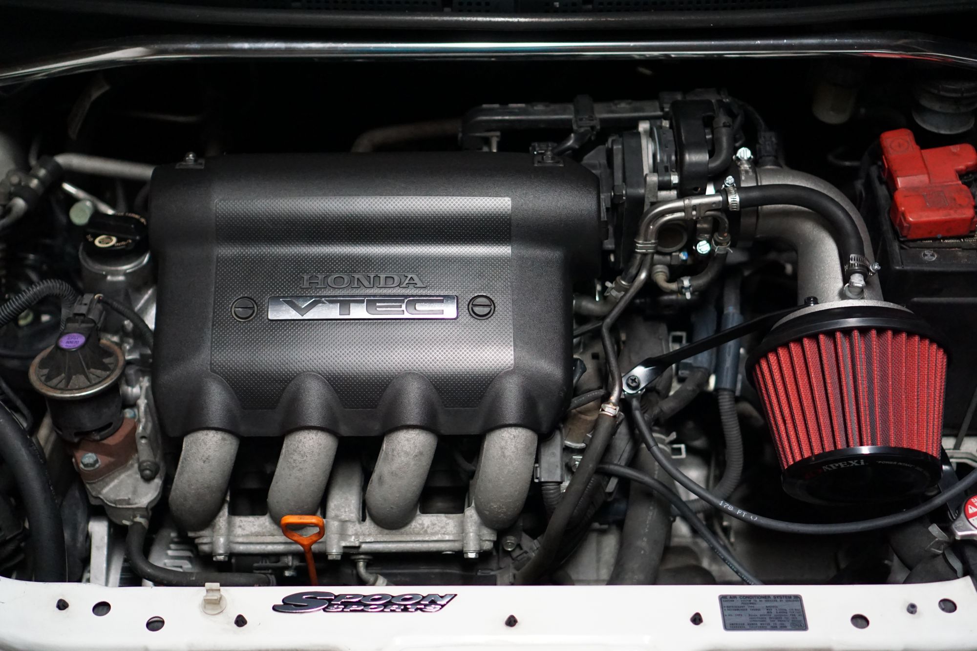

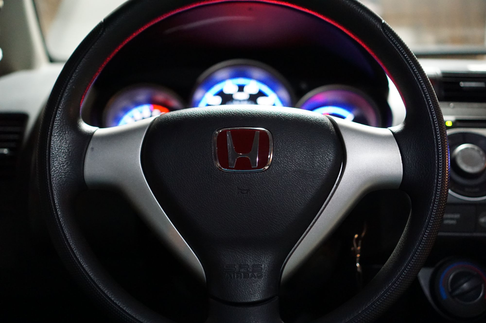

I installed couple goodies, the last Apexi intake in the country, some found wires, type r shift knob and red steering wheel emblem, lowering springs on brand new shocks, slotted and drilled front rotors and pads by stoptech, strup header, spoon sports strut tower bar, and custom axel back exhaust.

I got my Apexi power intake about 2 weeks ago, love it! Feels more consistent through the entire power band then my previous CAI.
