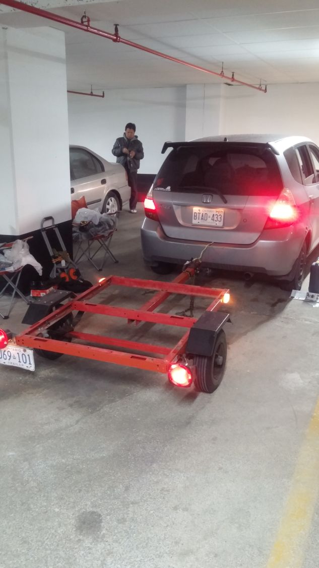

Connected the 4-pin trailer harness to the Fit and tested the trailer...its lit! ��

Nice. I'm currently rebuilding my trailer. It's sanded/grinded and then primered. Waiting for a warm day to lay on some paint.

yeah, i plan on rebuilding this one too..got it for cheap but previous owner said it was sitting for a looooong time.

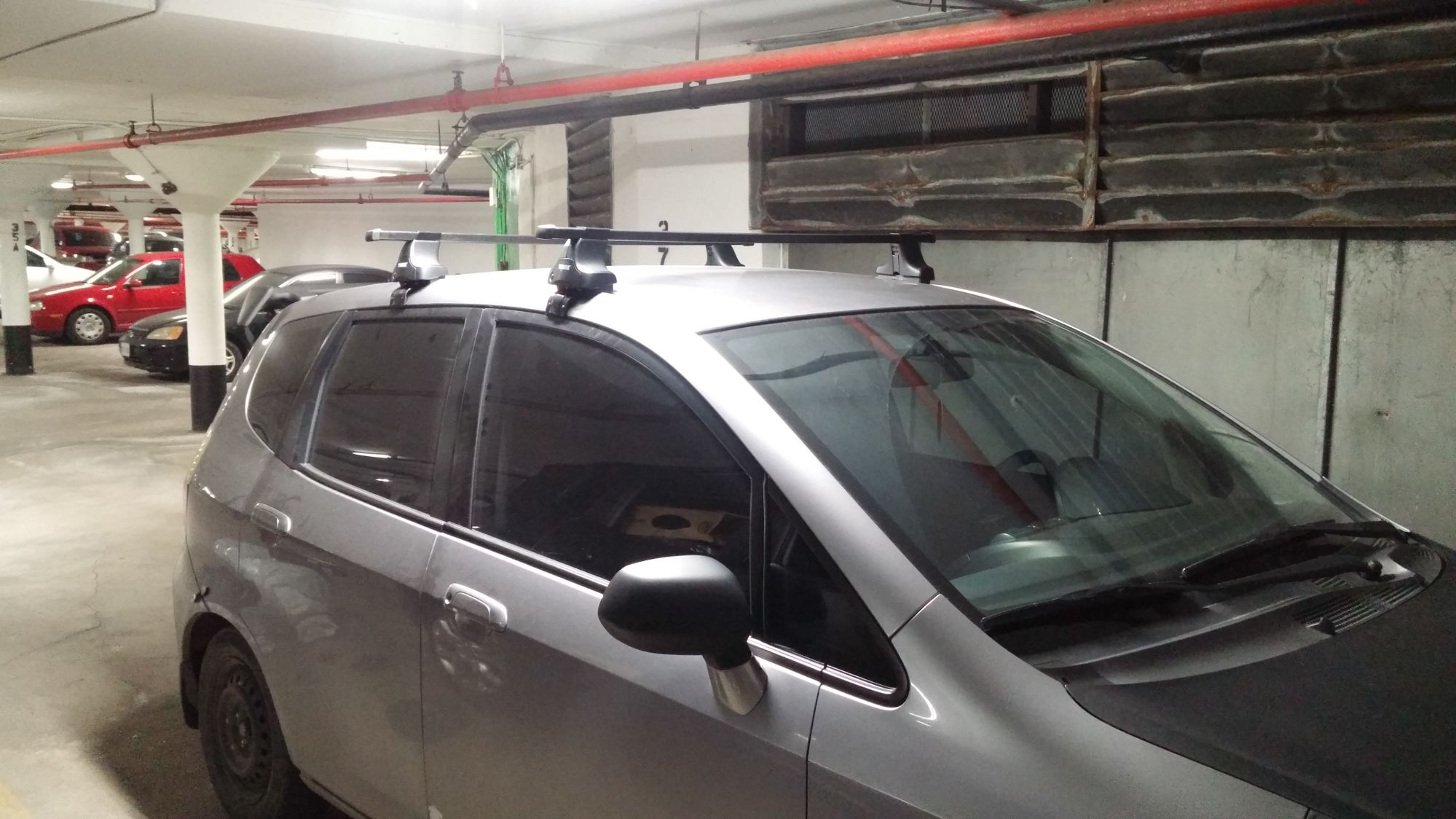

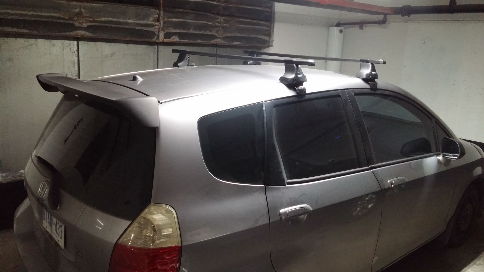

workhorse status lol

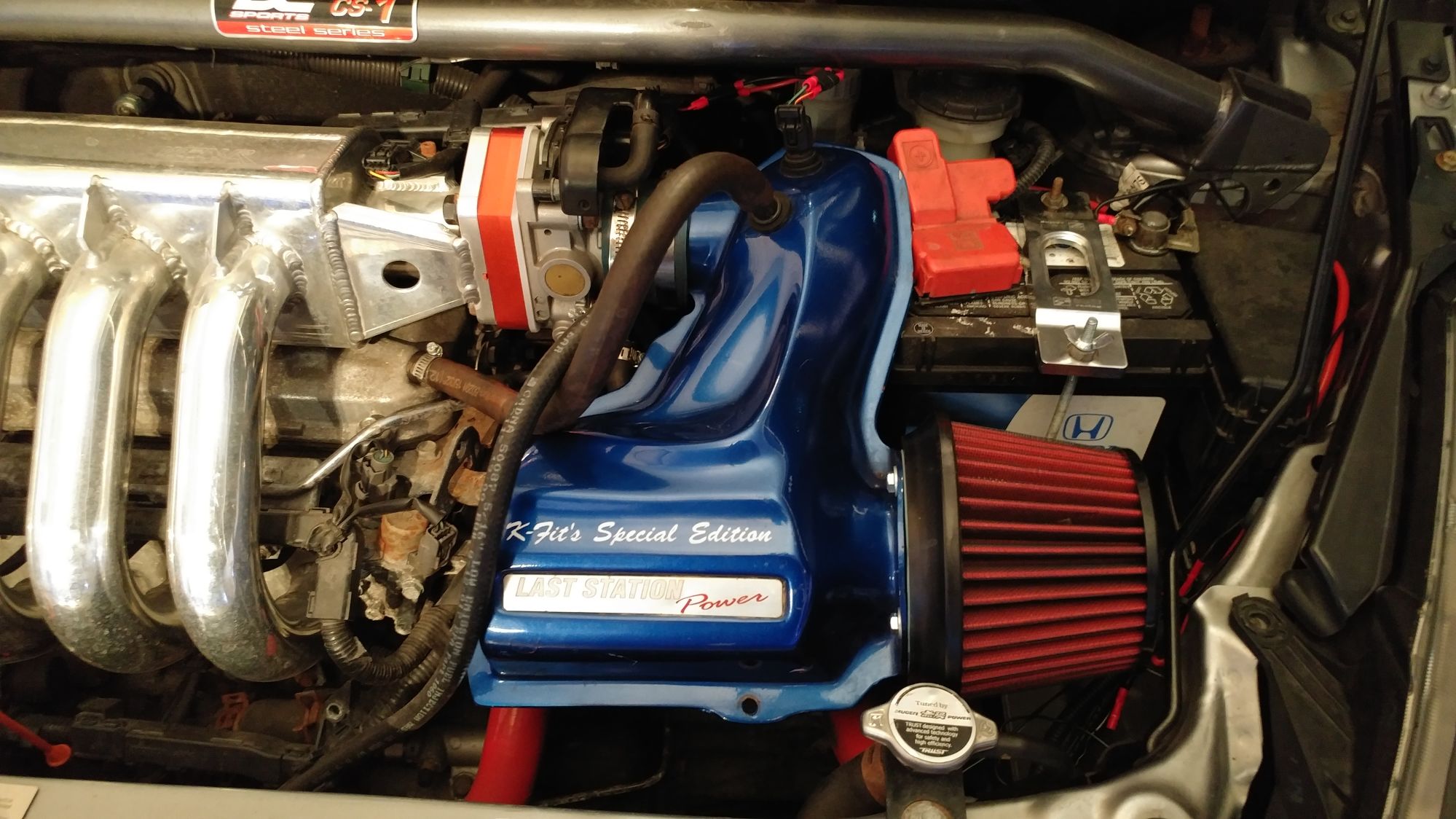

Well since my last post I've added:
Last Station chamber intake
Progress rear sway bar
Apexi SV axle back
Weapon R Race 2 piece headers
Megan mid-pipe

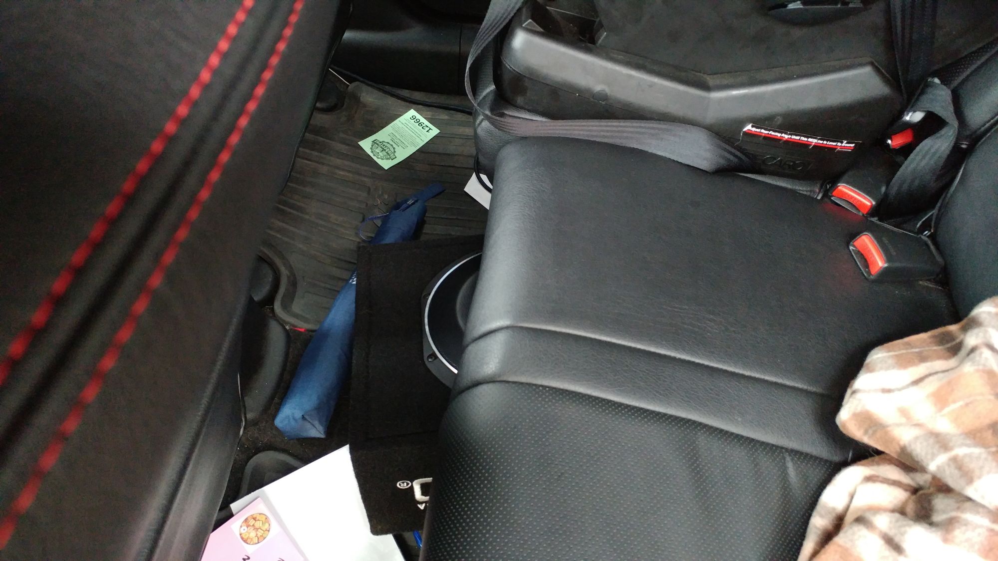

JL Audio 4 channel amp
JL Audio 10" enclosed sub (more boom and still fits under the back seat!)

cnordt24 where did you get that throttle body spacer from??

Ebay!! Same place i got the throttle body lol

What does the throttle body spacer do?

It helps improve the air flow in to the manifold which will increase HP and Torque. Given it won't be much on our little Fit motors, but every little bit helps

so you got a difference throttle body other than stock? is this a bigger throttle body

I'm using a throttle body from a 06-11 Civic. It's 55mm while the stock Fit throttle body is 50mm. It's also a direct bolt-on replacement to our stock throttle body, you will just need some longer hoses since the coolant nozzles face in different directions. Going from 50mm to 55mm may not sound like much, but every little bit helps and the R18 throttle bodies are fairly cheap (used for around $60). Plus being able to add a spacer is a nice upgrade too.

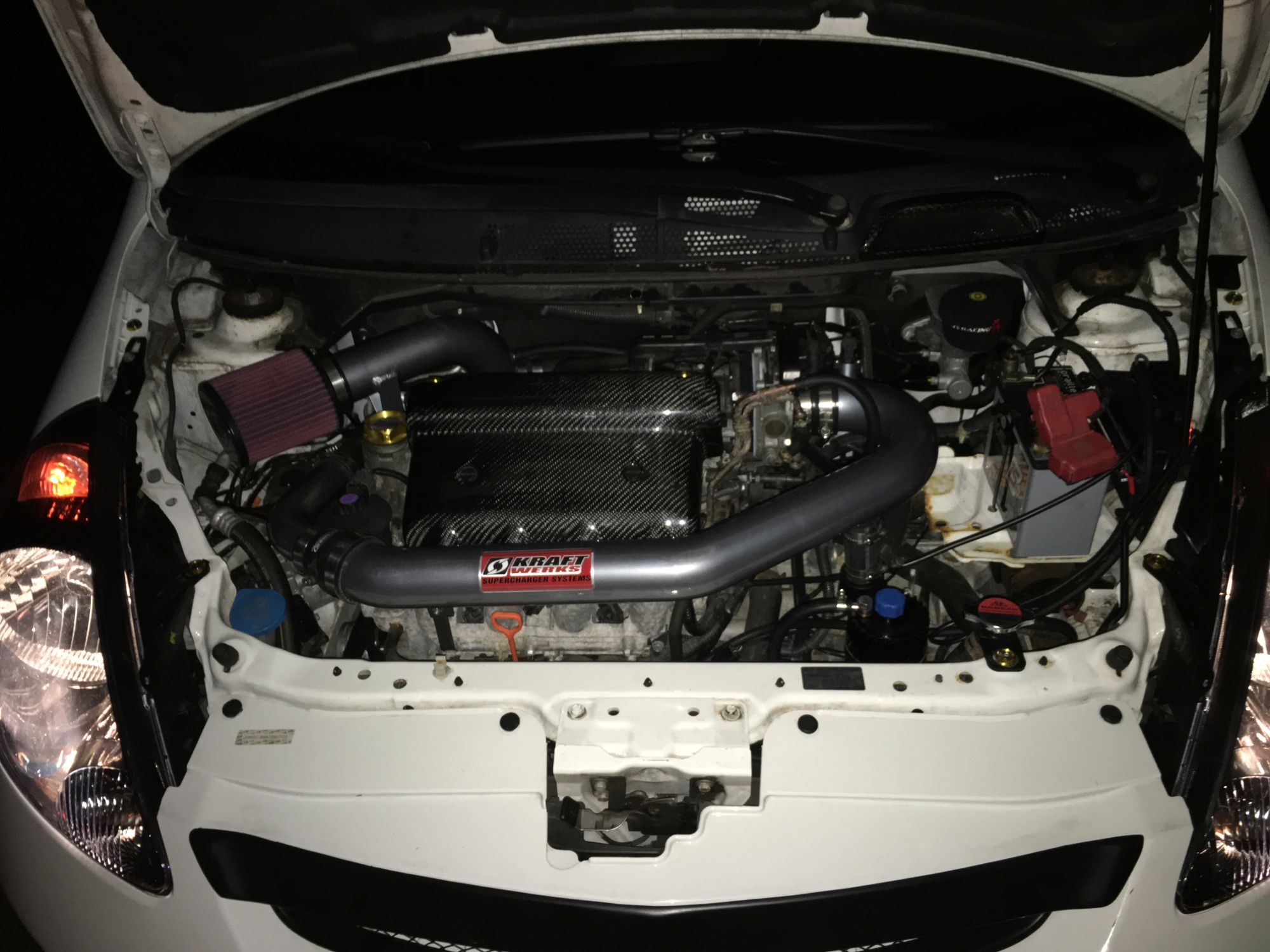

this happened
