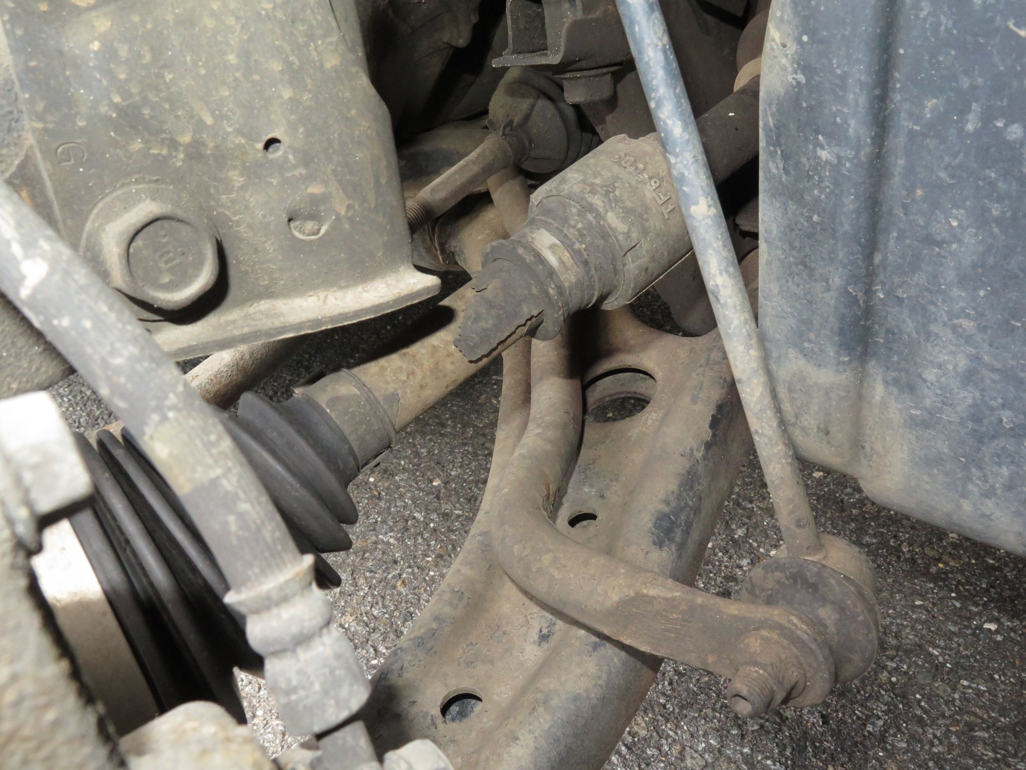

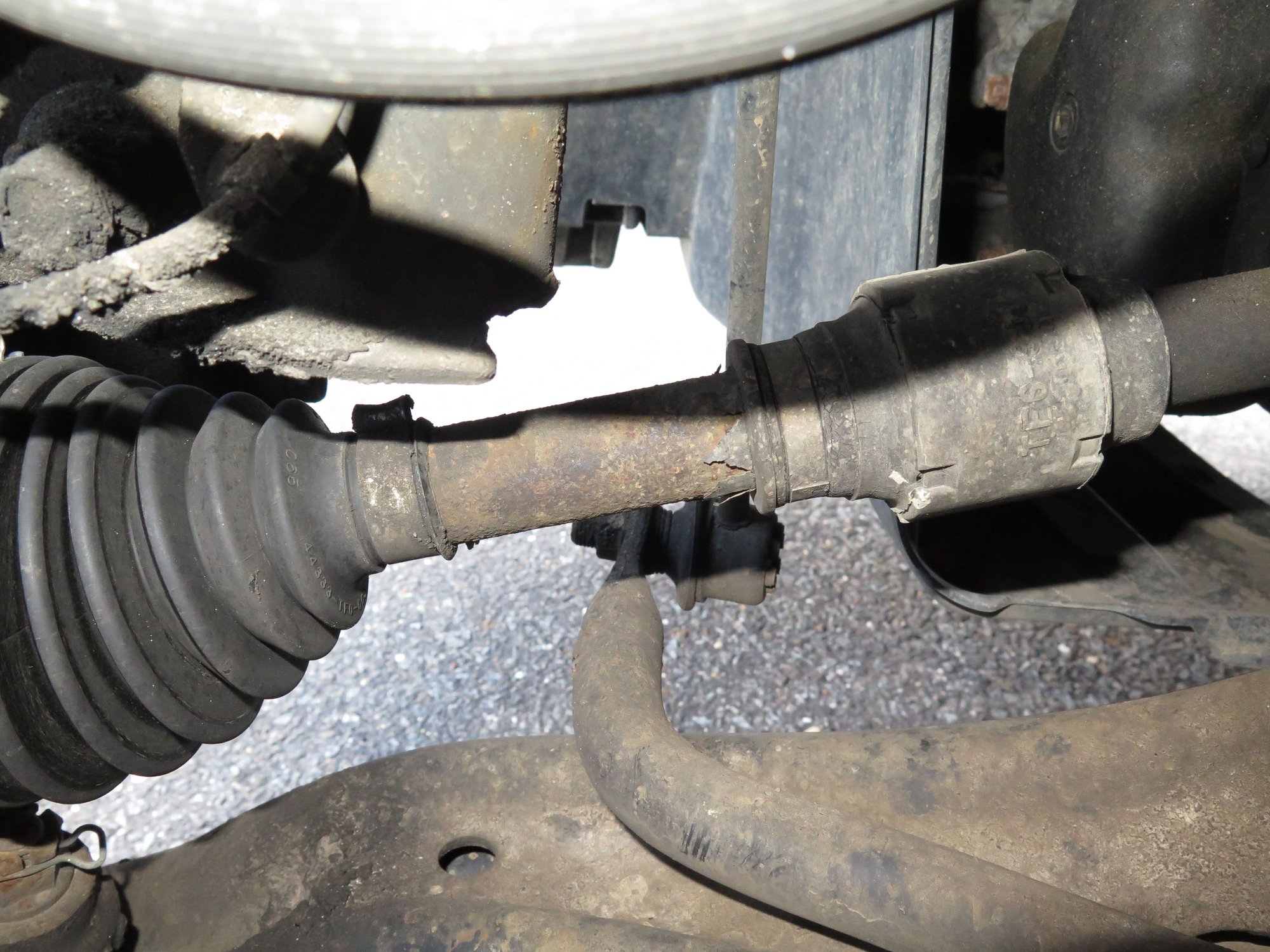

Took my 2010 Fit Sport Automatic 140,900 miles Tidewater Blue Metallic in today for the drive axle recall. Causeway Honda in Manahawkin, New Jersey.
First time my car has been back to the dealer since I bought it new in October 2009. Like some others on this forum, I don't like taking me car to the dealer, because you never know what kind of service you will get. Been following this thread and seeing that people have had the axle snap on them while driving. I know axles don't last forever anyway (usually the joints get worn), so I figured I'd take it in, as I would have to do it sooner or later anyway. I looked up the prices for the axle assembly on Benardi Honda's site: about $800 for each axle!!! I figured that would be about two grand at the dealer for parts and labor.
Yesterday I photos of both axles, here they are. I compared my axles to the photos in Honda's TSB, and figured that both would be eligible for replacement. I also took photos of my dashboard to show that there were no warning lights or CEL's on. Then I ran my OBD scanner and photoed that to show there were no codes. I just wanted a record of how the car was running before I took it in.
My appointment was for 1 pm; got there a little early and checked in, no problem. Went out to the showroom (basically no new cars on the lot because of the chip shortage), and a few minutes later the woman came out and told me I had three other recalls on the Fit (driver air bag, passenger air bag, and motion spring). I knew that beforehand, but was hoping they wouldn't bring it up, especially the air bags. I had read somewhere that a guy brought his Fit in for the axles and they said the dealer wouldn't release the car without doing the airbags, so I was kind of ready for that. I really didn't want to do the airbags due to some of the stuff I read about the dealers messing up the dashboard. I tried saying I'll schedule the airbags for next week, but they didn't go along with that. I sort of see their point: if the airbags went off after I left the dealer, I could probably sue them or something for letting me have an unsafe car back. So I gave it up and said to replace the bags.
About 15 minutes later, the tech that was going to do the work came out and I talked to him a bit. Asked if he would mind if I stood outside the bay and watched him work. Not that I was trying to see if he was screwing up, but because I just wanted to see the work. He said that was fine, so that was a good sign.
He did the driver's side airbag while the car was on the ground. Took about 15 minutes. They didn't have the passenger side in stock, so that side wasn't done. Fit went up on the lift (wish I had one), and he took the driver's side axle off first, then the passenger side. He brought over the axles so I could take a look at them; pretty interesting to look at when you can just hold them in your hand. The boots were in good shape, and the joints still turned nice and smoothly. Took a close look at the splines on each end; they looked in good shape also. Took pics of the old ones, will post another time. He then took the new ones out of the box; very nice!!!!!! I then walked away to wash the grease and dirt off my hands from the old axles, and when I got back about 10 minutes later, the car was back off the lift and ready. I told him "Man, that was fast!" He said he had done a lot of them in the last few months, and a white Fit an hour or two earlier that was in the bay next to my Fit. He took it for a spin. I asked him about the airbag and he showed me the old part. Crazy how a relatively small part like that could drive Takata into bankruptcy. He said that the passenger side airbag would be in tomorrow, but I'll do it next week instead. Bit surprised that they let my take the car without both bags being done, after what the woman told me earlier. It's fine by me though. He told me more about the motion spring replacement, but I'm not having that one done. He said it's a lot longer job with the engine work needed. Oh, I asked if I could take the old axles with me (I was going to saw them in half at the dampener to see if there was corrosion inside the shaft), but they said because it was a recall, Honda doesn't allow it. If I was having a non recall part replaced, the old one is mine if I want it.
The car wasn't realigned, but driving home it felt just like it always does. Maybe a bit smoother, maybe a bit quieter, maybe a bit tighter with the steering. Maybe my imagination after seeing those new beautiful axles. I'm going to check the ATF tomorrow (I forgot to ask if he had to add any), and I'll try and get some photos of the new axles.
In short, I was more than happy with the work Causeway Honda and the Tech guy did.
Sorry for the long post, but maybe it will be of use to someone. And thanks to everyone before me that made posts and pictures; they were a big help to me.
Driver's side, looking towards front of car.
Passenger side, looking towards rear of car.
