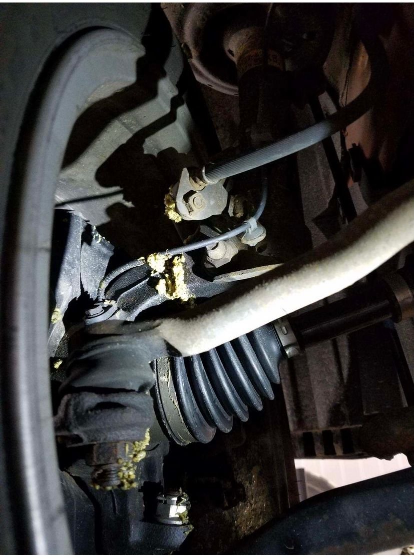

Heads up less than 2 months after recall replacement of drive shaft the rubber boot failed on drivers side. It split from metal clamp cutting/rubbing into it(not road debris) and grease was everywhere; a tech alerted me when getting an oil change. After Honda giving me crap (going to charge me for repair) I finally got to a manger who informed me rep that was trying to charge me to fix it was incorrect that warranty work/parts are covered for up to 12,000 miles. He said this was the 3rd one that came back that month to be re-fixed from warranty work as rubber boots are now failing. So keep an eye on them ugh!
Slit was on top side of rubber boot; tech took pic underneath during oil change.
The recall only covers the passenger side axle...on the m/t Fits.

From: Madison, WI
Honda replaced both mine no charge.

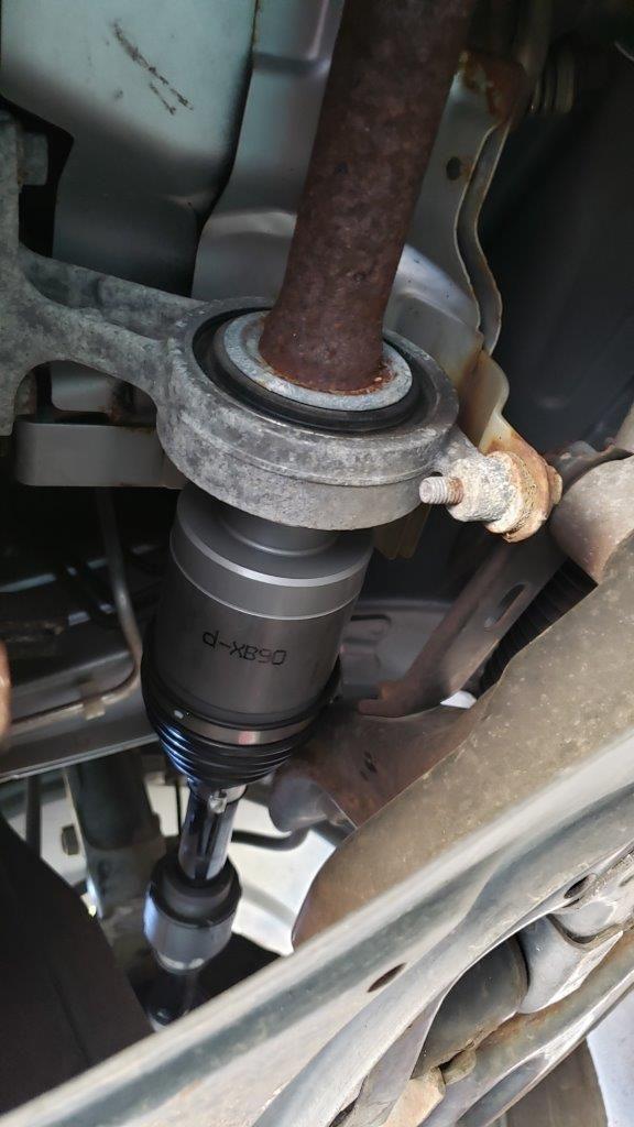

I have a '11 Sport w/ AT (~90k miles / road salt in winter / Southcentral Pennsylvania) and they change both at no charge. I don't have any 'before' pics but you can see the general condition on the rigid mounted half-shaft out of the trans on passenger side (not changed).
I notice that the CV joint performance was improved when I'd stop, put into reverse, to back into the driveway. No click / clunk sound as the slack was taken up in the reverse direction. No problem before these were changed, so all went smoothly. Pleasantly surprise about how the recall service went versus getting screwed (almost twice) on a Check Engine Light: $50 diagnostic, $50 labor, $170 Coil Pack when it was a lose spark plug, which they didn't touch, so the CEL came back on and they said it must be another Coil Pack. Luckily, I asked for the old Coil Pack and asked myself, 'why does it smell of gasoline and is black with soot?'. Two spark plugs were lose. Just to prove a point, I'm still using the 'supposedly' bad Coil Pack 40,000 miles later.

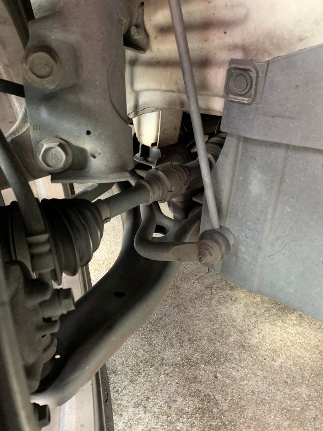

How do my shafts look? I have app scheduled with dealer
