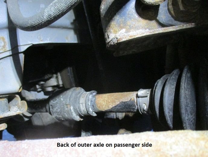

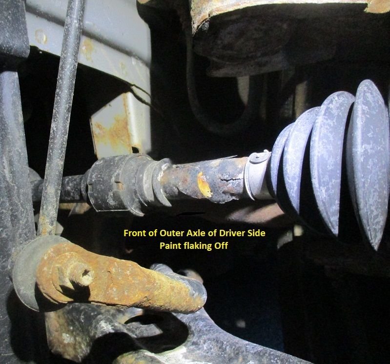

Took these tonight . Doesn't look good . Probably need both replaced . Plenty of rust is beneath flaking paint on the driver side .

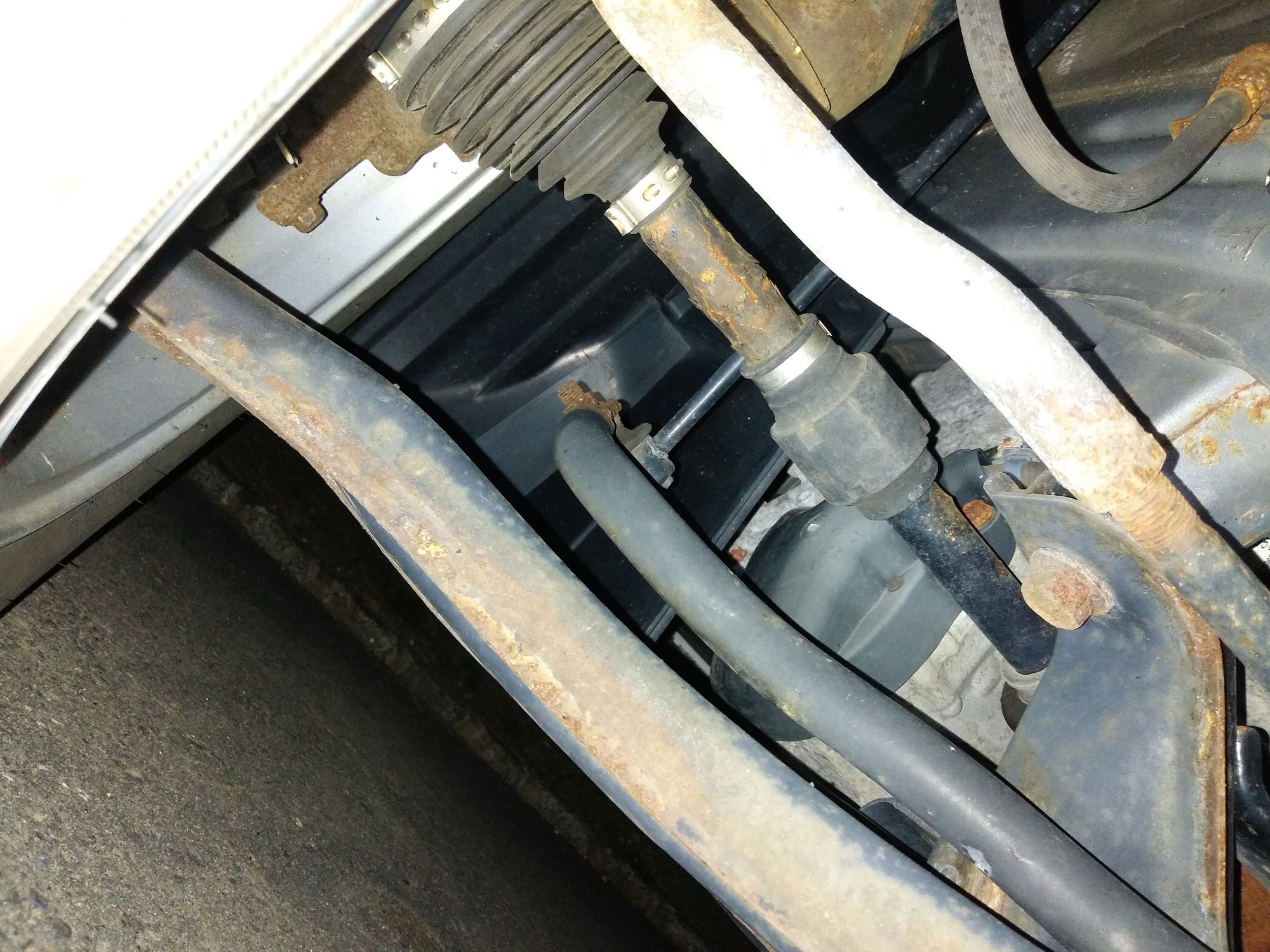

ugh. this looks ugly. This is after 13 winters. In New Jersey they brine the hell out of the roads.... whether the forecast calls for less than 1 inch or 20 inches of snow.

Looks like both are in need of replacing .

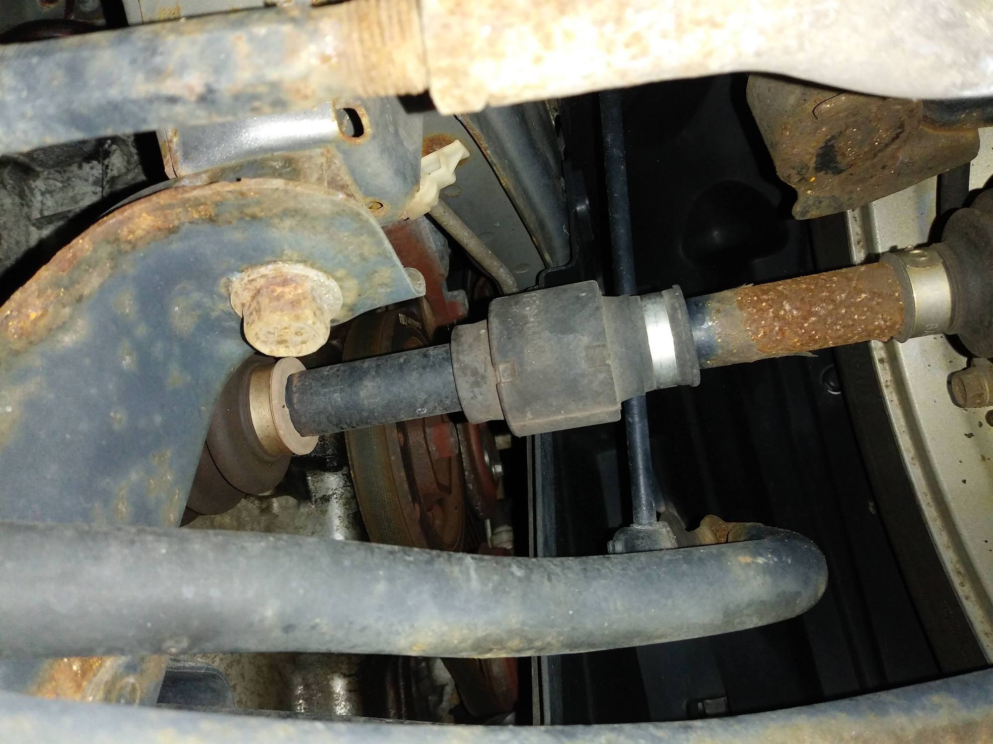

Same here. I changed my oil today and had a look at mine. They look all rusted without any paint. So I guess I'll be getting two new ones whenever I do the recall.

Do we dare to keep driving ? Doesn't mention not to drive in the 2nd notice . Not sure if we'd be liable if there's an accident due to the axle(s) .
Old Apr 7, 2021 | 10:27 PM
  #87
spin out's Avatar
Posts: 516
From: new jersey
After I got a look at mine last night (for the first time), I had the same thought. I became instantly wary of driving the car.
I talked to 2 local honda dealers today and one of them (a guy at Freehold Honda) didn't even know there was a recall.
The guy at Open Road Honda wasn't aware of any particular problems with the shaft actually snapping.
The thing that would worry me about the pics you took is that your passenger side looks similar (but no quite as bad) to the condition of punx45's when his snapped.

@spin out @Odie
Yes, they look worse then mine did when mine snapped. Check out the pic https://www.fitfreak.net/forums/2nd-...ml#post1456847
