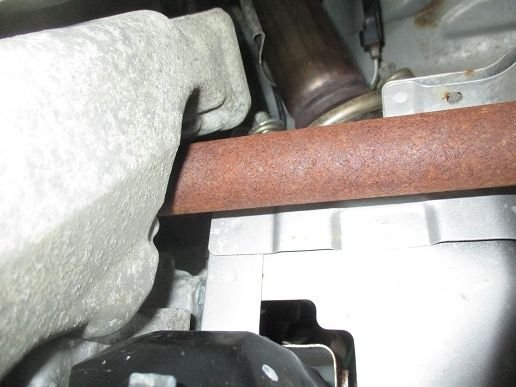

Question
Need to be concerned ? Took these yesterday of the passenger side . These are the larger part of the inner axle .

@Odie:
1) Looks like all of the coating on your axle is gone, and you have a layer of rust on the bare metal. So, I'm wondering how you lost all of the factory axle coating so completely.
2) How many miles on the car?
3) Where do you live, and what are the conditions (weather, salt, etc.)?
4) Looks like it's just surface rust, which may not be a crisis (yet).

N.E. , plenty of humidity , rain , snow , salt , dirt , etc.. 7 years of ownership and getting near 70,000 miles . The surface doesn't look as bad as Jacoblong09s' axle that broke . Our axle is smoother than rough . May have a little life left . Plan to get it done sooner than later .

That doesn't look that bad ... the surface is entirely uniform. If you had pitting, deformity etc, I would say the metal is weaker. I'd imagine they're unlikely to break until a decent amount of material is rusted away.
I'd still have it replaced, just saying, you may not be close to having it fail.

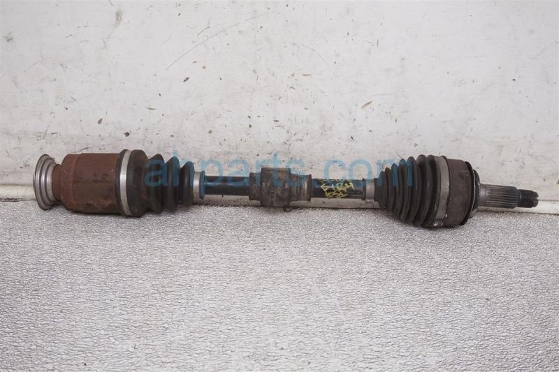

I'm not sure what this photo shows? All of the photos of the axle shafts that I've seen show the two short shafts with a rubber boot at each end and the damper in the middle. Like the photo I posted below. Could it be that the photo above is of a sway bar or other suspension component. I ain't no expert, so just asking....
