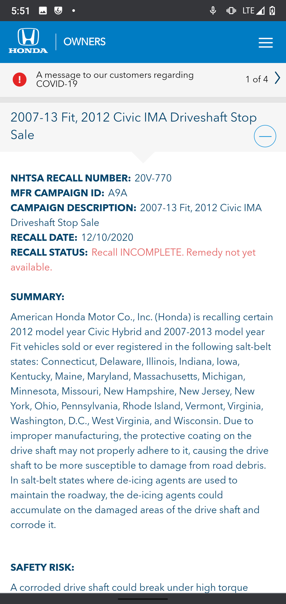

I have a manual transmission '09 and took it to the dealer for routine maintenance yesterday. They checked the axles and confirmed they need to be replaced via the recall, but they only have parts for automatic and are waiting for Honda regarding the manual version of the Fit. No ETA given – which was also the spirit of the recall letter. I suppose my options are to wait for a Honda response to the dealer or get them replaced myself. Sounds like getting reimbursed for the repairs done outside the recall scope is likely a dead-end?

Originally Posted by donlogan
After calling and scheduling an appointment to get the work done tomorrow, I received a call back today:
"We're sorry but the recall only applies to 2010 and up. Honda hasn't released the 'instructions' for 08 and 09. We will be in touch when they release the recall work for 09."
Anyone else experience this?
I'm curious if you guys see open recall info on the Honda Owners site for your cars. I have yet to get a notification, and I'm wondering if it's because my 1st gen has a manual transmission. My thinking is that they're probably prioritizing parts for the autos since the majority of cars sold have auto transmissions.

Driveshaft recall
I drive a 5MT 2012 sport, and recently a I had a cv shaft detach from the motor on the highway due to a bad motor mount loosening it up over time. My dad knows a guy who works for a dealership and does work at his house on the weekends and I brought the reca up to him.
He said they will only replace the shaft free of charge for the recall if the shaft breaks, due to rust hidden underneath the axle boots. If you are driving your car hard and "spin" your axle, honda won't cover that. He also told me that there is no remedy by honda yet, meaning that the recalled part gets replaced if it breaks, rather than repaired. If the axle is fine and there's no visible rust on the black shaft in between the boots, I wouldn't worry about it.
If there's rust there, take it to a dealer, have it looked at.
a remedy is not yet available, meaning that they won't replace it unless you bring it to them and ask for it, and even then probably not unless it's rusted

I have some interesting information to add. '09 Fit Sport M/T recently at the dealer for a state safety inspection. Was told they would inspect the driveshafts to see if I'm eligible for the safety recall. Told the right driveshaft is eligible. I look under the car, both driveshafts are completely devoid of paint, save for a few flakes near the CV boots. It turns out the recall notice reads "if there are (corrosion-related protective coating) deformities within 40mm of the dynamic damper, the drive shaft will be replaced for FREE." It turns out the '09 Fit M/T doesn't have a dynamic damper on the left driveshaft. You better believe I'm going to be bitching out the service manager, opening a case with Honda Customer Support, and filing a complaint with the NHTSA if I don't get both of my driveshafts replaced.
