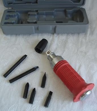

I just read your previous post where you are having problem with the screw holding the rotor,
if I may suggest,
for the next rotor change, it is best to use the Impact ScrewDriver
like this one for example:
1/2 inch Impact Screwdriver Set with Case and Phillips and slotted bits with 1-3/8 1/2 inch Impact Screwdriver Set with Case and Phillips and slotted bits with 1-3/8" and 15/16" shanks (six bits total) - Amazon.com
where you HAMMERED the screwdriver with a hammer which mean the shock/vibration help loosened the
screw and at the same time drove deeper to the screw grove so you won't strip the screw and
it also move the screw counter clockwise by each hammer blow...
or you can also use the Impact Power tools (which is even better)...
This way, you will not strip the head of the screw.
(Please take note that the amazon item above is just for example,
I bought that item and the bit that came with it is actually weaker than the Honda screw,
so don't buy the item above but just used it as example...
well I got cheap on this one only $16 shipped hahaha, I should buy a better impact screwdriver...,
yeah, I actually strip the socket bit that came with this impact screwdriver and the screw is fine...)...
also, those screw actually help center the rotor (beside the hub),
that is why Honda use 2 screw instead of one screw,
so if you can, it is best to always use the screw, so your rotor will be perfectly centered.
This screw actually enable you to upgrade to a larger/other Honda OEM rotor (but same PCD) which might have a larger center bore hole without the need of putting a hubcentric ring... and it will still be perfectly centered and balanced/no vibration.
edit:
also if you don't use the screw anymore, the thread (hole) on the hub will be corroded or filled with dirt from time to time,
and if somehow in the future you actually going to need to use it, the thread might be already broken...,
so it is best to use the screw again.
and applying an antiseize cream would help prevent it from seizing again later.

Thanks for the suggestion. I did actually have an impact driver like the one you pictured (just a hand tool, not powered or pneumatic). That still didn't do it. Perhaps a pneumatic tool would've done the job, but I don't own one and wasn't gonna buy one just for this, and then have it still possibly not work. So a 7/64" titanium easy-out bit set did the trick. Was still a pain though of course. As per using the screws in the future, I can't imagine a real world situation that would require having them. Like I said, once the wheels and lug nuts are on the rotors are held in place. I'll just make sure not to knock the rotors and calipers around when I remove front wheels in the future. I may end up getting two screws though, just one for each side, and using anti-seize on them, just so I don't have to worry about them moving around when changing wheels/rotating tires, what have you... But just one screw on each rotor, two seems asinine.
Make sure to post pics once your strut/brake master bar and battery tie down are installed.

I have found that when removing these screws with a hammer impact to set the tool to tighten first give it a couple of whacks then turn it to remove. Worked every time for me.
ps: found this out by mistake set it wrong first then discovered the mistake. Worked so good I tried it on the other side and do it all the time now.
