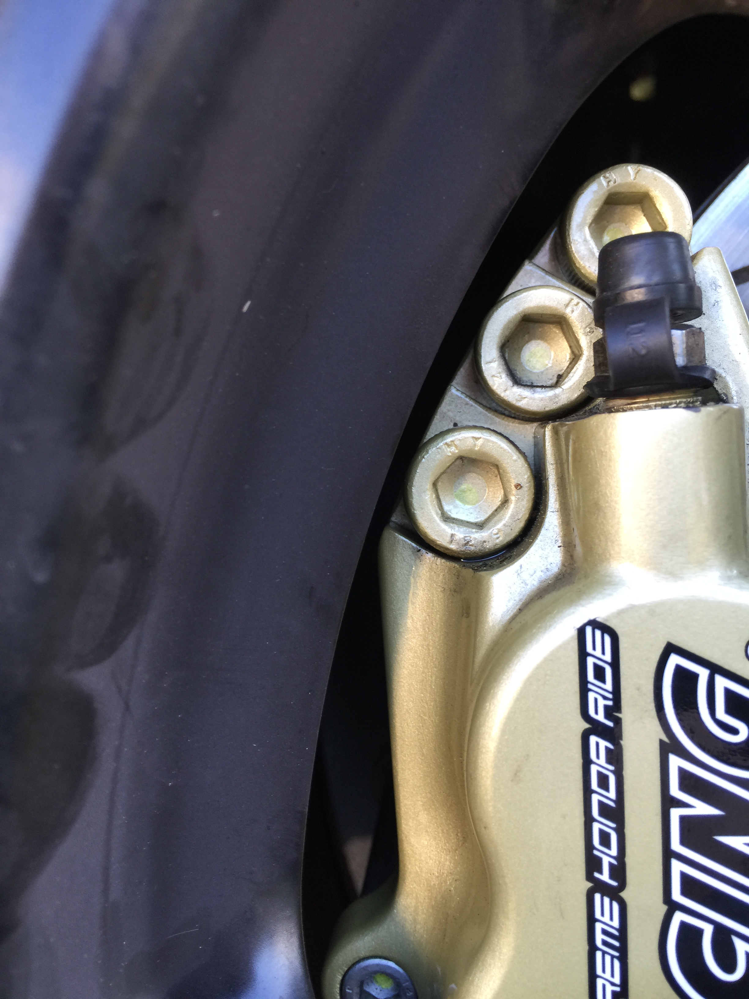

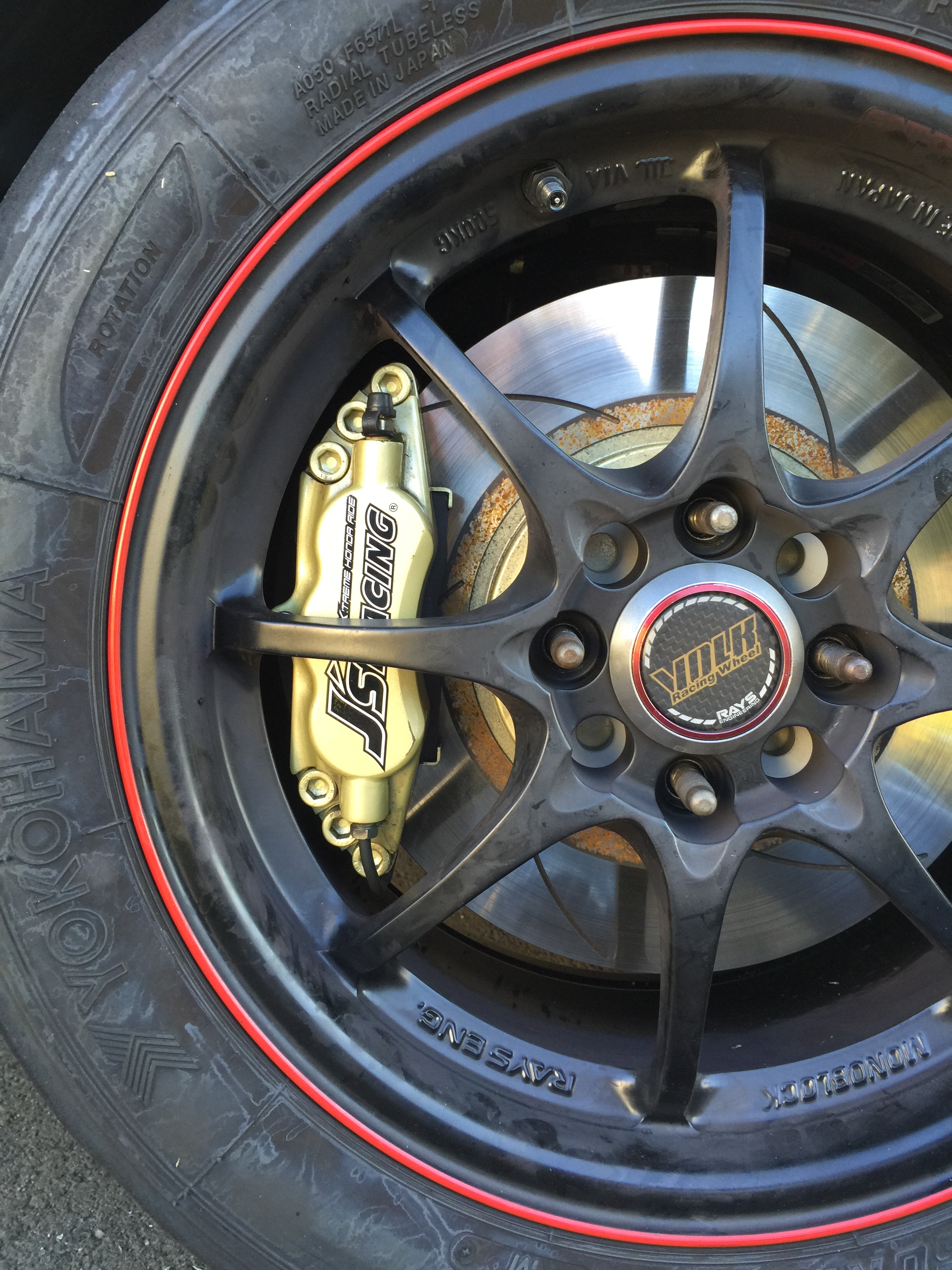

Did some test fitting of my 15" CE28s, they are +43, but the spokes were just touching the caliper, so added the 10mm H&R spacers and that gives plenty of spoke clearance.

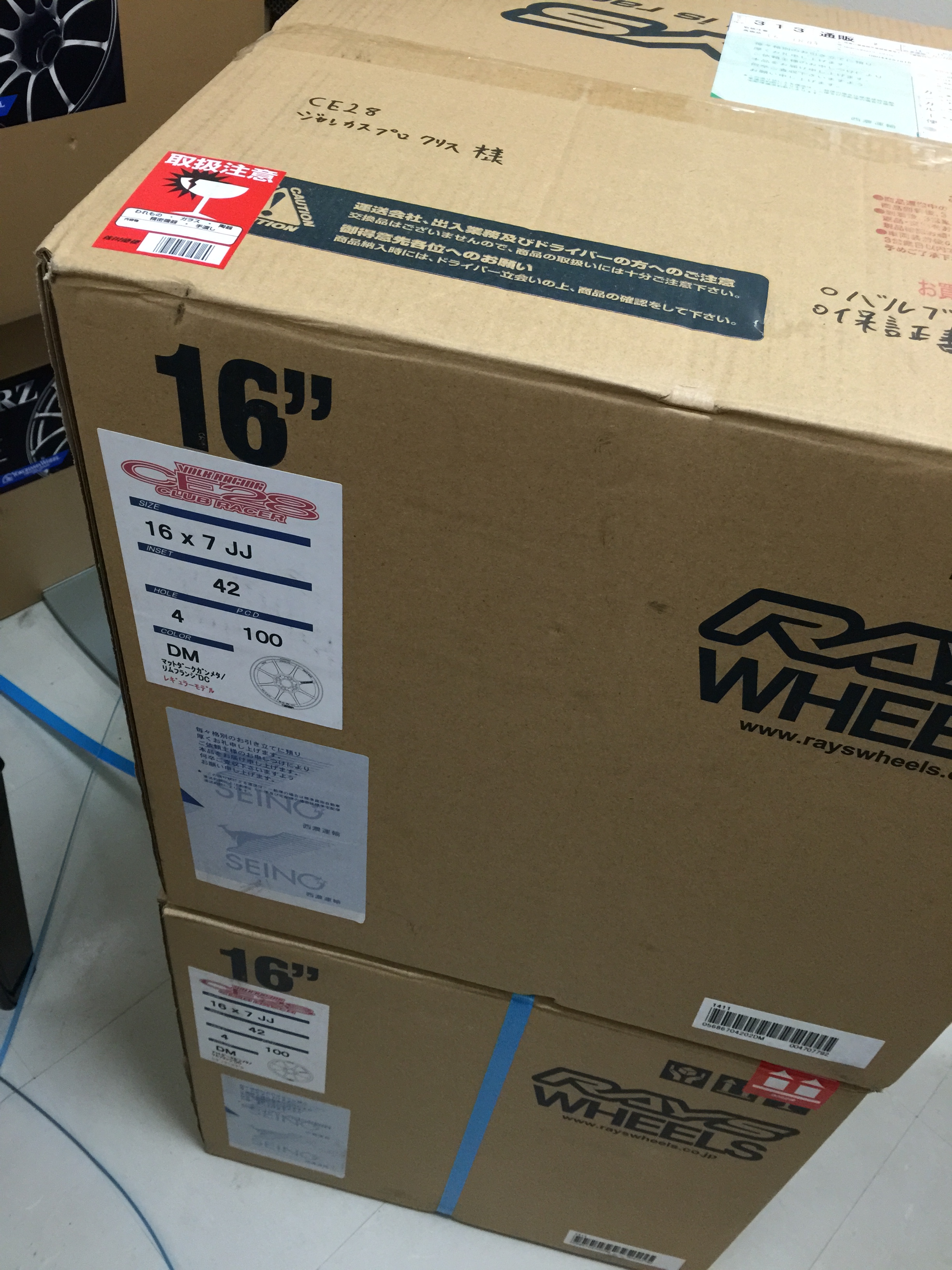

Then tonight was called by Seino to pick up a couple boxes...

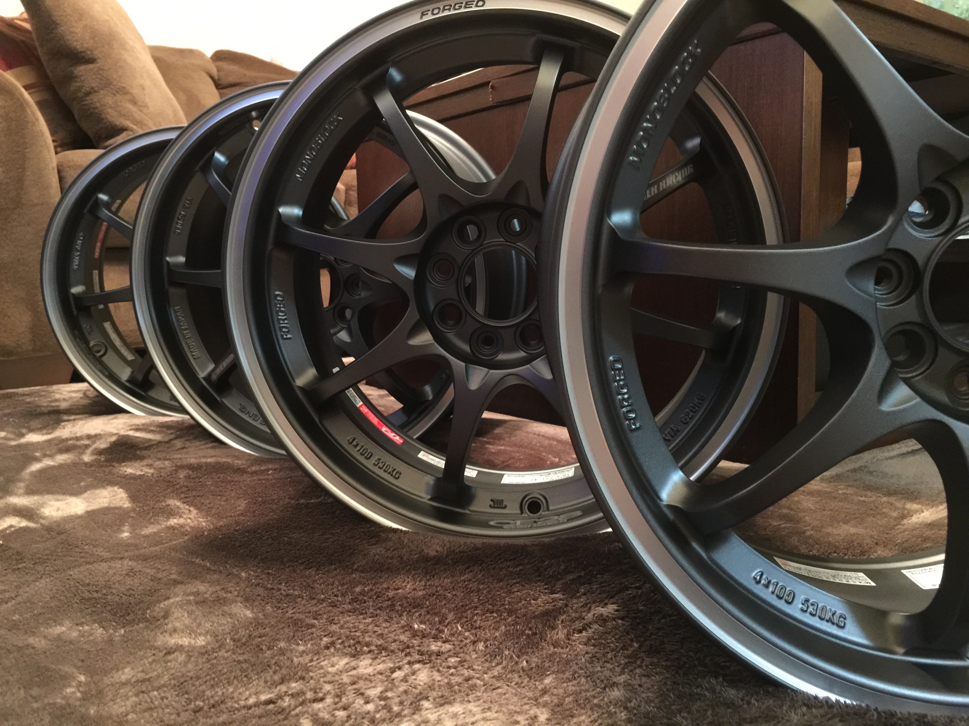

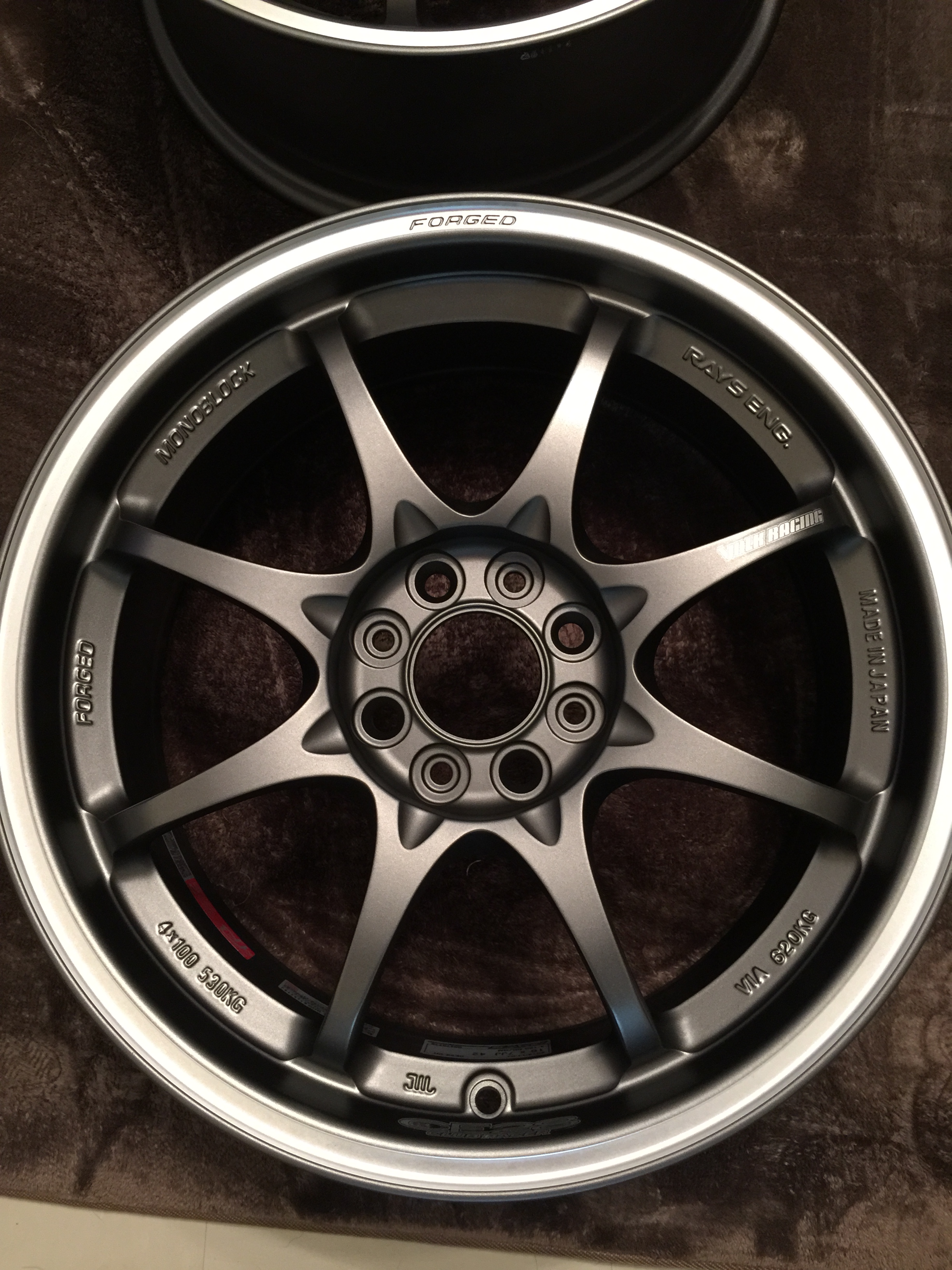

These things are nice and light, 16x7" and just 4.9kg (10.8lbs). Now deciding to go with A050s or just go with AD08Rs, probably A050s as I bought these specifically to use on circuit. When the bronze CE28s come in, they'll probably get AD08Rs.

That is a super tight fit between the caliper and wheel. I might even expect some rubbing if the metal starts expanding to do super heated brakes.

To be fair it's very hard to tell how much space there is from that picture. Track cars often have very low wheel/caliper clearances.
