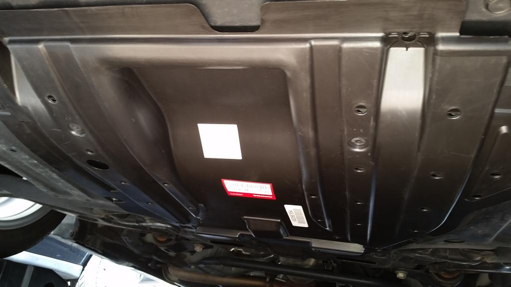

Installed my CRZ undertray today. almost a perfect fit. shaved the corners down a little bit with my dremel to get it to sit flusher. used most of the oem holes from the undertray and drilled corresponding holes on the FIT OEM underpanels. used a bunch of 8mm bumper clips to hold it down.

May have to do this. It looks great

That would probably keep down on the dirt that comes into the engine bay. It'd be a pain for oil changes, though.

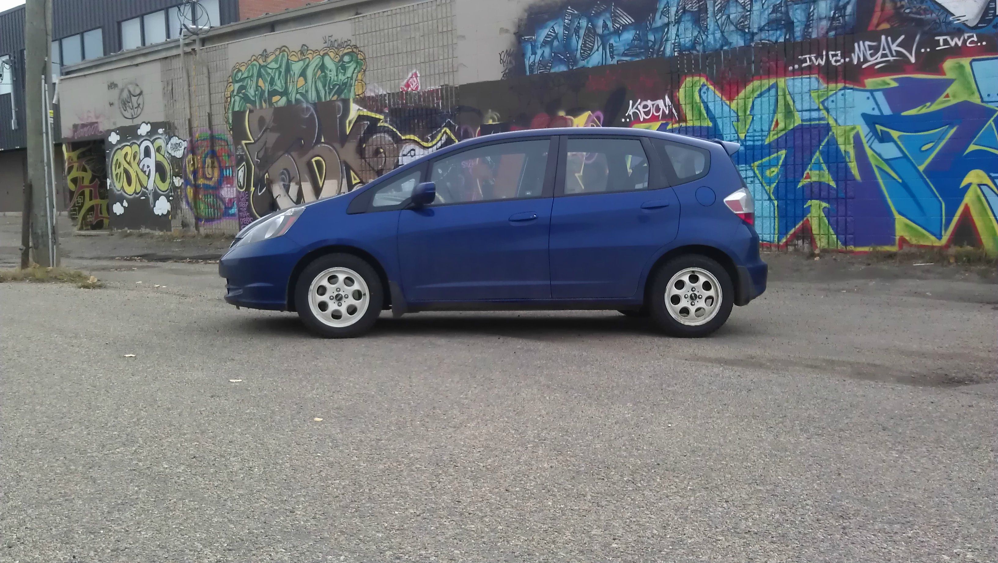

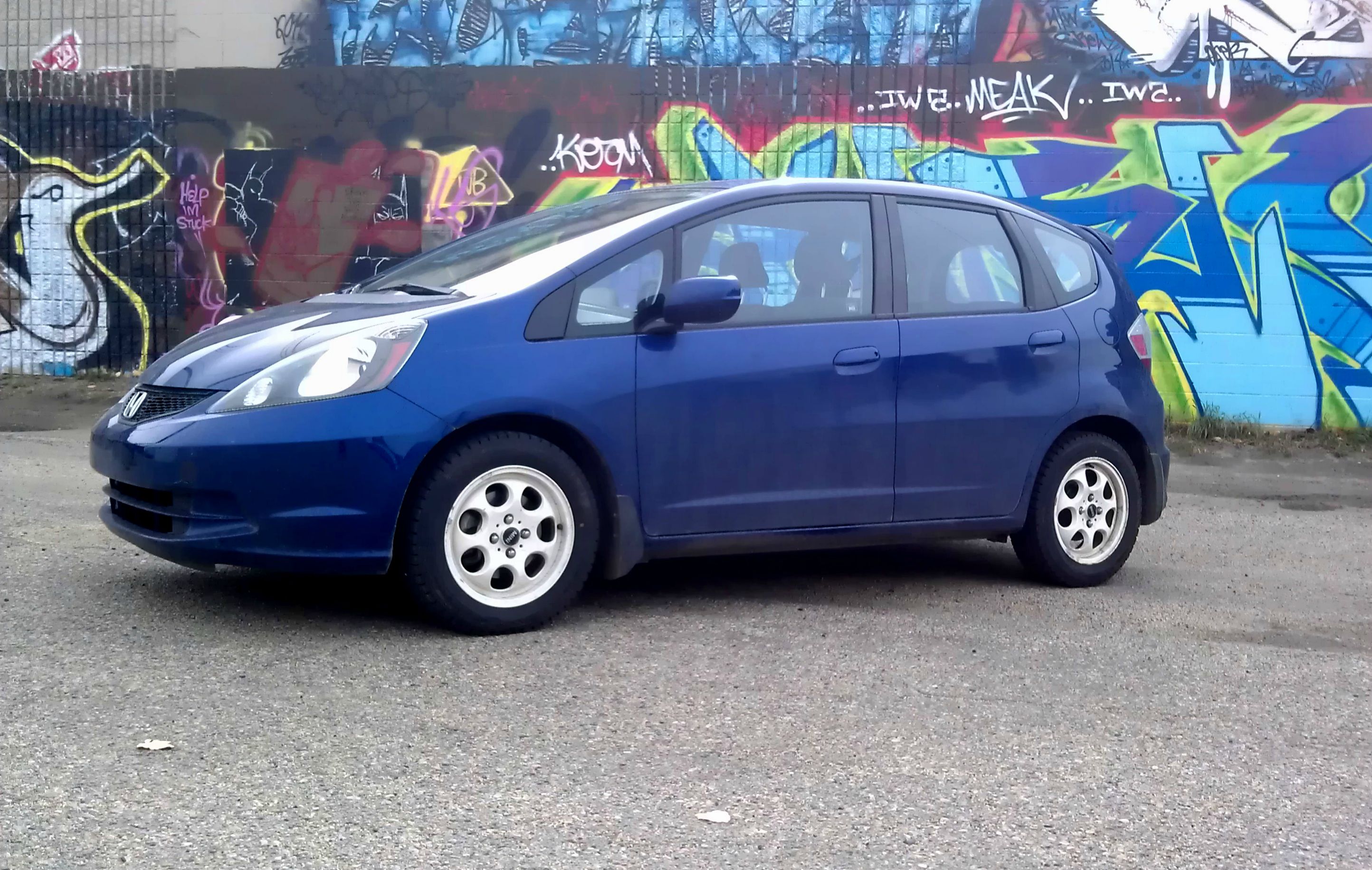

Forgot to include picture of the R81's!

Is this a Honda Part or aftermarket? How much did it cost and where did you get it? Why did you chose this one? And how does it compare with the Beatrush Aluminum Under Panel?

dealer does mine anyway. 6 clips and its off.

theres a thread here somewhere about it. its the CRZ lower engine cover. Part 74111-TM8-A00. $38 from Bernardi. this is an OEM part. beatrush is a little different. it has vents/louvres for hot air to exit i suppose. the price is much more considerable too. $100-150 from japan and it has to be made before u get it. it took bernardi two days to get the crz tray to me.

Nice undertray install, very clean!

Kinda want for them MPG gains. $38 is nice too.

yep, same reason i got it. thinking of devising a removal grill block too for when it gets colder. maybe i'll just block up the mugen grill instead of the bottom grill in front of the radiator....

That under tray will definitely prolong the metals in snow belt states where salt is used.

When I check the Beatrush is 238. This looks good, I will definitely have to check this out. Did you have to drill any metal? And did the "bunch of 8mm bumper clips" come from Bernardi, do you know about how many you used and do you happen to have have a part number for the clips? How secure do you feel about the attachment that it will not come loose on the highway?

drilling was done to other plastic under panels. it didnt come with the bumper clips. i bought a bunch of 8mm bumper clips from amazon. i'll find out today when i drive if it falls out.

In the thread "CRZ Aero engine under panel installed on my Fit",
Mini-Odessey says he used 2 screws as well:
"The 2 front screws are actually fairing screws from a Honda VFR800, this is neat because the screws have a fat blank unthreaded section that allows it to be tightened without stressing the plastic or over torquing it. The front 2 screws mounts do have threading from the factory that lines up, what you have to do is drill holes through the factory Fit plastic under panel and you will see 2 metal tabs that has threads that already exists."
Sounds and looks good but I have no clue where to get "fairing screws from a Honda VFR800" or the equivalent.

The internet. You can literally google it.
OR
Go to a Honda Powersports dealership/service center and ask for that.
Not very hard.

Maybe ill try out those fairing screws. I did get an 8mm clip to fit in that metal hole

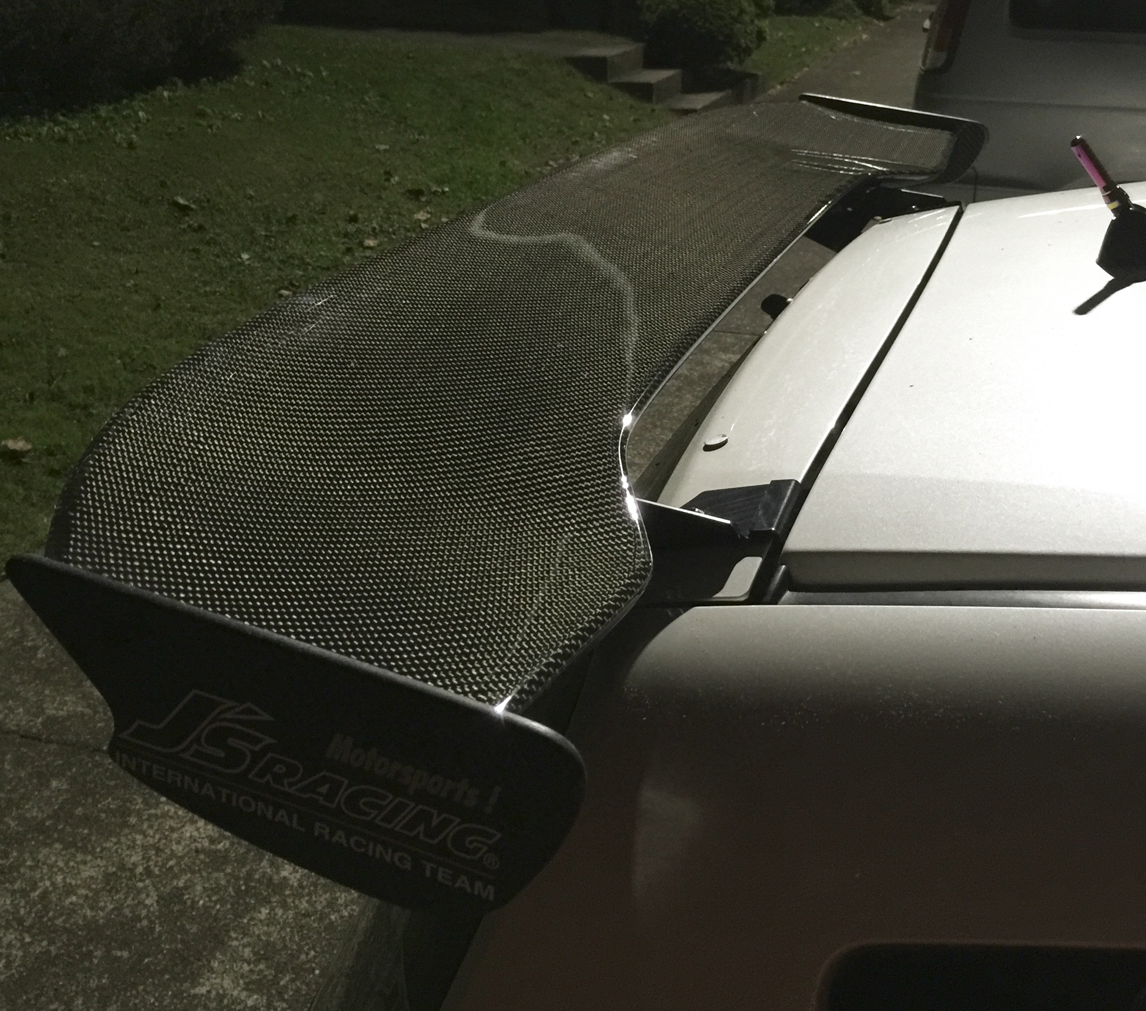

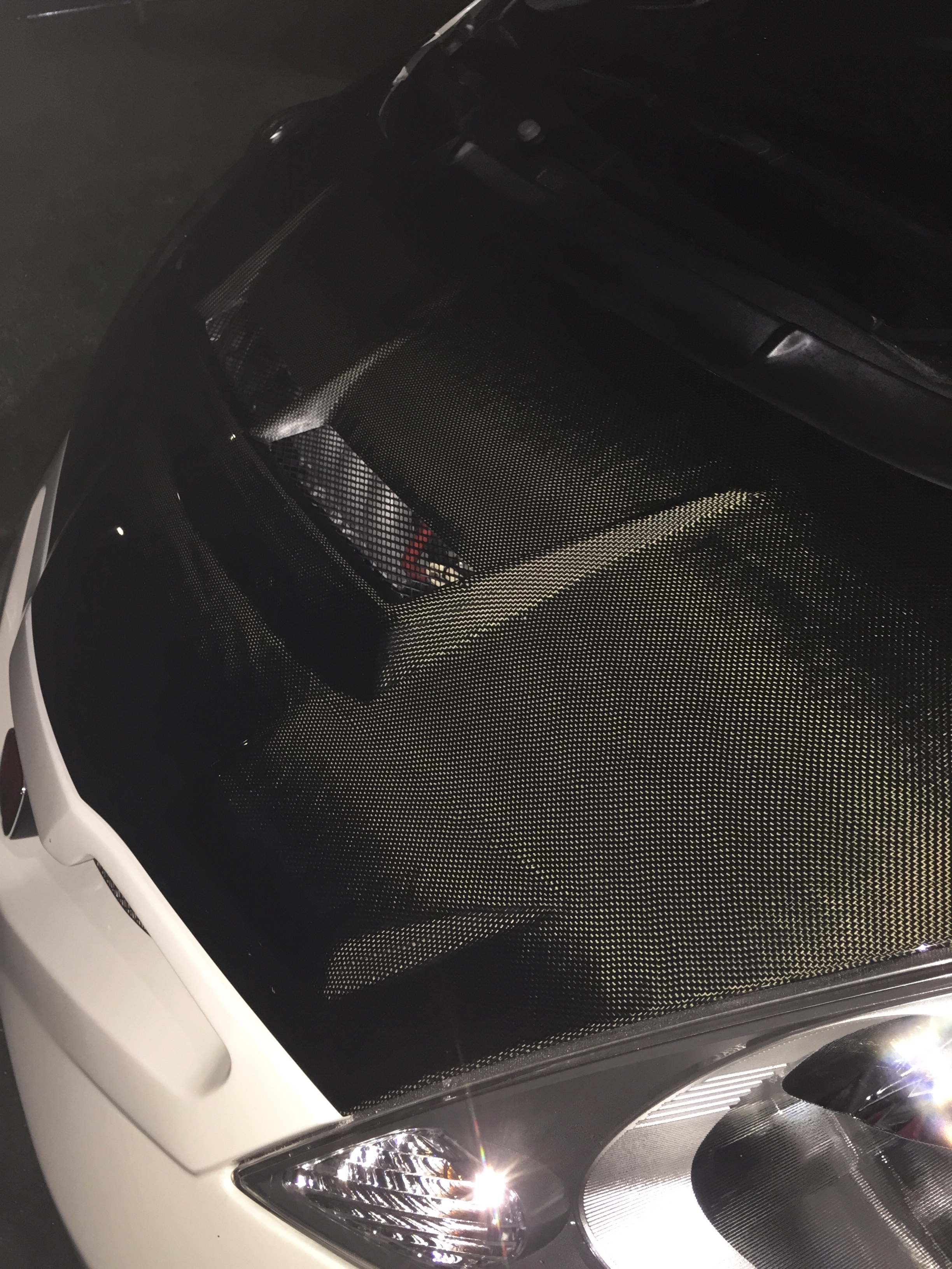

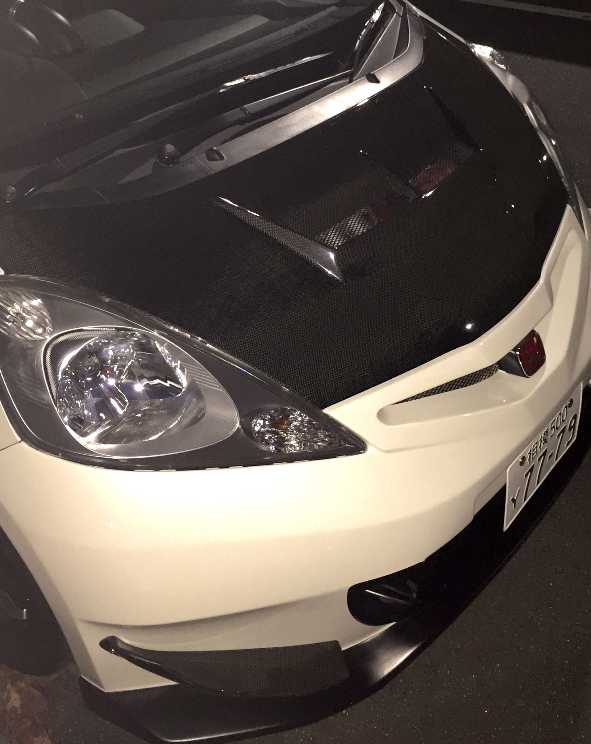

Did a quick wash, clean, polish and wax of my carbon pieces. The diffuser was in much need, but no picture of it as it was already dark and of course it sits at the bottom of the car.

Used Marine21 products for this. Have a typhoon possibly coming our way, so the added salt would just love to Richard with the finish.
