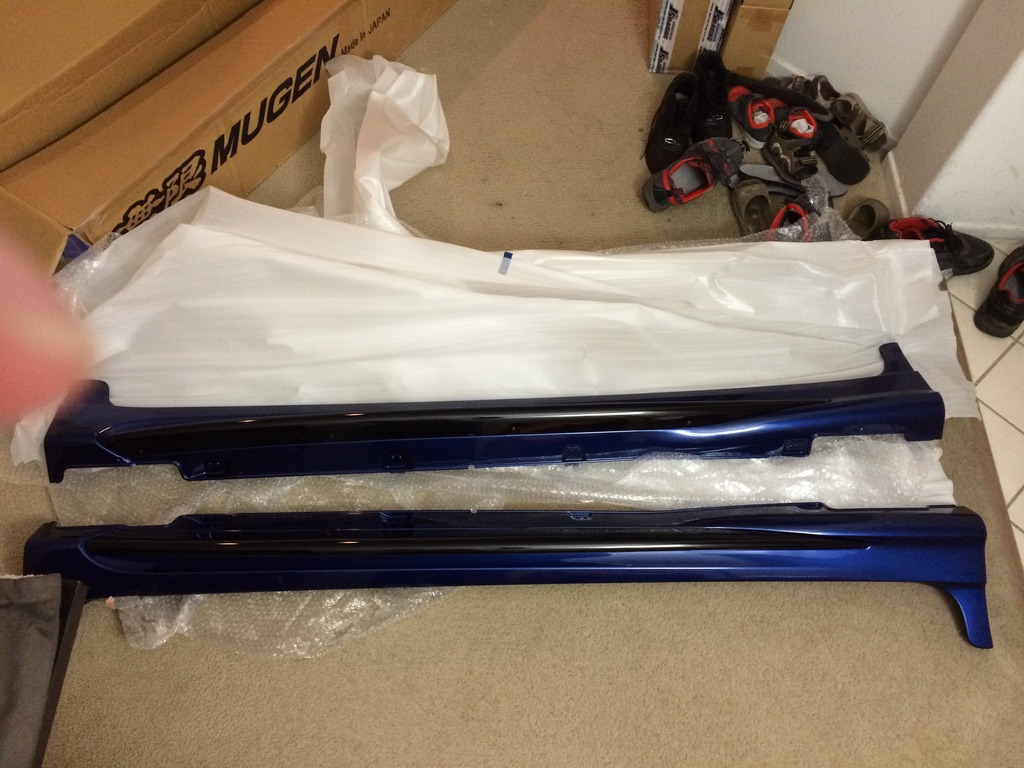

Mugen & J's Racing :)
My JDM Fit RS Mugen Side Skirt just arrived,
unfortunately Mugen already stop producing this,
so there is no longer Pearl White Color,
and the one available is Grey and This Blue,...
so I choose this Blue,
Hopefully, the Body Shop will have no problem painting this to Taffeta White
I will create separate DIY Thread once I paint and install this:

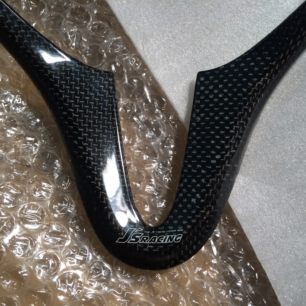

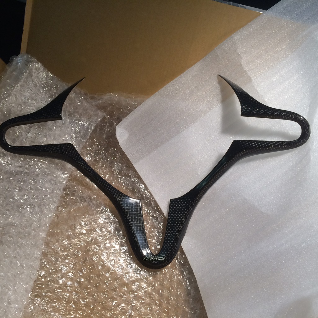

and all the item I want to buy from J's Racing also arrive today...
so J's Racing Shopping is done
This J's Racing Carbon Steering Wheel are a bit smaller then our stock steering,
and they look much better in real than in this pictures...
