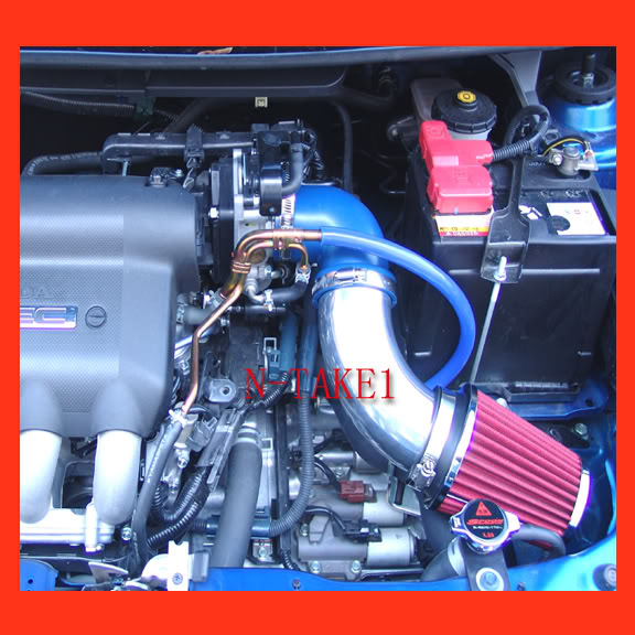

How does the ebay Intake for 50$ compare to the SSR intake? I'm wondering if this would be a better buy since the SSR intake piping is plastic, and you would to modify the MAF sensor hole yourself. The Ebay kit would be cheaper, have an aluminum piping, no modifications, and be a cheaper price. Let me know if anyone of you have tried or seen this. Thanks
HONDA FIT JAZZ 1.5 1.5L AIR INTAKE 2006-2008 - eBay (item 160528508995 end time Jan-13-11 19:34:41 PST)

is there a separate clamp or something i need to buy to connect the two 90s together?
Old Apr 27, 2011 | 10:33 PM
  #287
cr4zy3lgato's Avatar
Posts: 759
From: Quebec city
depends on what you get, with Sid's elbows it's not needed... but i went with aluminium elbows and had to get a silicone coupler
