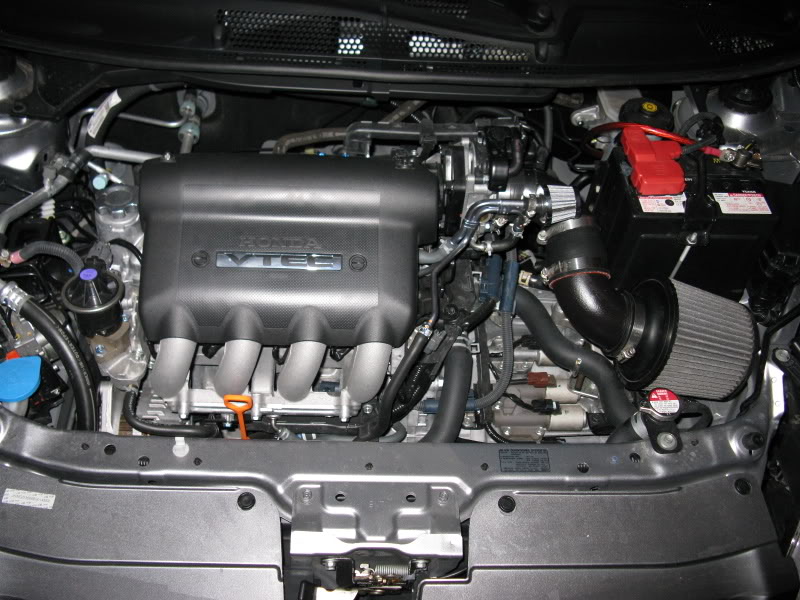

Built from my old AEM CAI that used to be on my 2001 civic ex. Used a dryflow filter and painted it black. Its a little loud for me, but the hp and mpg is worth it. Thanks SID for the idea!
lookin good
