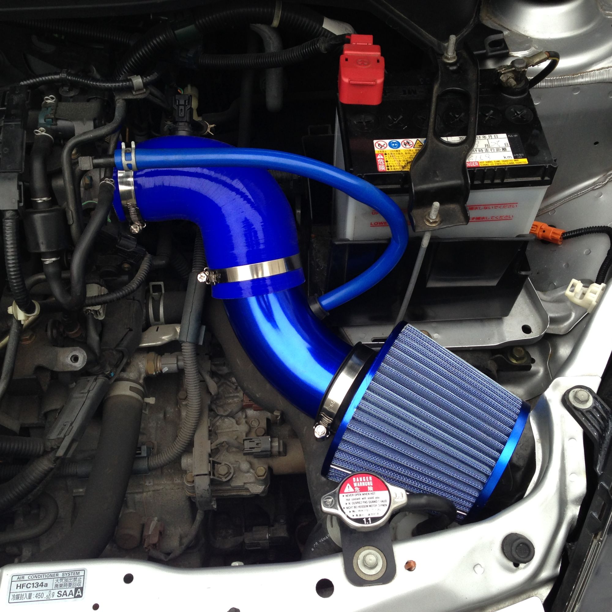

Just did this last weekend, and I'm very happy with the performance and fuel consumption. I've spent only $45.
Attached Thumbnails ***The Official SSR Intake DIY Thread (Sid Short Ram Intake)***-80-intake_1_18e25dd7c9251a4bdfca7bd299573d872037fb8b.jpg
