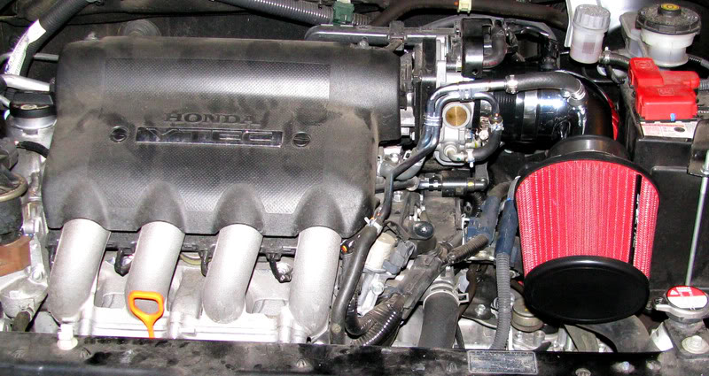

Well, I finally made my intake and it only cost $45 using the parts from O'riely and Advanced Auto, I only made one in hopes of better mpg :

oh my god clean your engine bay!!
all that dust is going to make ME sneeze
Old Oct 4, 2008 | 06:28 PM
  #146
Texas Coyote's Avatar
Posts: 7,388
From: Anderson County Texas
That will work. That is the same type of filter that mine has, the throttle body side is funnel shaped and and works like a velocity stack. Don't believe anyone that says that it will use more fuel, because the engine management system will compensate for the additional air flow and the air to fuel ratio will remain the same. Also the drive by wire throttle body will not open as much at low RPMs which in turn increases intake velocity and increases torque. As for the dust, mine is much dustier than that. If I washed it off every time it got that way I would be a busy man. Country living, I would guess. Dust is a small price to pay when you get to drive on roads that twist and turn and go up and down hills.

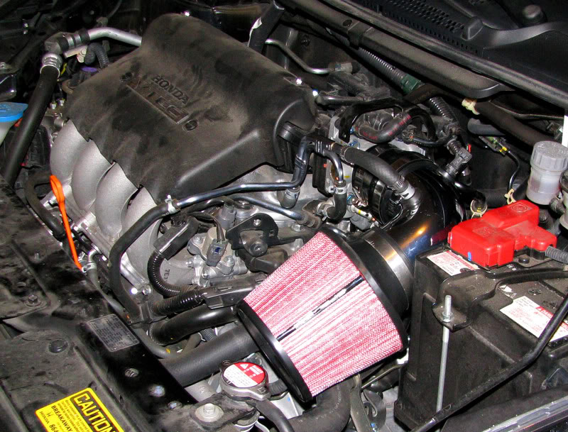

so i finished up my intake. couldnt take pictures last night because i did it in the dark and all i have is a crappy camera phone. these are the best i could get:
im gonna change the 60 to a 90 when autozone gets more in. the filters rubbing up against some shit but for now it works!
thanks sid for a great diy!

Anyone know if it would be possible to turn this into a CAI? I might try it and see what I come up with.
Also, did anyone have any problems with their filter rubbing what looks like the radiator hose? How did you guys fix it?

I loosened the radiator hose clamp and gave it a little twist , doesn't touch it now.
