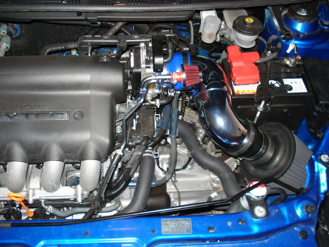

Well I wound up taking it off, for a number of reasons. I wanted the top-end back (either it's leaning out above 6k or starving, likely the former judging by the drone in the sound), the ongoing filter rubbing issue, and my lack of faith in anything plastic. In my defense there wasn't any loosening over 100 miles, nor any heat warping, but my uneasiness won out.
I'm sure it will be remade eventually with welded 2.5" pipe sections into a new 2.5" filter instead of my old crappy one. I'll probably include a tab that bolts down to that tranny mount for the stock airbox I've been fighting. I still give props to Sid for coming up with a cheap enough way for me to try it out to see if a short ram is worth it.
Until then, I gotta live without that sweet sweet sound, darn it all.

Have you considered that the increase in low end response could be giving you the illusion that the performance has fallen off on the top end? It may feel that way, but is probably the same performance as stock at higher revs. I went to a muffler shop and they put together a 2 1/2" axle back pipe with an 18" glass pack topped off with a tip I ordered from J.C. Whitney. I can't remember what the tip cost me, but the rest was about $80.00 and the stock pipe and muffler is sitting in the barn with less than 500 miles on it. It sounds better than any aftermarket pipe I've heard so far. It might make a difference. I think that mine did. The intake might work better with only one elbow, I don't think there is any noticeable difference in intake temperature with one elbow and the air flow would be more direct.

I have to give you credit for eye appeal, looks really nice. There is no way that it is leaning out or starving, because the air to fuel ratio is managed by the oxygen sensor, and the CEL would light up if it wasn't right. I would use the camera on the stock filter first, accelerating in 2nd gear from whatever rpm that your car starts to pull from till the limiter kicks in, then time it with a stopwatch between different points on the tachometer, write the figures down, then repeat using your trick intake. I hope that you come up with positive results. I don't see how you wouldn't. Good Luck.

It is possible for a GD3 to run lean. There is no mass airflow sensor and the o2 sensors are narrowband. That means when your right foot hits the floor and the throttle opens up, all the ECU sees as far as airflow sensors is the MAP reading about a bar and the IAT. (narrowband o2 sensor is useless at full throttle because it only reads rich/lean; it can't tell between a 12.5:1 rich and 14.5:1 rich, which is actually lean for the conditions.)
I was hoping the video would pick up the droning sound over 6k. It was literally such a loud hum that it made my ears pop. I think it's the 3" piping in conjuction with tight bends allowing the pressure waves to pile up on one another.

From the videos, I used a stopwatch from 4k to redline a few times for both, and came up with about 3.9 sec for the first one and 4.0 sec for the second one. Pretty much within a margin of error so no conclusive evidence.
I'm not giving up on this quite yet, just need to revise the setup. I'm still thinking 2.5" will give better laminar flow and get rid of that loudness. Besides I don't want to be wearing through filters every 1000 miles like I would be now! Dang airbox mount.
And yes, I drove it to work with the stock airbox and I miss the Sid intake already. It had more part-throttle pep.
