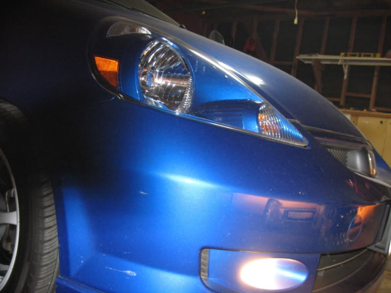

  #286
ChrisN's Avatar
Frequent FitFreak Poster
Posts: 861
From: Southern California
Special thanks to j5ive and leonine for your instruction and write-up.
Also, thanks to all those who provided all the good info in this DIY.
I followed the instruction of this write-up in post #173 and now I can use my fog light
independently. I'm not too keen with DIY but with a clearly instructed
write-up like this one, I did it with confidence. It took me a good half an hour or so
to complete.
Here's a picture taken right after the completion. Not a good one but
enough just to let all know:
