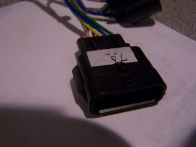

I have tried three times to install controller. I have no continuity when I turn ignition on go to calibrate. It is not lit either. I suspect it is the plug going up into harness not being pushed in all the way and I can't get it to go in farther.

Hi Black3sr
Could you post up a picture of the harness connector head?

I trimmed the edges a bit so I could get it started into the female end of harness. I did not want to force it any more unless I got it stuck.
I did make sure to have it turned the correct way so the insides lined up.
Size:  22.1 KBName:  010-3.jpg

Try plugging it in the other way....almost certain that'll fix your problem. And you'll know if you have power if the memory unit (so the box not the LCD) blinks red when you plug it into the OBDII port (assuming the battery is connected that is).

Thanks M$ for suggestions. First there is no light on the black box to blink. I just plugged it in and nothing.
Are you saying turn the one plug 180 degrees and try it? I do not see that working as the pins do not line up. Under the long row there is what looks like two pins(?) or something and I have those on the same side. I really don't see how this plug will go in far enough to make contact.

I DID IT!!!!!!!!!!!!!!!!!!!!!!!!!!
A Dremel with cutting disc and another one with a sanding drum and voila.
I shortened the plug by an 1/8" or so with cutting wheel. Then cut off the wing/guide things on the sides. Then sanded all the way around til it would fit snugly but be removable.
Calibration went rather easily - surprise eh.
