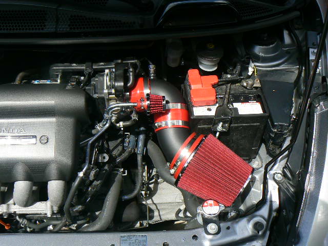

Here's mine I did last weekend
Old Jul 27, 2009 | 04:10 PM

I'm really liking the flat black paint on the intake. I'm most likely going to take mine off and paint it as well. Looks sweet TurboManGT! You know me, I've always been a fan of red and black color combo!
