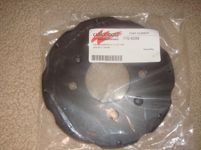

I just finish sound deadening my Driver's door (Passenger's door still few days away hahaha)...
and The UPS Delivery Person arrive
When he handed me the box,
I feel excited right away,
why, because the box is VERY LIGHT !!!
I immediately open it,

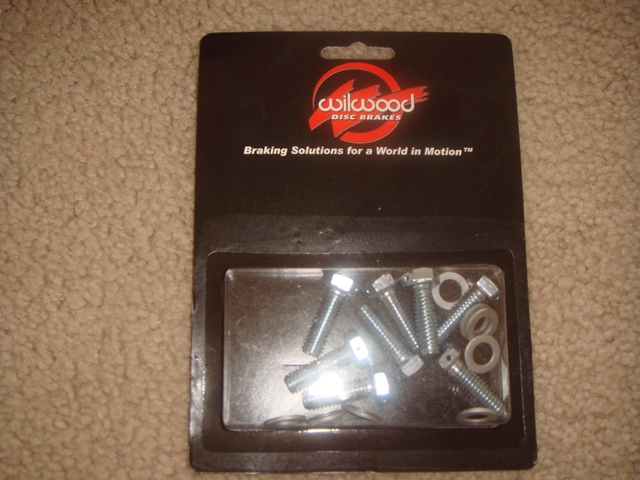

and there it is, my Wilwood rotor HAT and Wilwood's bolt...

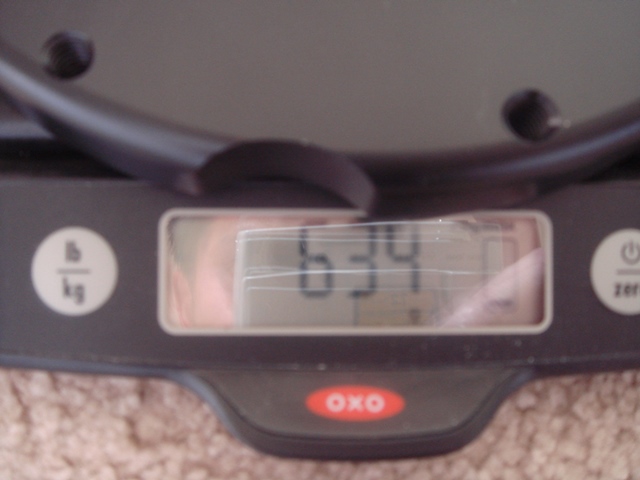

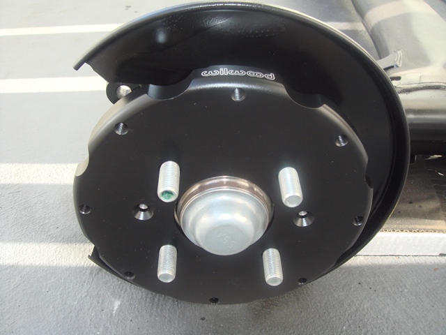

I open it, and measure the weight, and then try to fit the HAT onto my JDM RS rear axle,
turn out, everything is perfect, the rotor hat offset is just the way I predict it will,
which mean I can mount the rotor without having to remove or cut the stock Backing Plate... (removing the backing plate mean i had to take out the wheel hub etc etc, beside, I prefer if I still have the backing plate)
Ok, here are the pictures:

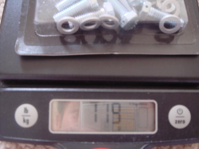

Rotor Hat Weight is just 634 grams !!!
Bolt Weight: 119 grams

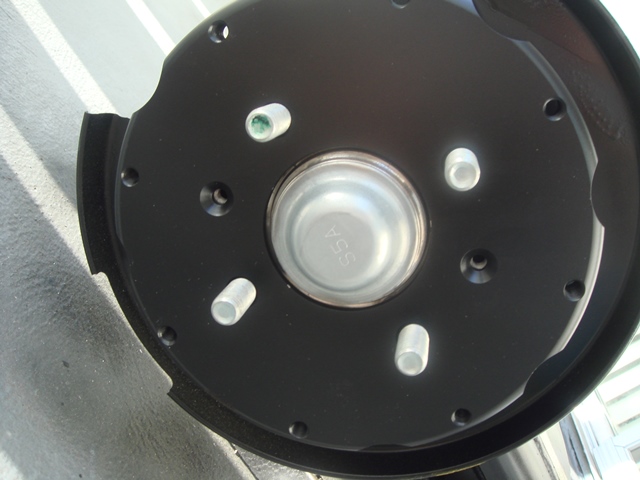

Test Fitment on my JDM RS Rear Axle:
Notice that it had 2 centering bolt just like stock Honda OEM disk brake,
this mean I don't really need to buy hubcentric ring,
although this rotor center hub diameter is slightly larger then our's because
this rotor hat is for Honda Civic with 64mm center hub (our's 61mm only)

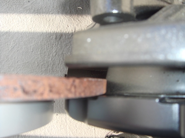

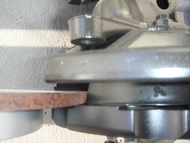

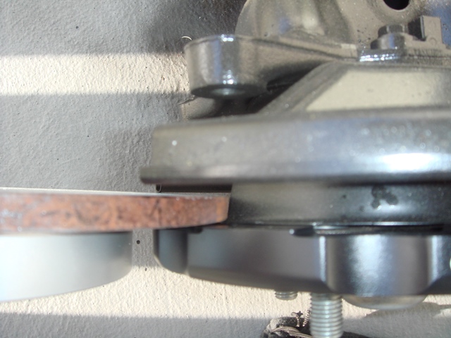

I am checking the offset,
notice I put my stock RS Rear Disk brake which are 9mm thick between
the rotor hat and the backing plate,
and there are still plenty of space !!!
There are 2 candidate rotors for me,
first is TheBrakeMan scalloped 12.19in diameter rotor which are 9.5mm thick,
so only 0.5mm thicker than my standard rotors,
second is Wilwood 12in diameter rotor which are less then 9mm thick,
so both rotor definitely will clear the backing plate !
It is also easier this way than using a deeper offset rotor hat because
this will be easier to make the bracket for the OEM caliper since
there are more space !!!

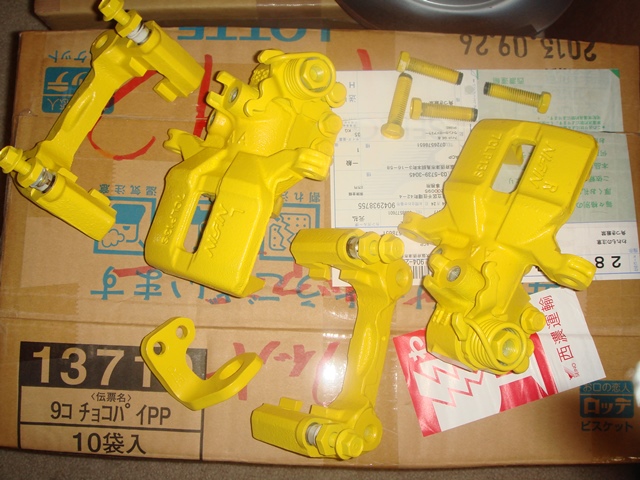

the caliper yellow paint had been cured in the oven yesterday, and tomorrow I am going to paint them with
CLEAR COAT color so they will by DEEPLY SHINY
after that another 7 days before I can put them in the oven (for curing the clear coat)...
then if I still have free time, I will rebuilt the caliper to replace all the seal...
but during the next month (entire June) I might have other things coming soon, so this project might had to wait a bit...
here are the calipers:
(just missing one parking brake bracket, because I had to repaint it since I manage to nick/chip the paint a bit cause I hit something on it before I cure/oven it).

Few days ago, I finally cured the last clear coat of paint on the caliper so the rear caliper cosmetic finish is done.
I also had bought several set of special brake line wrench and brake bleeding wrench,

b. Buy either 12.19in TheBrakeMan Scalloped rotor (still in back order so had to wait), or if I am not patient, I can just buy the regular 12in Wilwood Drilled Rotor
c. Make the mock up for the Brake Caliper Bracket to accommodate this larger rear rotor using plywood/mdf
d. Bring that mock up bracket to machine shop so they can machine the real bracket using either aluminum or stainless steel as the material,
and also make a hubcentric ring for the wilwood rotor hat since it have
slightly larger hub holes then my RS hubs.
e. Buy Strong Grade 9 or Grade 10 bolts to attached the bracket and caliper to the rear axle
f. Buy several new Honda bolts and clips to attached the rear axle to chassis/shocks etc because according to Honda, I got to replace this bolts every time I took the bolt off (one time used bolt only)
g. Buy Spoon Rigid Collar to make sure there is less flex on the rear axle bushing and the chassis mounting (had to order this from either Rakuten/Amazon Japan)
h. Buy longer parking brake cable from 2013 Honda Civic Si (older model Si use different kind of end connector from the cable to the caliper so got to use the latest model parking brake cable).
I need to buy new parking brake cable since the larger rotor make the old parking brake cable don't fit anymore.
i. Buy Brake Bleeding tools
j. Buy many bottles of Motul Dot 5.1 brake fluid
k. Buy Goodridge brake line for USDM Honda Fit (kit with 4 lines) and then
buy another 2 custom Goodridge longer brake line to connect between
the rear most hard pipe brake line to the rear brake caliper.
That custom brake line will also require some extra banjo adaptor and banjo bolt. I had figure out every part from Goodridge to built this custom brake line, so all I had to do is just buy all the part.
l. after I had all the above, then I can choose whether I want to risk installing the large rear rotor brake right away, or use the standard JDM RS rear rotor first until I can have budget to buy the front Brembo conversion...
I think I want to risk using the larger disk brake right away, since the rear oem brake caliper is so tiny, it should not hat too much brake bias change compare to stock one... but I will decide later when I already have the rear larger rotor on my hand.
Among all the above, the complicated step to do is going to be the process of making the rear brake caliper bracket...
well it is not really hard, but I just had to be very precise in measuring...
come to think of it, the hardest part is actually coming out with the budget for the FRONT Brembo conversion...(at least $4,000 with custom bracket since the Brembo for Subaru BR-Z 6 piston 14in kit run around $3,500) I hope I can manage that asap
oh, I forgot, I also need to find a larger master cylinder (1in diameter) so my pedal travel will be back to normal,
otherwise I can just bought the J's Racing larger master cylinder but then I still have to modified the front hard brake pipe from the larger master cylinder to the VSA actuator.
hmmm...
I already feel tired just making this list,...
I am sure I will more tired doing all the above hahaha
so please be patient with this project since it will involve a lot of "baby step" hahaha
