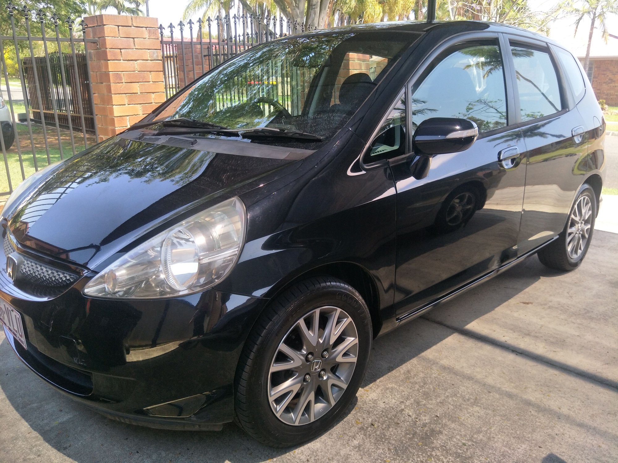

Forget all this cosmetic stuff. Someone asked whether the manual transmissions are interchangeable and I REALLY need to know this. Like a lot of early GD3 mt's mine's on the way out. I may buy a 2008 model with body damage just to take the mt out. But will it fit? Donor car would be the 1.3 L engine whereas my 2007 car has the 1.5 L if that makes any difference.
Don't care if the gear ratios are different, but WILL they bolt in place of each other, anyone know? I might then put the wonky one back into the newer car and resell it as a complete parts car to someone else. Please don't let me get stuck with TWO wonky Jazz/Fits as my wife will kill me!
PS Here's my Jazz, I took off the original 14" steelies and put on 15" mag's from a much newer model, dunno which year though.
