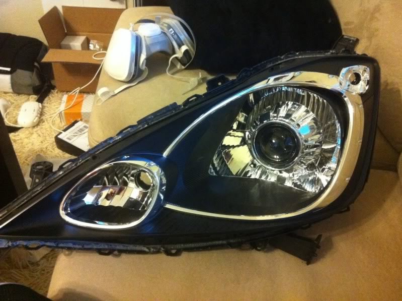

With all this hid talk, thought I'd share what I just wrapped up...

Nice! Mind if I ask, how did you separate the housing?

VERY CAREFULLY!! ha. You wanna put it in te oven at 225 for like 4 min, pull it out, start to pry the tabs up, stick it back in if the glue cools too much for another 2 min and pull it out and pry.

Man I'd be so scared! I have my HID projectors and shroud, but I'm too much of a chicken to do it LOL

You just gotta go for it. First time I had the oven too hot and put my headlight on a cookie sheet, melted a little of the bottom. Oops. Use a piece of wood (doesn't conduct as much heat) and keep it at like 225. I just fiberglasses, sealed and sprayed the base. Ended up coming out fine.

Make sure you do a DIY when you finally have the courage to open things up. I too am a big chicken. I need some really good instructions and pictures so I can start planning this retrofit business...

Nice job!!!! Did you do a DIY? If you don't mind, I'd like to know your parts used. Thanks.
