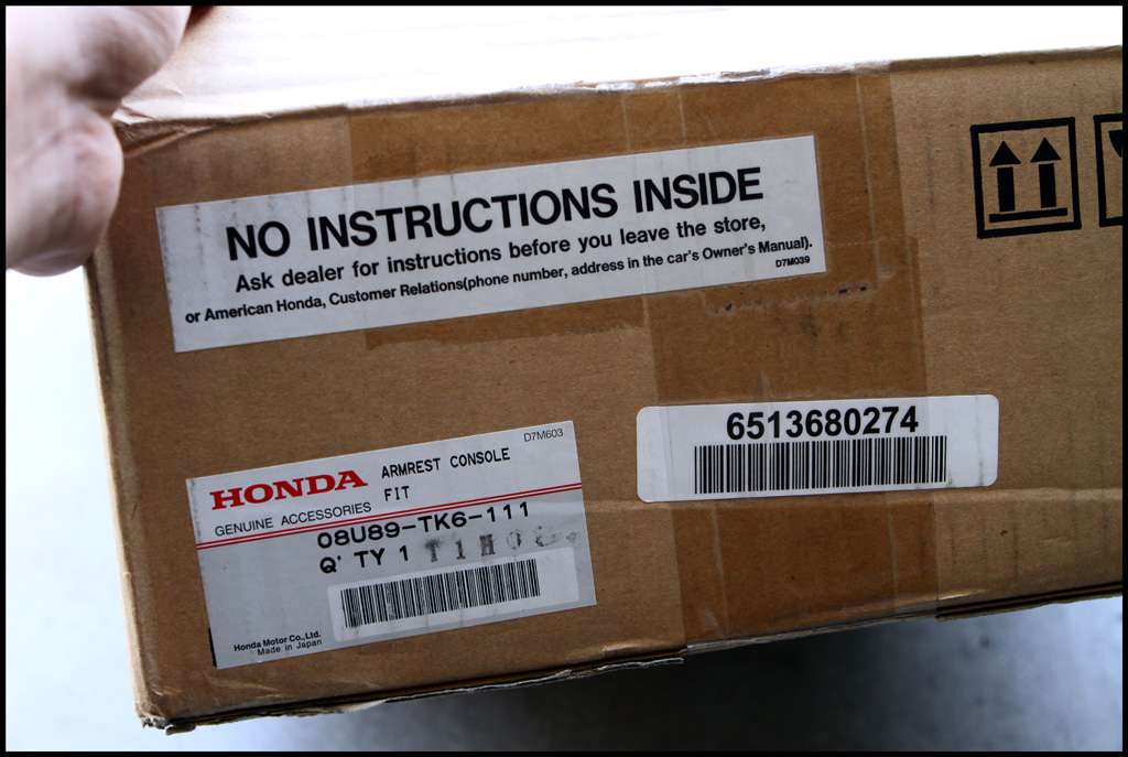

I picked up an OEM armrest and Progress 19mm rear swaybar locally from a member here. Good deal.
Part number/box for armrest.

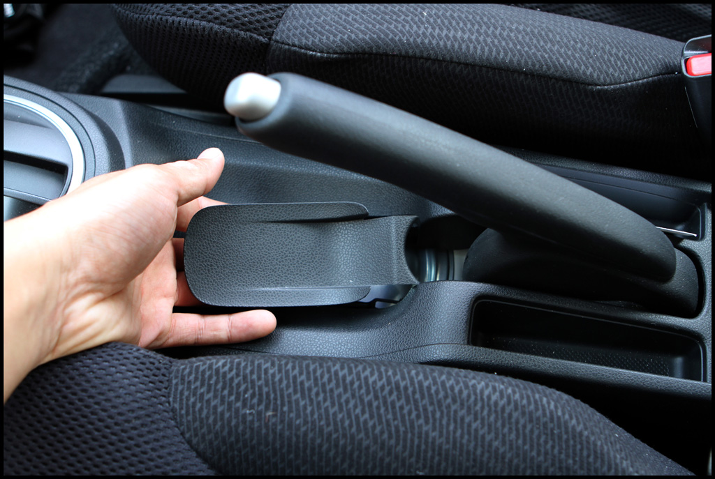

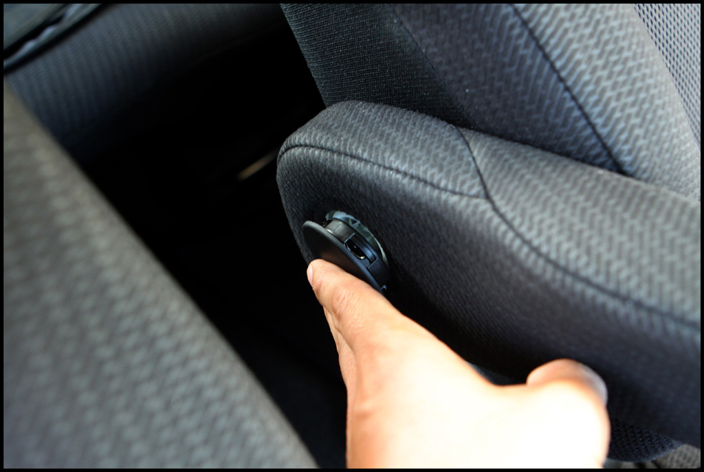

Pop out the factory Sport armrest with a screwdriver.

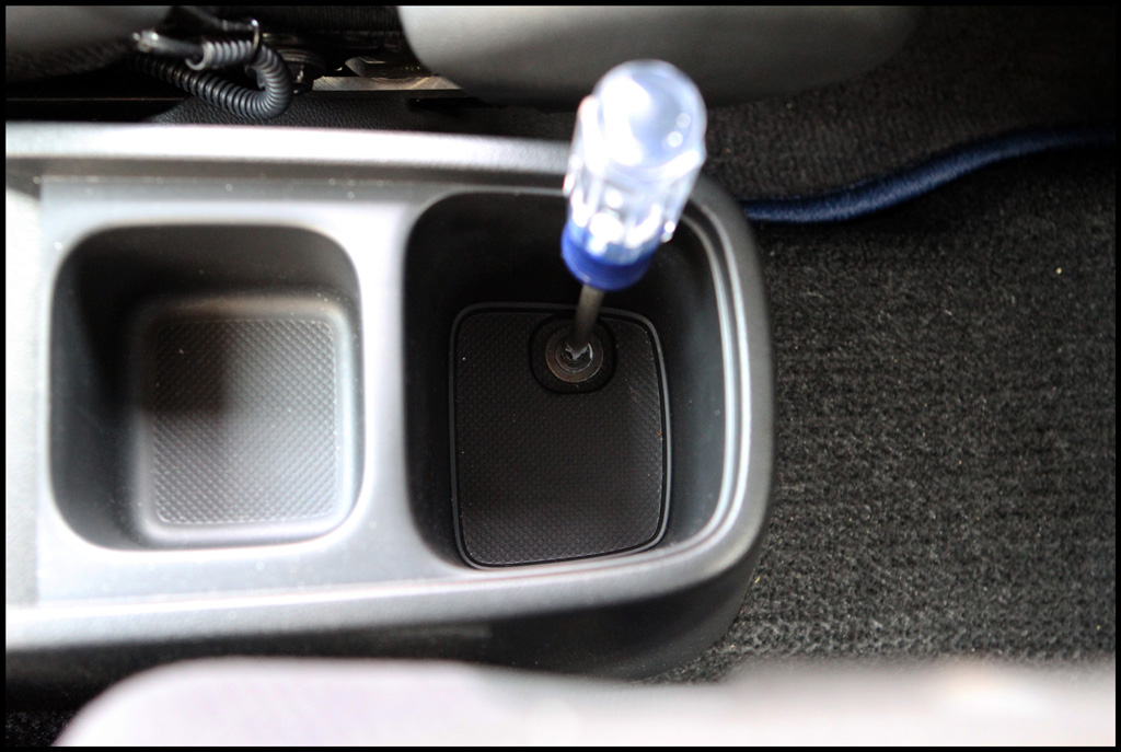

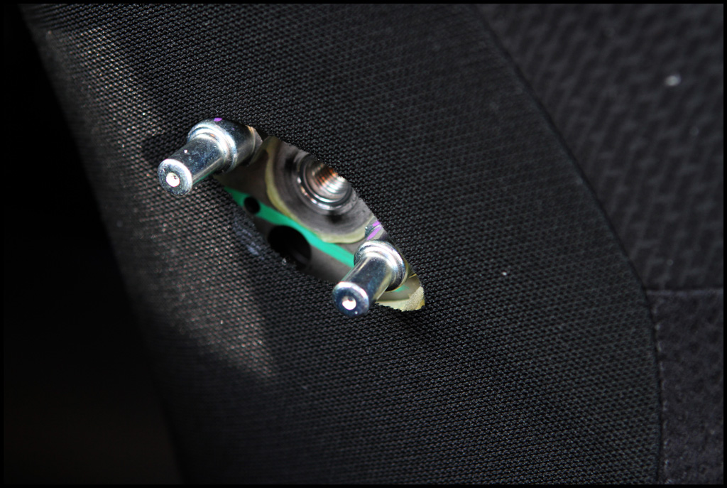

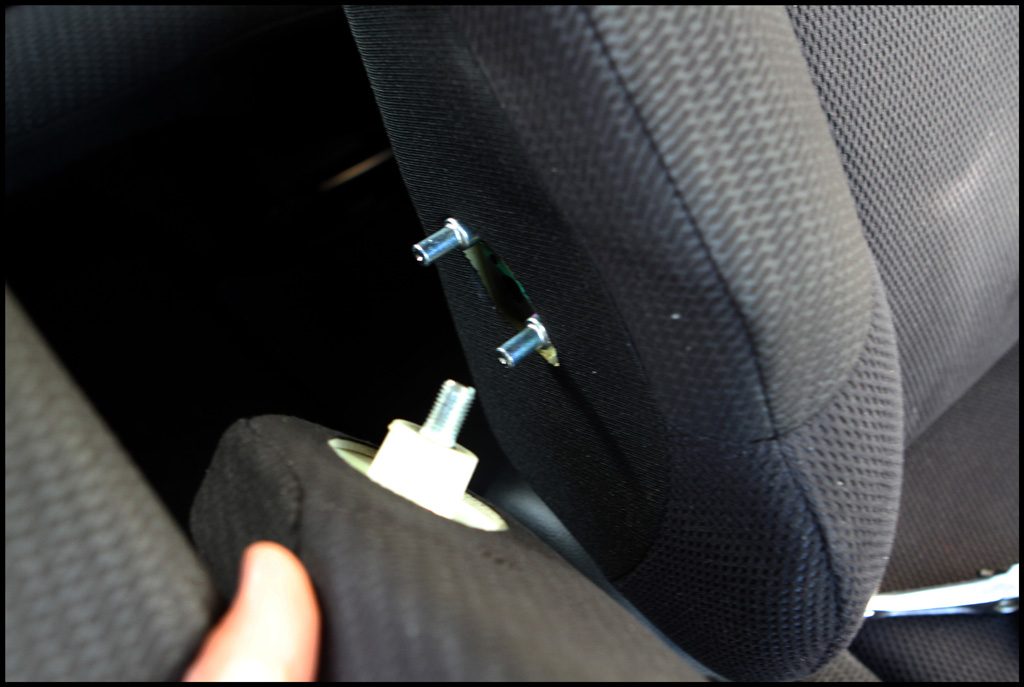

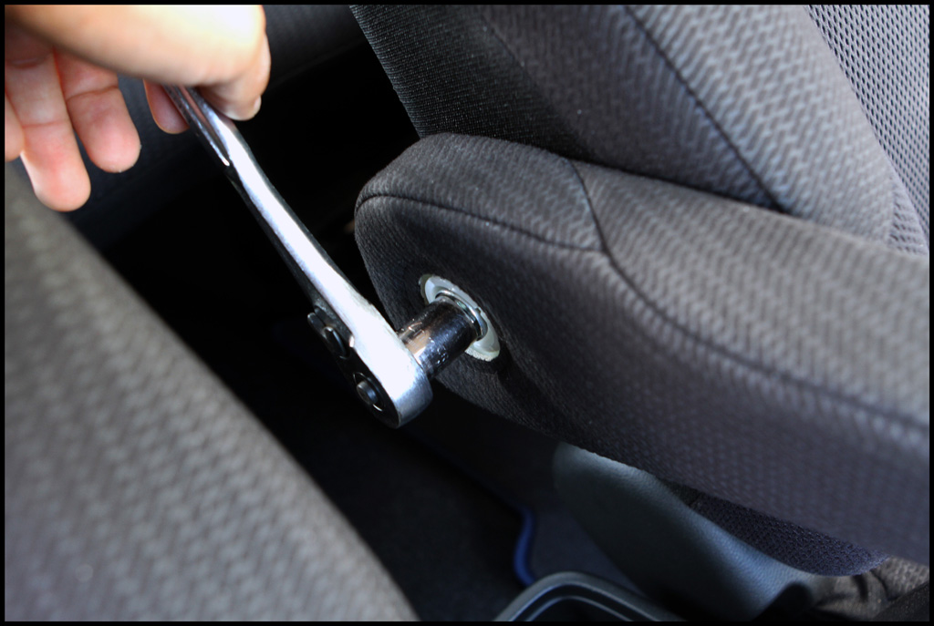

Remove the large 14mm bolt holding the armrest.

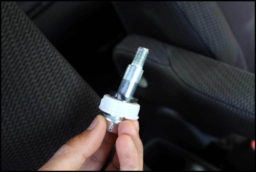

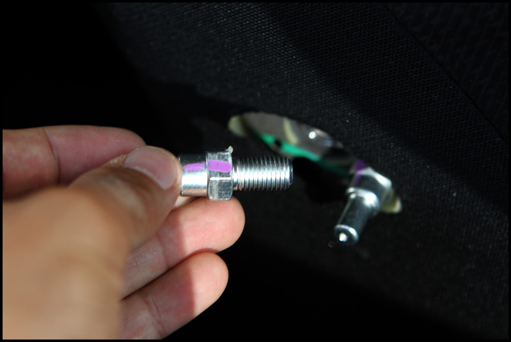

Remove the 12mm "studs" with a deep socket.

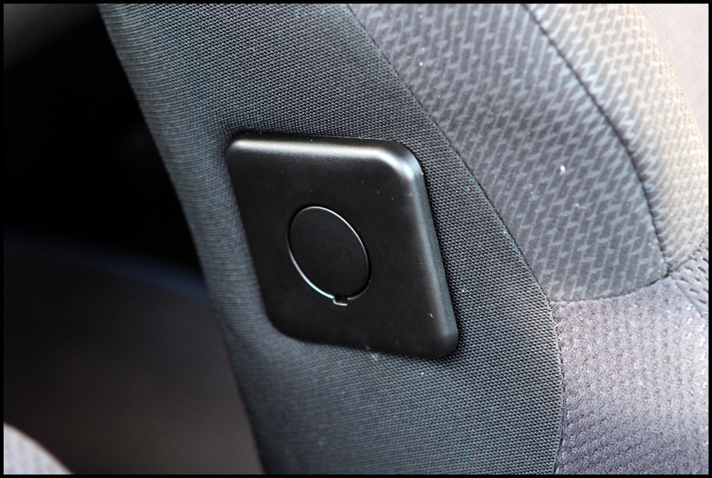

Install the supplied "cap". Initially it didn't fit snug, but I eventually got it to fit.

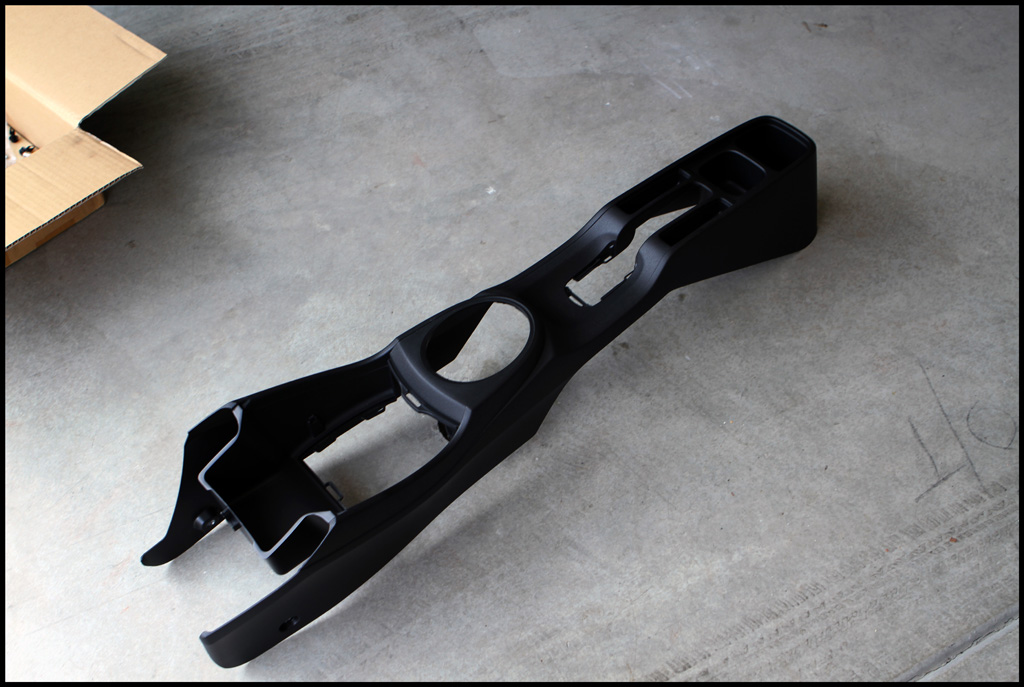

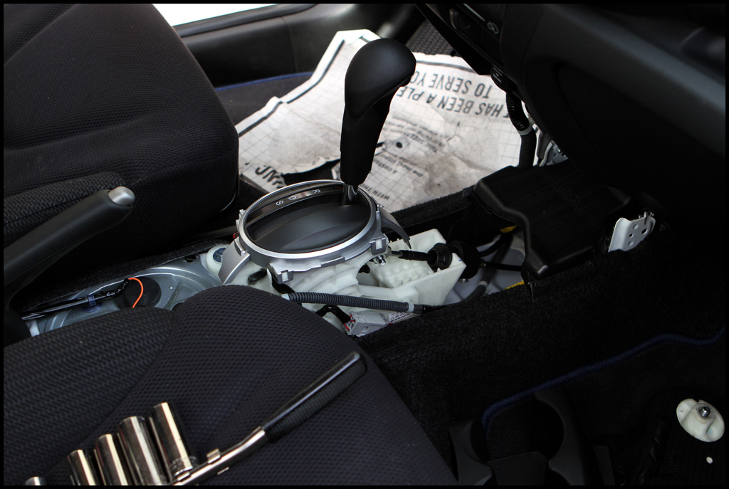

Next, remove the entire center console. A pain as usual.

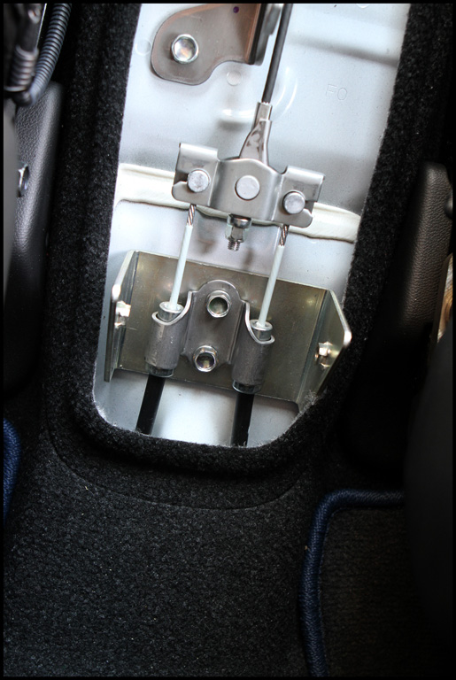

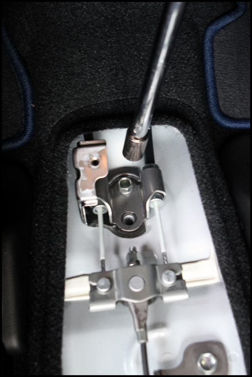

Unbolt the handbrake bracket thing.
Install the supplied bracket underneath. The instructions supplied by Honda are actually incorrect here. It's supposed to be flipped so the angled portion faces the other way. Of course I had to disassemble everything afterwards to fix it.

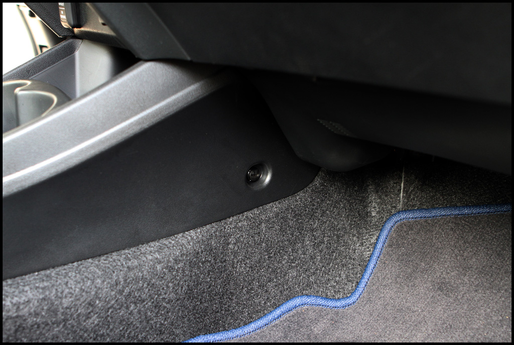

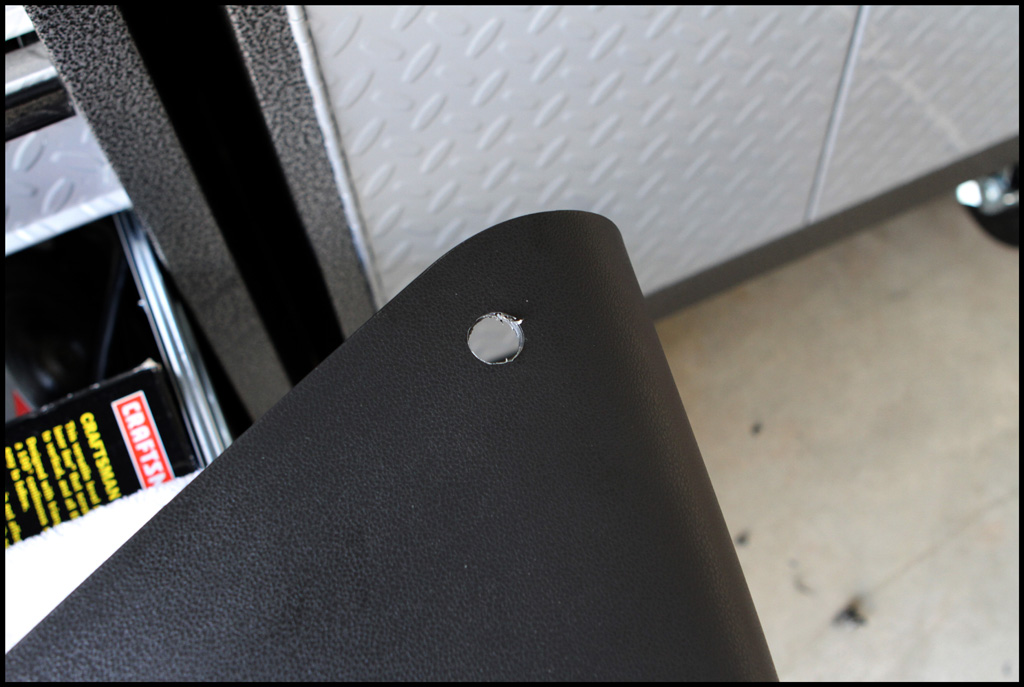

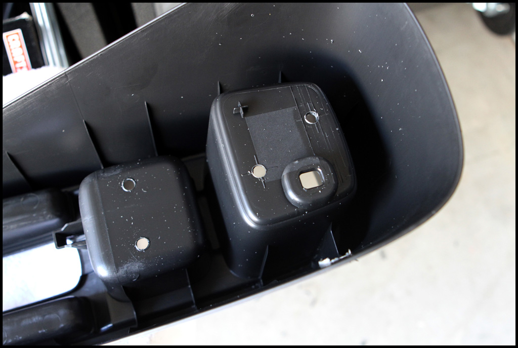

Now you have to drill a few holes. Luckily, Honda put in marks where you're supposed to drill.
Now you're supposed to drill a larger hole here. Since the rubber caps are the only thing I didn't have (the seller kept them since he needed to cap his holes) I drilled the smallest holes possible.

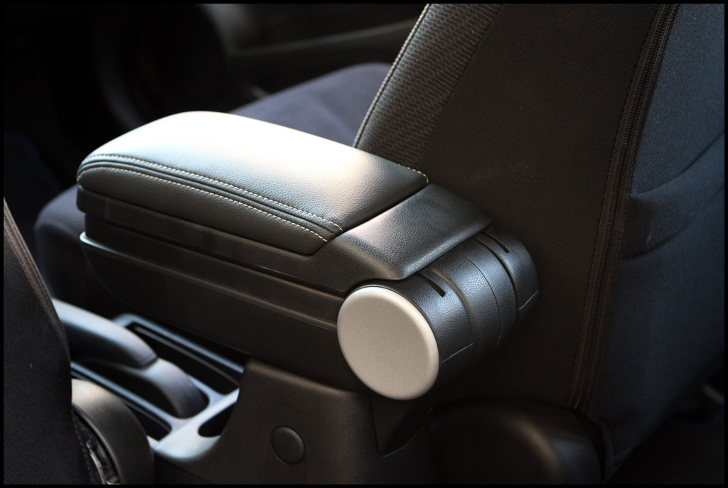

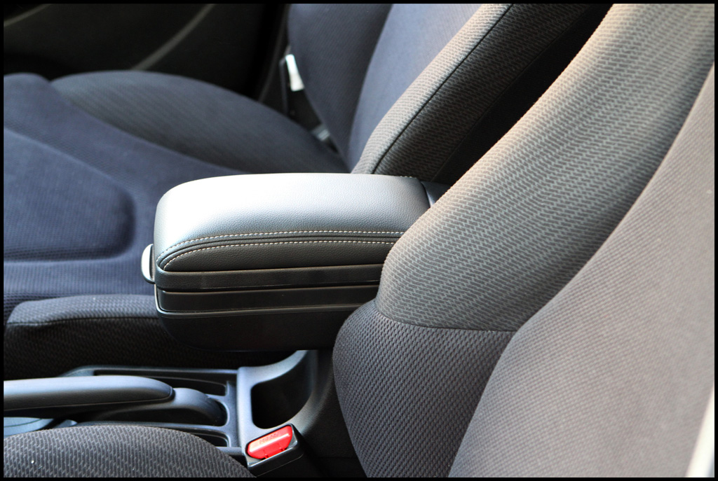

All done!

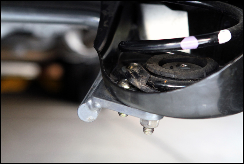

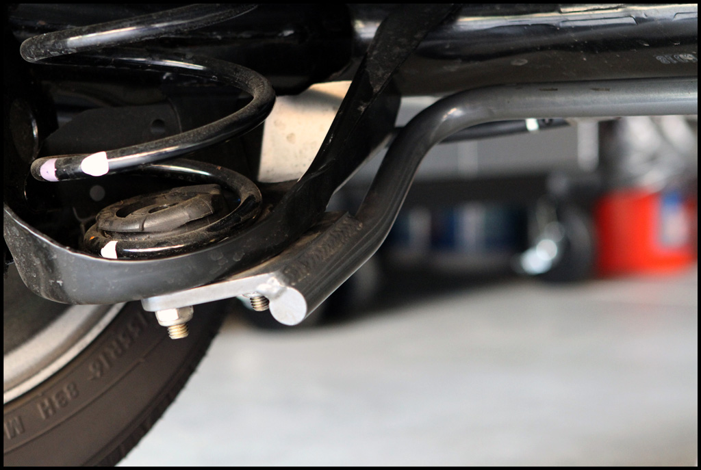

Onto the swaybar. Since my hands were a bit dirty I only took completed pics. The difference is VERY noticeable. I highly recommend it. The install was VERY easy. Just jack it up and bolt it right to the "spring tray." The only difficult part was maneuvering around the spring to drop the bolts through. Had to use a pry bar to move things around a bit.

That is awesome. Still debating on the rear sway bar.

I would do it. It's so cheap, plus it's so easy to install.

Very nice pics and diy. Always been torn on the center armrest. I like that it provides storage, but it also does away with two cup holders, which I regularly use. Also concerned it'd be too high to comfortably shift since I have a short shifter and relatively shorter Skunk2 knob. Does the whole assembly flip back like the original armrest, giving your arm clearance to shift (if you had a manual I mean)?

I had some of the same reservations as you. Let me help.
I didn't use the cupholders, but I do like the extra cubbyholes for storage. Keep in mind that the rear two "cupholders" are really small and don't really fit cups that well. They're mainly for storage. When you flip up the entire armrest, there's still a small cubbyhole there. Plus, obviously there's space inside the armrest.
And as mentioned above, yes you can flip the entire thing up. This armrest is actually LOWER than the little flip down thing that the Sport model gives you.
