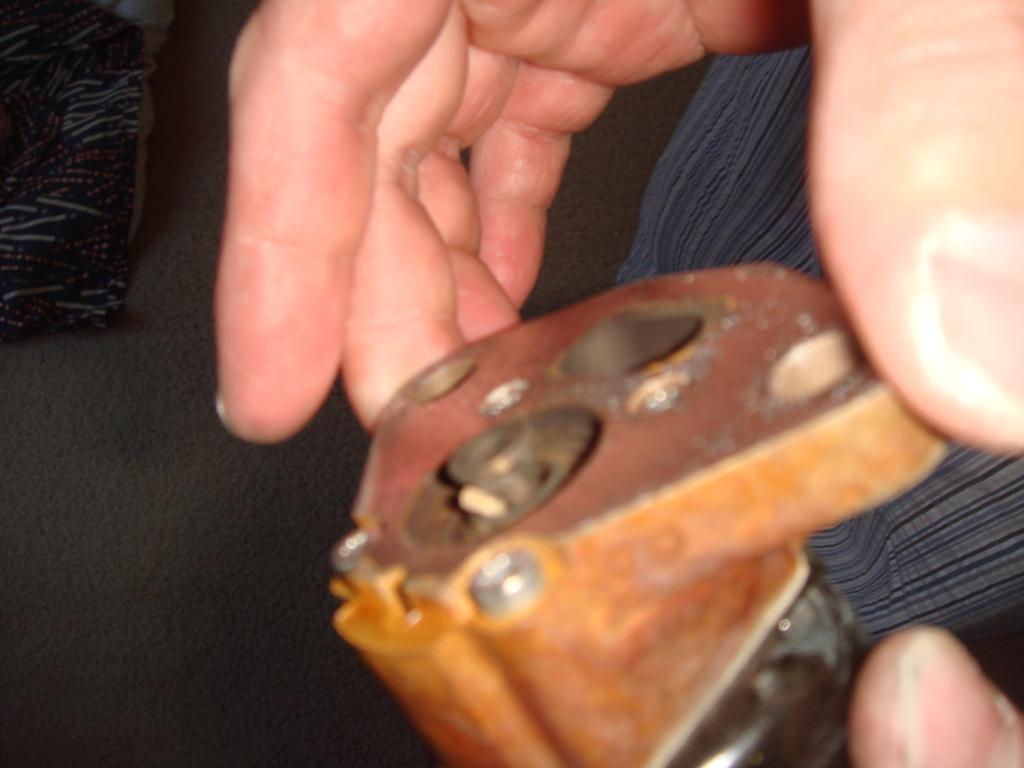

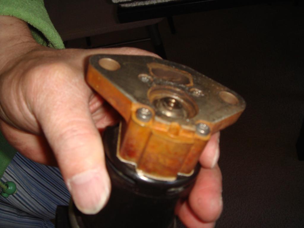

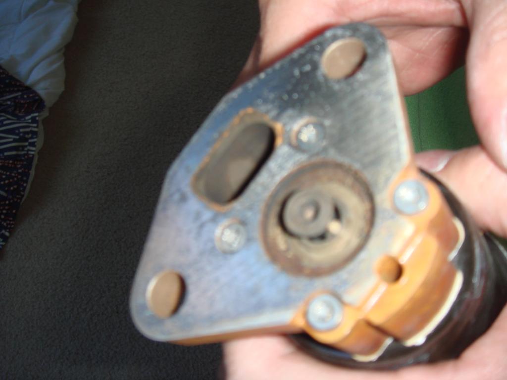

I found the answer :
The EGR Valve STUCK OPEN,
as you can see on the picture below,
there is a white material stuck.
I think this material must come from or when I install the T1R Header...
somehow,...
It is NOT metallic though cause it is not attract by magnet (I test),
but it could be stainless steel...
anyway...
Remove the material and CLEAN it...
Start the car, everything is PERFECT again
I already buy the ScanGauge II though... oh well, it's ok it is always a useful tool...
glad I am not going to dealer/service, they will charge me a lot of money for this...

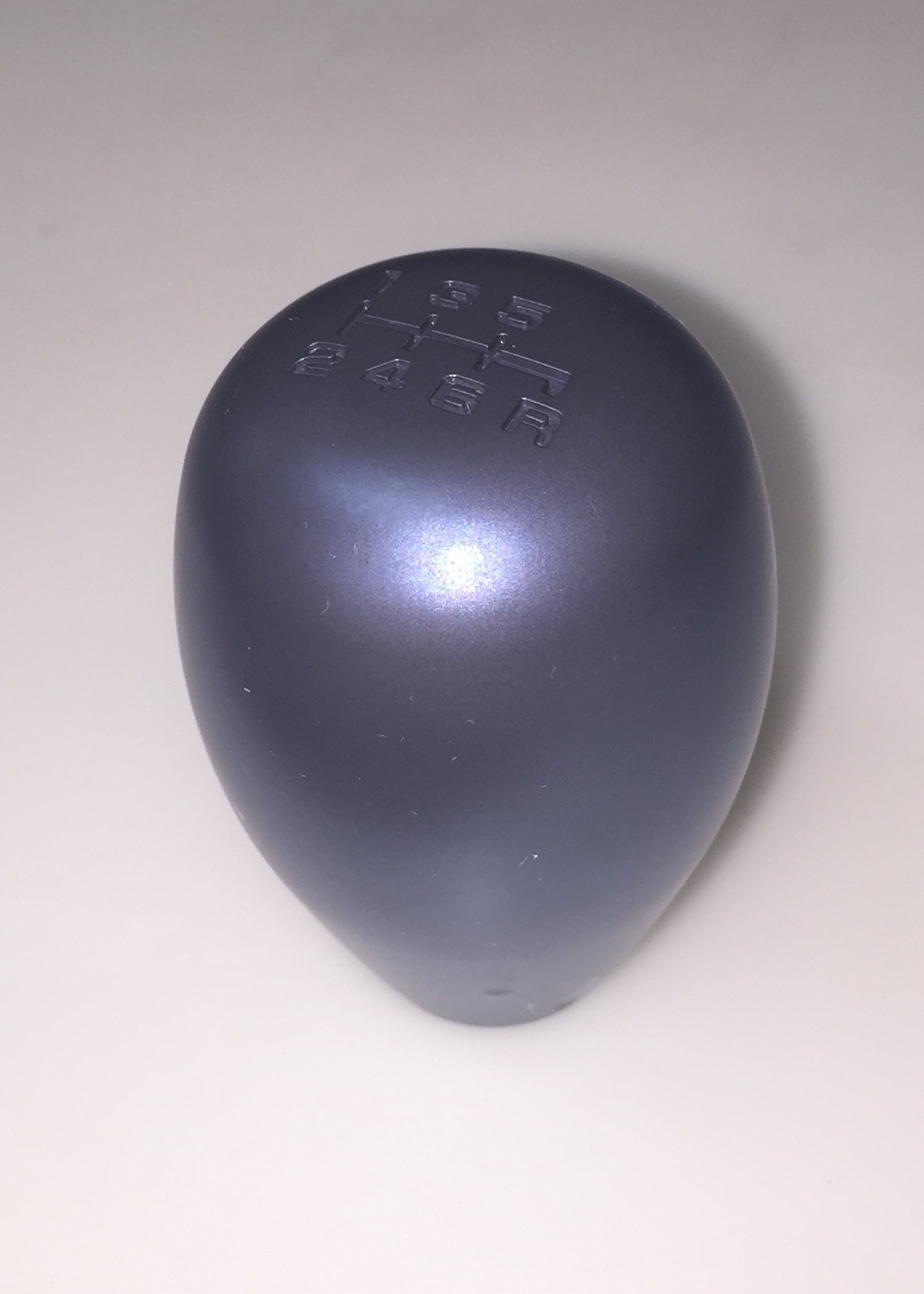

Since going to 6MT, pulled out my old DC5R titanium knob the other day and decided to take some heat to it with the oven set on self-clean and then after a torch. I also ordered a new one online, actually it is sold stateside as a S2000 accessory, to play with and try a different coloring scheme.
After baking in the oven for about 75 min...
And yesterday after work I took the torch to it some...
I like the rainbow effect I was able to achieve and capture a good color spectrum on it.
The new one I want to try for a green and gold mix, but not sure if I can accomplish it.
