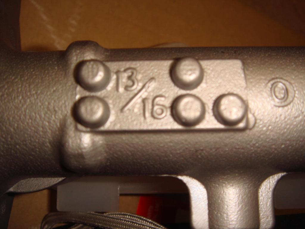

Actually, if you could please help me,
please kindly take picture (using iphone or small digital camera) at the bottom part of your J's brake master cylinder,
it should show the diameter...
I had been searching internet but I NEVER able to find
the pictures of the J's racing master cylinder from the bottom,
so I never know the diameter.
for example like this:
The above pictures is the Civic Type R (FD2) JDM brake master cylinder
that I bought from Japan, as you can see the 13/16 means
it is only 13/16" in bore diameter.
plus the Civic MC had 2 10mm bubble outlet (similar to Non VSA USDM Honda Fit),
while mine is a VSA equipped USDM Honda Fit with 12mm bubble connection.
I need a MC that say 1 which will mean 1"
