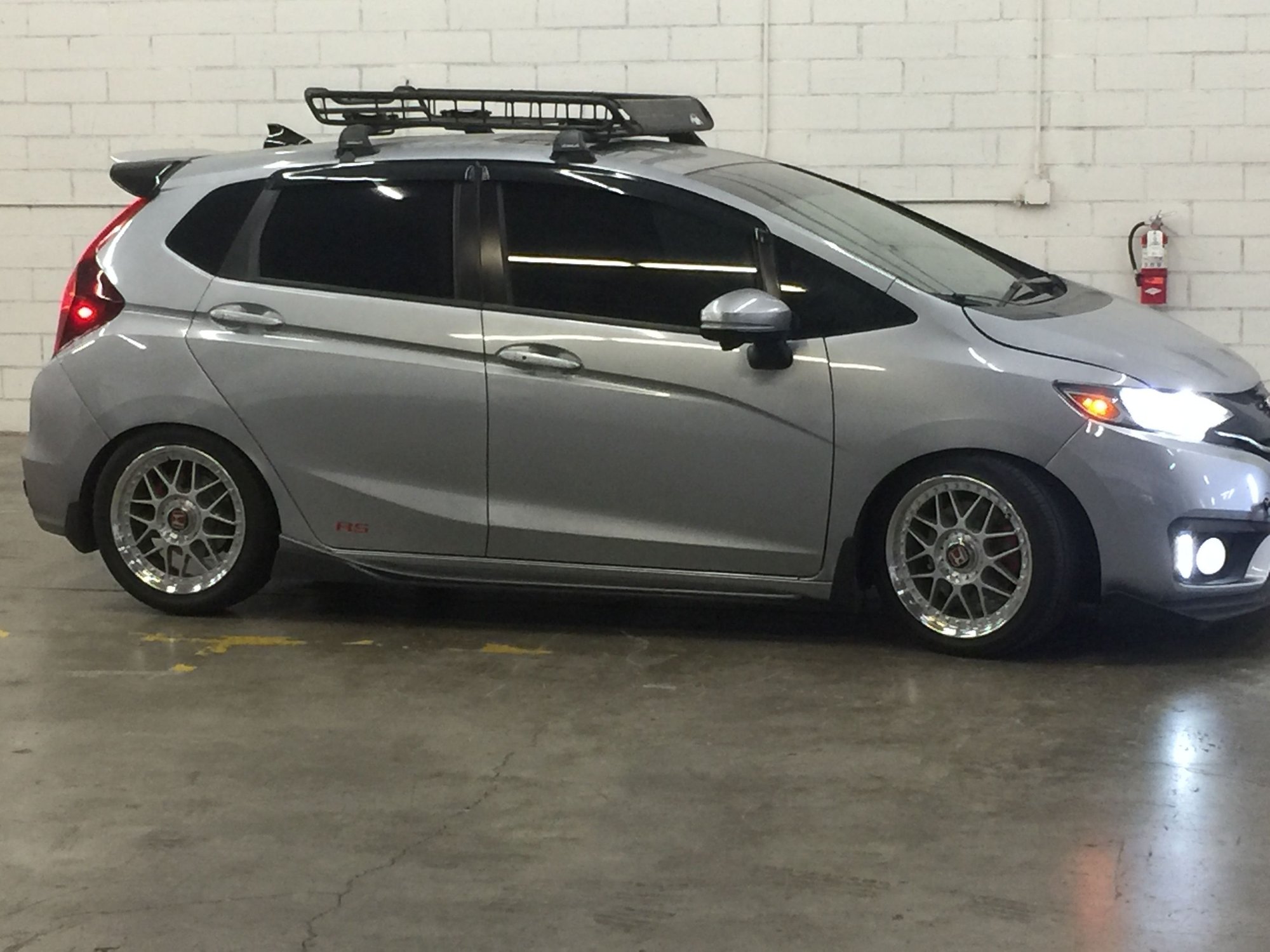

Originally Posted by Elpapas
The 2020 look with the black and red center caps
I like your roof rack. It was very difficult to find one recently. I eventually ordered a Rhino-Rack, but it took almost a month to receive the whole thing. Delivery was spread over several weeks and four boxes. I'm in the process of putting it together. I want to make some kind of wind deflector.
home depo should have what you need let us know how it does
First I have to get the rack on the car.
There are a few online articles about how to make on. My only concern is having something touching the roof and scratching through the paint.
put the rubber door molding that they sale at the Autozone it protects your door when you open the door in parking lots that are small the should fix your worries
