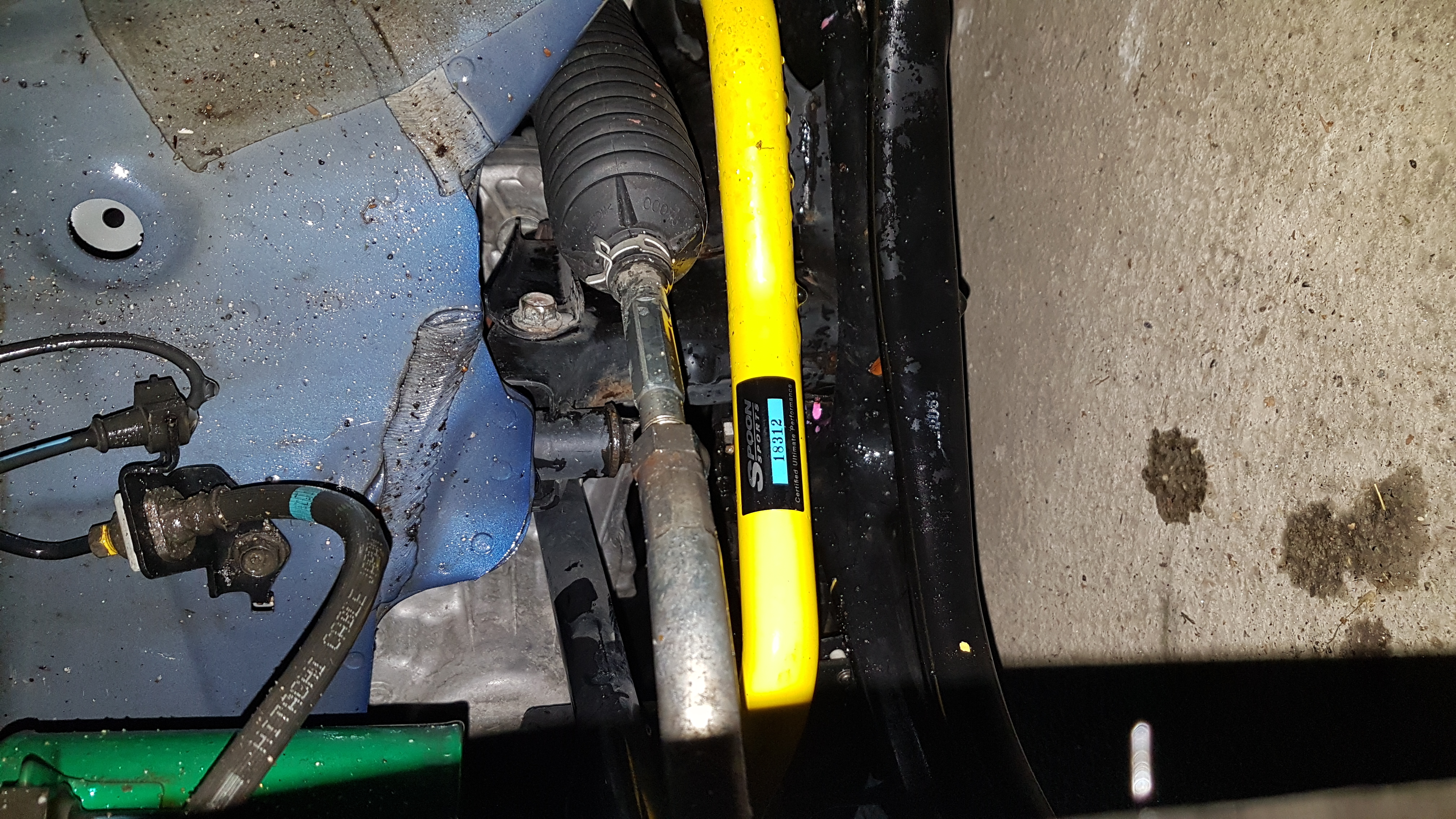

Spoon sway bar
So, finally my Spoon front sway bar is installed ! The Spoon N1 muffler also !
I'm also trying a Blitz LM panel filter, it seems to work well and the filtration looks good, I check the airbox interior almost everyday without any dust inside until now...
+ Seeker super short shifter, Seeker super boot collar and a few goodies...
Give some feedback after some driving time!
Old Oct 24, 2020 | 06:11 AM
  #3167
RoyDynamicgk5's Avatar
Joined: Jun 2019
Posts: 110
From: Switzerland
Sure !
After a few km of driving, I can say that : on dry road, the grip is very high ! The front end bite the apex like crazy, in a similar behaviour then my previous Civic Type-R FK2. It increase also a lot the traction in corner exit.
On wet road...it's an other story ! I've to transfer the weight on front wheels by late braking to have a bit of grip, but I clearly feel the car don't roll enough. It's what I've excpected...
But I love that mod !

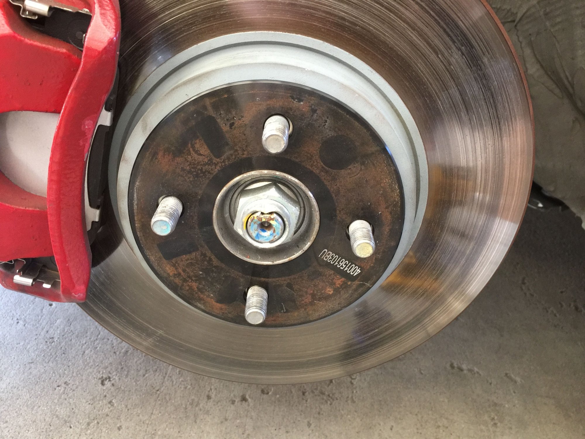

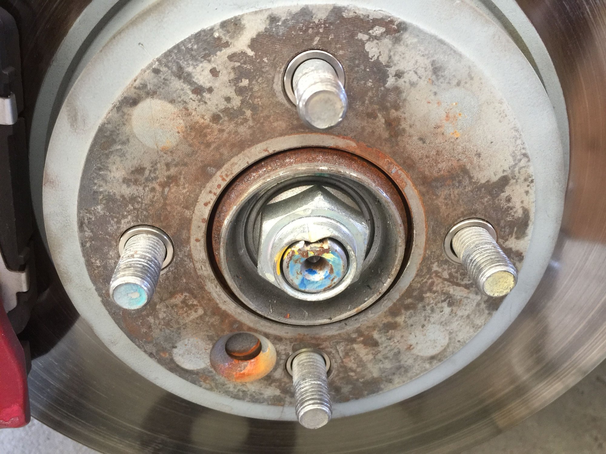

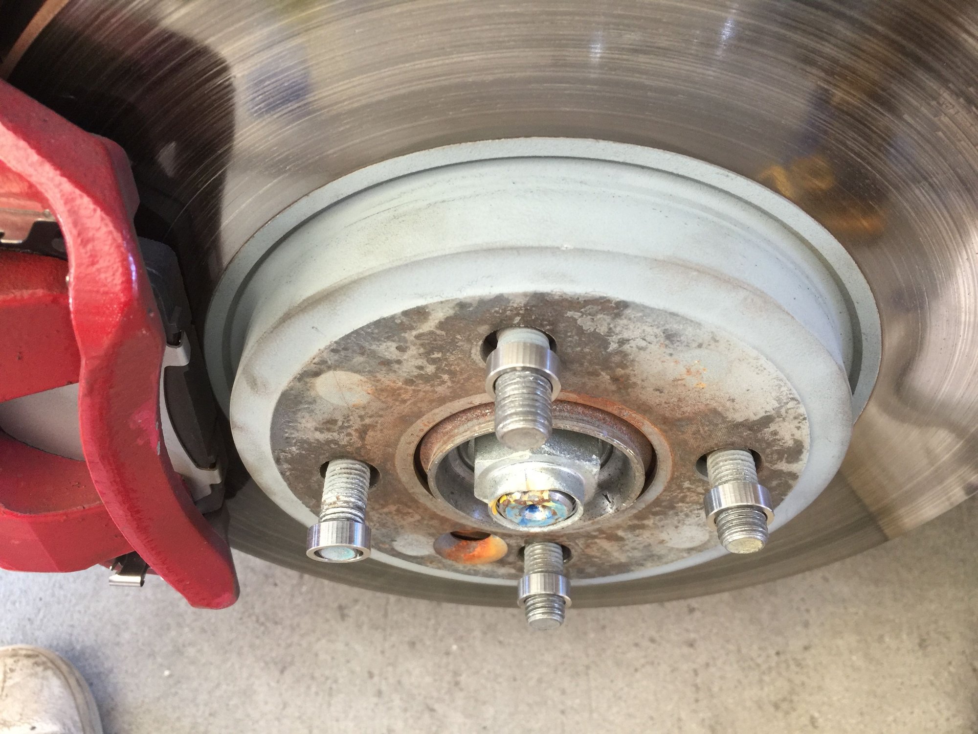

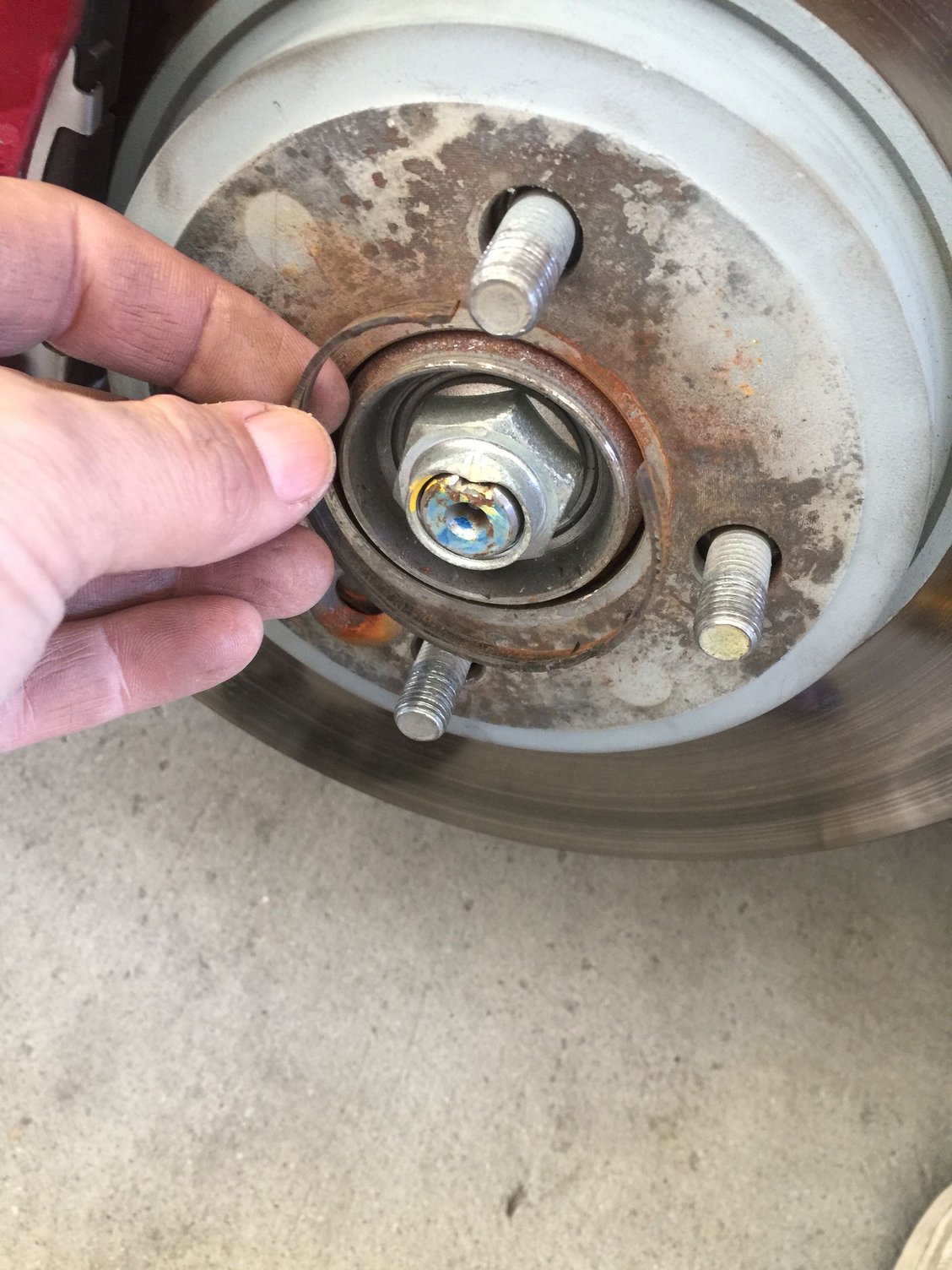

Type r rotors kit
Mini. Cooper rotor plastic ring
Install
S/s rotor rings to center the rotor
Rings install and 3mm spacer to clear the caliper front rotor
Install
That doesn't loo safe at all.
mall good the plastic one work for a few years but now with the s/s on the studs we’re good 11.5” rotor is a great upgrade from the 10” that is oem
