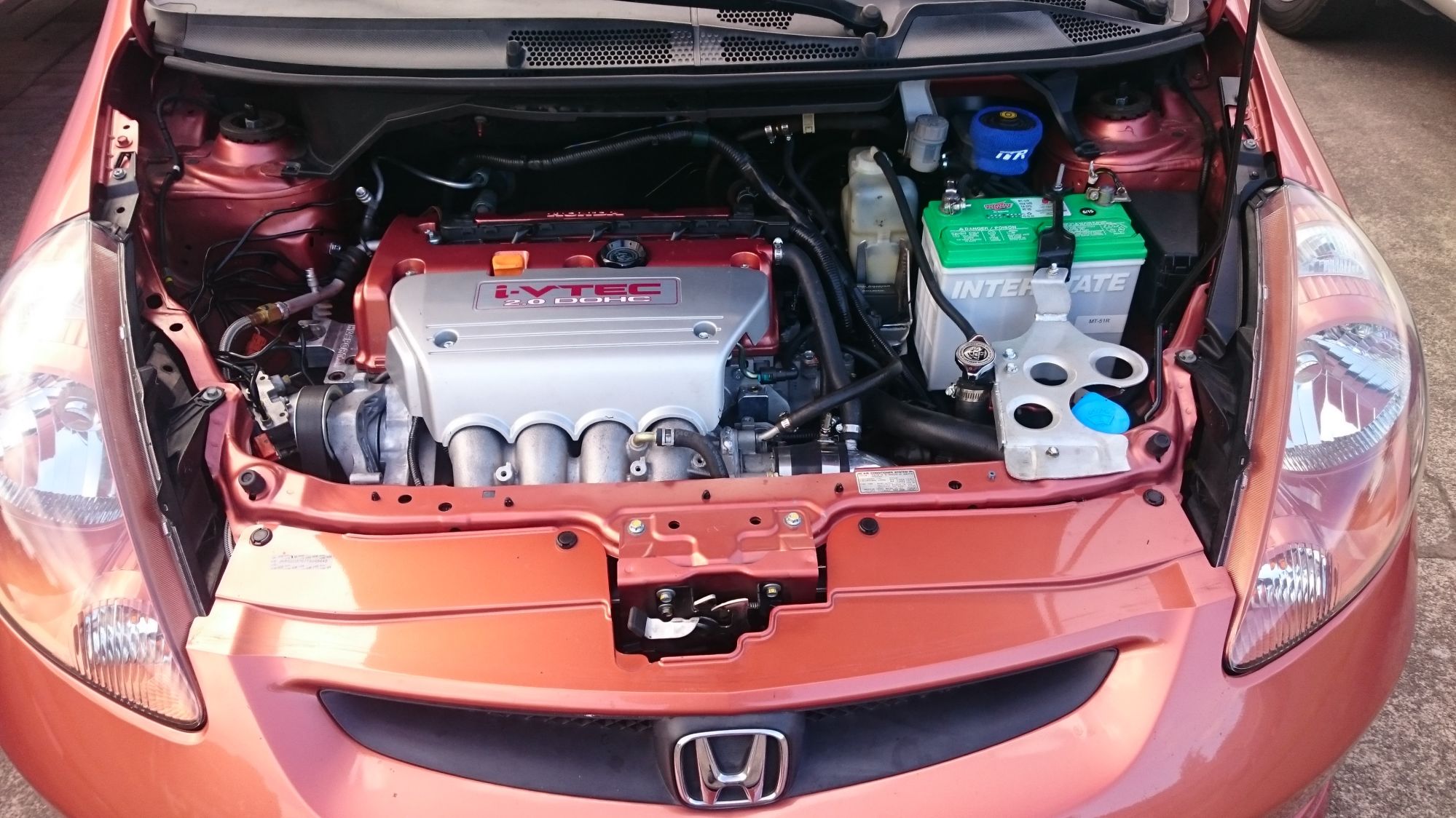

Finally done
Here's the completed k20z3 running a tsx ecu, only thing that didn't survive was cruse control. Let's just say it's pretty fun to drive, we will definitely autox this thing.

Whoa! Looks great!
Do the Showas still feel ill equipped for dealing with the extra weight?

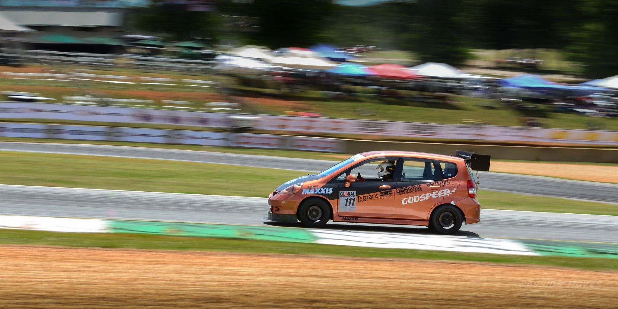

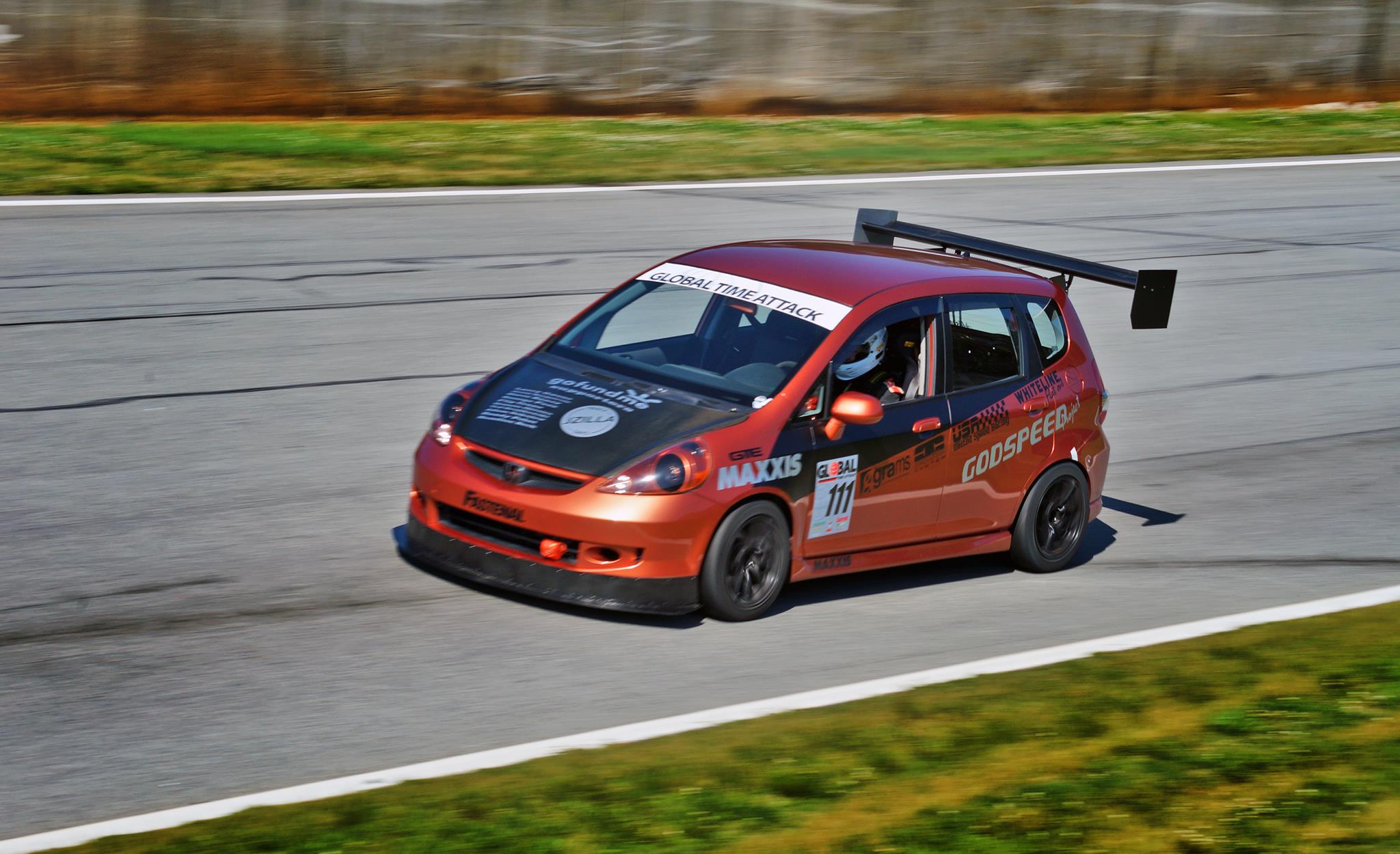

2007 Honda Fit Sport, original Blaze Metallic Orange paint
- 2006 Honda Civic Si k20z3 full engine and transmission swap, bought new from Honda
- Hasport Performance GDK1 k20 swap mounts
- ASP 4-1 Race header and 2.5" V-Band exhaust
- Custom large diameter cold air intake, wrapped with reflective heat wrap
- J's Racing Metallic Green Valve Cover
- Go Power V1R Camshafts
- Skunk2 Racing Pro Series Valve springs and retainers
- Grams Performance 550cc Injectors and 320lph fuel pump
- Hondata KPro ecu, custom harness, and full tune to 237whp
- Competition Clutch Super Single
- Insane Shafts 500hp race axles
- Modified k20z3 shift cables to fit stock Fit shifter box
- Custom upper radiator support to allow radiator to be mounted more forward and gain more room for better intake manifold
- Mishimoto Aluminum Radiator
- Godspeed Project custom valved coilovers with HyperCoil custom spring rates
- Blox Racing 24mm Front sway bar with custom adjustable droplinks
- early MR2 fitment adjustable camber plates custom installed in shock towers
- Konig Helix 15x9 Black flow formed wheels front and rear
- Maxxis Victra VR-1 245/40r15 Tires front and rear
- Wilwood 4-piston front brake setup
- RSX rear disc conversion with 4x100 EP3 rotors
- Hawk DTC60 front pads, DTC30 rear pads
- custom built brake master cylinder brace
- custom s2000 clutch master cylinder conversion
- custom integra type-r brake master cylinder conversion
- Racepak iQ3S Dash mated to G2X Logger
- Momo Daytona head containment seat on Custom fabricated steel seat base and aluminum side mounts
- Schroth Profi-II Enduro 6 point harness
- Recaro Pole Position passengers seat on custom base and aluminum side mounts (light weight but meets rule requirements)
- Nsidius Industries Shift Extender
- NRG quick release and 50mm hub extension
- Sparco 300mm suede steering wheel
- 4 Point custom welded back half cage
- back half gutted per class rules and all airbags removed
- VIS Racing Sports OEM Style Carbon Fiber hood
- Custom 4" drop down front splitter with hidden support structure
- 68" Kognition carbon wing on custom mounts with adjustable support and angle tubes, angle and leading edge height adjustable, zero flex in this setup

fantastic! can i ask how much that k20z3 cost you from Honda and can we see some shots of your engine bay?
