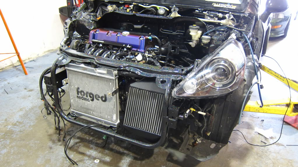

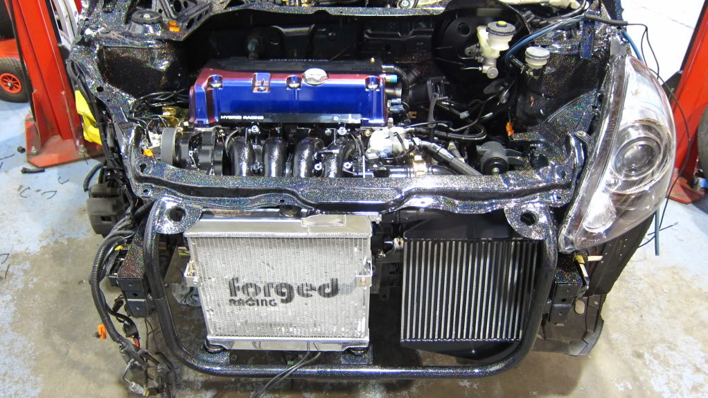

tuning is important in any car ..... some ppl think they put a after market intake on and automatically get 5hp increase..... this is false information provided by the supplier just trying to make u buy the product.... i mean, Yes u will get that 5hp increase but that's after tuning....without tuning, u will loose hp !!
cant post without pictures
