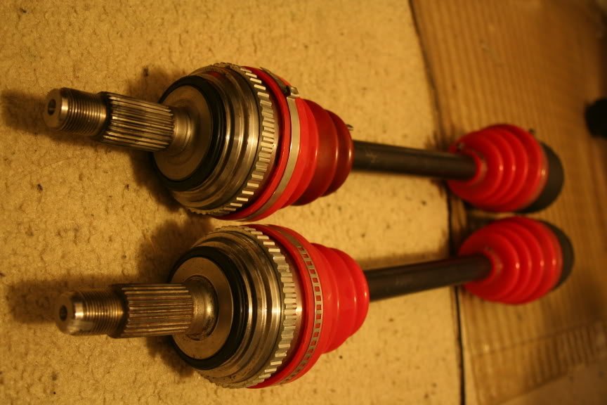

MAKE SURE YOU TAKE OFF THE ABS/VSS RING ON THE AXLE OUTTER! if you dont it wont free spin and will bind up on the spindle, ask me how i know lol....just take a flat head screw driver and hammer and gently tap it while spinning it around to take it off, take your time cuz it takes a few taps to get it to come off evenly and dont mess up the boot, the ring is the gear looking piece in the pic just before the boot
ive learned alot of do and dont so if anyone has any questions or problems hit me up and ill help
