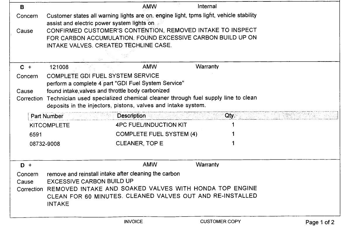

This was Carbon buildup in the engine. That's why the repair was going to be $500. A fuel injection cleaning runs about $179 at the dealer, and that was suggested to be done every 25,000 mile. Unfortunately, It's not just about putting a cheap bottle of fuel cleaner in the gas tank. Wish it was that simple and cheap. My Brother-in law-swears by Honda Fits, he's never had any trouble, that's why I bought mine.

I had the economy button on since I bought my car. I was told by the dealer it doesn't harm the car to have it on all the time. I have a 2018 Honda Fit. At 31,000 I had excessive carbon buildup. I drive mainly on the Thruway and never let the car idol. I am OCD when it comes to maintenance for my car. My dealer wanted to charge me $500 to fix it. The car was under warranty and they weren't going to honor the warranty because according to them the problem wasn't due to a defective part. I called Corporate and got no where. With a little research I found that this carbon buildup is common in Honda's and Corporate hasn't addressed the issue. Nobody could give me an answer as to whether having the economy button on all the time contributed to the buildup at such a low mileage. BTW, a fuel injection cleaning is not listed in the maintenance manual as a regular service because Honda doesn't want the cost of owning the car (as listed in Consumer Reports) increased by adding that to the schedule. After talking to several mechanics who work on Honda's and own them they confessed that they have the fuel injection cleaning done on a regular basis. Some honesty from Corporate would be much appreciated. Had I known this before-hand I could have avoided a costly repair. I leave the economy button off now and plan on having a fuel injection cleaning every 20,000 miles. Buyer beware.
How did you know you had excessive carbon build up? Was there a check engine light? What was the trouble code. You mentioned fuel injection cleaning, did you have issues and had the fuel injectors replaced?
This was Carbon buildup in the engine. That's why the repair was going to be $500. A fuel injection cleaning runs about $179 at the dealer, and that was suggested to be done every 25,000 miles. Unfortunately, It's not just about putting a cheap bottle of fuel cleaner in the gas tank. Wish it was that simple and cheap. My Brother-in law-swears by Honda Fits, he's never had any trouble, that's why I bought mine.
You know, I had looked into that quite a while ago and from what I gathered, the carbon buildup you may actually see, like in the manifold, etc. does little harm. And when I asked others about cleaning the carbon buildup "past my throttle body" I got the same answer----"It's going to be there, cleaning isn't going to make much of a difference (except for cleaning the throttle body of course) and that the liquid cleaner you put in your gas tank does nearly as good. Now, that being said, I am no mechanic but carbon buildup, especially with the low mileage you have on your car, I think is just a fact of life. Where you do want to keep it clean is at the injectors, spark plugs, throttle body, etc. and I guess the liquid gas tank cleaner helps a lot there.

Yes, the check engine light came on. I don't know what the trouble code number was, the dealer diagnosed it as a carbon buildup problem.
The fuel injectors were not replaced, they took them apart, cleaned them and also did a standard fuel injection cleaning. All told for the labor and service it would have been $500+. Like I said before, nobody could tell me for certain if having the economy button on continuously may have been a cause.

Can you get an itemized list of exactly what is included in their "standard cleaning service"?? If they didn't give you a written list of the work performed, I'd be suspect. And if they did give you a list, could you please post it here? Thanks.

This is the info from the Dealer invoice about what they found and the work that was done.

I attached the invoice showing what the dealer found and the work that was done on my car.
I did not know there was any service that actually disassembled parts of the engine to clean carbon. I thought that all they would do was run some liquid cleaner through the fuel line to do the cleaning. Are all your warning lights off now and is the car running right now? And will this condition just come back?
Cool keep us posted to see how it's going as the miles go up. Too bad they didn't include the DTC. Might be an option for those that think that they have to replace the injectors.

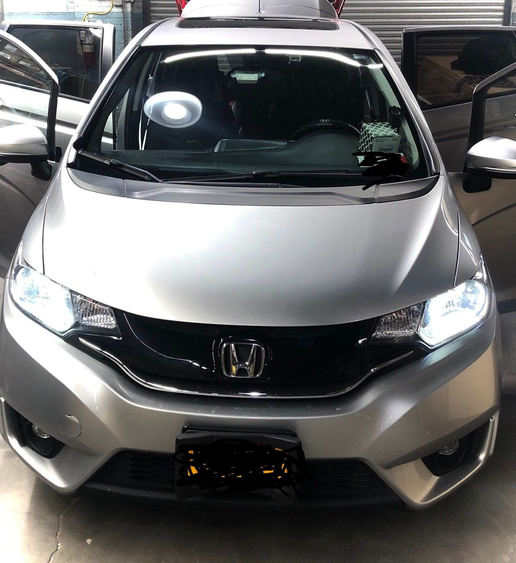

Led :)
Originally Posted by 2Rismo2
The headlight bulbs definitely need replacing. Don't waste your time on halogen, just go to a high quality LED and it's a world of difference.

Warning lights are off and I was told that I should have the fuel injection cleaning done every 20,000-25,000 miles to prevent this from happening again.
This is NOT a recommended service on the maintenance schedule for a Honda Fit. I wasn't given a clear answer as to why this carbon buildup happened.
My brother in law has owned several Honda Fits and only had to have the oil changed and brakes done.

BTW, this was not a service, this was a repair to the car on top of the fuel injection cleaning that was done.
GK is the first fit with GDI so it's a different fuel delivery design.
That said, I'm at 89k and I've never done a fuel injection service. I put the cheap stuff from Murphy gas station.
